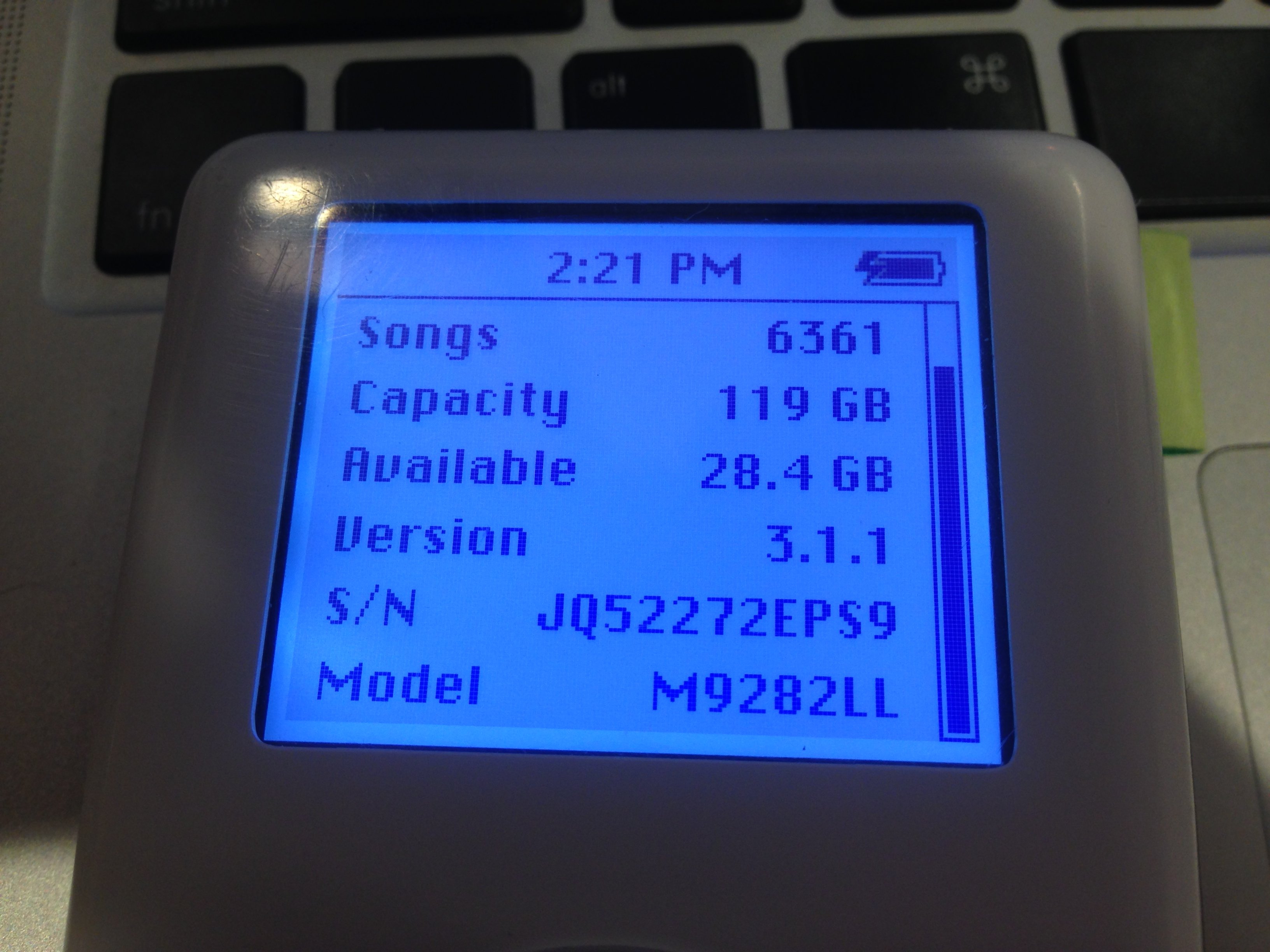

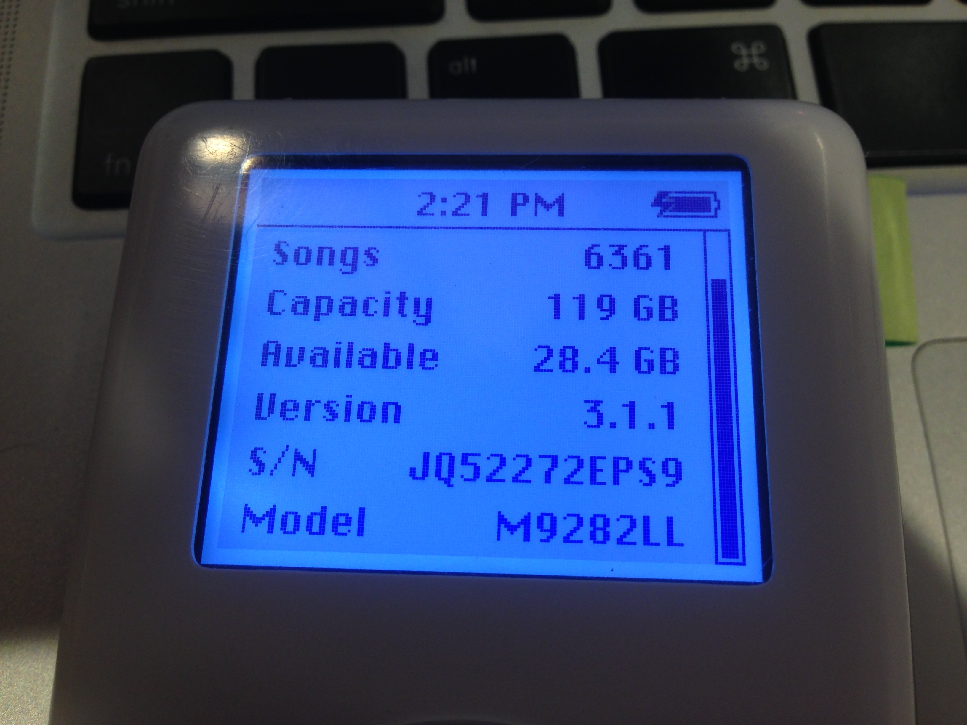

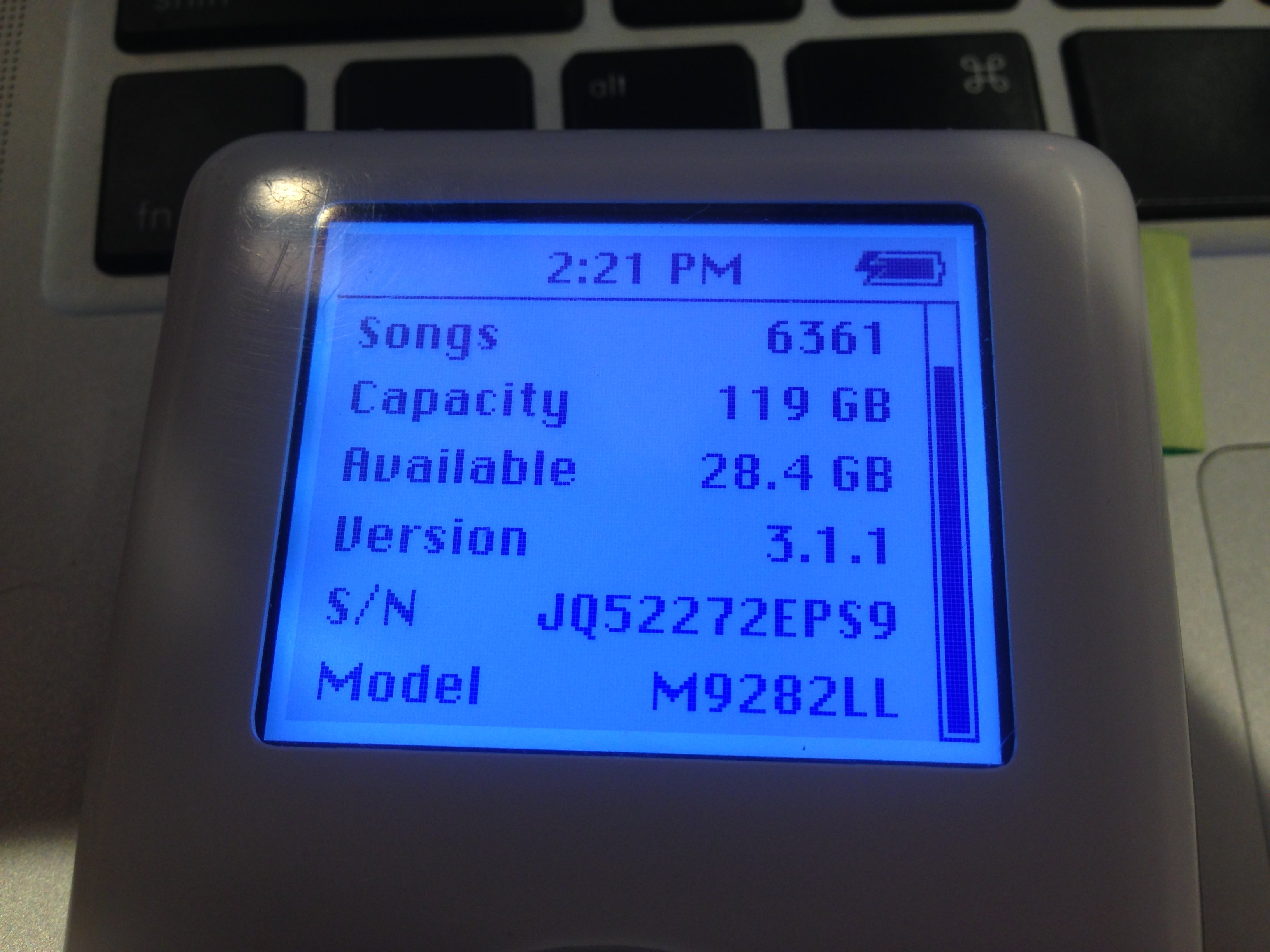

Has anyone successfully converted a 4th gen to 256GB and verified that everything still works after filling up the disk with music ? I'd specifically be interested in storing ~10k lossless tracks on mine if that's possible.
Not strictly what you were talking about, but there are some pictures of people who have successfully done similar mods at the iFlash website here: https://www.iflash.xyz/store/4th-gen-converter/
Reactions: tkermit
thanks, that's helpful! Of course, after seeing this, I'm now seriously tempted to try my luck at putting a 512GB SD card in there for a bit of "future-proofing" ... seems too good to be true for that to work. Now if only the old iPod software understood album artists and I'd be in heaven ... 😵
Happy to help. I really see no reason why that wouldn't work. It seems like you can pretty much have as much storage as you can afford, it's only the track limits you would have to watch out for. I actually just finished installing a 128GB microSD in mine. It's so nice to finally have an iPod (and a thin 4th gen. at that) which can hold my entire library.
Reactions: rgarjr and tkermit
Very nice! That's my exact model. I just ordered a 400GB SD card and all of the necessary adapter paraphernalia, plus replacement battery while I'm at it. Happily, I also just discovered the wonders of Rockbox which finally lets me select albums by album artist and have gapless playback on my iPod. We'll see how everything goes. I'll be sure to report back here in any case.
