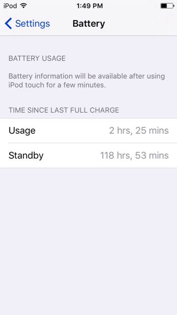

What are your guys' battery life like if you leave it on standby?
my standby..

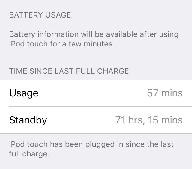

My iPod 3g 64gb still gets about 5 days standby plus an hour a day of listening; Wi-fi is turned off completely. When I first got it six years ago, it could get 10-14 days of standby with 1-2 hours of listening a day. Are those days long-gone?
The posted screenshot says 72 hours standby which is less than I get today on six year old tech. That's sad.
