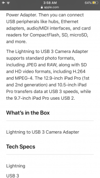

This has nothing To do with your results, I have said which lightning devices have USB 3.0 based on the link provided but you created lies based on your supposed tests that every iOS device since the iPad Pros came out have USB 3.0
The correct answer you could have written a couple of posts ago is NVMe since all iPad Pros (and A9 devices and later) have it which accounts for faster transfer speeds and could be why your “tests” all across the board be the same since NVMe in these devices is akin to a PC class SSD and the A8 and before was usingnot ANYTHING TO DO WITH USB 3 which I told you which lightning devices use it and I showed you the link to the usb 3 camera adapter which Apple states which lightning devices have usb 3
And a screenshot. If you still think all iPhones and iPads released since iPad Pros have USB 3 even when Apple has stated the obvious then I don’t know what to say

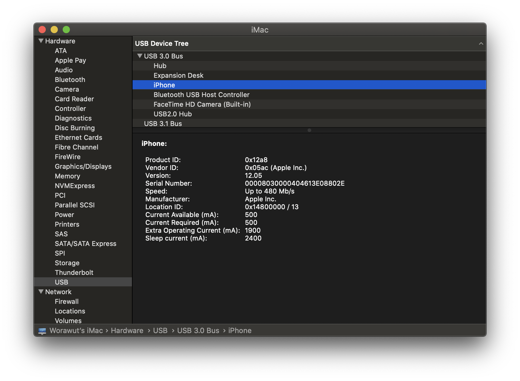

I tested it a few months ago. Only the iPads (12.9-inch iPad Pro (1st and 2nd generation) and 10.5-inch iPad Pro) support low and unstable USB 3 speed (20-70 MB/s) when in host mode and this Lightning to USB 3 Camera Adapter must be used. The adapter provides additional power to the lightning connector, so there is also an extra lightning connector on the adapter. This needed for storage media that need more power.
If you use this adapter with other lightning products like iPhones, iPad mini, iPad Air etc... it is only USB 2.0 in host mode.
If these 3 iPad Pro are not in host mode, without Lightning to USB 3 Camera Adapter, only USB 2.0 is supported, just like all other current lightning devices (iPhone 12 Pro, iPod touch 7, iPad 8th generation).
The problem is that the lightning connector is not powerful, this is a hardware problem that cannot be solved. Therefore no lightning product directly supports USB 3 transfer speed only with USB-C to Lightning cable to PC or Mac.
Only with the first USB-C devices like the iPad Pro 11 (2018) supported without adapter directly with USB-C cable USB 3 transfer speed in host mode and without host mode.
If interested here are the results.
