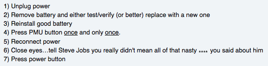

Out of curiosity, have you tried a PMU reset?
Screenshot instructions borrowed from a friend.😉
(It's worth a try.)
(It's worth a try.)
