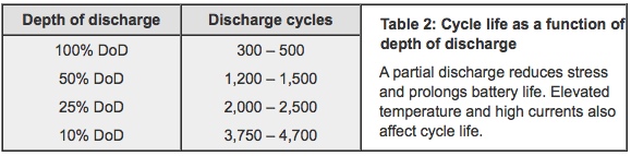

I would suggest you read some material on batteryuniversity.com. On their home page, their 'Most Popular Articles' section has a number of things specific to charging and prolonging the life of Li-ion batteries.
The principals of charging li-ion batteries are universal. Apple has no super special handle on the process. Although if they give guidelines for their products, it is probably worth heeding.
I try to let my iphones, ipads, and ipods drop to at least 20% before I charge. I may have topped off a device once or twice from an already charged state of 80% or higher. But I try to avoid that. Both of my iphone 5's, my ipad 3 and ipad air still go multiple days without having to recharge and charge back up pretty quickly. So I assume my batteries are in good shape still.

There is some science to helping a lithium based battery have a longer life span.
There is nothing new to the technology and even though it's in a iPhone the same physics and chemistry apply to all lithium based batteries.
I really wouldn't worry about it though. The difference it makes is to insignificant to worry about. Be better to charge your phone in cooler areas then worrying about how depleted it is.
