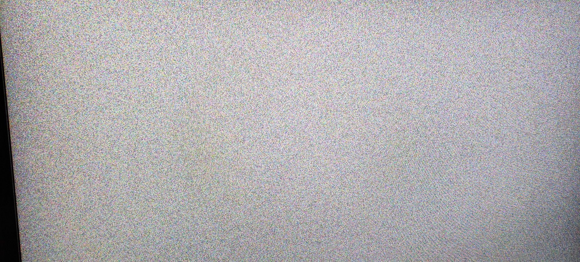

but the biggest problem is the flickering and grainy image on the monitor! Sometimes there is no image at all only after I unplug and reconnect the monitor's HDMI cable!
I also thought that the video card was faulty, but then the TV screen would also be grainy

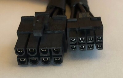

Unfortunately I have to replace the MPX 580 Pro card with an rx 6600xt because there are many problems with the MPX
I'm not sure which power cable I should buy for it?
If I buy 2 of this cable it will be good?
Thanks
That cable should work.

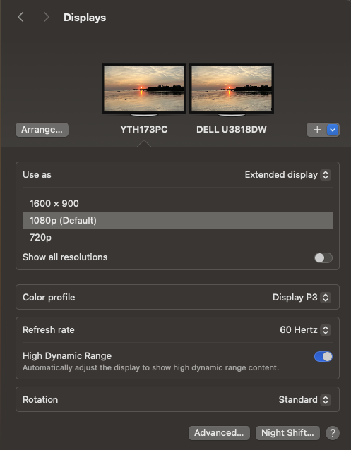

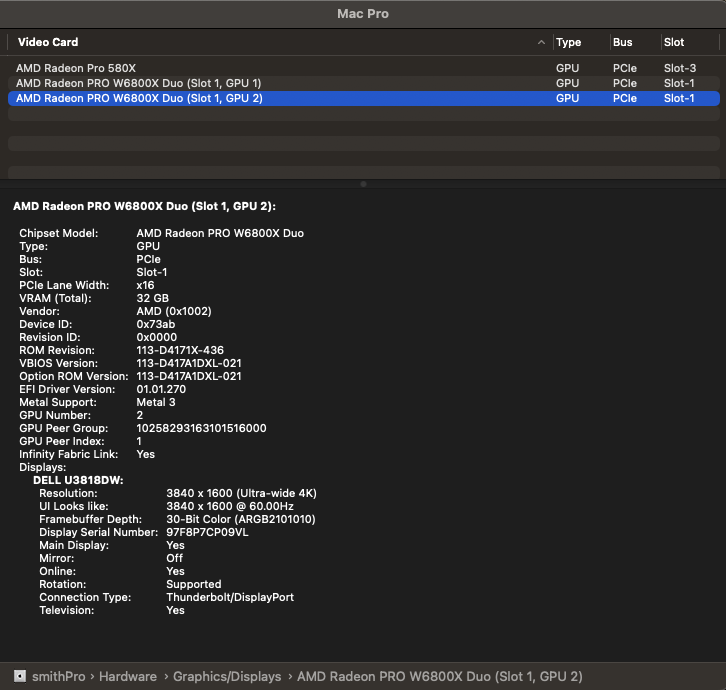

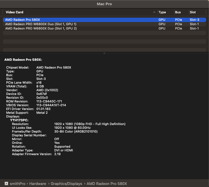

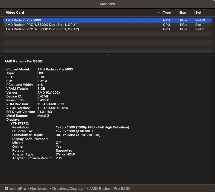

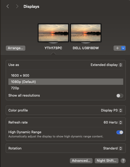

I am not sure why you are having issues with your MPX 580x; I still have mine installed also and it seems to work fine for whatever. As you can see from my screen shots, I have a 17" HDR capable monitor and a Dell Ultrawide. The 17" is being run off the 580x and the Ultrawide off the 6800 Duo.
Although I will say that a non-HDR image background looks wonky on the 17" if I switch it to HDR mode, but HDR videos look ok using the Display P3 color mode. Personally unless you are doing video editing in HDR the need for HDR is pretty minimal.
Although I will say that a non-HDR image background looks wonky on the 17" if I switch it to HDR mode, but HDR videos look ok using the Display P3 color mode. Personally unless you are doing video editing in HDR the need for HDR is pretty minimal.View attachment 2551724View attachment 2551725View attachment 2551726

I tried the HDR setting on Windows 10 and the subtitles are barely visible.
The picture is dark in games and the performance is not up to my expectations.
Unfortunately, the driver for this card is also very outdated.
The video card may be faulty because every time I boot up after entering the password I get a black screen until I turn the monitor off and back on!
It could also be because of the HDMI-DP adapter?
If I have time, I'll repair the HDMI connector on the monitor, which broke, and if I get a black screen even with an HDMI cable, then the video card is definitely at fault.
Unfortunately, with the Magic Keyboard, the bottmenu doesn't want to come up even though I hold down the Option key 🙁
Switching between MacOS and Windows isn't that easy
True though the OWC one is much better than buying from Apple.
I purchased the set because I think it will be increasingly hard to get parts for our Mac Pro 7,1 over time.
Make sure you understand how much power your 6600xt needs - you might need two cables. If I recall there are two 8 Pin PCIe power connectors on the motherboard - both provide 300Watts. Confirm what your 6600xt needs and get the right cables accordingly.
I would try and download the driver installation package for Windows from AMD directly and try and install that to see if it makes a difference for the 580
Thanks for the advice about the cable!
I downloaded the Adrenalin installer from AMD's website and it didn't recognize the card!
The driver that BootCamp installs is very outdated and it seems that there is no newer version for this video card.
I think switching to rx6600xt is the best option
It also performed well in MP 5.1!
What version do you have? 21.30.44.22 is the latest from June 17th this year.
yes, this version is installed!
When I start the game Until Dawn, the system warns me that a newer driver is required for the game to function properly!
And what's really annoying is that after every boot it goes to a black screen and rarely colored dots appear!
I'm thinking it's a video card failure, but the strange thing is that after I turn the monitor off and back on, there's a picture again.
