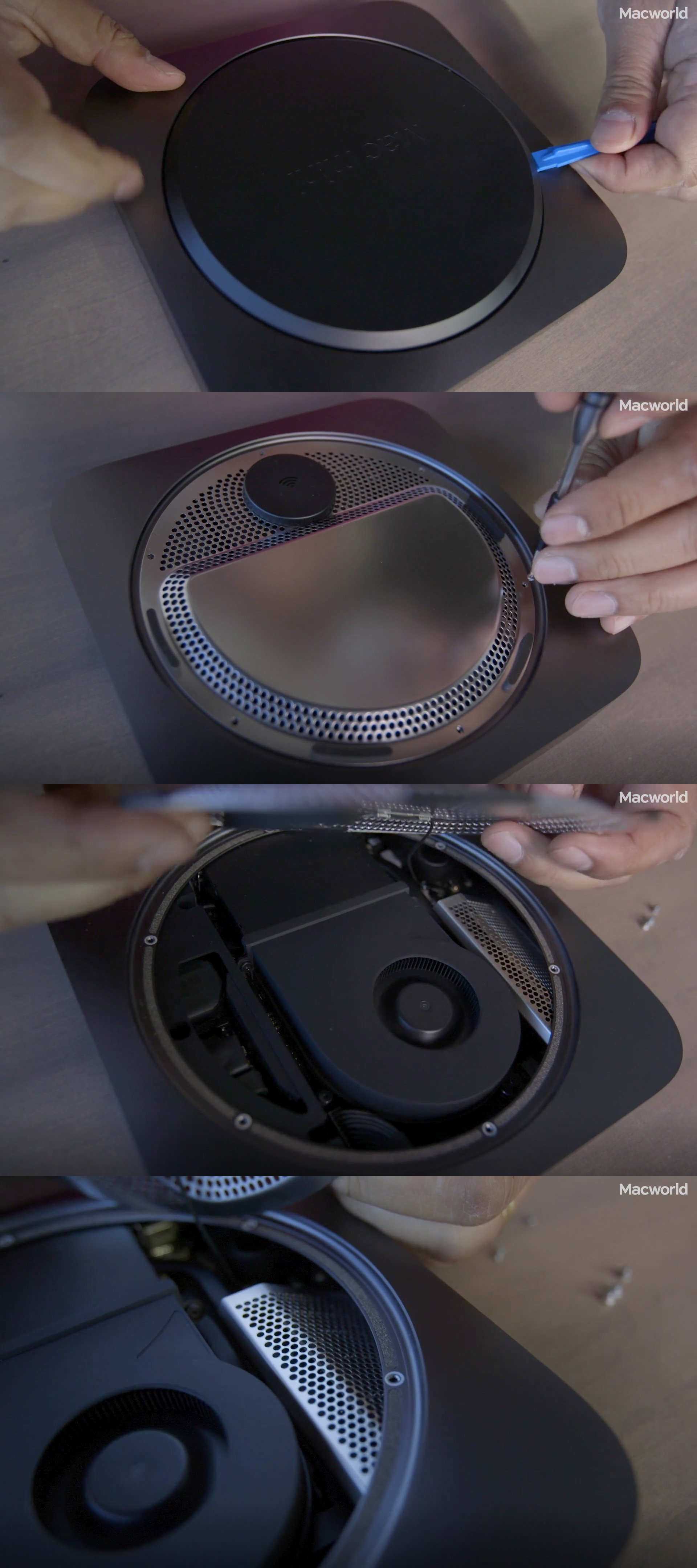

Macworld says it is impossible to replace without removing fan.
Full quote:
Apple doesn’t consider the Mac mini to be user-configurable, and it recommends that memory upgrades be performed by a certified Apple service provider. Doing it on your own will void the warranty.

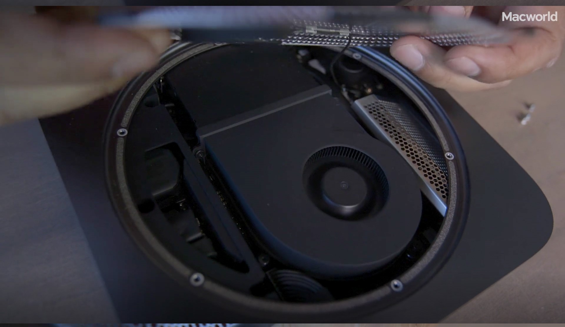

You can easily open up the Mac mini on your own: The circular plastic cap at the bottom of the Mac mini pops off to unveil an aluminum hatch that’s kept in place with torx screws. But what you’ll find when you remove the hatch is that the memory is placed in a sort of a cage, and that you’ll need to remove the fan and other components to get access. It’s not a trivial task.​
Full quote:
Yes, that’s it, thank you. This is a huge deal breaker to me, if true.
What exact purpose does the aluminium cage over the SO-DIMM serve? A heat sink? Though judging by the "brace" over the fan compartment, it seems once you unscrew that, half of the chamber together with the fan itself can be pulled out. Need to wait someone to actually try a RAM swap to see about the cage part. At least it seems to me you don't need to slide the whole mobo out from behind like previous mini's HDD swapping procedure.

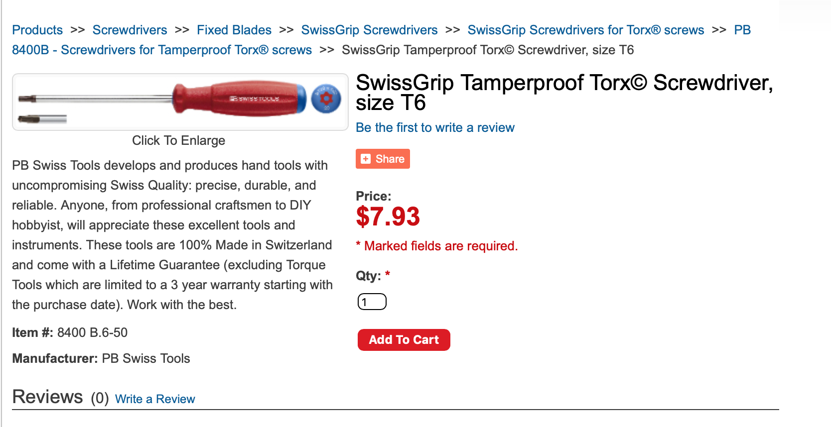

In other words, you think it's it's the driver I listed and attached a photo of.

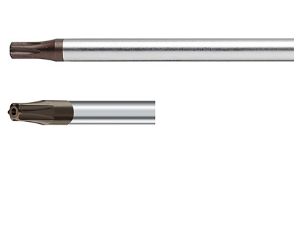

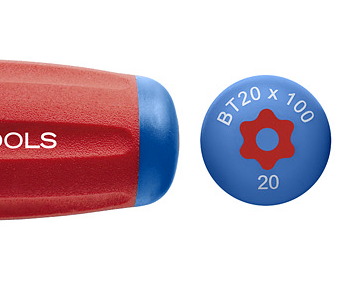

No, you posted a T6, the T6 has no hole to accommodate the pin on the security screws used on the mini.
A version known as Security Torx, Tamper-Resistant Torx (often shortened to Torx TR) or pin-in Torx contains a post in the center of the head that prevents a standard Torx driver (or a straight screwdriver) from being inserted.
This is from the 2014 tear down that used the same screws.

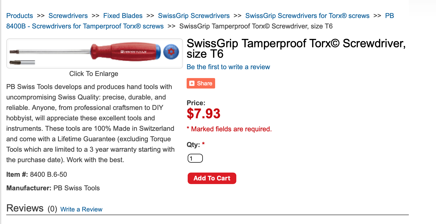

It goes by various names, Security Torx, Tamper Resistant Torx, Pin-in Torx. It's sometimes called a T6, which Swiss Tools uses, and sometimes a TR6, which you apparently prefer.
Yes, or here from Amazon for $4.99:
https://www.amazon.com/Mini-Torx-Se..._1?ie=UTF8&qid=1541511875&sr=8-1&keywords=TR6
or the iFixit one:
https://www.amazon.com/iFixit-TR6-T..._3?ie=UTF8&qid=1541511875&sr=8-3&keywords=TR6
(also $4.99, in stock, ships today)
You don't understand the terminology. Maybe try to speak with less certitude.
It goes by various names, Security Torx, Tamper Resistant Torx, Tamperproof Torx, Pin-in Torx. PB Swiss, a first-class toolmaker whose tools I prefer, calls it a Tamperproof T6. Some people, such as you, like to call it a TR6.
They are all the same thing.
No, the tool he posted IS a tamper-proof Torx, they just indicated the general T6 size, but the item description and photo clearly shows it's for a tamper-proof fastener:

On the 2012 the interior plate, just under the plastic cover had the Wifi antenna - FWIW, swapping RAM in the 2018 looks roughly like swapping the HDD in the 2012, i.e., bottom cover, antenna plate, and fan/duct assembly.
