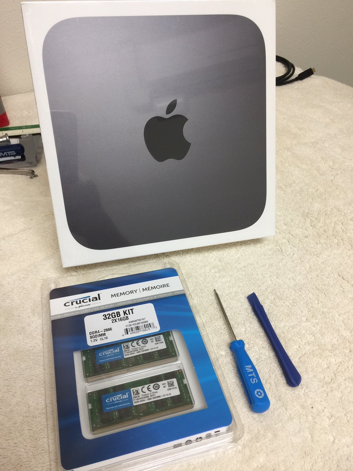

I own a standard Torx T9, but I've ordered an ESD T9 for this project.

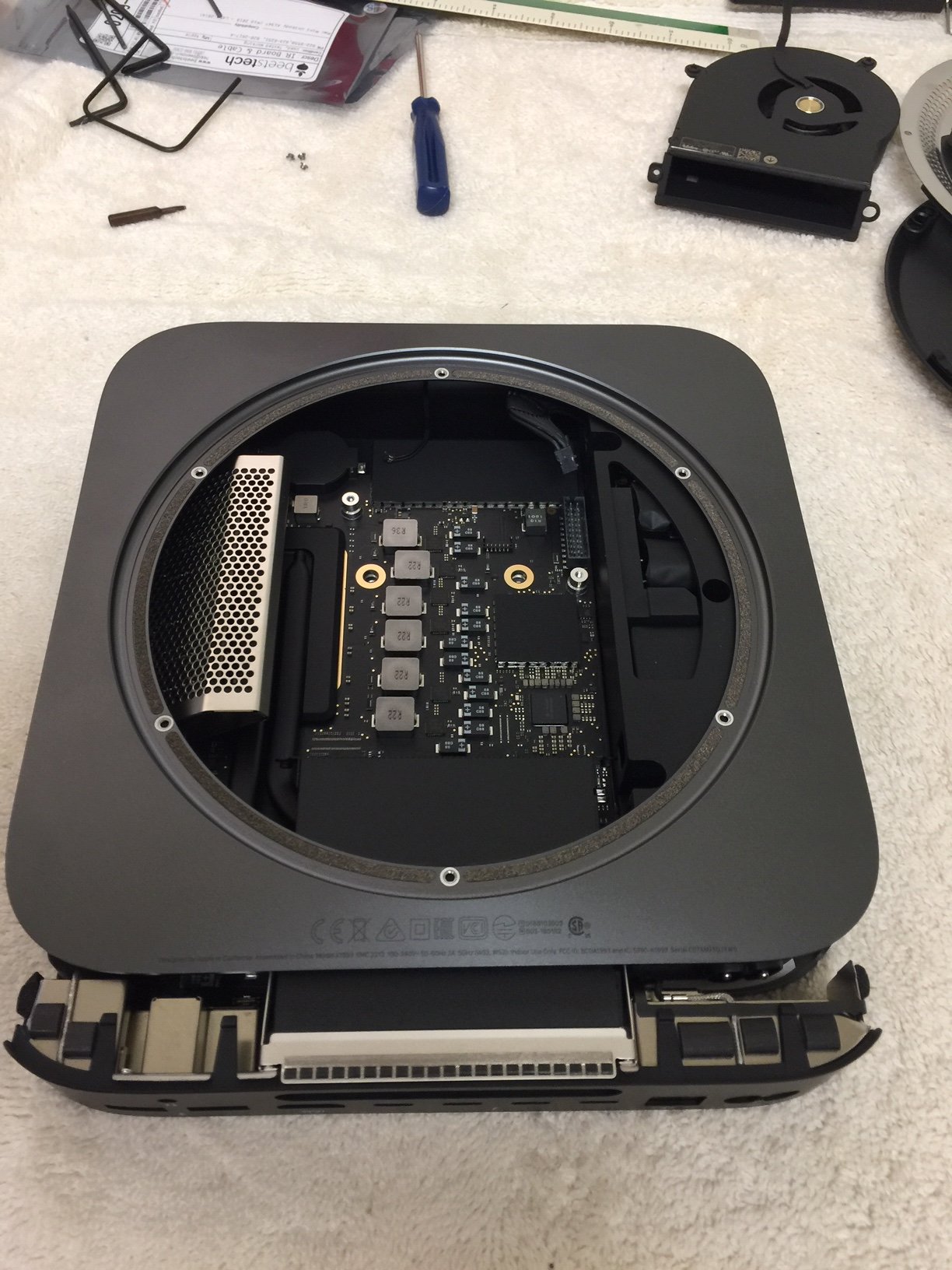

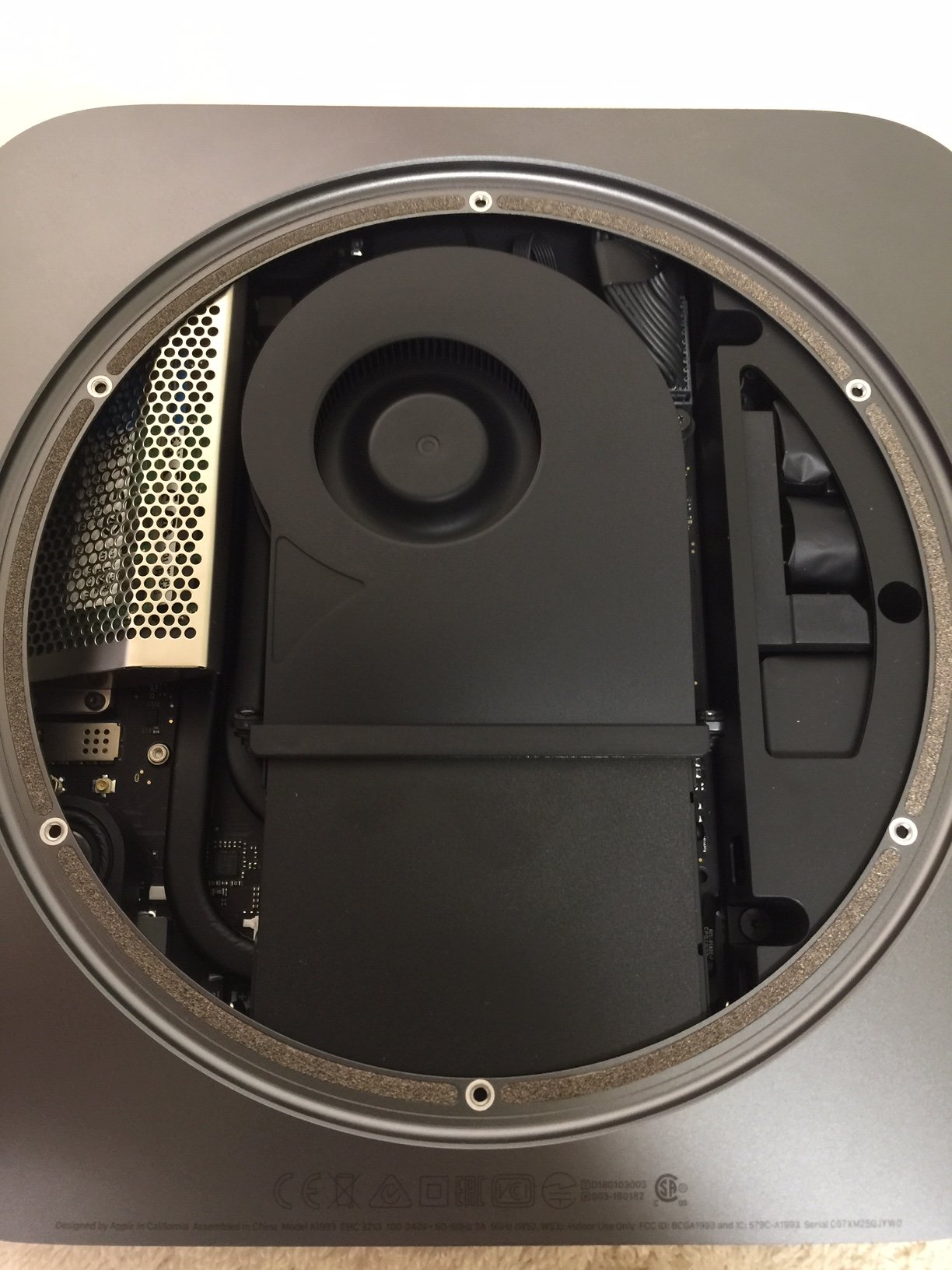

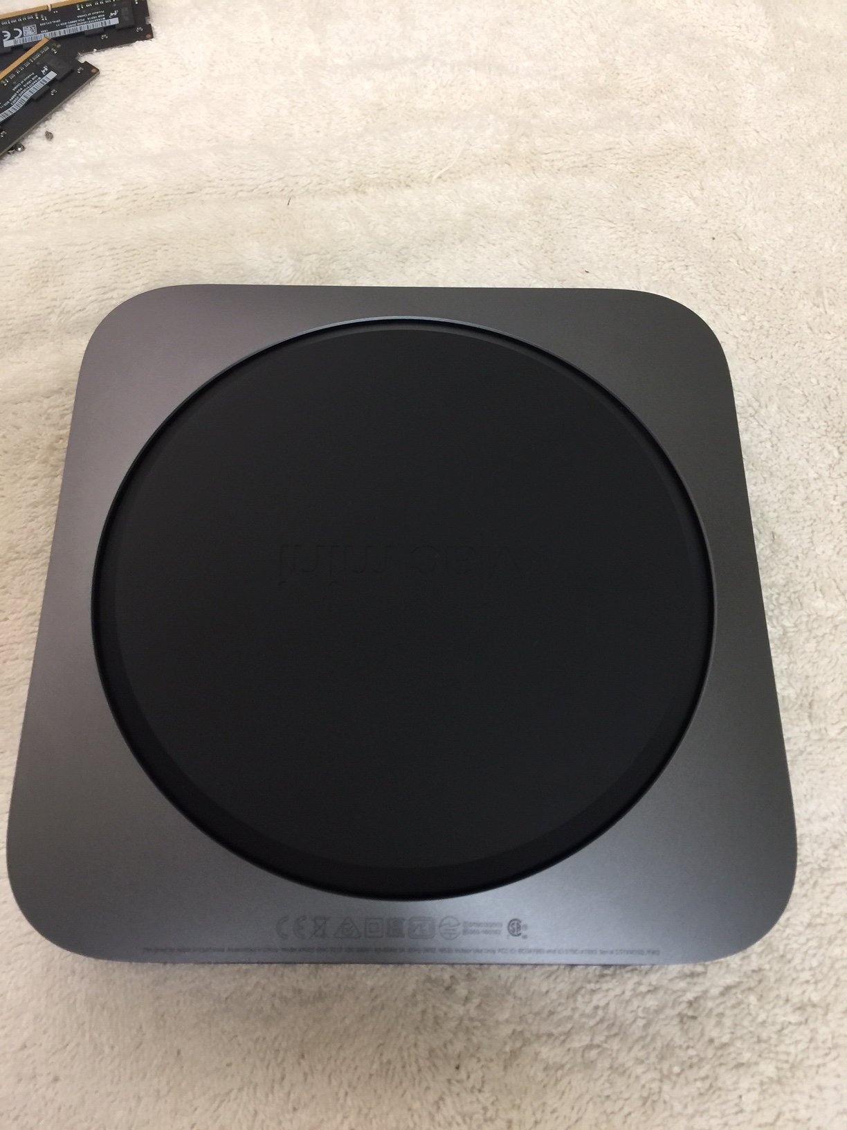

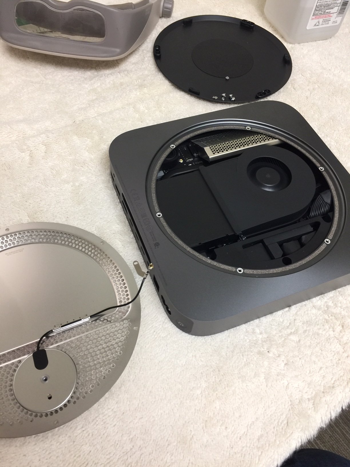

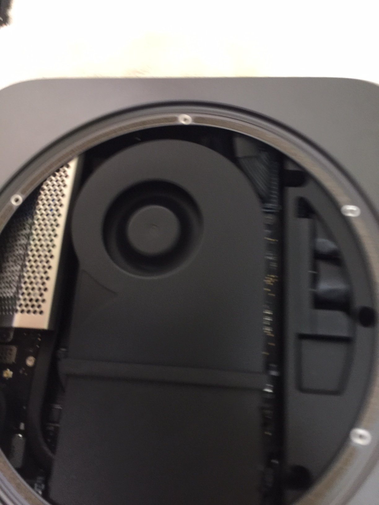

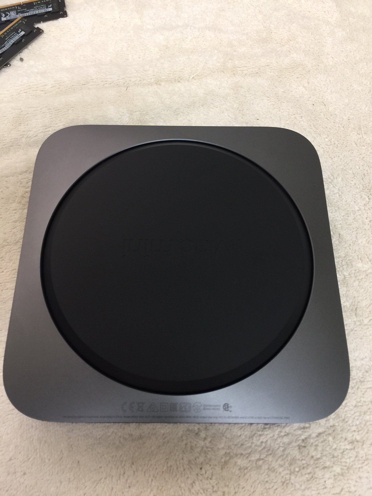

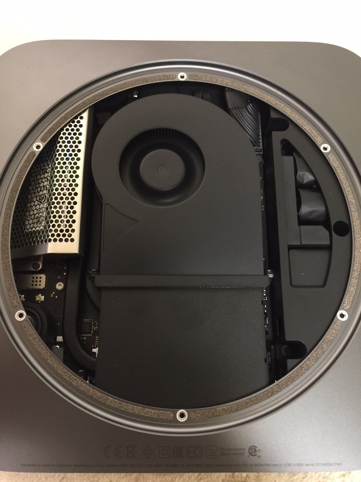

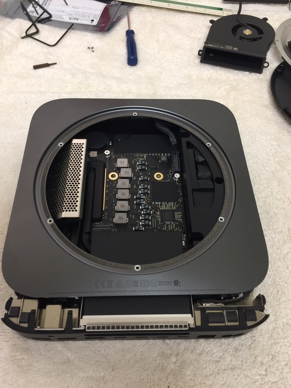

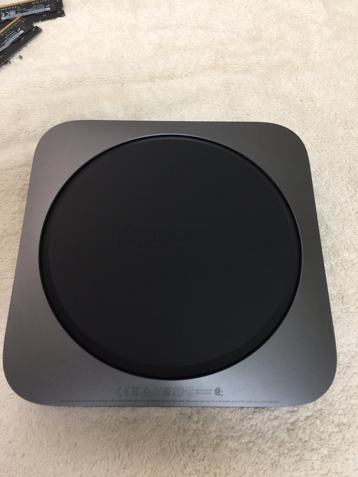

Just got my Mac Mini. Time to rip this sucker open with forensic style grace and poise. Wish me luck!

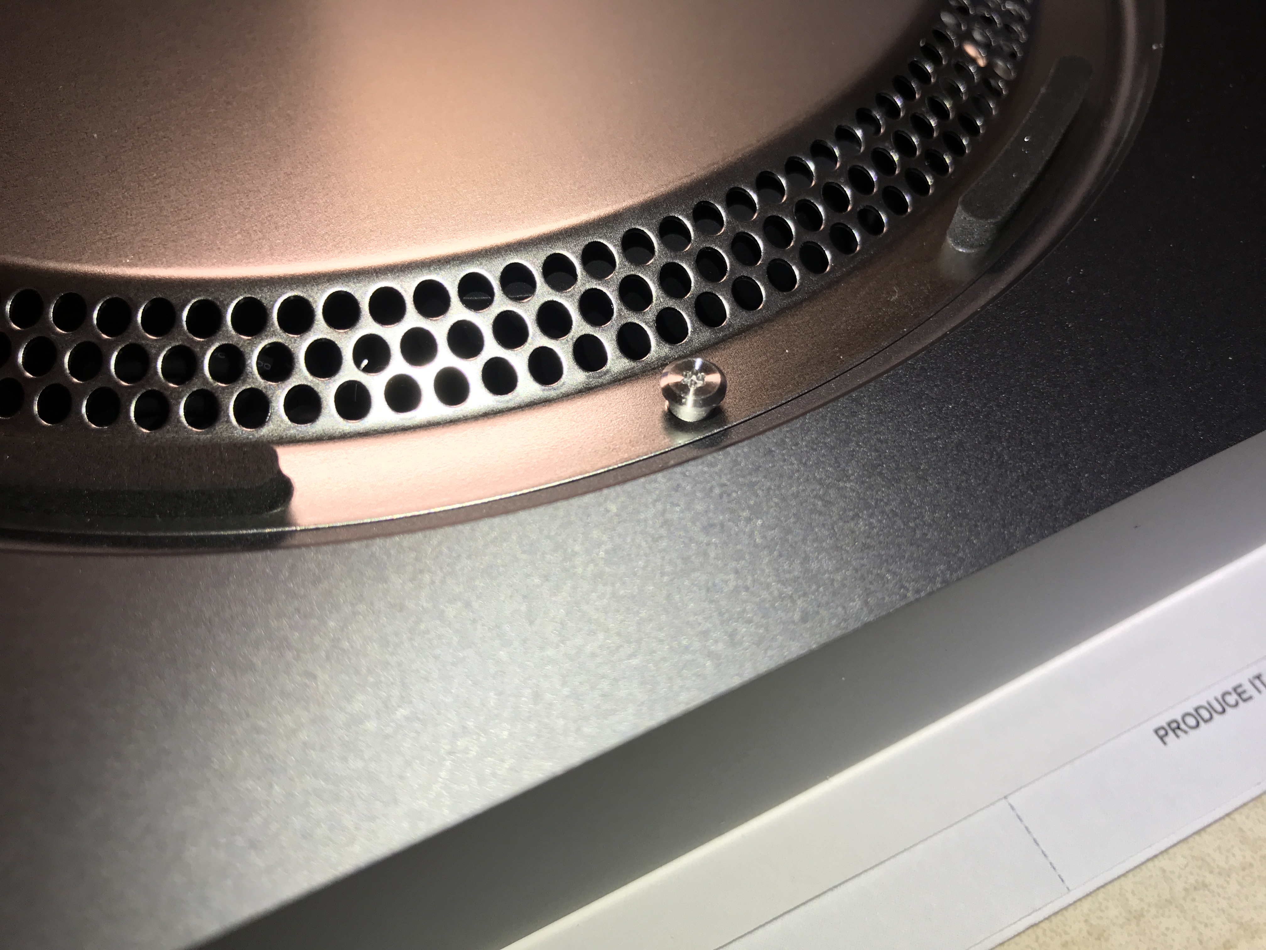

Interesting. Dombera used a T6 and a T9. However, these might well work where you used a T5 and a T10.
Torx can allow for a little "fudge factor", if the tolerances (fasteners or tools) are a little off and the fasteners aren't super tight.
Interesting. Dombera used a T6 and a T9. However, these might well adequately fit the screws on which you used a T5 and a T10.

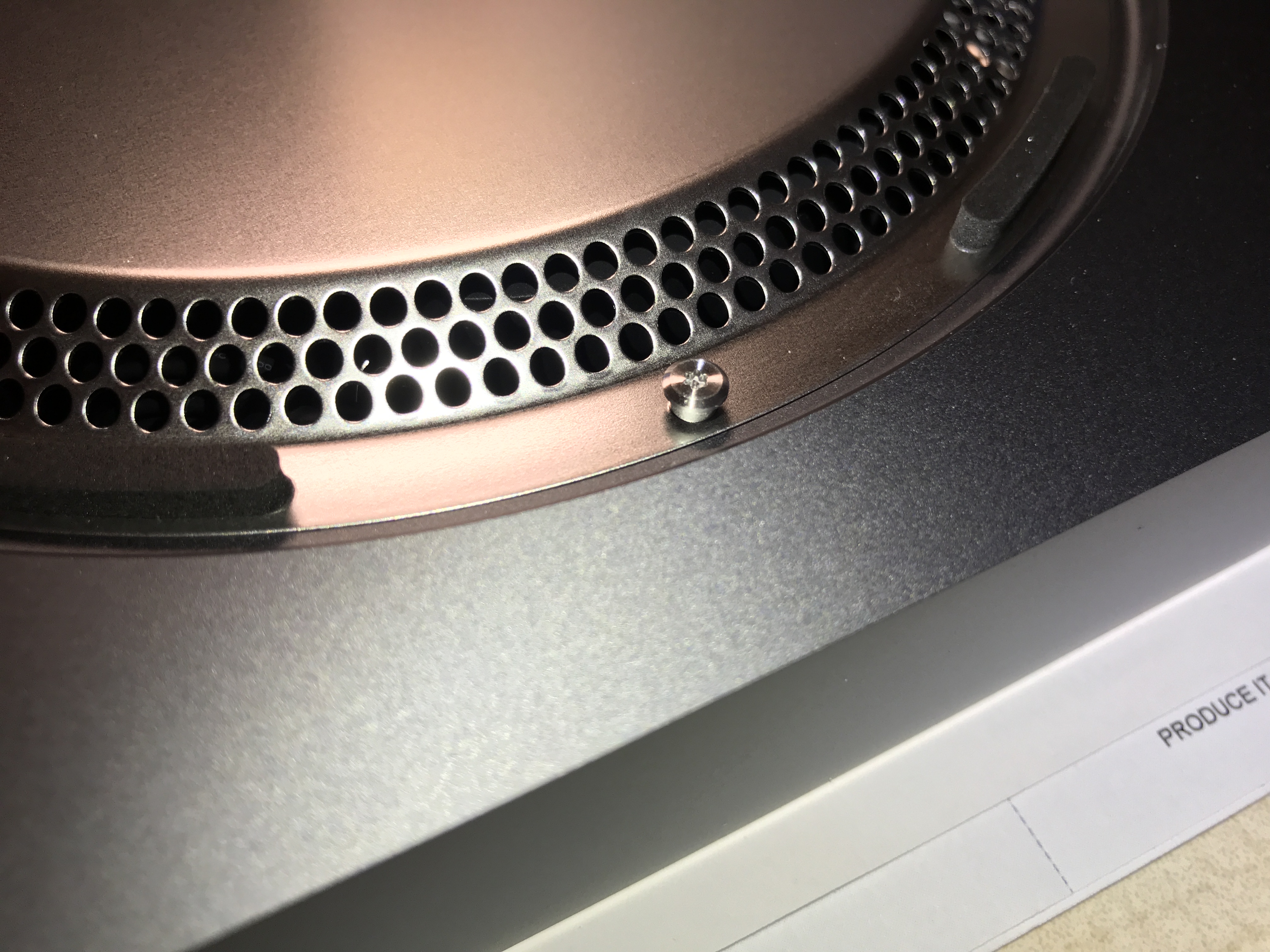

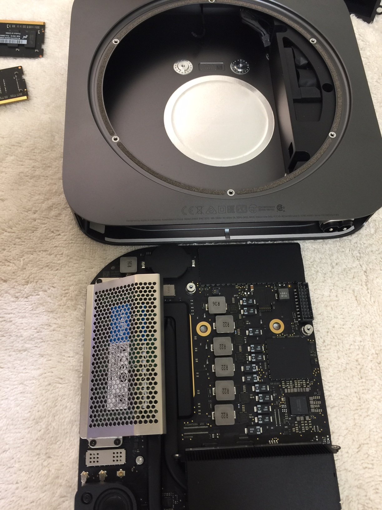

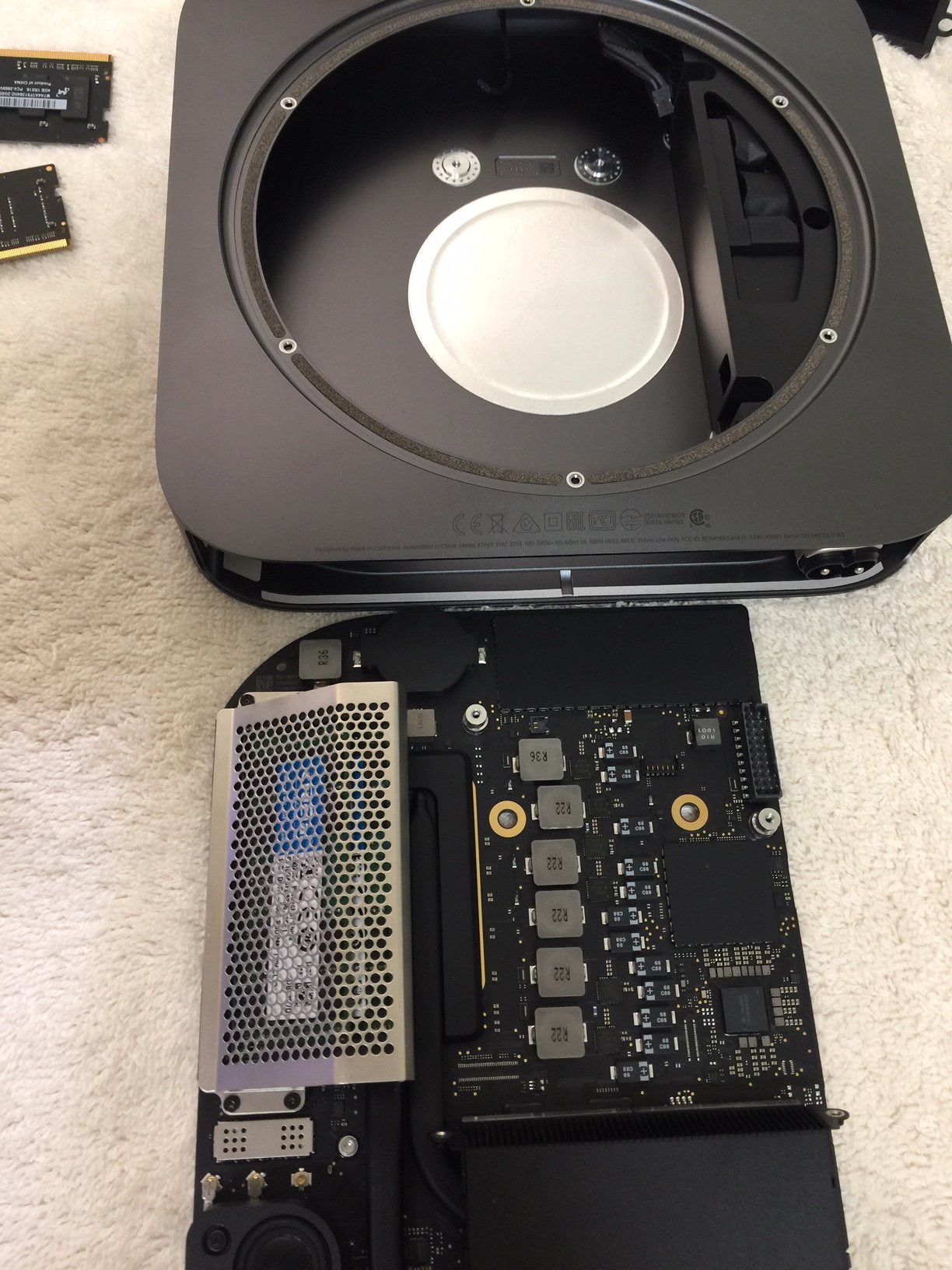

I did originally grab a T9 and it did fit, but a 10 fit better so that's what I elected for. The only security screws are the 6 on the exterior, the rest are standard. I'll do a write up shortly

That was quick
Looks totally doable. Easier than the hard drive replacement I had to do on the inlaws iMac years back.
Reactions: Miat

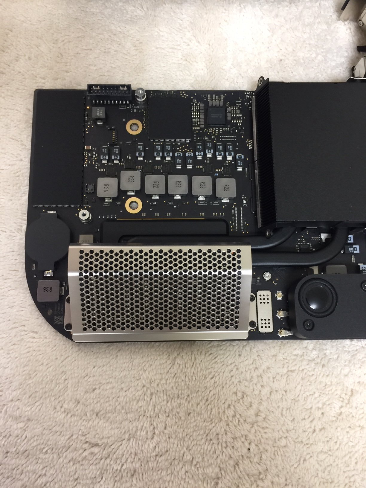

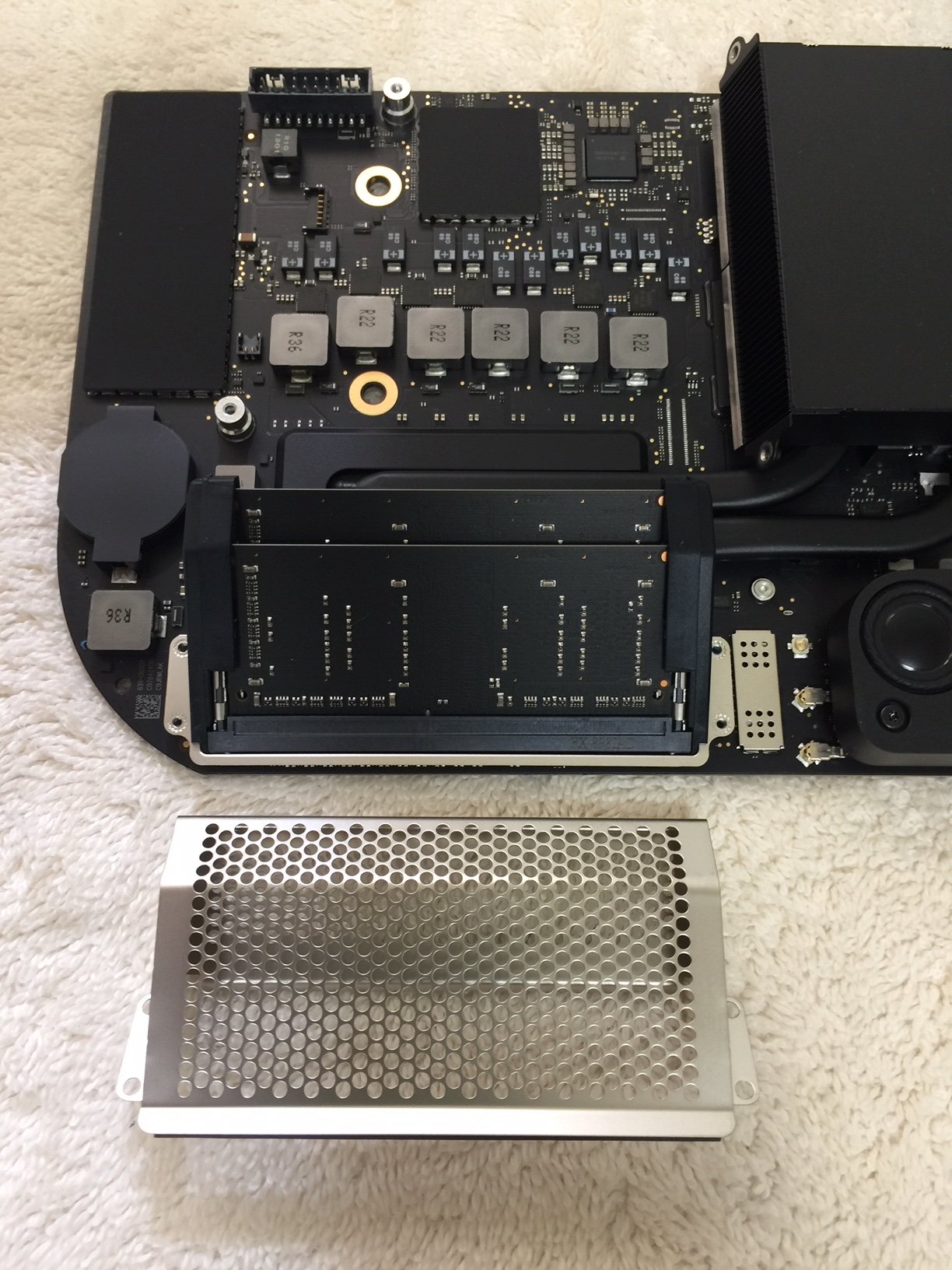

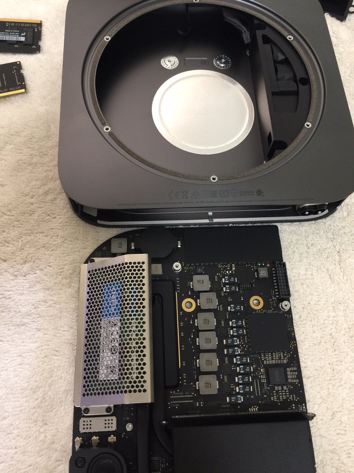

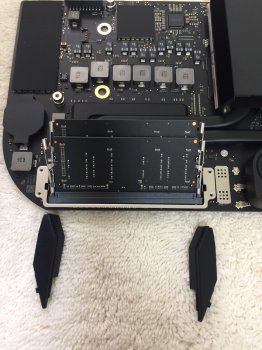

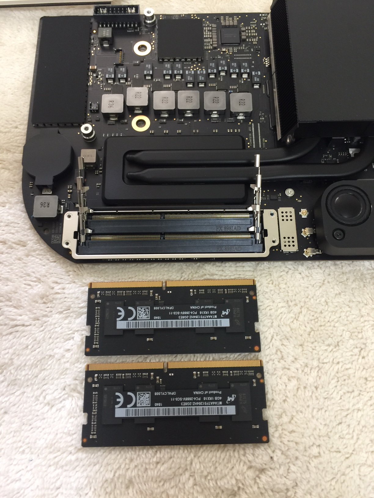

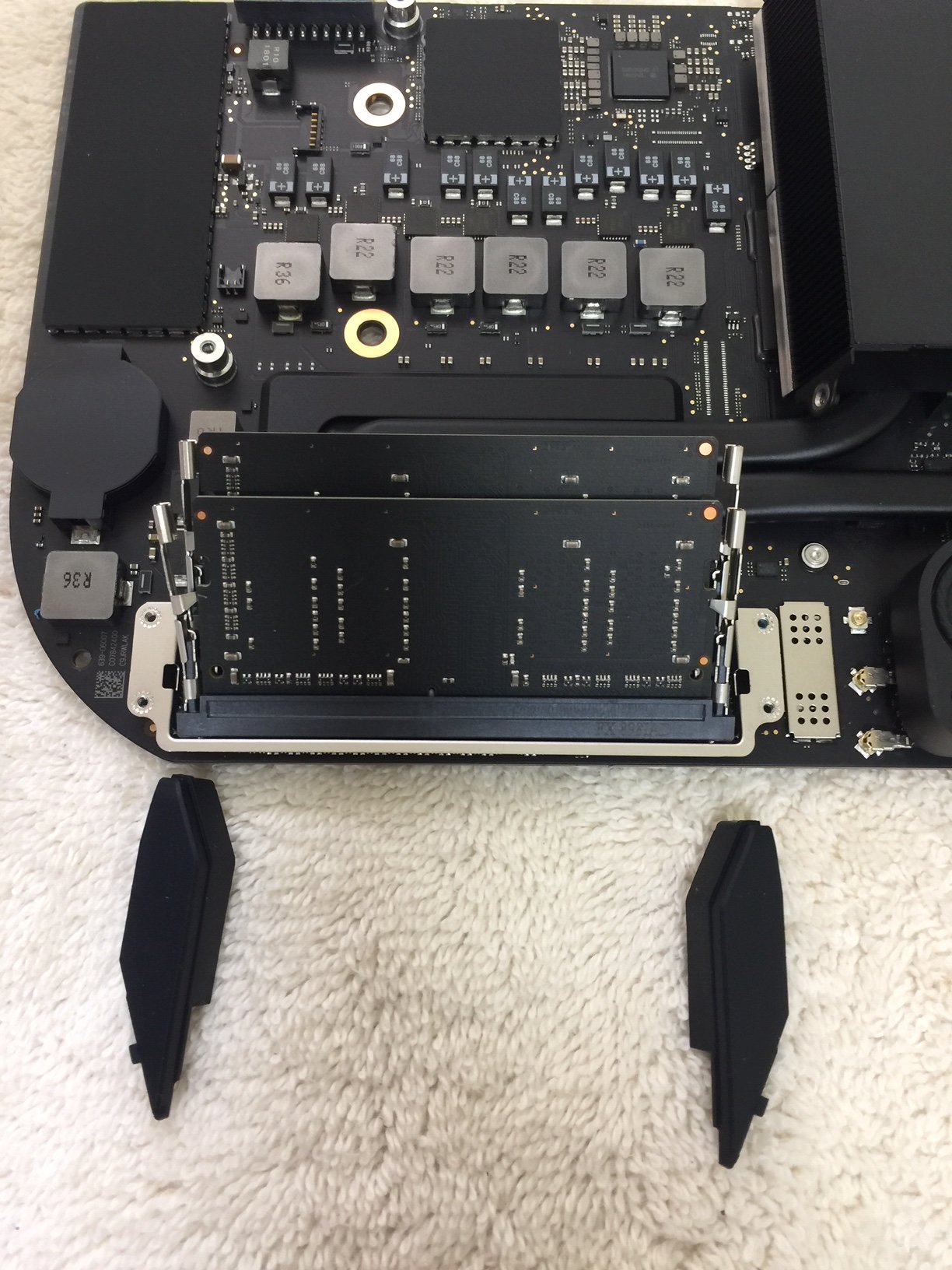

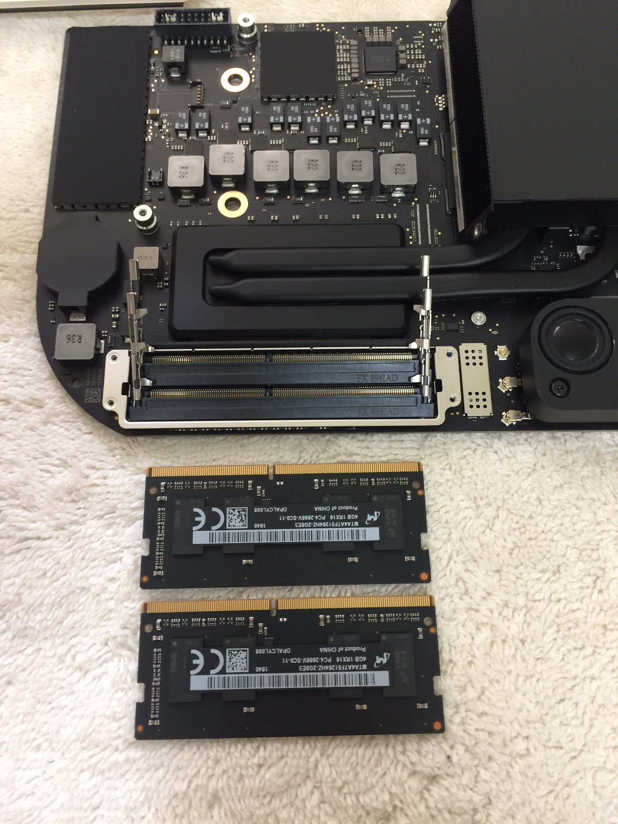

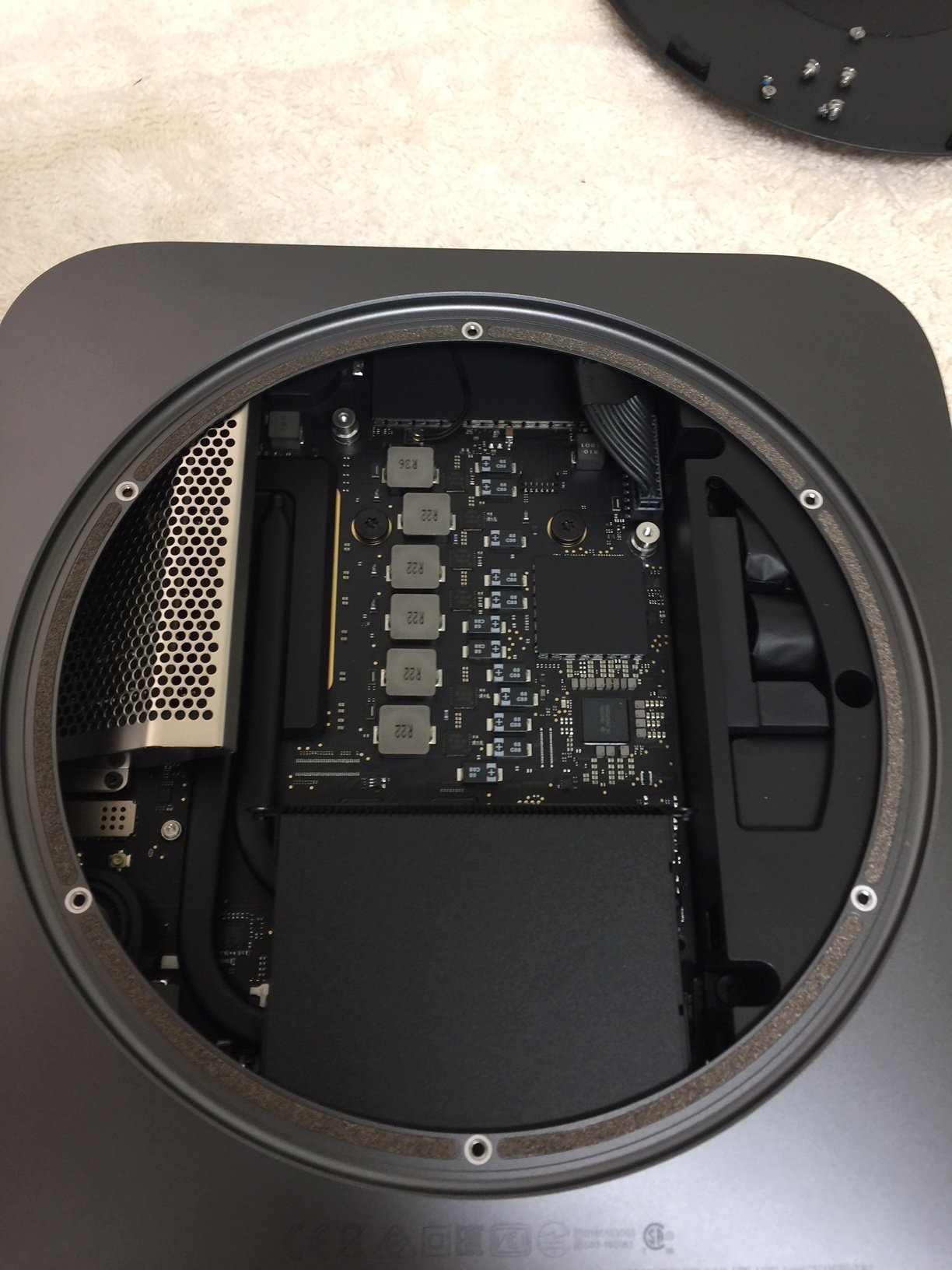

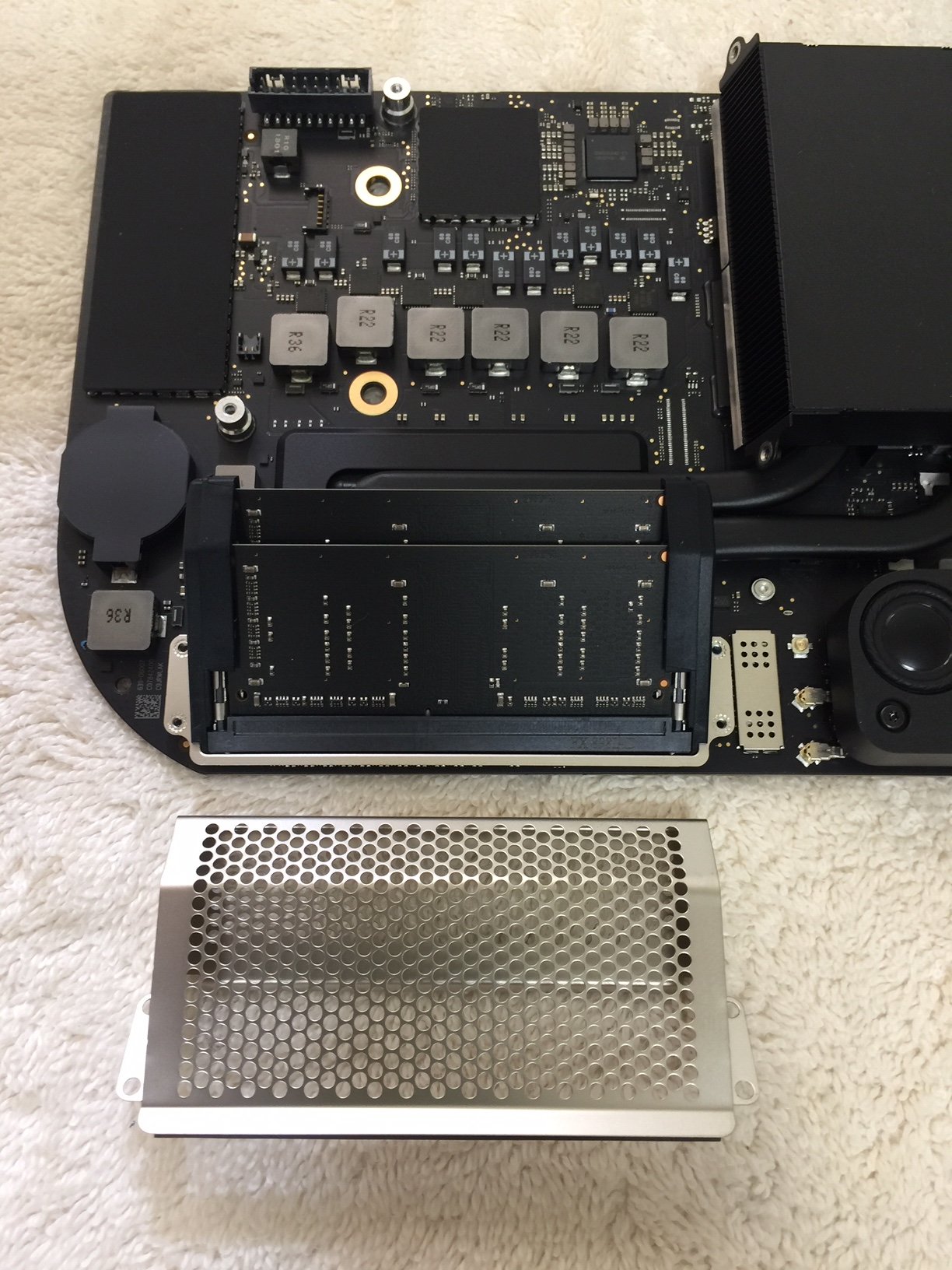

@Dr. Stealth So no way to fiddle the RAM (and cage/cover) out with the logic board in place, right? It doesn't seem like it, but the actual space/clearance isn't totally clear from the photos.
I mean, by the time you've removed the bottom plate, antenna/cover, fans, etc., it's not much more to go ahead and slide the board out, but was just curious 🙂
Oh, did see the really clear photo with the fasteners on the cage, those would be tricky, I'm gonna say that's a big no (but no biggie 😀)
I'm trying to order some screwdrivers 🙂

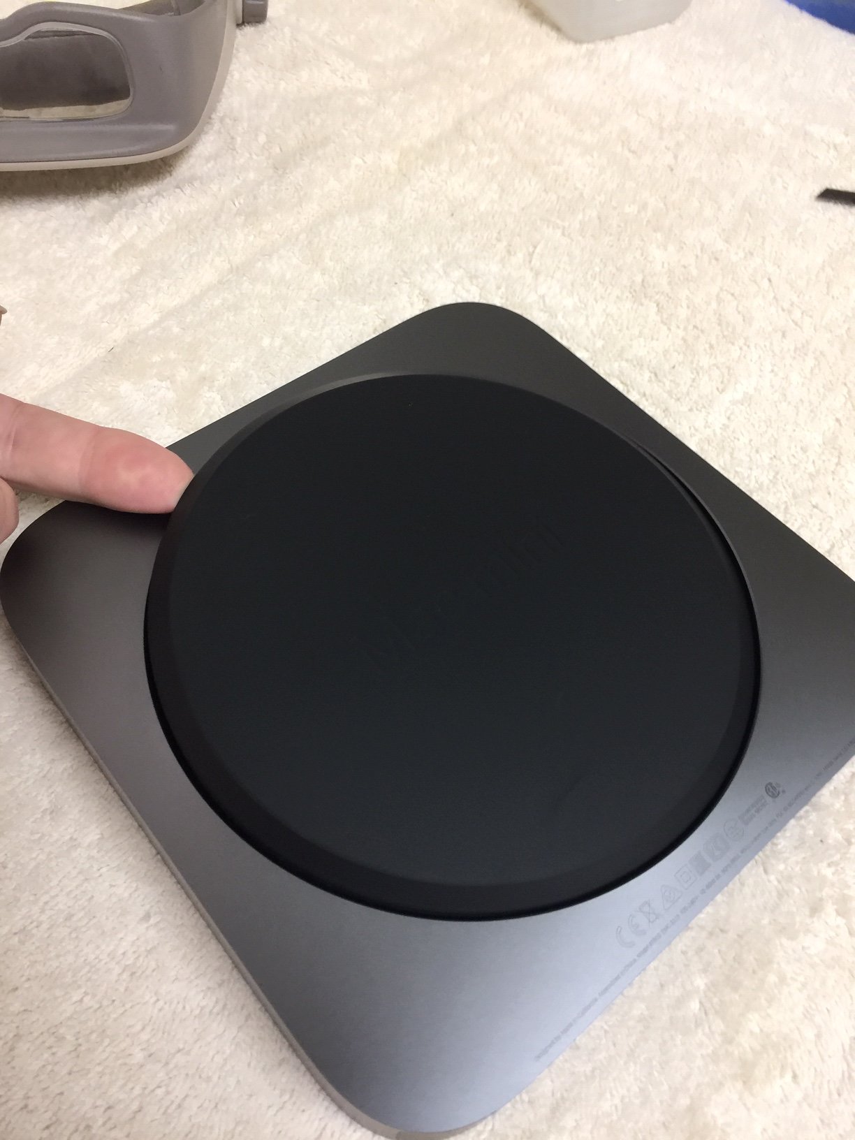

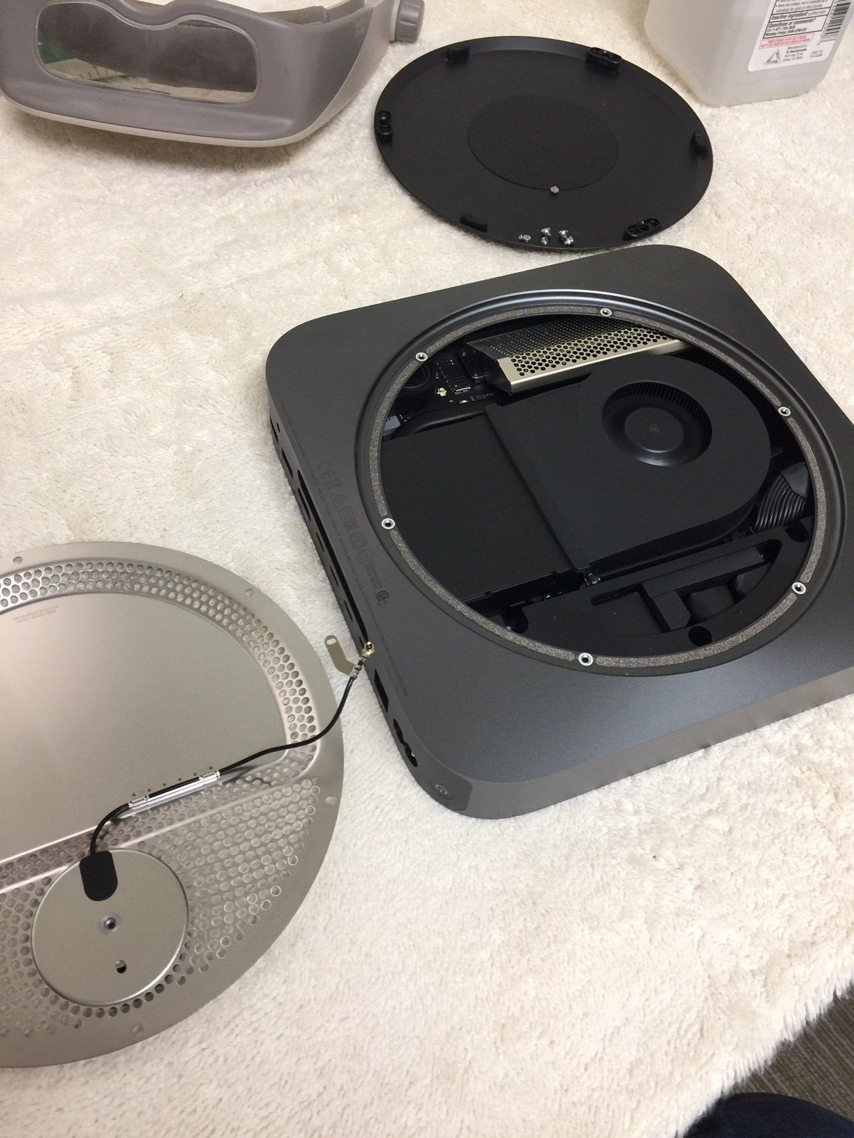

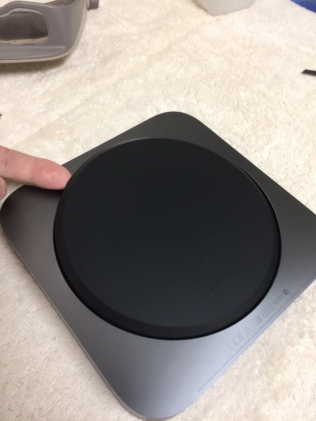

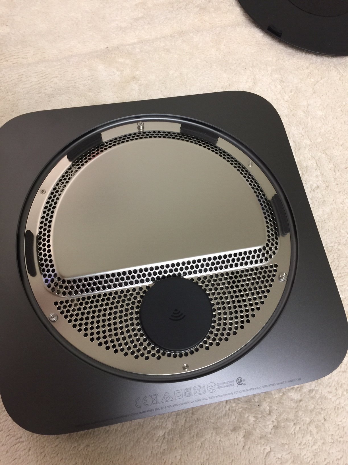

Which ones did you use? Also, how did you get the backplate off?
Ignore if you're going to do a write-up, or are engaged at the moment with a glass of celebratory champagne.
A spudger or even Credit card should do.

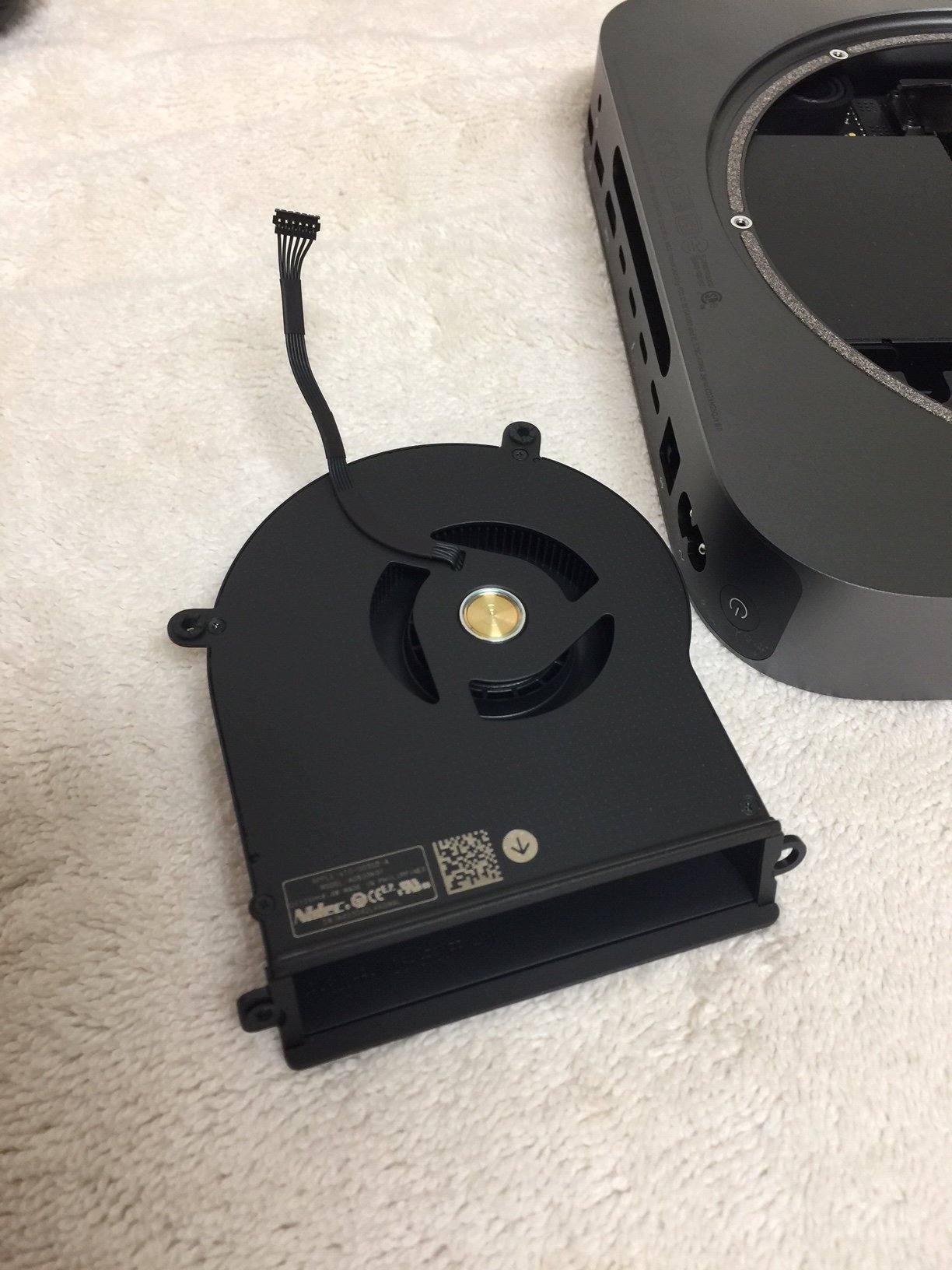

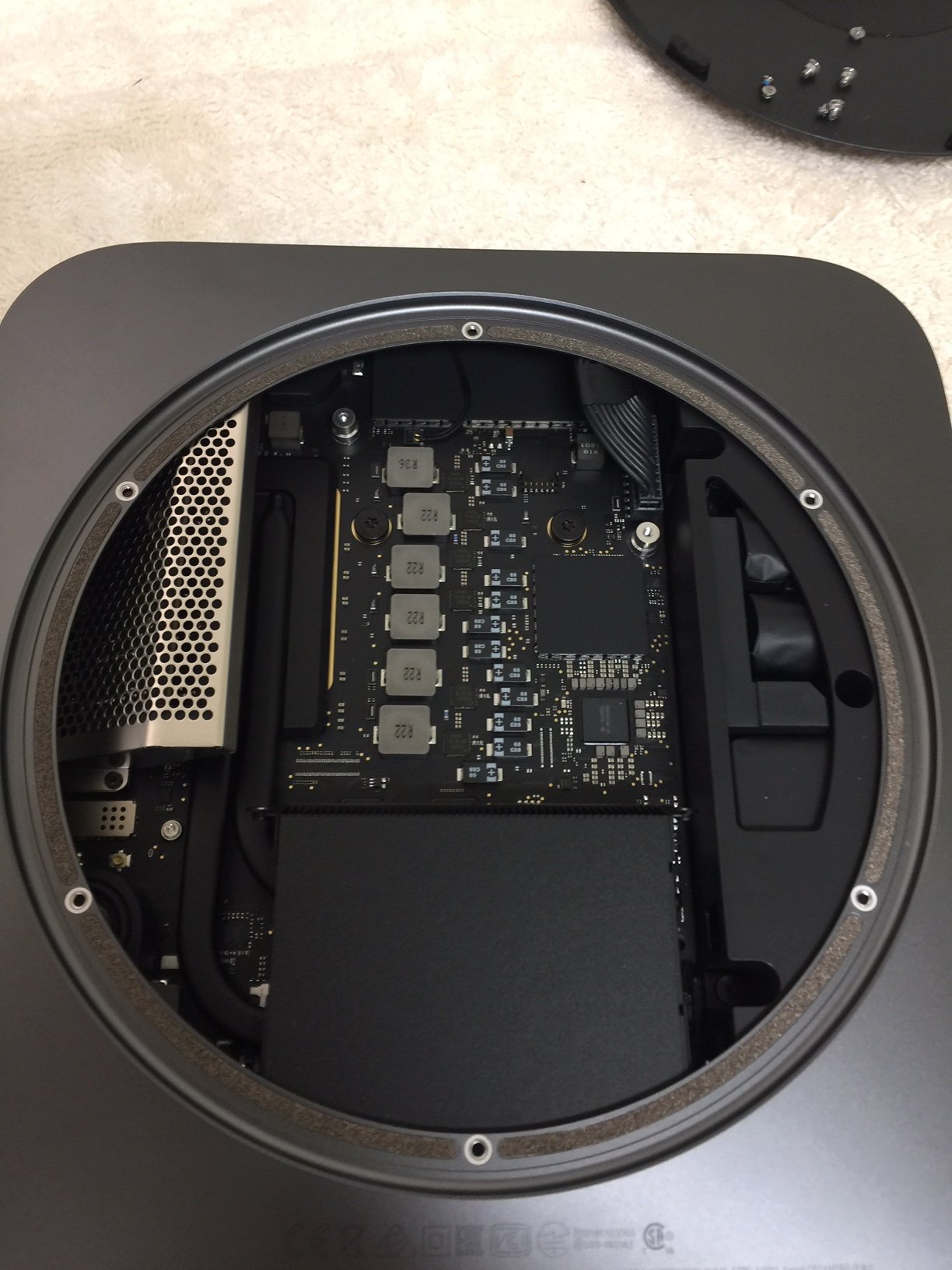

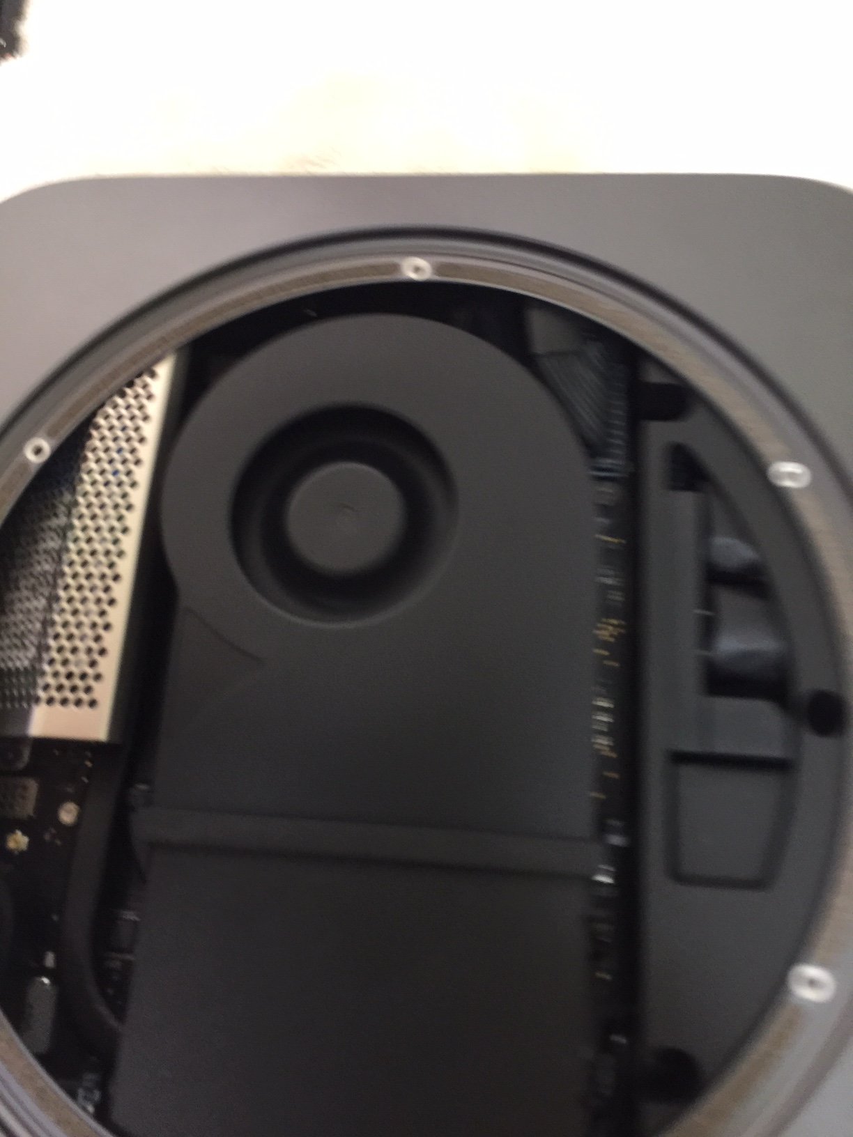

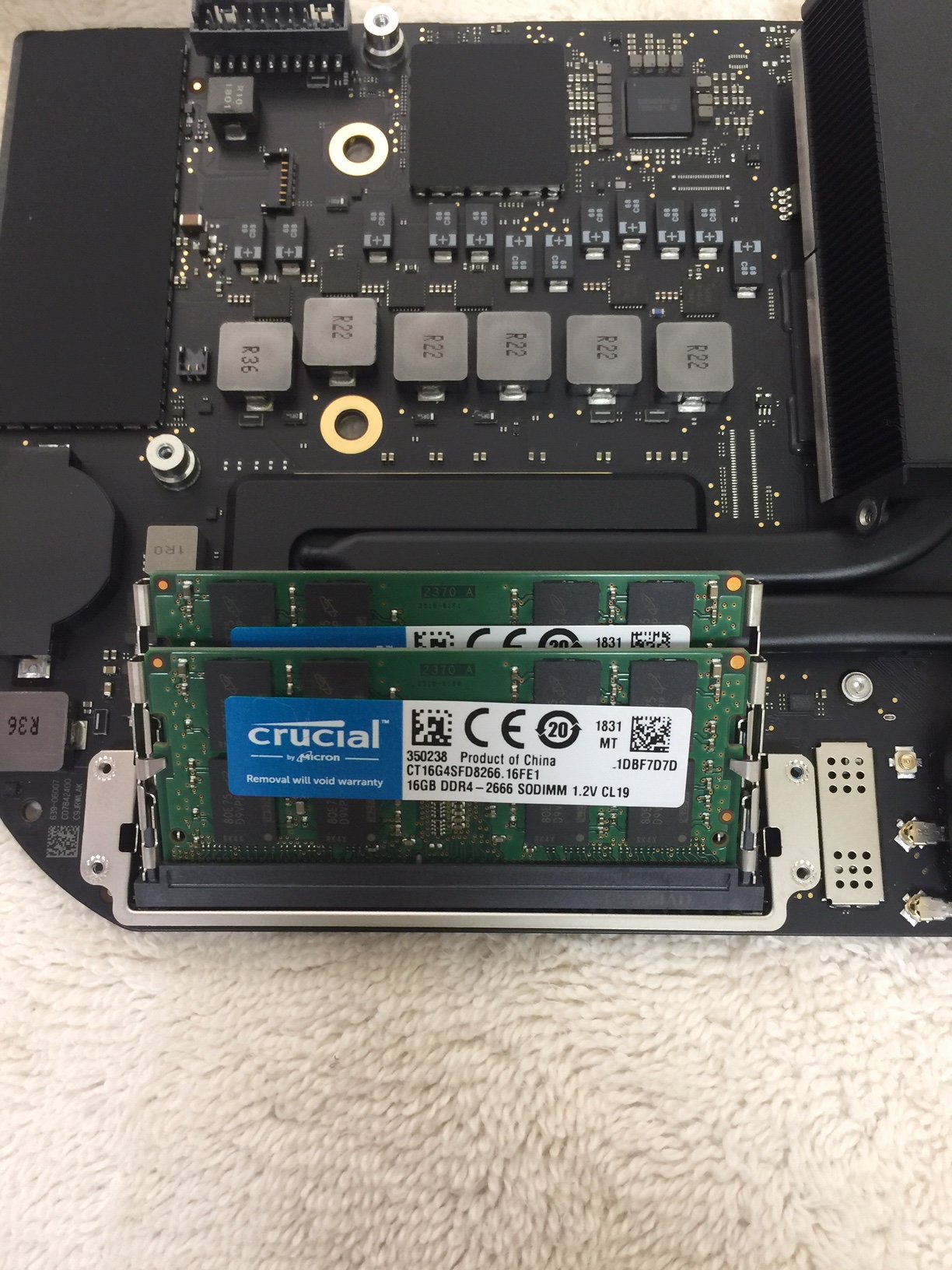

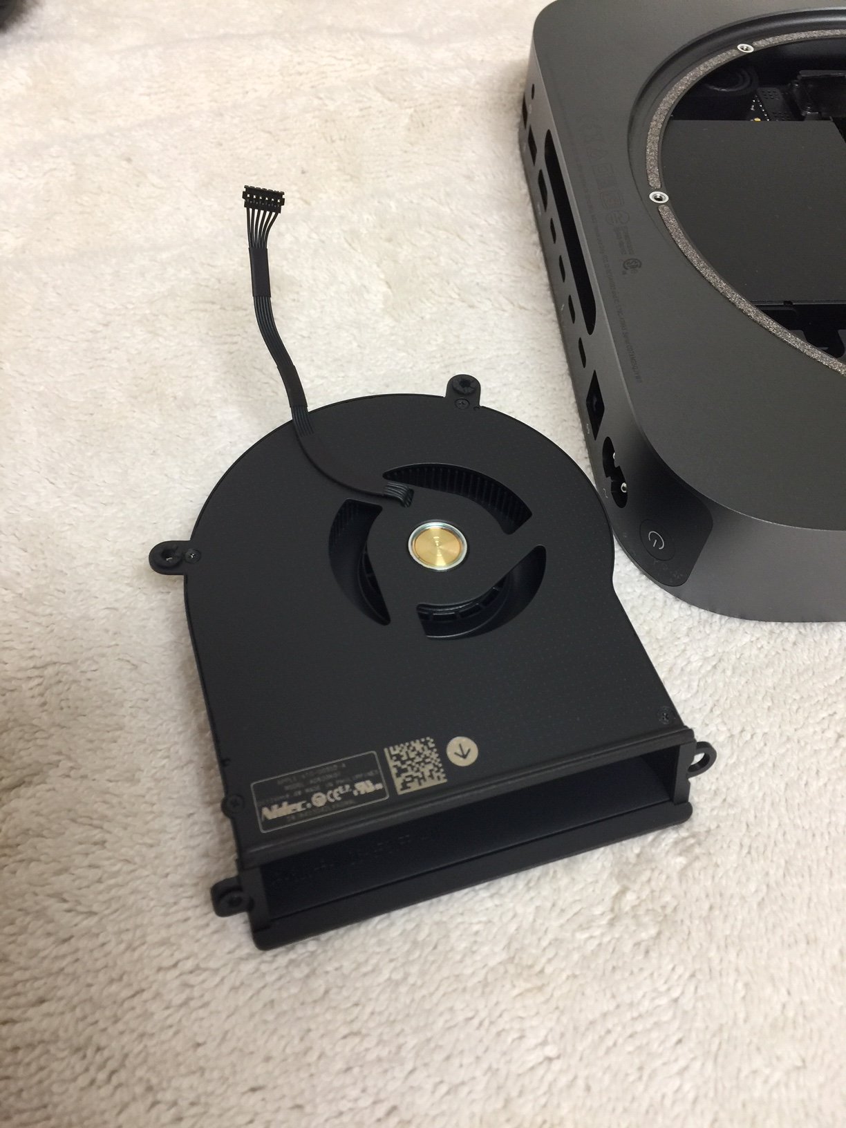

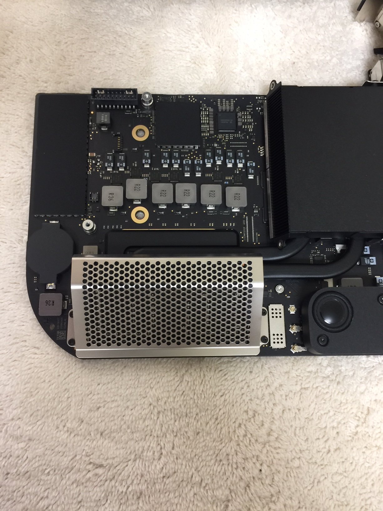

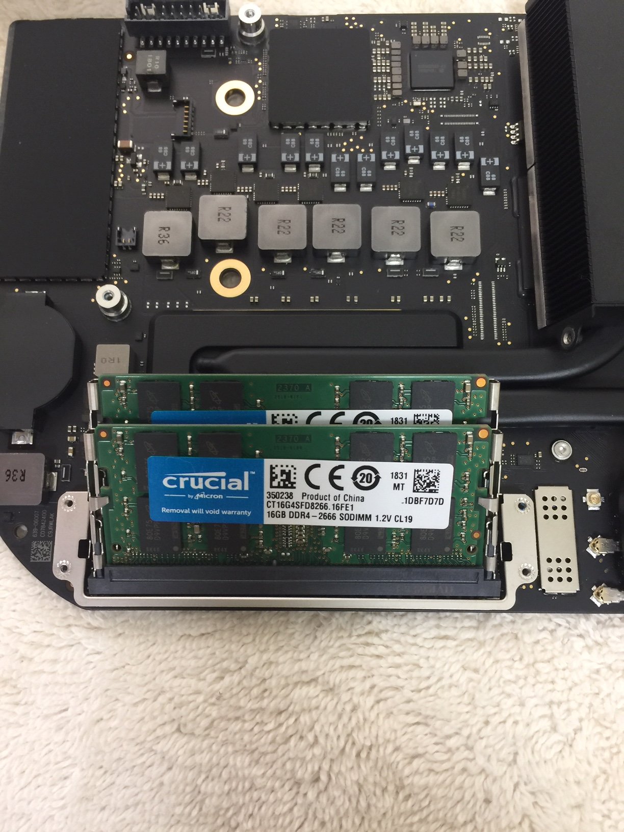

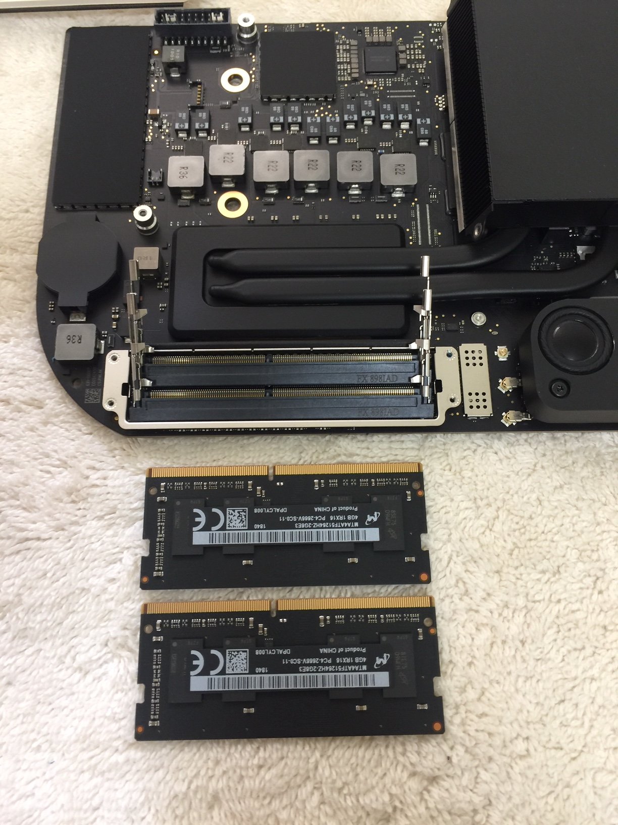

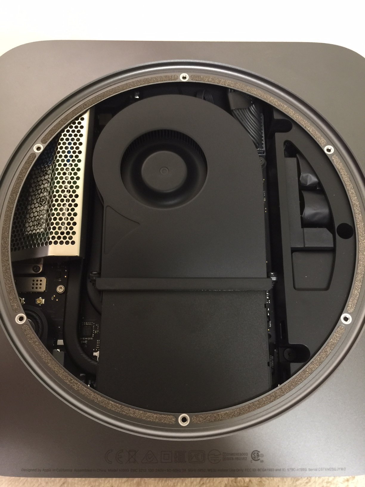

Some pics (sorry for the quality), highlighted areas wher you need to be careful.
[doublepost=1541599169][/doublepost]More:
[doublepost=1541599262][/doublepost]I will be testing it more (i5 noisem etc) but cannot spend more time on this right now, sorry folks. Hopefully you've found it useful 😉
dombera, on Your voyage to boldly go, where no one has gone before, have You spotted the SSD?
