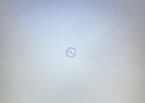

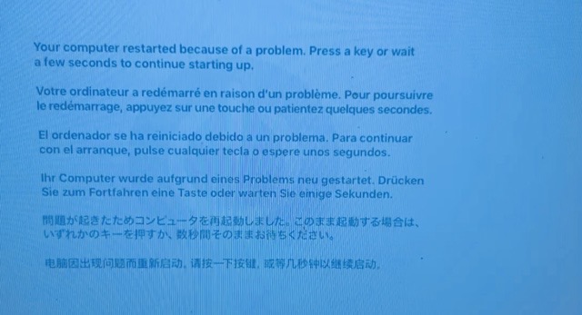

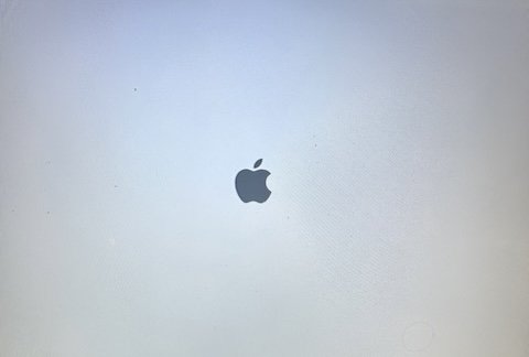

I have tried numerous times to switch on, and if I ever get past the log in, in less than a minute the first ‘problem’ pic appears, followed by the second, and then sits on apple logo till I power off. Or more often than not, it turns itself off. Nothing seems to help. I tried to start in safe, but that fails also, and I dare say would switch itself off again if it ever did.
Question being, I realise this is a 2011 MBP running High Sierra and it owes me nothing, but I’ve relied on it most days and it would be good to get something out of it. I don’t find the iPad I’m on now as easy to do stuff on at all. I’d like to think the SSD is still OK, but I’m beginning to wonder, as my last back up is a fair while ago. Any advice, other than throw it away, would be most appreciated.
I assume the problem isn’t because of the drive as it switches off and is deeper than that? Or I’d swap out drive.
Thanks for any help.

If it's 13" -- something else. A kernel panic (first image) is usually an indication of something amiss with hardware. Did you ever add RAM to this one? Does it have the original HDD, or did you install a replacement drive?

It looks like it is coming up with the Prohibitory symbol so you could try re-installing Mac OS from Recovery if you haven't tried already - https://support.apple.com/en-us/101666
Thanks, I can’t get it to stay on long enough to do that, yet.
