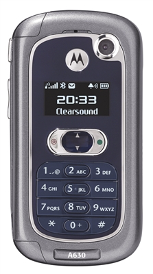

Note that you will also need an a630 graphic. I just duped one of the other tiffs in the same folder and renamed it: MOTA630.tiff but it means that in iSync, my a630 looks like a flip phone ('cause I didn't bother to find a similar model).
Does anyone have a nice a630 tiff they'd like to share?

Can't you just resize something like this and save it as tiff?
Aw, man... that graphic was a lot better than the one I just uploaded. Well, OK, here's the file to use then.
And yeah, you can basically just save anything as tiff, assuming you make it 60x60 pixels, surrounded by transparency, and save the transparency and layer information.
LOL, I thought they looked pretty much the same! 😱

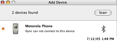

I have tried this over and over, does this only work with an usb cable.
I tried it with bluetooth and i get this.
Nope, this is for BlueTooth.
Have you already run the iSync 2.1 update?
The file I reference in step 5 of the step-by-step is the edited file from iSync 2.0. So if you're already on 2.1, perhaps that's the problem.

i have already updated it to 2.1
maybe that's the problem.
can i delete isink and copy the older version from My ibook to the g5.
and run this again.
thanks,
Here's the proper file to use for iSync 2.1.
I will edit the step-by-step instructions to link to this file.

i have done everything in this post but i am still getting the same error "isync can not connect to this device". is this because i am trying to connect with bluetooth. TOe have you been able to get isync working with bluetooth or are you using a usb cable?
knowram, this is with Bluetooth. Senseibiz, I just duplicate it and leave it the way the Finder names it (with copy in the file name).
Don't know what the trouble might be with y'all... it seems to be working just fine for me. Are you getting any errors when you try to copy the files over? Did you decompress the zip files?
Did you turn on BlueTooth Discovery on your a630? Go to Settings/Connection/Bluetooth Link/Setup/Find Me. You then have 60 seconds to find it with your Mac.

Toe, I did it. but I did it for isinc 2.0. I copy it from my ibook to my G5.
then I copy the plist files and .tiff to the applications, ............
I re-started isinc and there it was.
finally. I will keep it this way until i find out a way with 2.1
