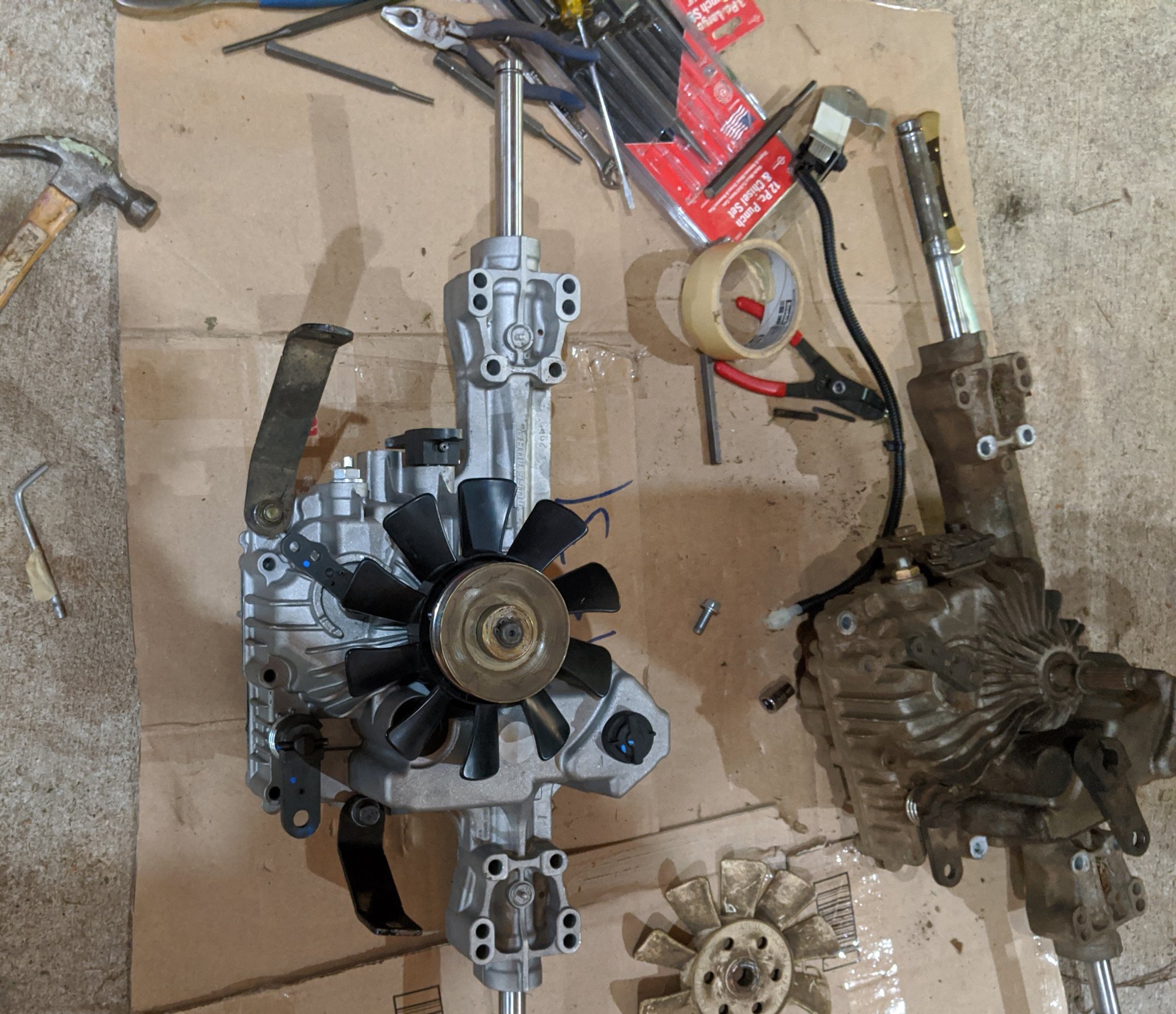

I’ve put this off long enough. Anyways, I’m just going over the mods I made not full detail of assembly and disassembly. Once you’ve made all the mods. Assembly and disassembly is nearly identical to the original transaxle.

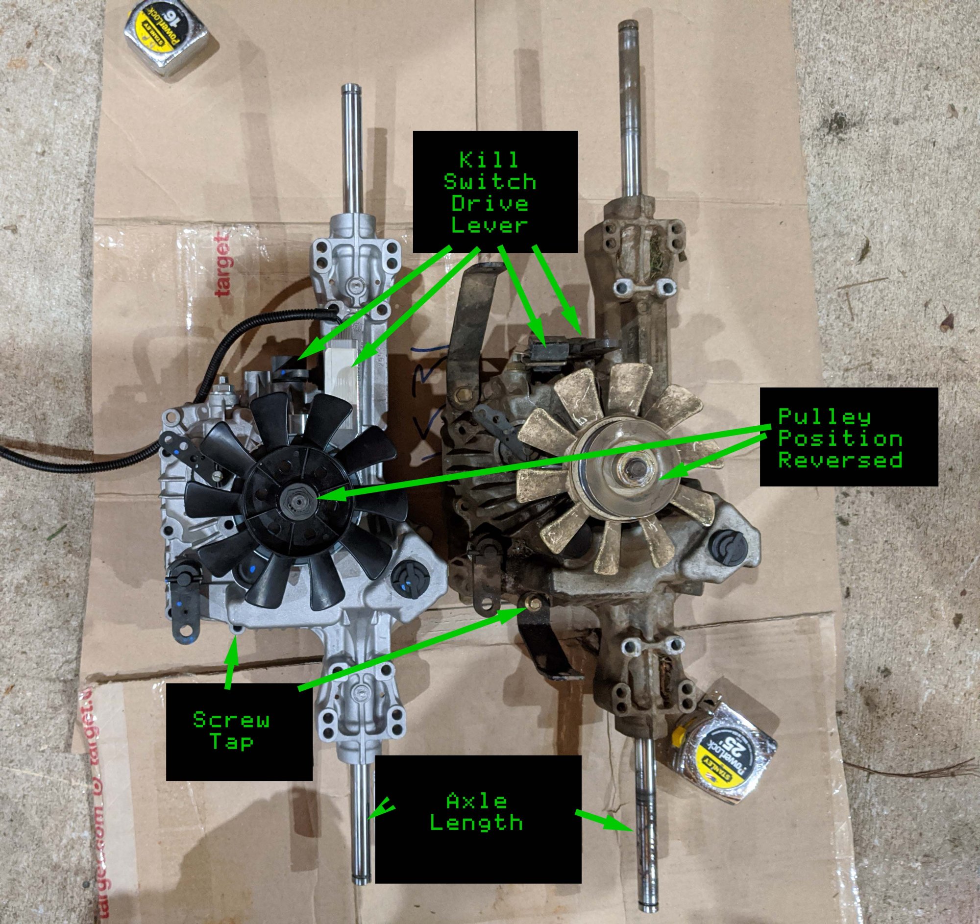

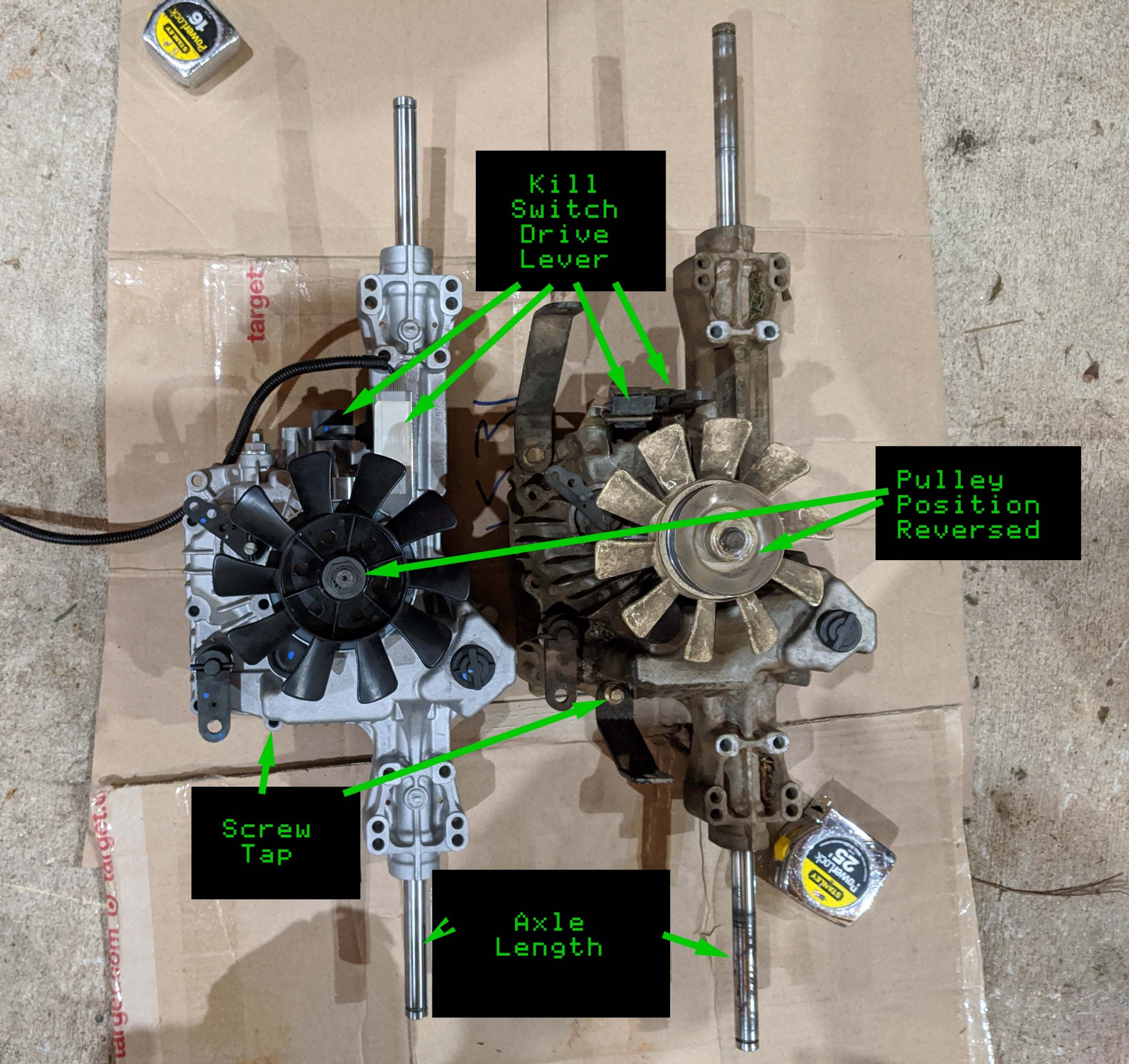

There are a few key differences between the original transmission and the Huqvarna K57
  1. Reverse Kill Switch Position
  2. Drive Lever Direction
  3. Screw Tap
  4. Pulley size and order
  5. Axle Length

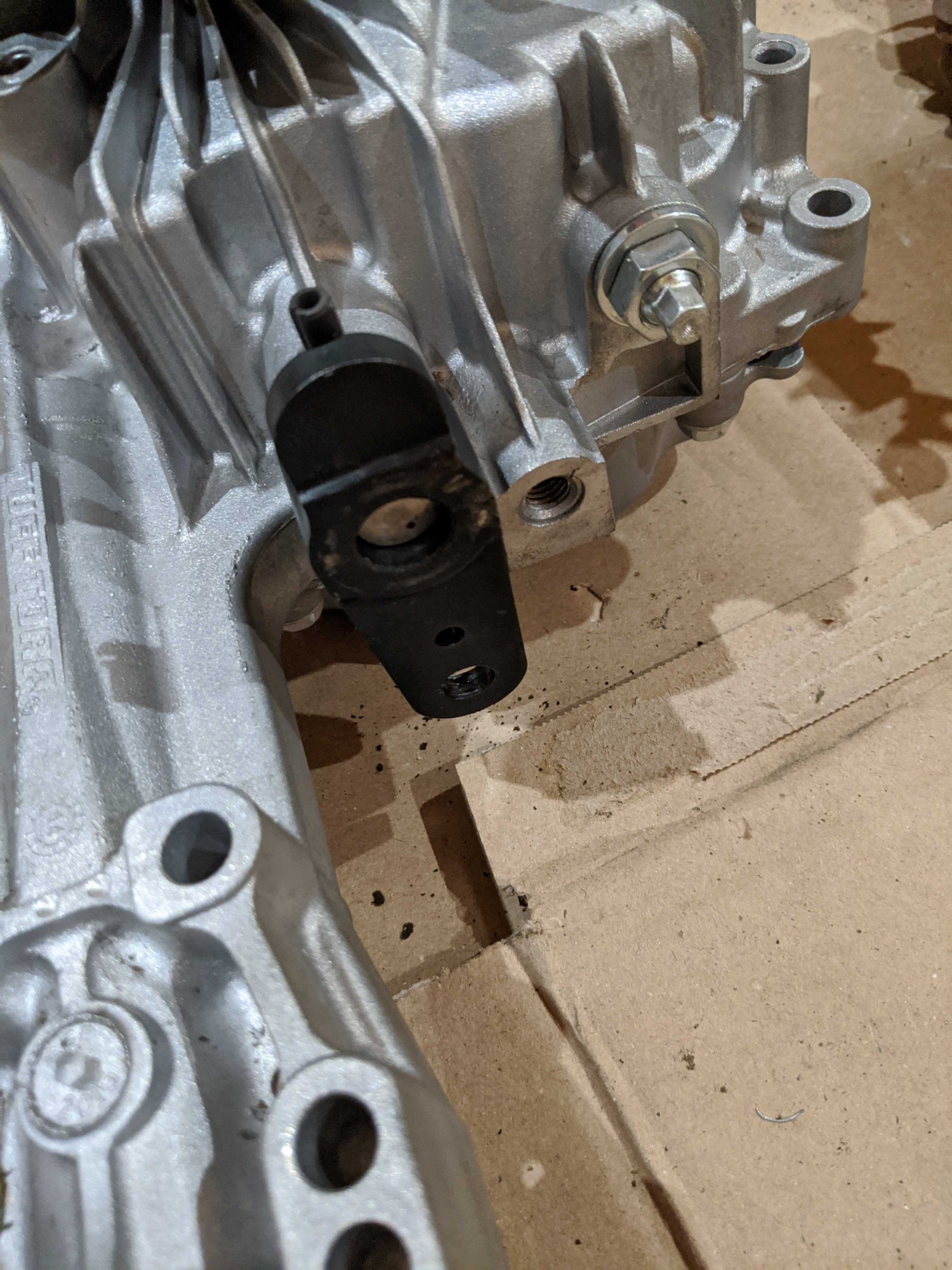

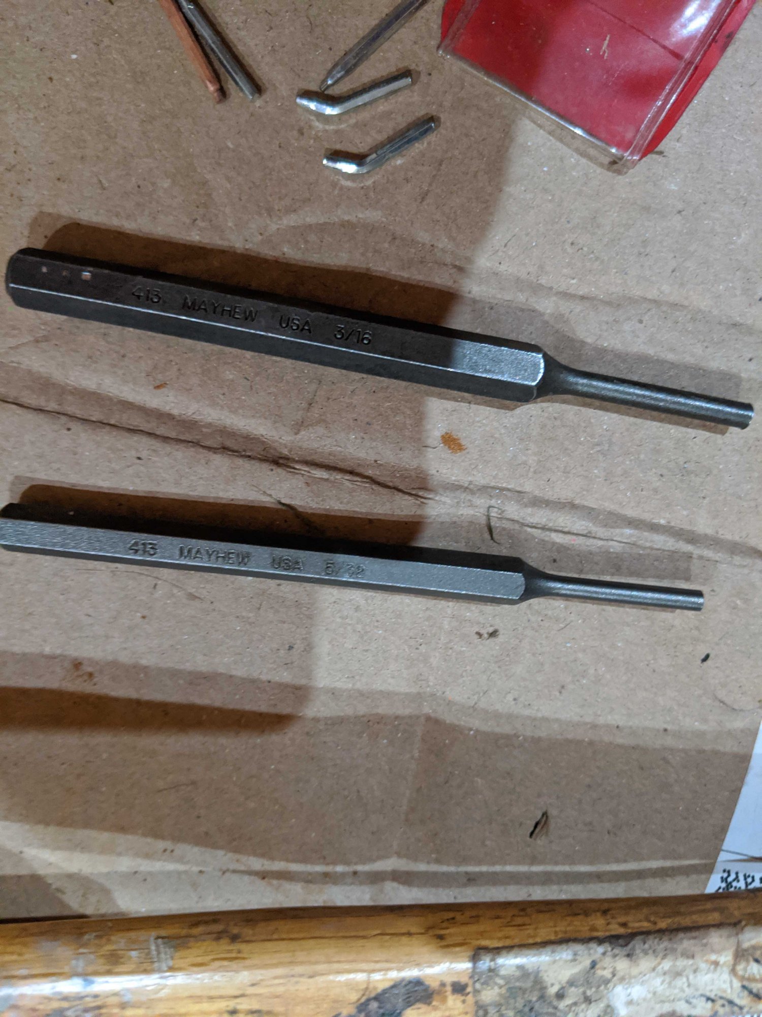

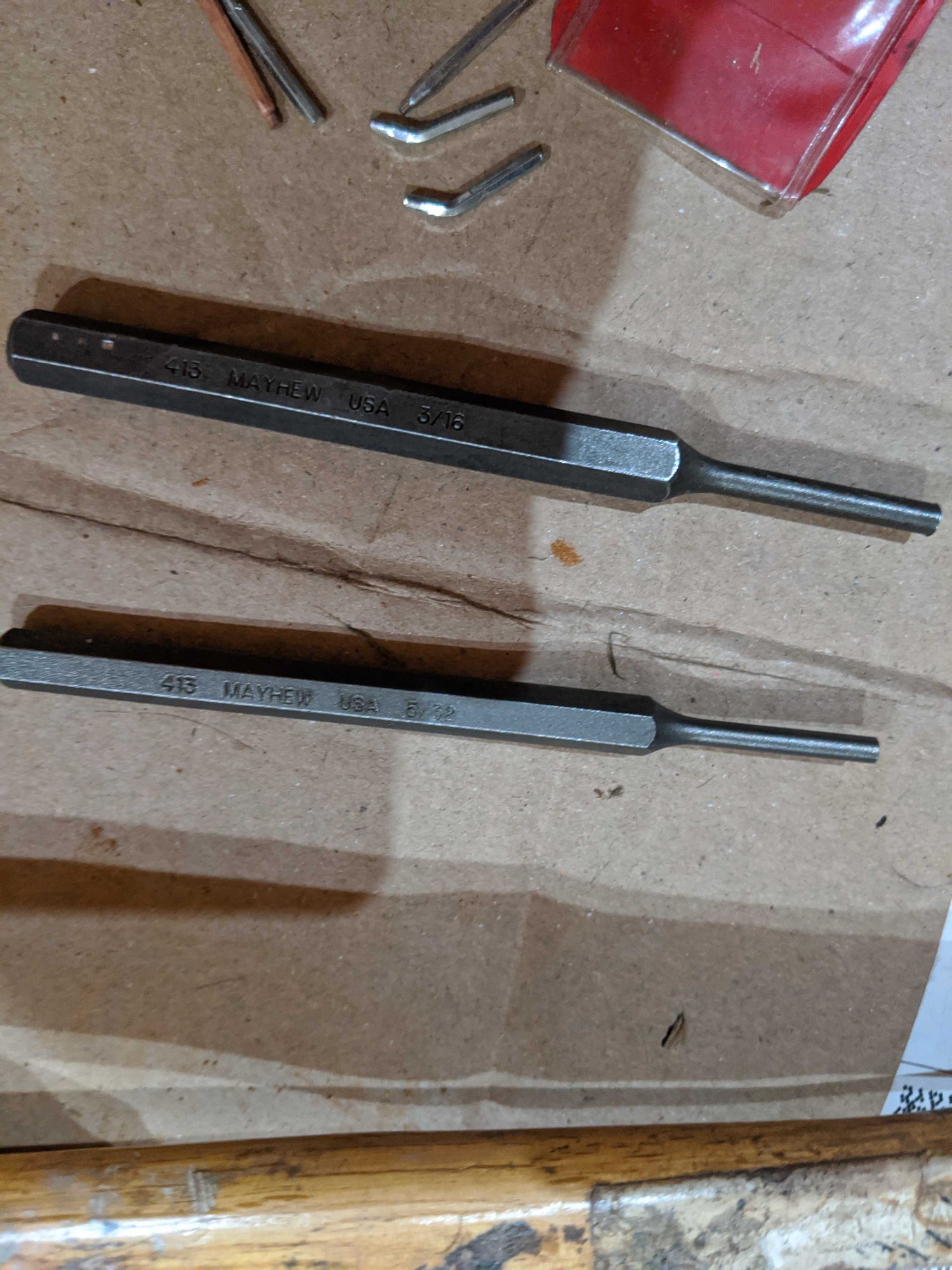

A bit of a pain. The lever is mounted with two pins. One inside another. I don’t know the technical names for these pins. I’ll just call them wedge pins. I had to remove the inner pin with a 5/32 punch and the outer pin with a 3/16 punch. Then I flipped and rotated the drive lever to face down and out to clear the transaxle housing.
This caused a secondary problem. The drive pedal linkage now rubbed against the drive belts for the mower deck. I placed this bar in a vice. Heated it with a torch and bent it where it contacted the deck belt. To make it clear the deck.

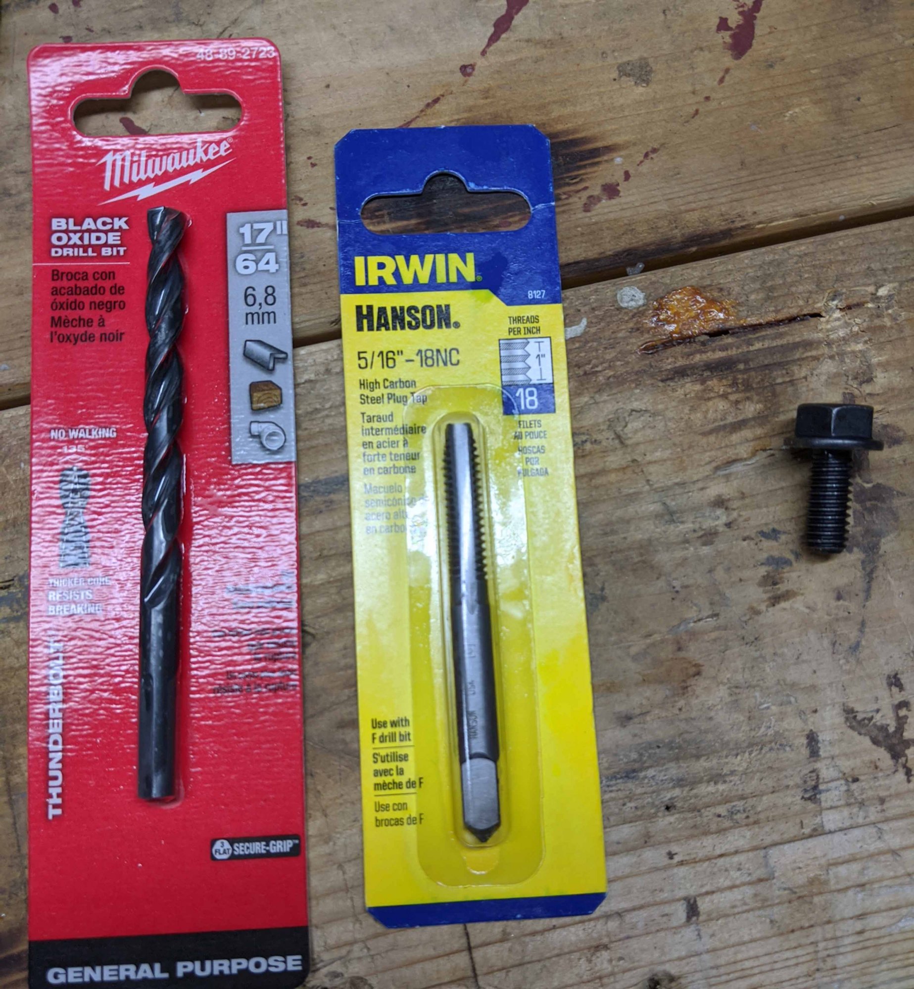

3. Screw Tap

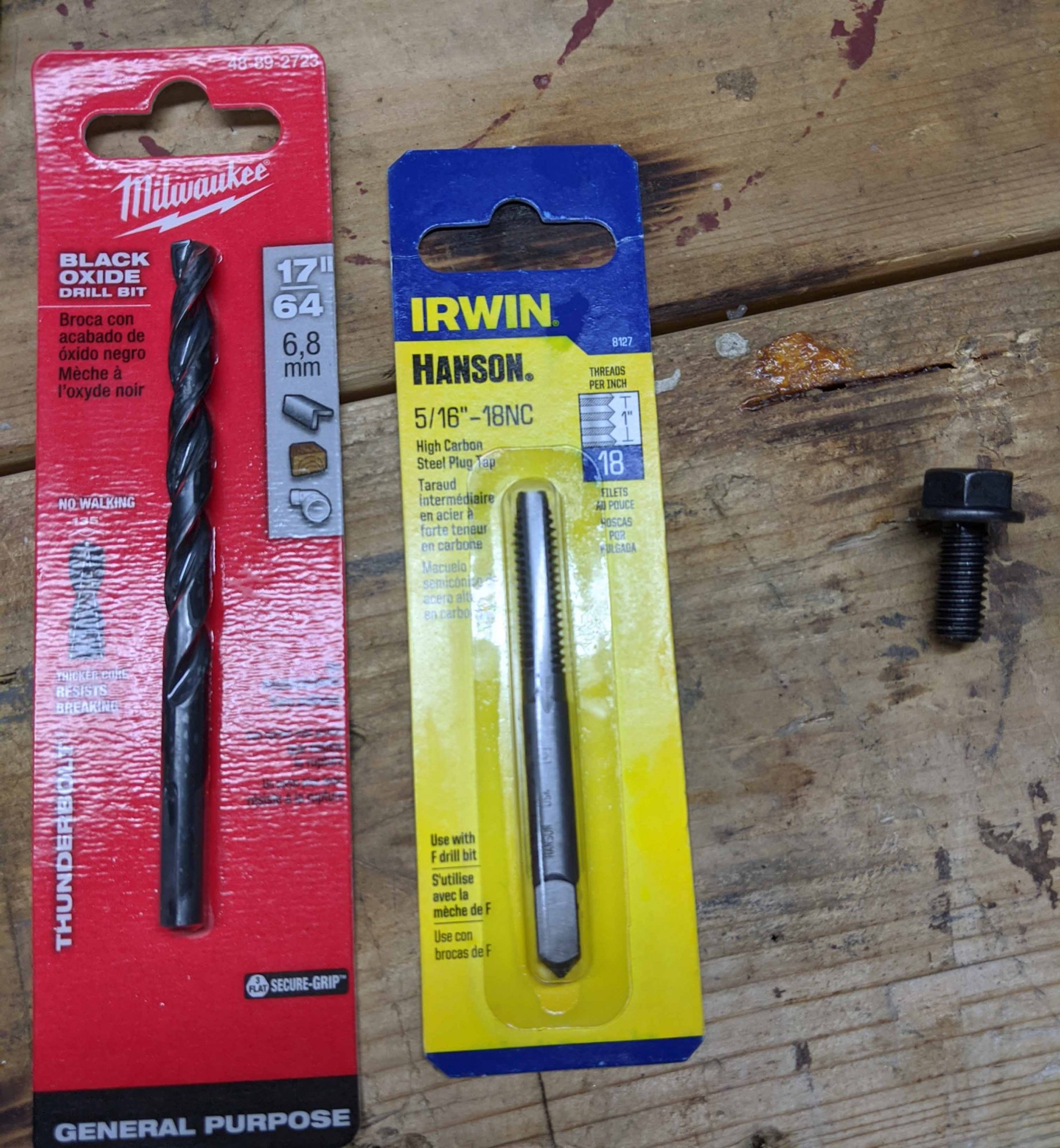

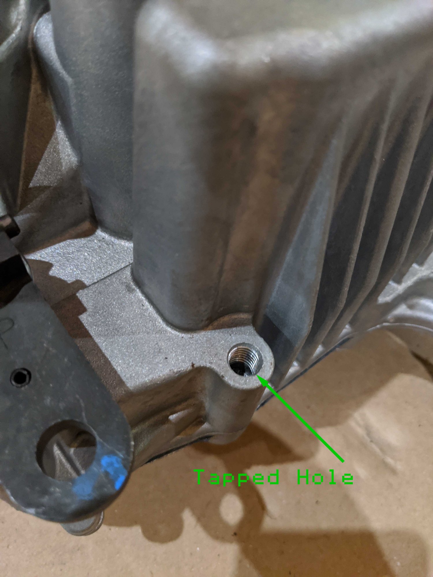

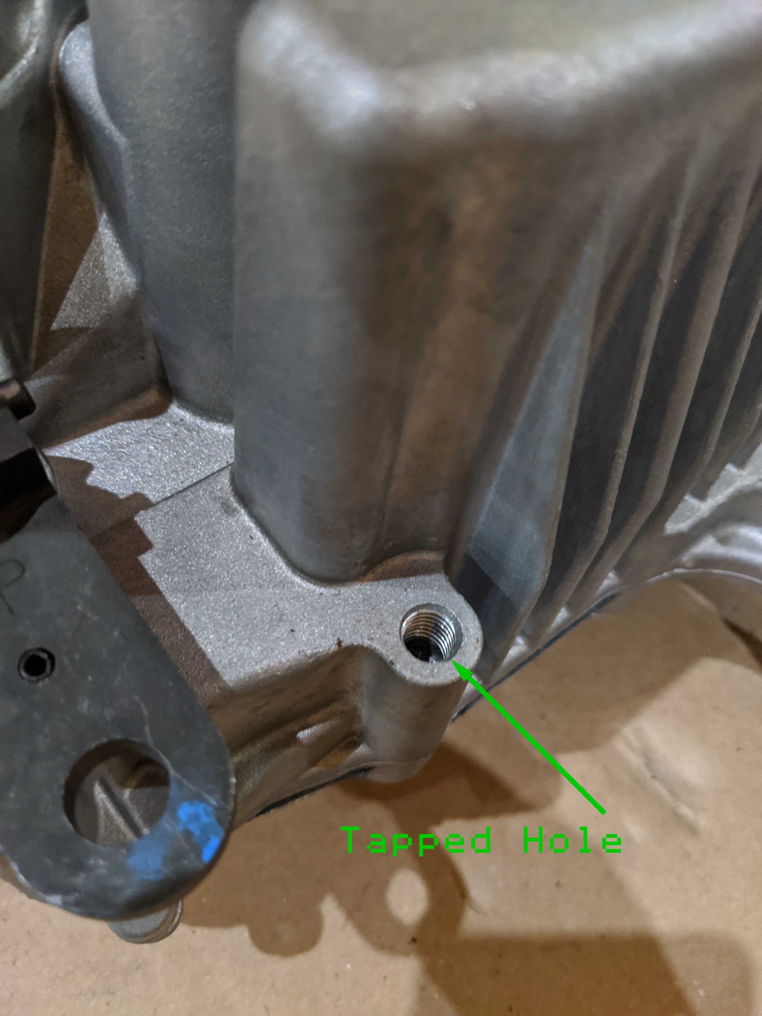

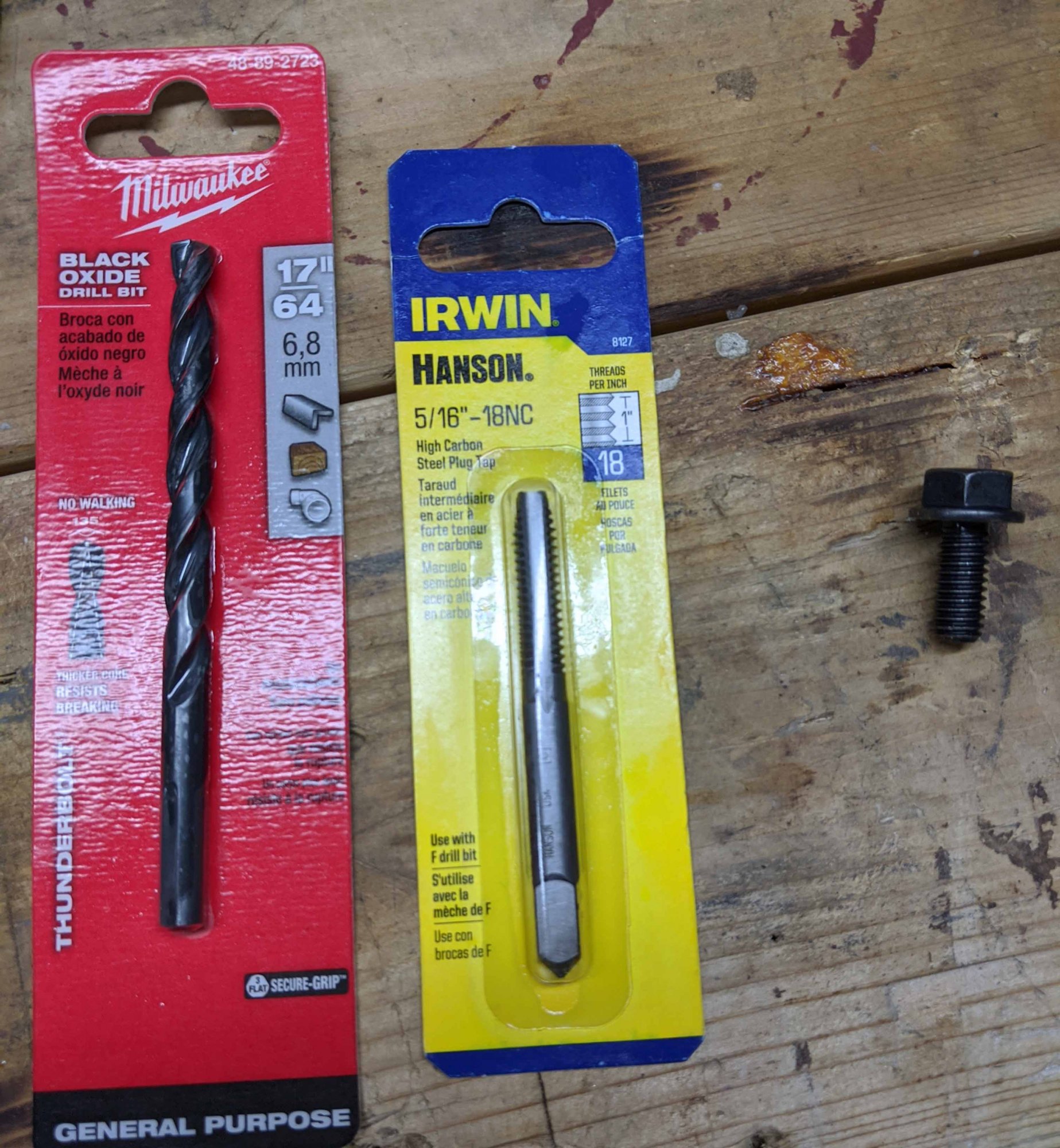

While they placed a mount hole in the new transaxle. It wasn’t threaded. Which is needed for mounting one of the frame mount bars. The original JD screw is metric but the hardware store didn’t have a metric tap in the size I needed. Thankfully a 5/16”-18NC is nearly identical. So I got the 5/16”-18NC Tap, 17/64 drill bit (which I ended up not needing) and a matching 5/16 bolt to replace the metric one. You’ll also need a tap handle if you don’t have one.
Tapping was easy as the block is aluminum. I practiced on some scrap aluminum first. Just a word of warning. This is aluminum. When tapping or finally mounting the frame mount. Don’t over tighten. Those threads will strip. I didn’t have this issue as I was careful.

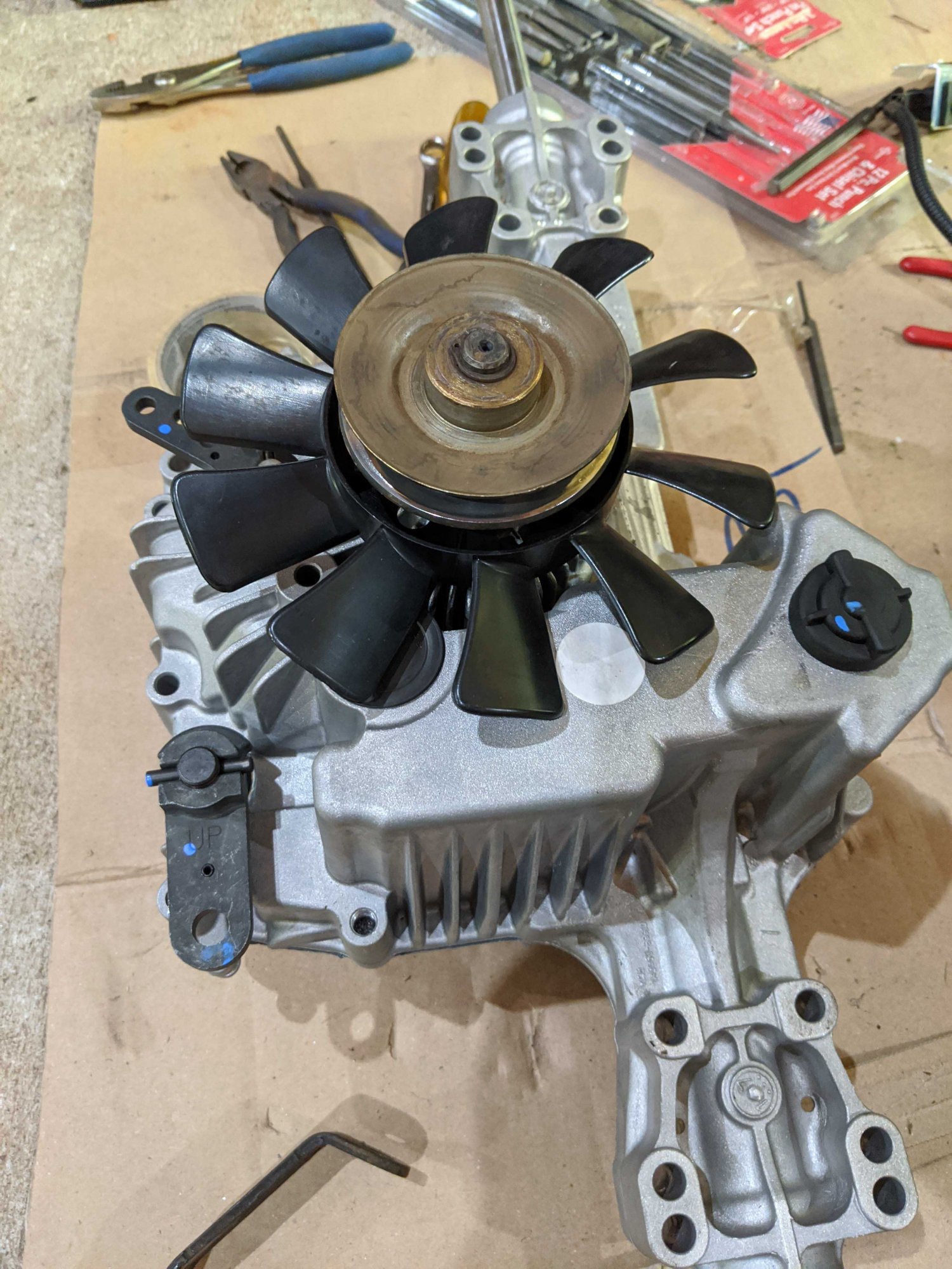

4. Pulley size and order.
The K57R came with a large diameter pulley and the pulley/fan order was reversed. Thankfully the shaft size and keying is the same. I just moved over the JD pulley and placed them in the correct order. You’ll need snap ring pliers

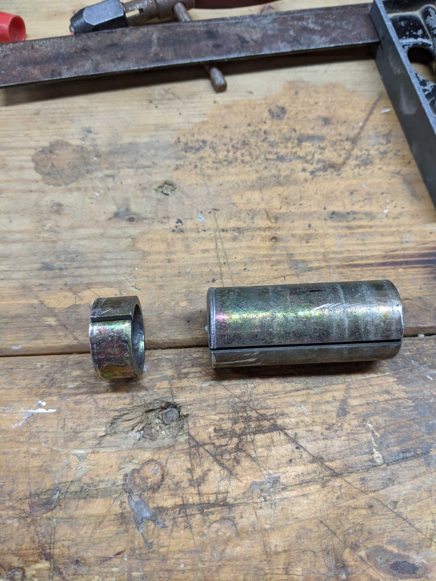

5. Axle Length
The K57R has a shorter axle. To correct for this. I had to shorten the spacers between the transaxle and rims. This caused a secondary issue. The left wheel now rubs against the deck height adjustment lever.

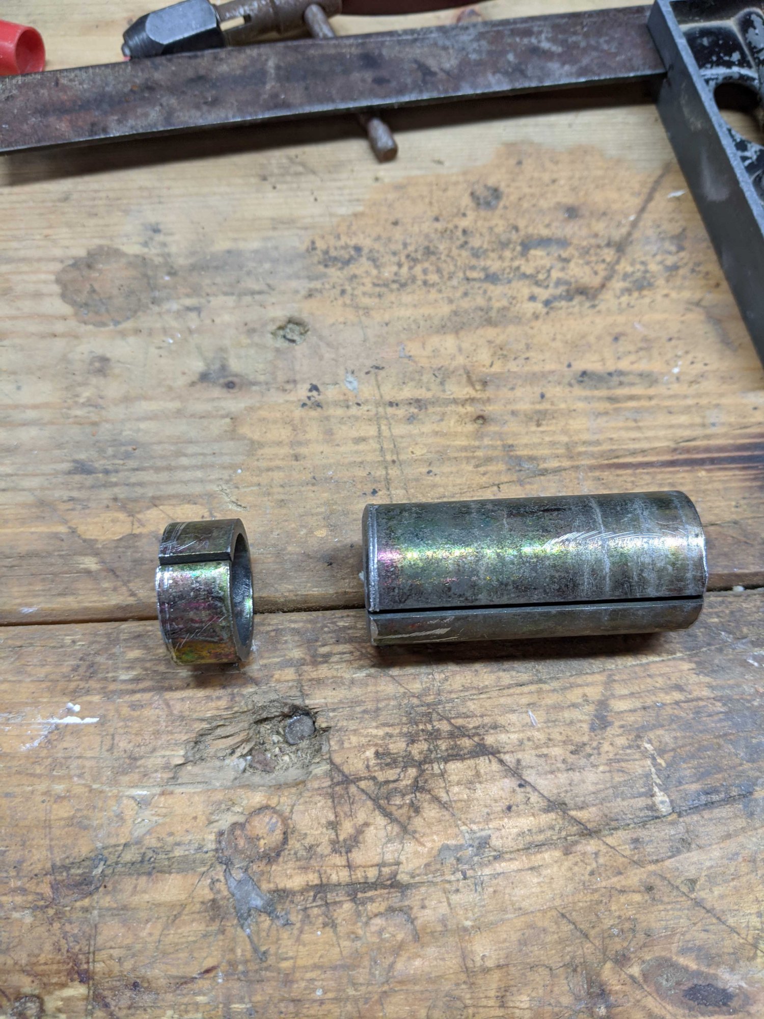

To fix the rubbing issue. I cut a notch out of the tube of the lever to allow it to sit closer to the frame with a right angle grinder. I also shortened the keeper pin and drilled a new hole for the cotter pin. To make centering your drill bit easier I used the angle grinder to notch it. Finally I filed the edges to round them off.

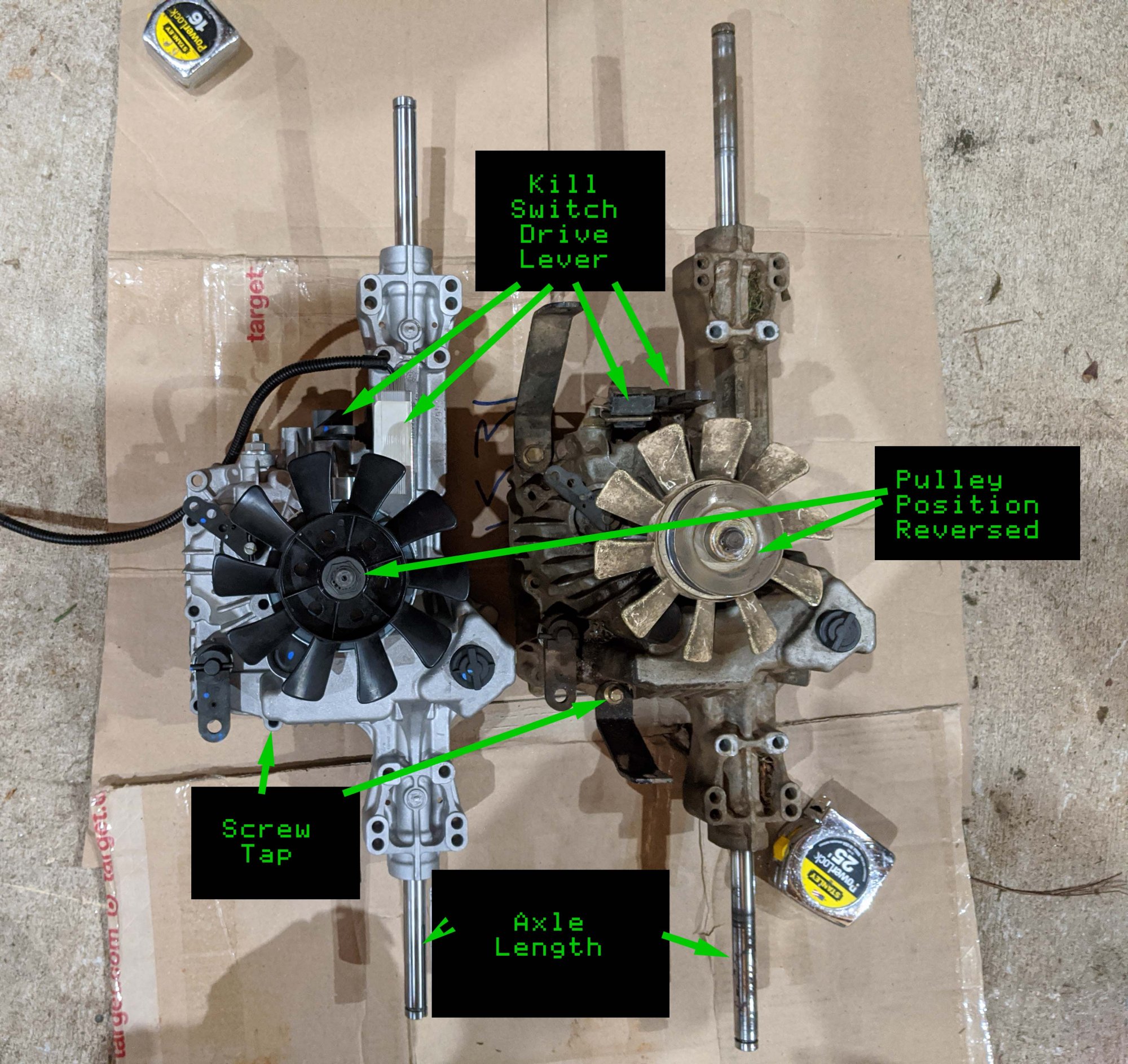

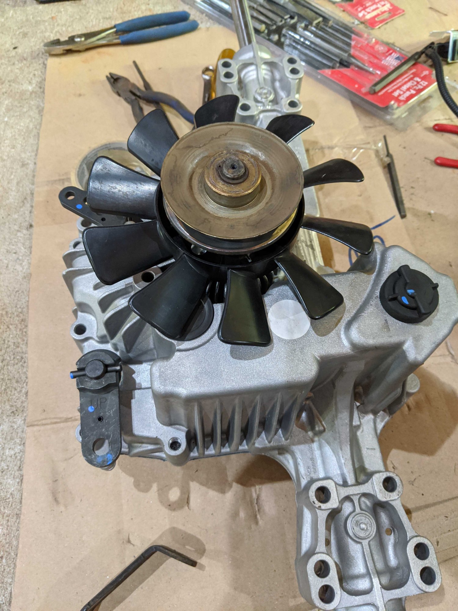

Tools Used
  • Right Angle Grinder
  • Vice
  • Propane Torch
  • Snap Ring Pliers
  • Drill and Tap
  • Hammer
  • Punches
  • Metal File
  3. Screw Tap
  5. Axle Length
This was the easiest to deal with. I don’t have any use for it.I just removed it. Problem solved.

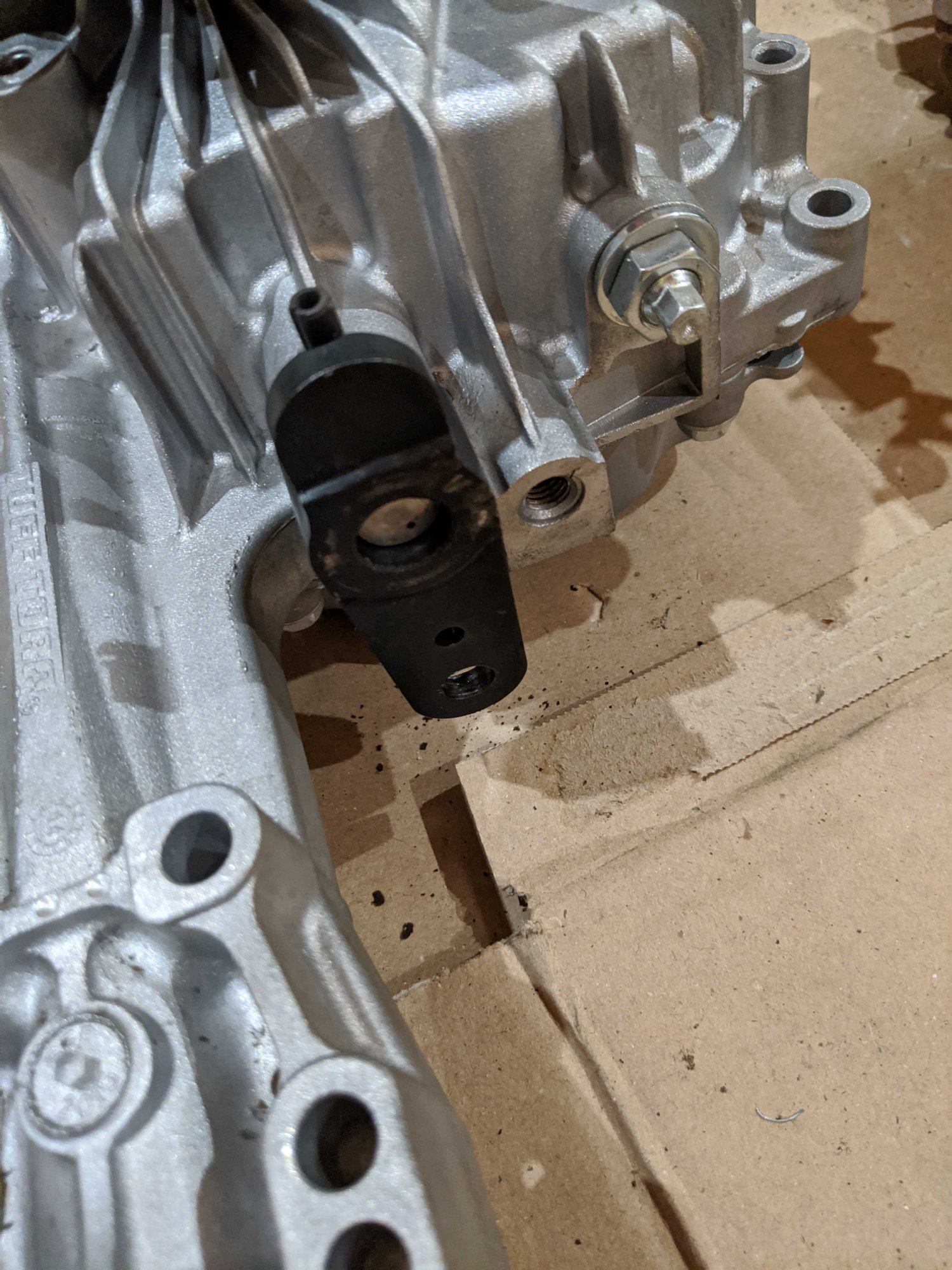

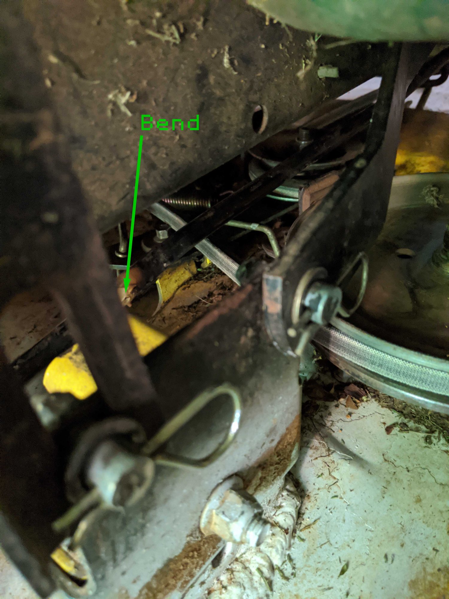

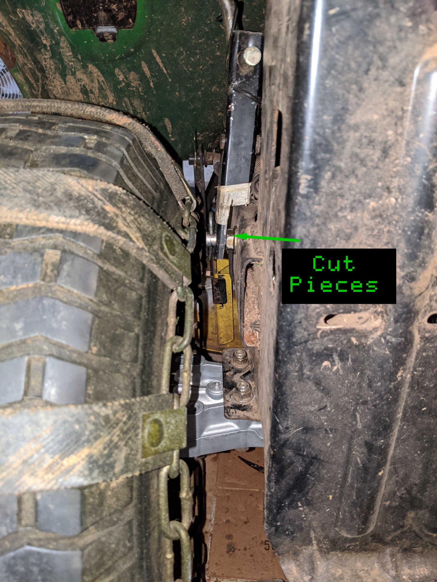

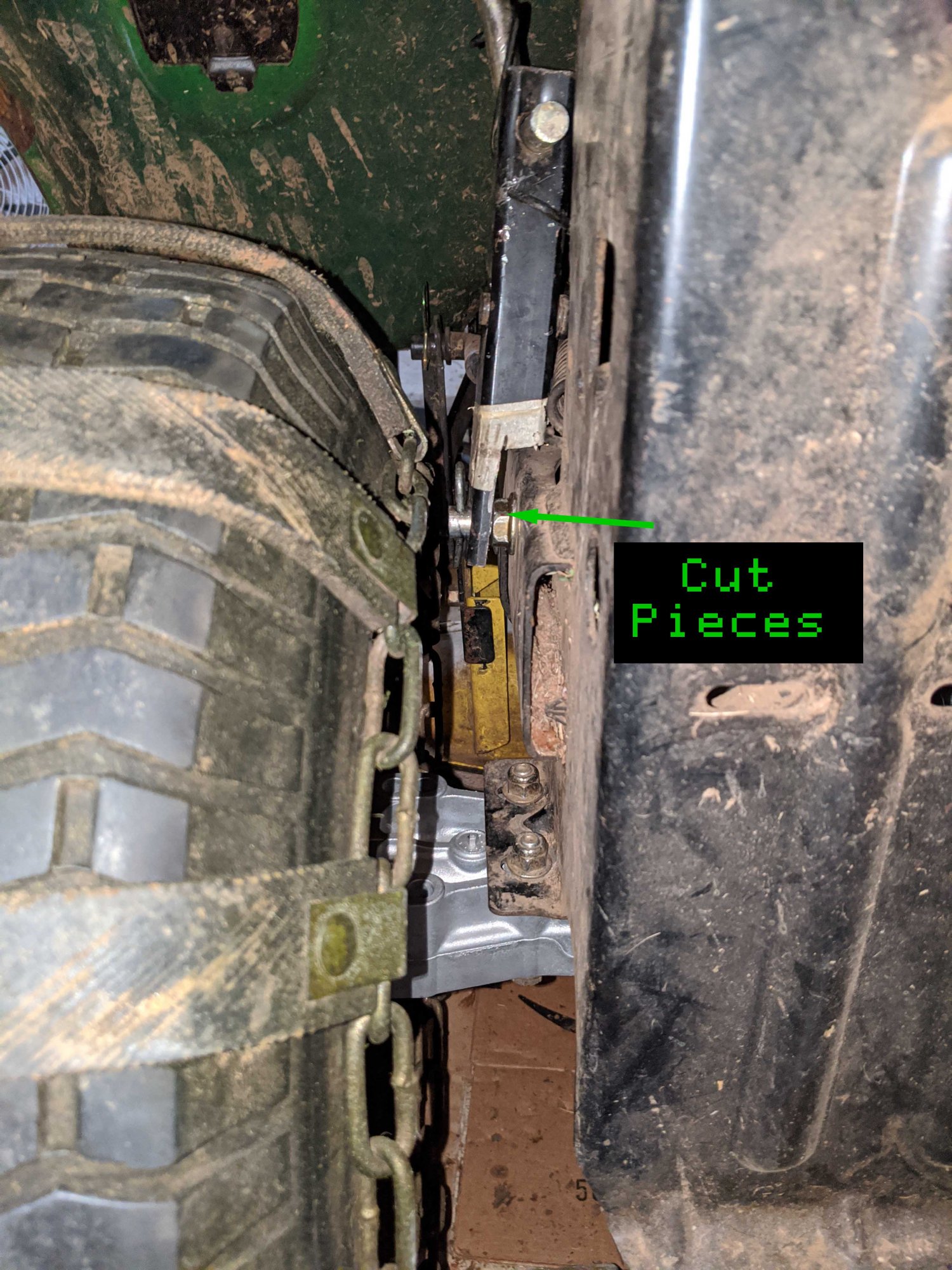

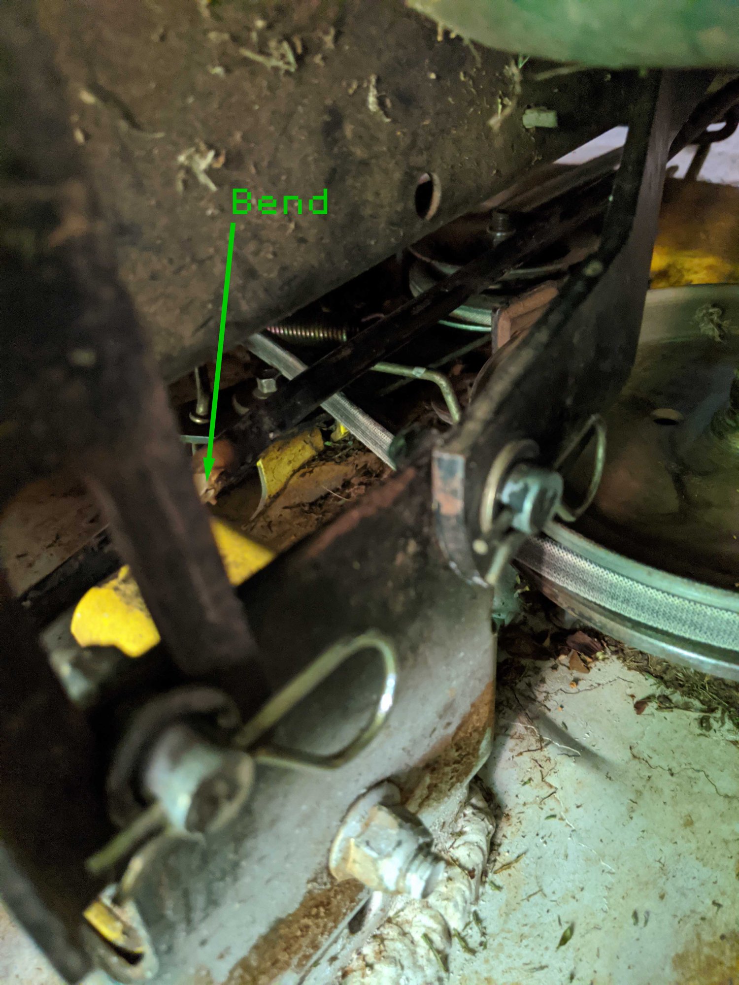

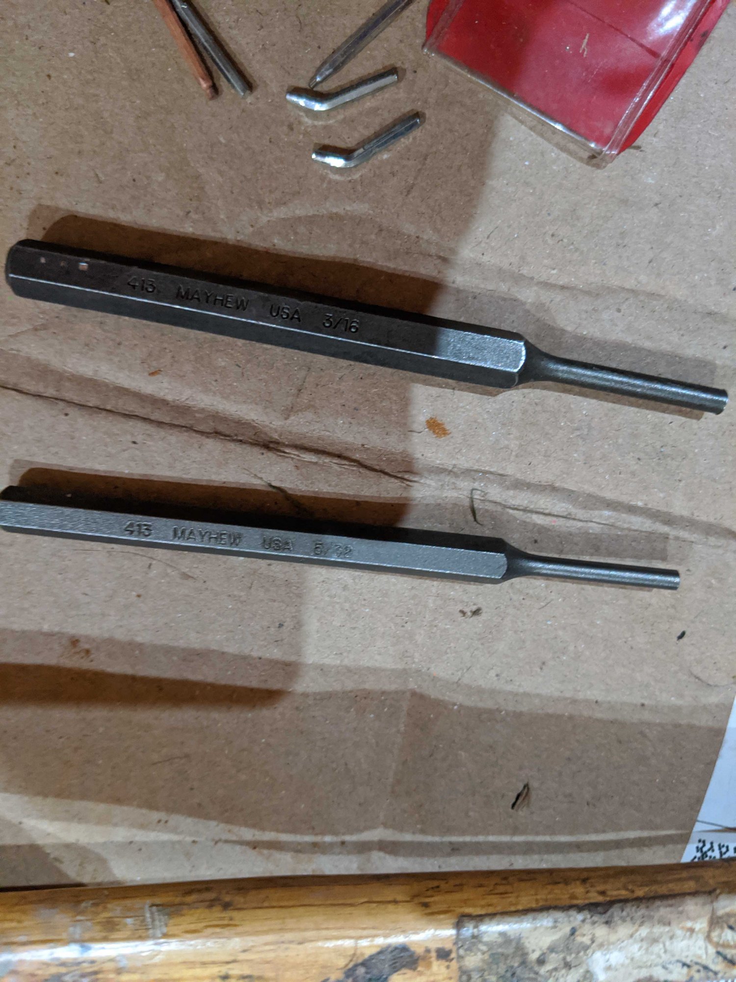

View attachment 961459View attachment 961460View attachment 961462

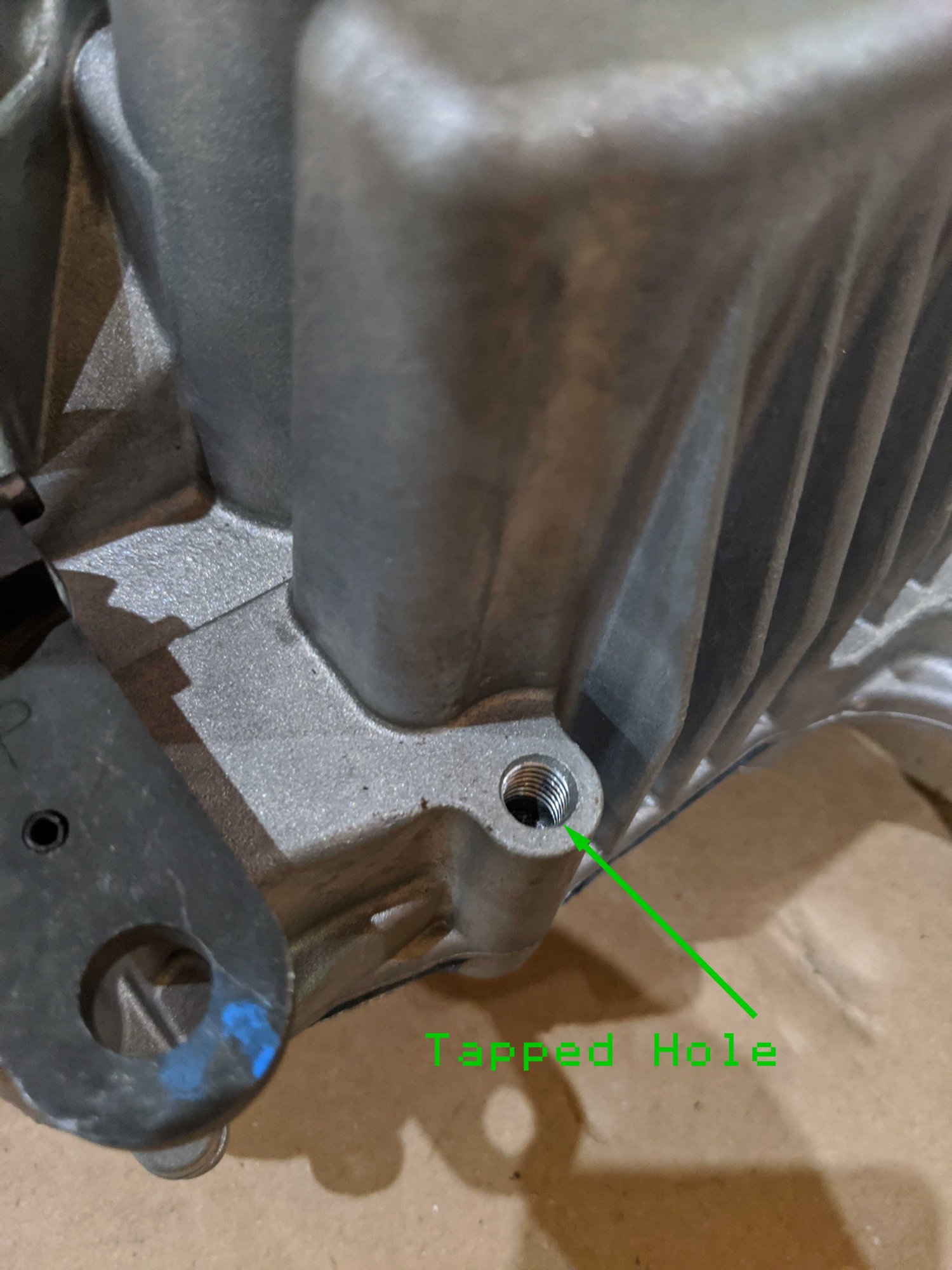

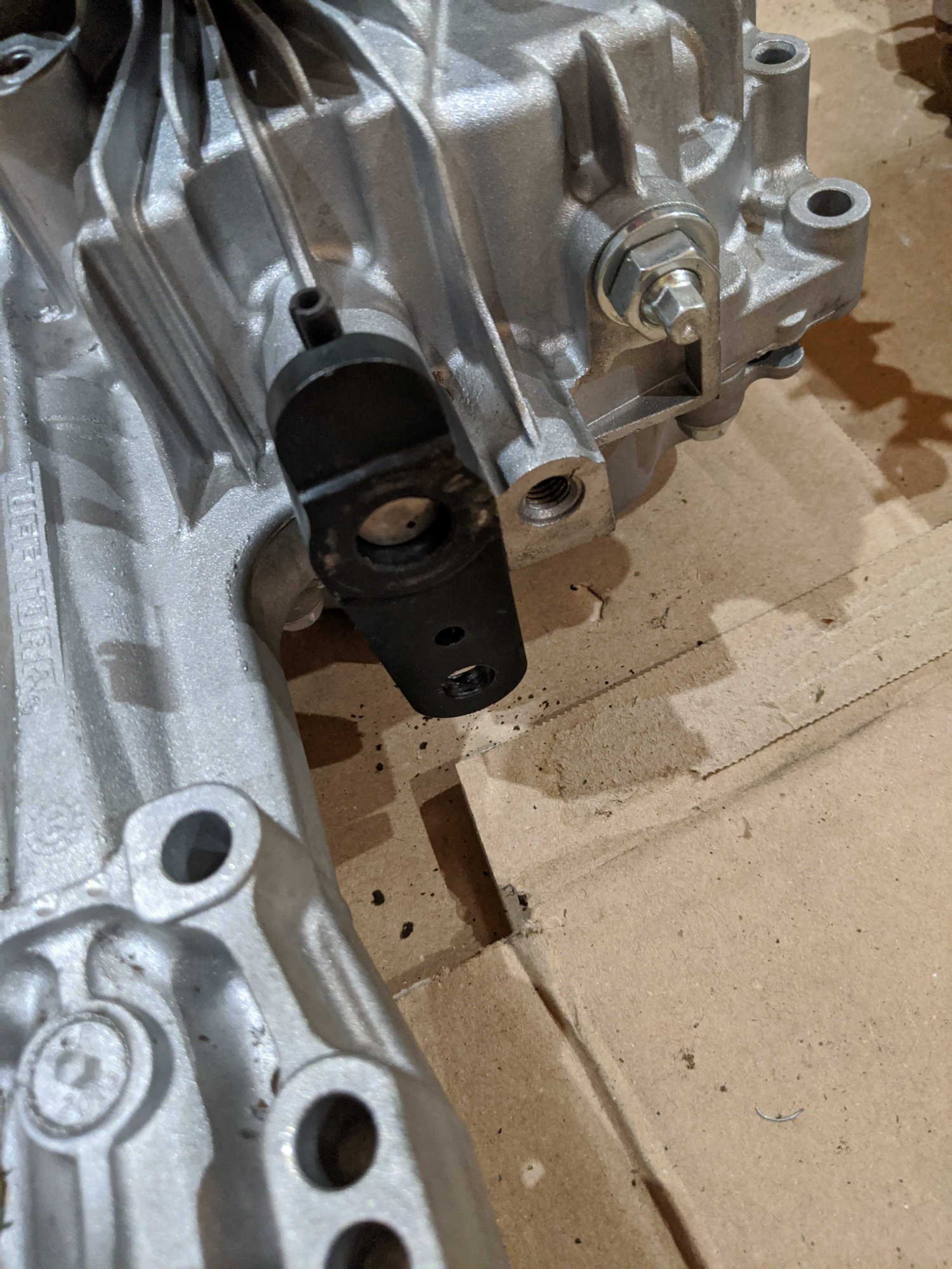

3. Screw Tap
View attachment 961461View attachment 961463

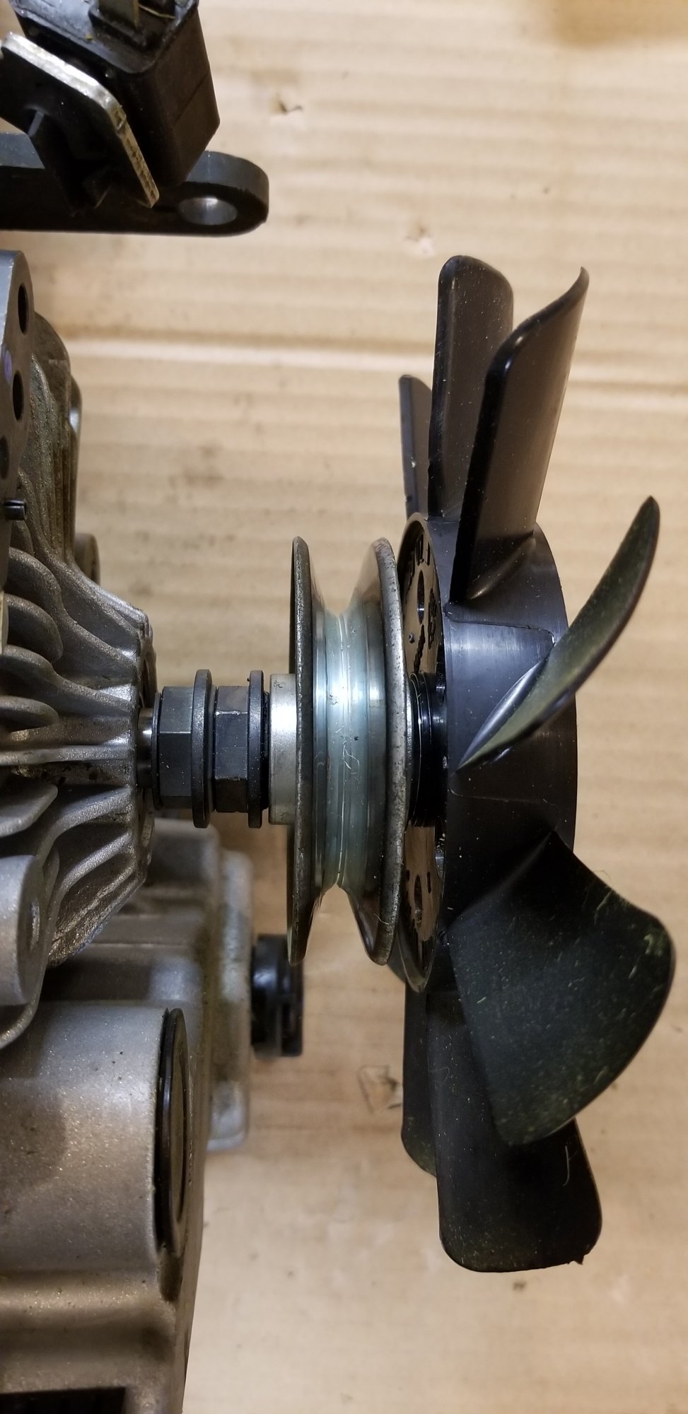

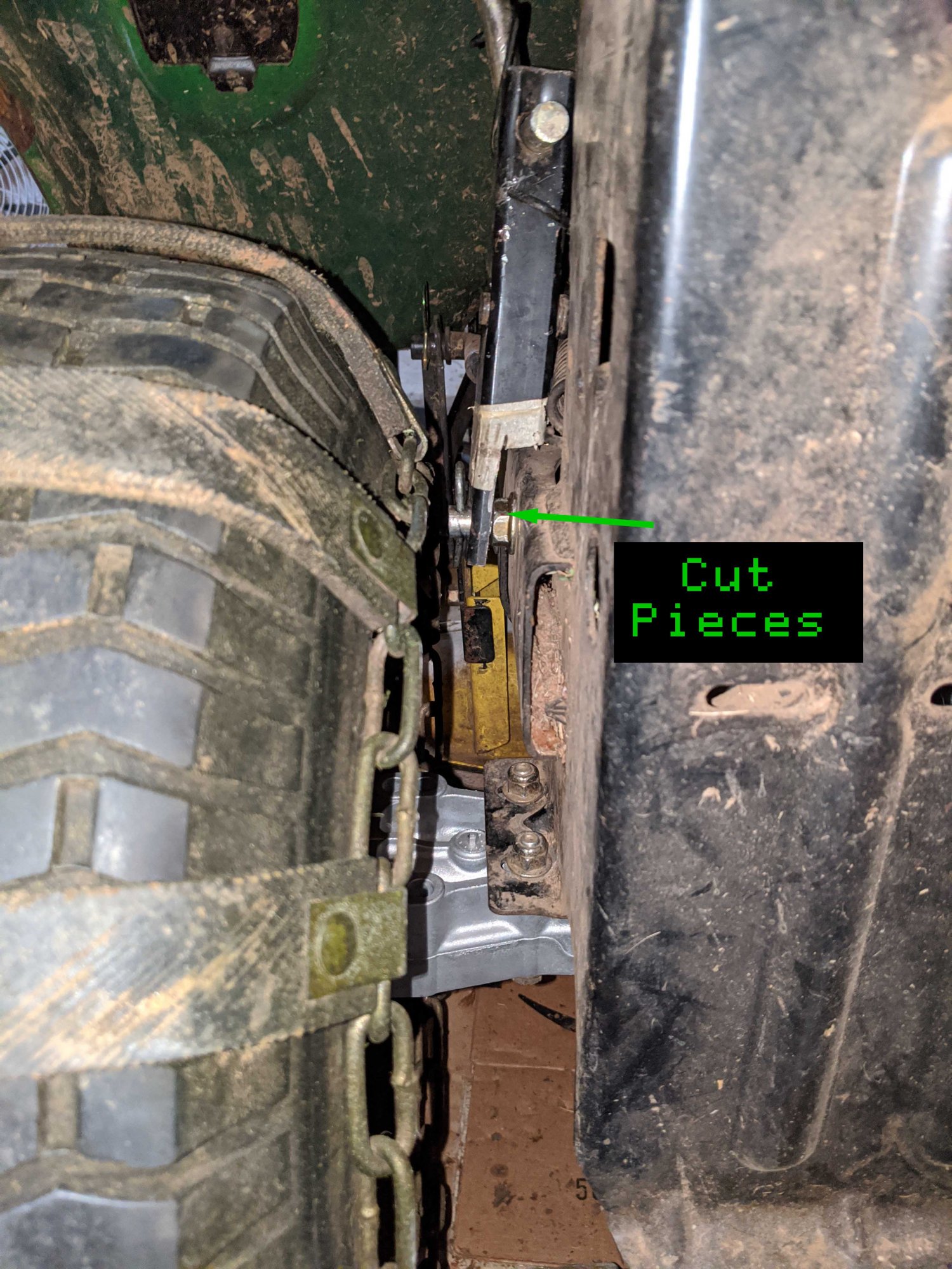

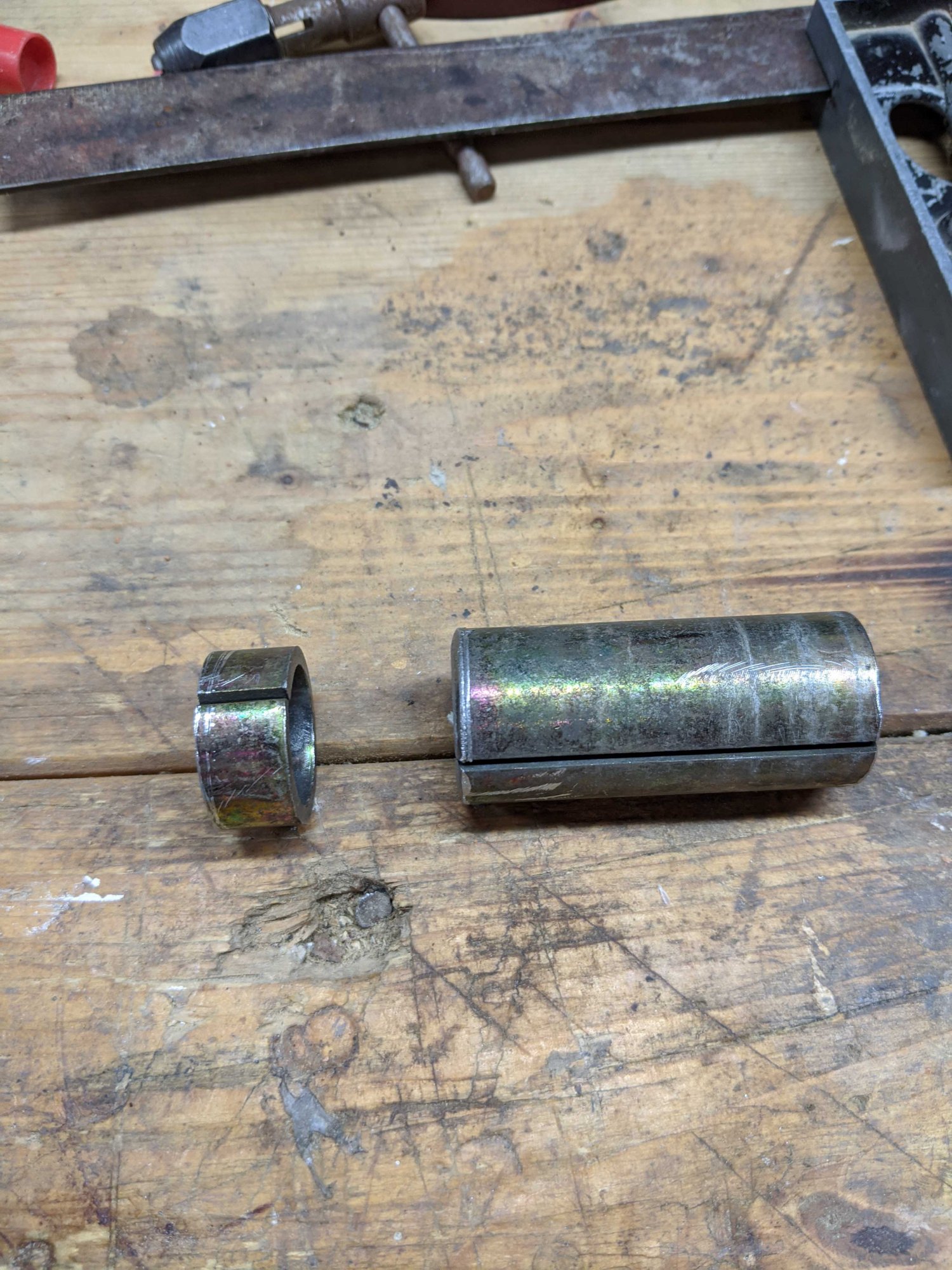

5. Axle Length
View attachment 961465View attachment 961466

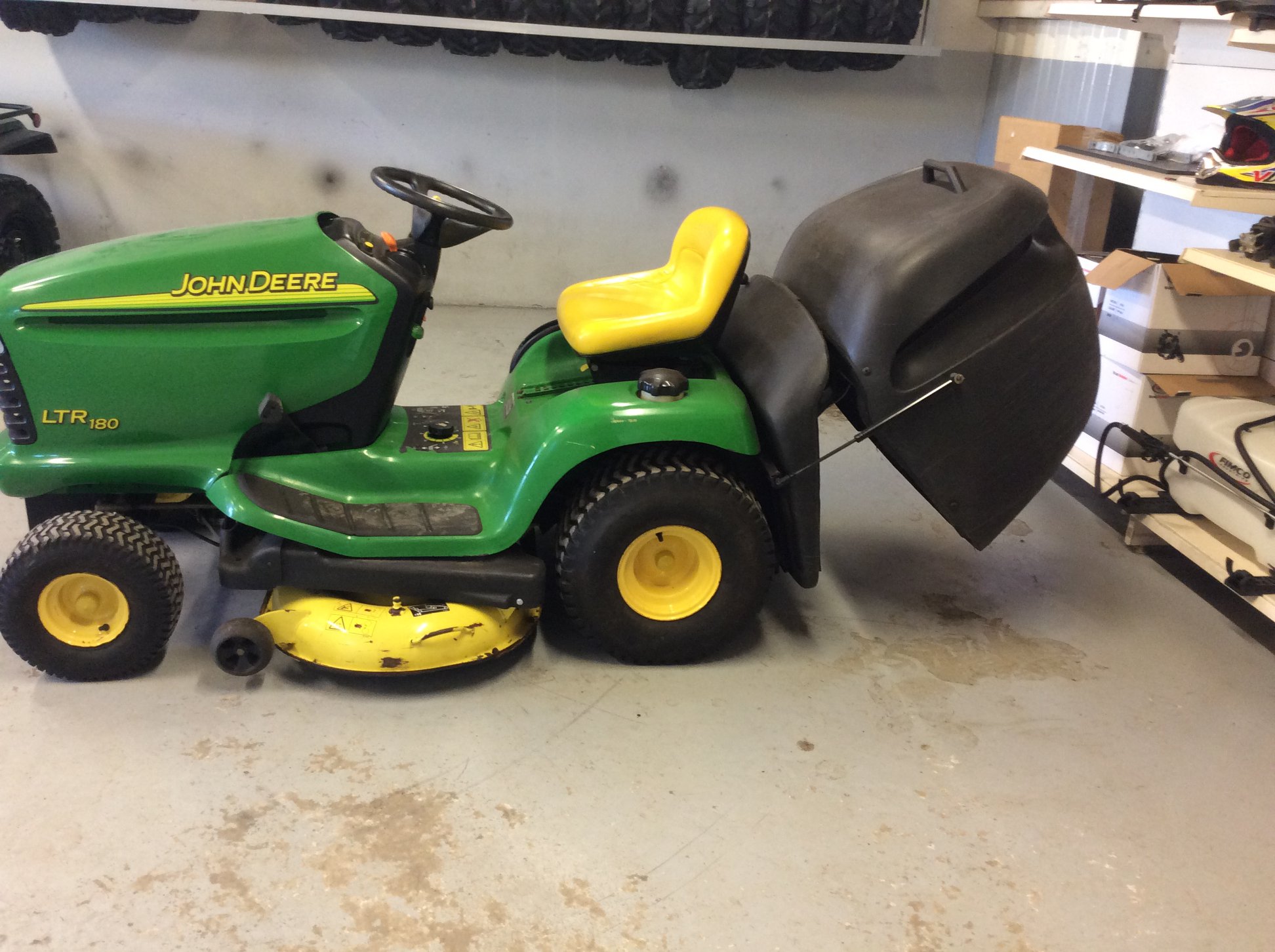

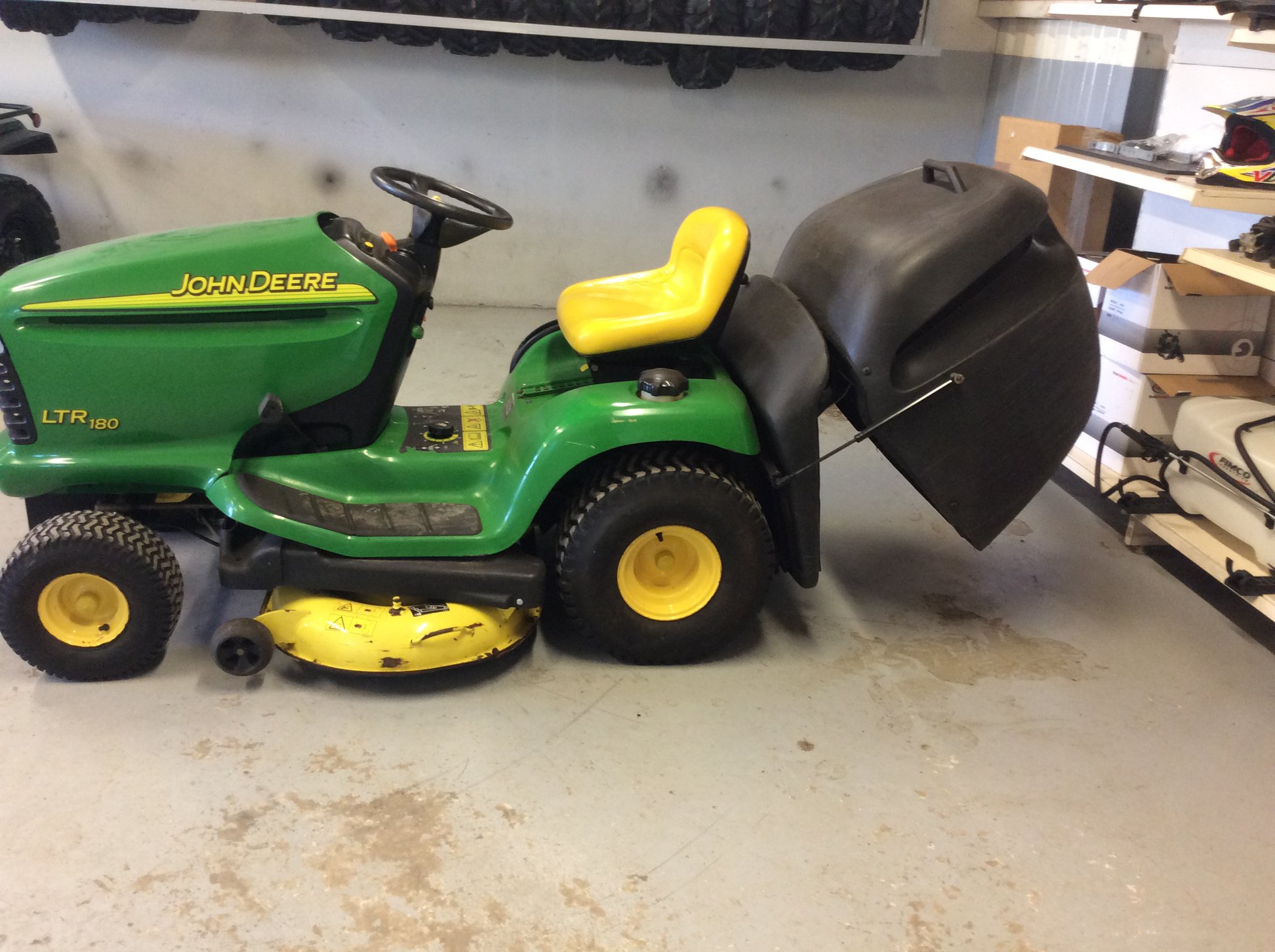

Since I am doing this on a JD LTR180 has a center rear discharge chute clearence is tight above fan I figure I can use a spacer if necessary to shim the trans if height is a problem.

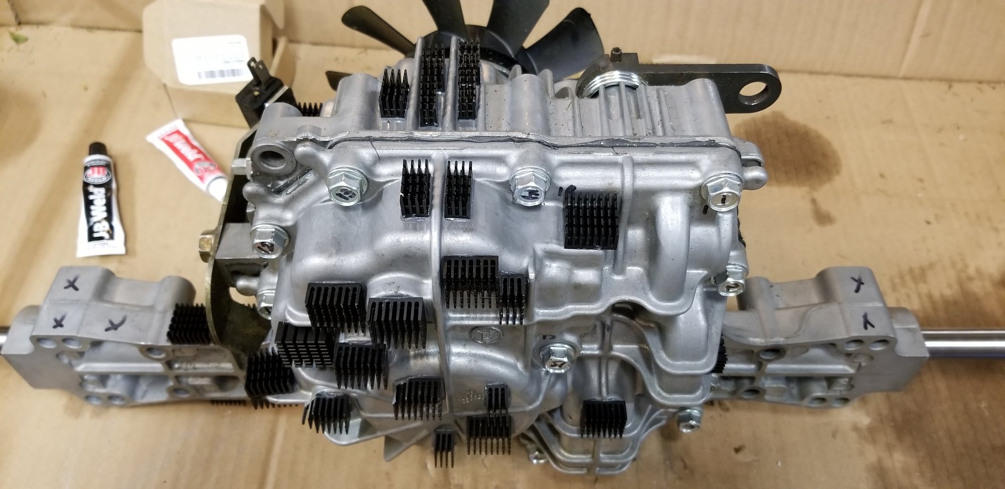

just found this great pics of K57 upgrade

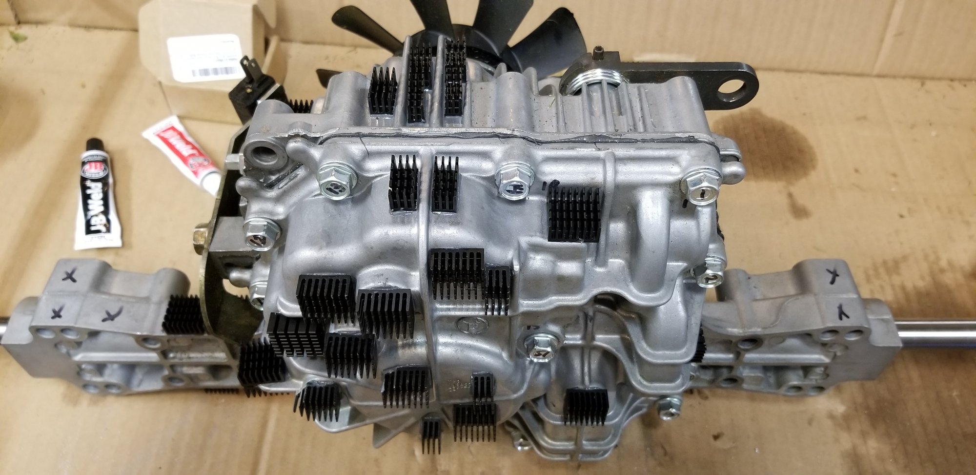

Why swap all those parts from the K57R? If you're going to open it up. You should just need to transfer your axles from the K46 and there's a wedge shaped block you'd need to rotate 180 degrees to correct the forward/reverse being reversed. As far as I can tell the axles should be interchangeable since so many other parts are and they are the same diameter. If your model has short axles like the Husqvarna. You won't even need to swap the axles.
Everything else is external. Reusing the JD Pulley, drive lever and reverse kill switch. Plus tapping the one mount hole. You shouldn't need to do any of the mods I did. I did those because I didn't want to take it apart.
Physically the mounts and clearances are the same. The casing is a bit bulkier. But the position of the mount holes, levers, pulleys and such are the same.
Although I'd skip the kill switch. It's annoying and it physically limits how far you may depress the reverse pedal. Limiting reverse speed.

Like I briefly glossed over in my post. I only had to mod the JD because I did not open up the transaxles. If I swapped out the original longer axles and reversed the wedge no mods to the JD would have been needed. As everything lined up.
Since I was stuck with the shorter axles and flipped the drive lever. That brought the tires closer and lowered the pedal linkage. Requiring the JD mods.
If you change the axles and reverse the wedge. You should just need to configure the transaxle like your original. Put on your fan and pulley in the JD order. Put on your kill switch. Connect your linkages. There should be two left mount brackets. One has the drop through bolt. The other screws in and needs to be tapped.

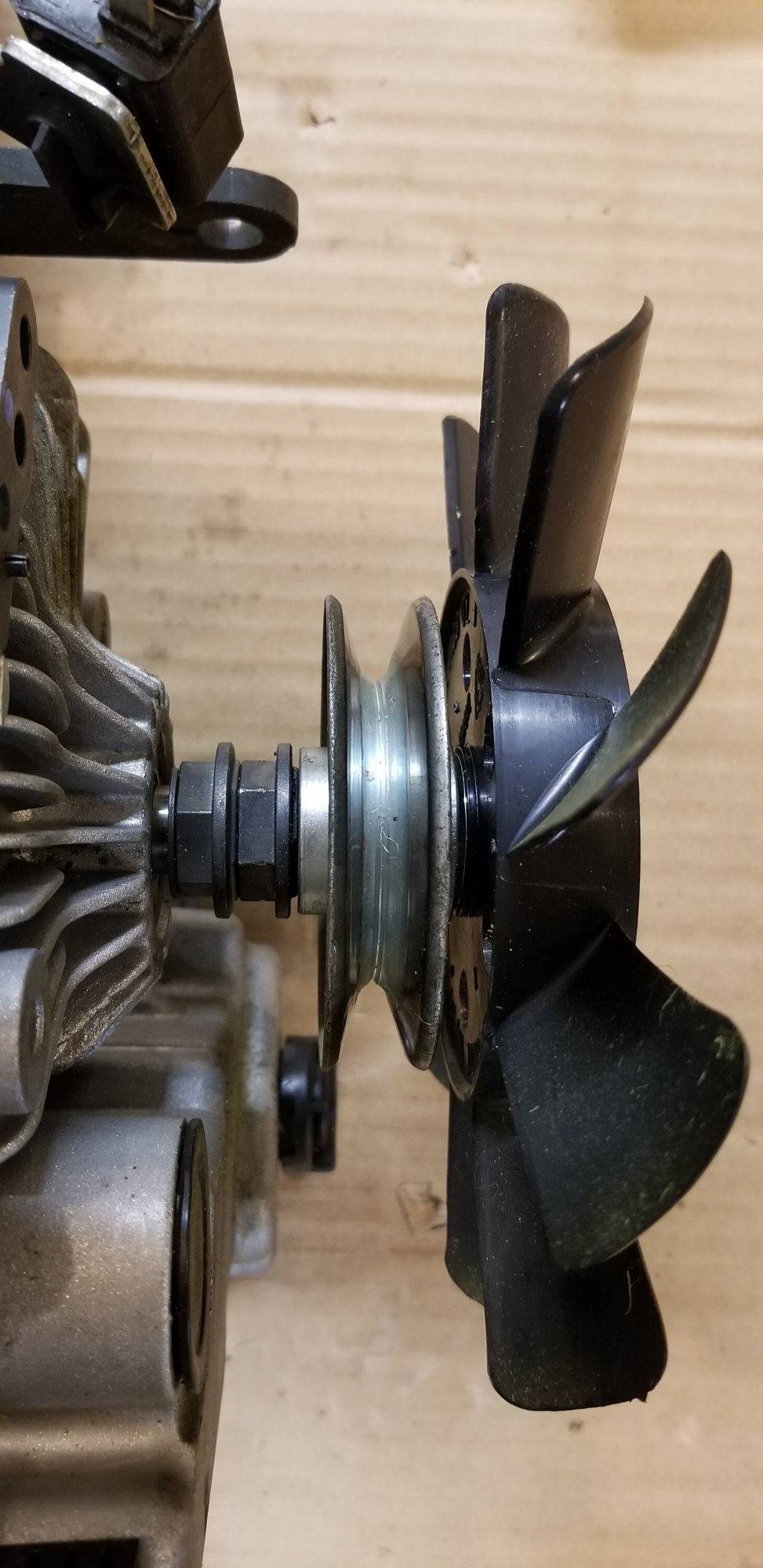

I used my original drive belt. The pulley lined up fine when I used the original JD pulley.
It appears to have a drain plug.
Here is another angle comparing the two. My K57 has all the same bolt holes as my K46 that I'm aware of. So, I'd expect it also has the 5th bolt hole you are referring to.
That's just my setup though. There's lots of variation in the Tuff Torq line depending on what the mower manufacturer wants. Your K46 may be different than my K46. If it has some customization for the grass clipping attachment. Before I did any mods I installed the K57R to check for alignment.
All in all, I would absolutely do the k57R replacement and mods again. It is less $ than the rebuild kit, and you have to crack open the transmission anyway to do a rebuild. I looked into the Husq 348XD over the summer - it has the k66 with locking differential and a twin cylinder engine which all would be wonderful, however their snowblower attachment appears to have significant issues and I don't know what it would take in terms of mods to get my JD attachment to work with it. I've got about 160 hrs on my JD D110, so I'm going to run with that as long as I can. Wish me luck!
Reactions: John Skull
I'm new to the macrumors forum, and wanted to share my story about my lawn tractor transmission too... I just did the K46 (actually a T40J) to K57R upgrade on my JD D110. Thank you velocityg4 for the inspiration! I picked up the K57R from Surplus Center at ~$270 + ~$50 shipping, shipped next day and got here fast and safe. The housings are identical. I opted to crack open the new unit, flip the wedge and replace the axles with my old axles - absolutely no problems there - axle mounts are identical. I also ordered some new axle seals - I highly recommend this since the teeth on the end of the axle mess with the seal/spring when you pull the axle out through them. I took apart more than I probably needed to as I was looking to replace the input drive shaft to avoid belt alignment, but found that I did not need to, since the k57R "stack" includes toothed two bolts as spacers that I can simply slip them on to reorder to match my T40J belt alignment exactly (see pic). These bolts are also great for driving the shaft with a socket on your drill to bleed the air out of the unit when refilling with oil. I tapped the mounting hole as velocityg4 did, and replaced the drive pulley with my original pulley. I also opted to replace the exterior forward/reverse and brake levers with my originals to avoid any pedal issues. I used Permatex UltraBlack for the new gasket and replaced the oil with Mobil1 5w-50. Note the k57R takes a bit less oil than the T40J - probably due to the extra pump hardware in the unit. The hardest/most time consuming parts of the task were scraping all the old gasket off of the housing and getting the roll pins out of the exterior forward/reverse and brake levers.
I put the mod k57R back in and mowed my lawn. Everything works fine, and it does seem a bit faster (see below) especially in reverse. Most importantly, it has no problem going still going as slow as I want it to. (Well, most most importantly the transmission still works after I opened it up and messed around with it 🙂).
According to TuffTorq, my old T40J delivers 176.4nm torque with a max input shaft speed of 3,000rpm and a 28.04:1 reduction ratio. The k57R "hopper" I picked up delivers 231nm of torque with a max input shaft speed of 3,600rpm and a 23.02:1 reduction ratio. I'm assuming this is about a 30% increase in torque and a 20% increase in output speed. Since I am using my existing old pulley, there would be an additional 20% increase in output speed based on the difference in pulley sizes. The slower drive rpm would erase 20% of the speed increase, yielding a net 20% speed increase. I'm not sure how the slower drive rpm might affect the torque output vs. greater pull on the engine, etc. I assume the extra hardware in the k57R provides some incremental output, since everything else is the same (they have the same pump and motor rebuild kits) with perhaps the exception of some of the gearing which would yield the difference in reduction ratios (I didn't count the teeth when I had both the units open).
My requirement, and reason I'm replacing my T40J and opting for a (arguably) beefier transmission is *not* mowing my 1.5 acre flat lawn in the suburbs, not even that it is less $ than a k46 rebuild kit, but what I do with it in the winter. I haul it out to my cabin in the mountains and use it to clear snow off my steep, long driveway with the John Deere 42" snowblower attachment (which I love, is built like a tank, and is a different story). I snowblow it instead of having it plowed because we use it is as a sledding run, so I need to control the snow I leave on the driveway and leave clean "walls" of snow on each side to keep sledders in bounds. I have chains for the tractor, the OEM weights, and then another ~200lbs of sandbags I lash to it to maintain traction. Add another 190lbs for me and the fact that my garage is downhill from the road (requiring me to clear the initial path through the snow on an uphill run through typically 6-12+" of snow at a time), it creates a use case way beyond the design spec of a k46 (much less a T40J). While it is typically below freezing out, heat is still the enemy - I can through clumps of snow on it and it not only steams, the snow sizzles and dances. I typically change my transmission oil every year, and have seen water in my oil (from water getting in through the breather cap?) in the past so I don't do this anymore...
This brings me to my next mod, which some (including me) may find disturbing (reader discretion advised 😉). I bought a 30 pack of 20x20x10mm heat sinks on Amazon for $9, got some JB weld, and got busy. My placement of the heat sinks was driven by flat spots on the housing, clearance for moving levers/arms and access to housing bolts, proximity to the internal pump, motor and oil sump, and avoiding gravity based pile up of clippings and debris around heat sinks/housing fins, and no up-facing heatsinks that debris will settle into. My first thought was this mod was that even with mounting side and down facing, the heat sinks will be a magnet for grass clippings and debris which could actually insulate instead of dissipate heat. But remember my use case, I'm not going to run into heat issues mowing my flat lawn, it is when I'm working in snow. A long highway speed trailer haul out to the cabin and an once over with some compressed air once a year should get the fins cleaned up for the hard work in the snow. It looks funny, but the math is compelling, ~128 square inches of additional heat dissipating surface area. Still, probably not a mod for everyone.

the other way around, If you look at the trans side by side the pulley is off by about 1 Inch. I am unsure where this inch comes from? different center case? offset in upper case mounting of center case? The K57 has same mounts, same positioning of levers and has short axles. If you have the short axles, then K57 just bolts right in. I noticed in a previous thread that on his tractor the 5th mounting bolt was threaded (he had to tap trans case), my 5th bolt uses a nut and bolt (not threaded), the JD LTR's. On any trans you need to check rotation controled by wedge that sits behind motor. And if you need to swap axle, very easy 2 u clips slide axle out, new axle slide in replace clips.
Almost forgot unsure what oil is used in K57R?? so I would change oil after 30-50 hrs (season) with the recomended 10-50/ 20-50 syn oil.
The input drive shaft extends about 2.5" out of the top of the housing on both the k57R and the k46 (T40J in my case). The cause of the "1 inch" pulley misalignment is two fold: 1) the retaining ring that holds the pulley and fan up is 3/4" lower (closer to the housing) on the k57R input drive shaft, and 2) the order that the pulley and fan are slipped onto the input drive shaft as shipped from the factory. The k57R includes two "nuts" that slip on the input drive shaft that are 3/8" high each that space the pulley and fan on the drive shaft. Fortunately, the nuts, pulley, and fan can be slipped on in any order, so you can put the nuts on first to provide 3/4" space up the drive shaft for the pulley and retaining ring (see my pic in the post above). These nuts are also great for driving the input shaft with a socket/power drill to bleed air out of the unit when refilling with oil. FYI - The k57R housing is also threaded for the bolt that extends up to the side of the pulley to prevent the belt from coming off the pulley (installed on the k46/T40J). I used Mobil1 5w-50.

Mine came w/o drain plug since I had drilled them in my K46A and I had to remove bottom pan to replace axels, I used my K46 pan. My levers were all the same did not have to swap the forward/ reverse lever or the motor wedge thin side up on mine, and I had to make a new neutral arm. when I get home tonight will post pics of inner trans. the top case is different as mine had the plastic reservoir, the K57R has a larger hump. The top case is different on the K46A so I'm not sure if shaft for pulley/ fan will line up? I would think it's easier to just bolt up the K57R then swap everything out.
Ah... my T40J case was identical to the k57R. Did you try measuring and comparing the distances from the top of the input drive shaft to something the same on both like the axle? That should give you an idea of any potential line up issues.
An external reservoir and drain plug would be awesome. If the rebuild kits for the k57R and your k46A are the same, you may be able to gut the new parts from the k57 and put them in your old case. I know easier said than done with gasket scraping, new axle seals, new oil, etc...
