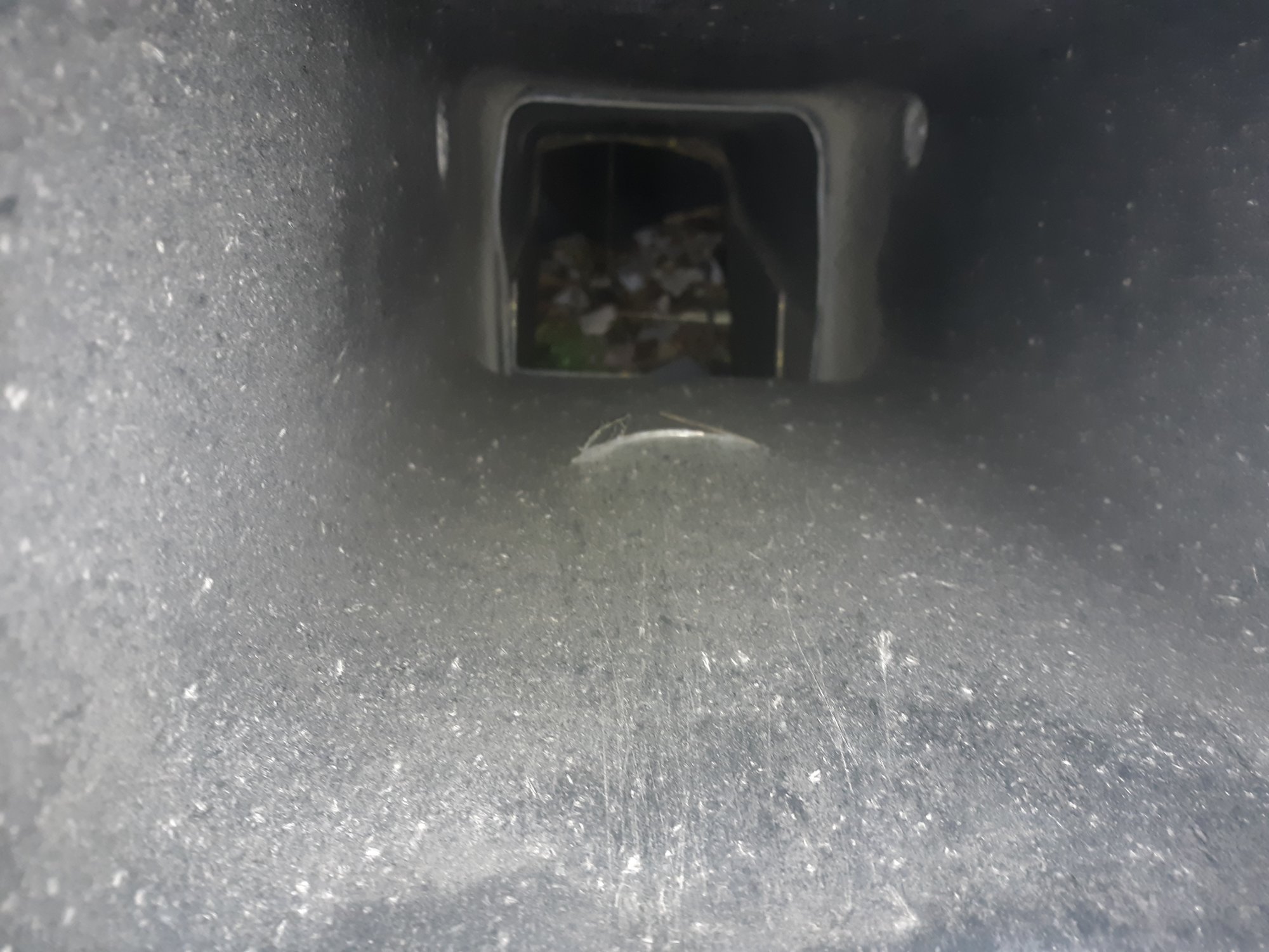

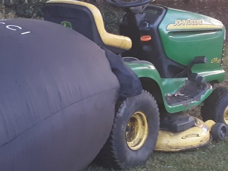

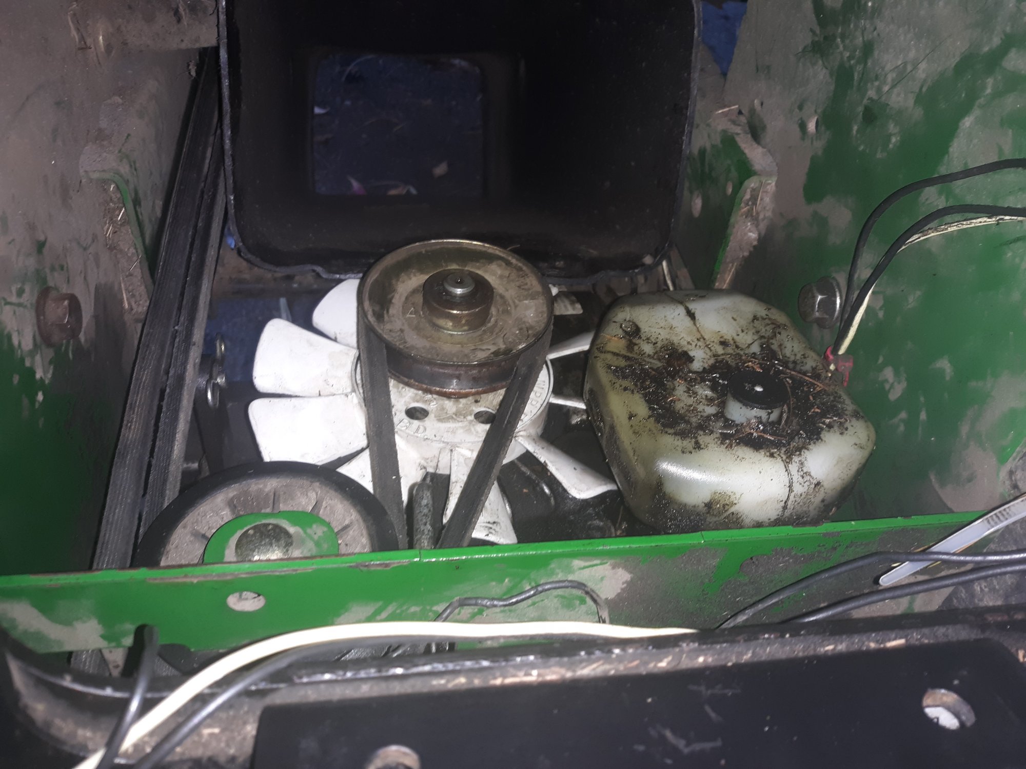

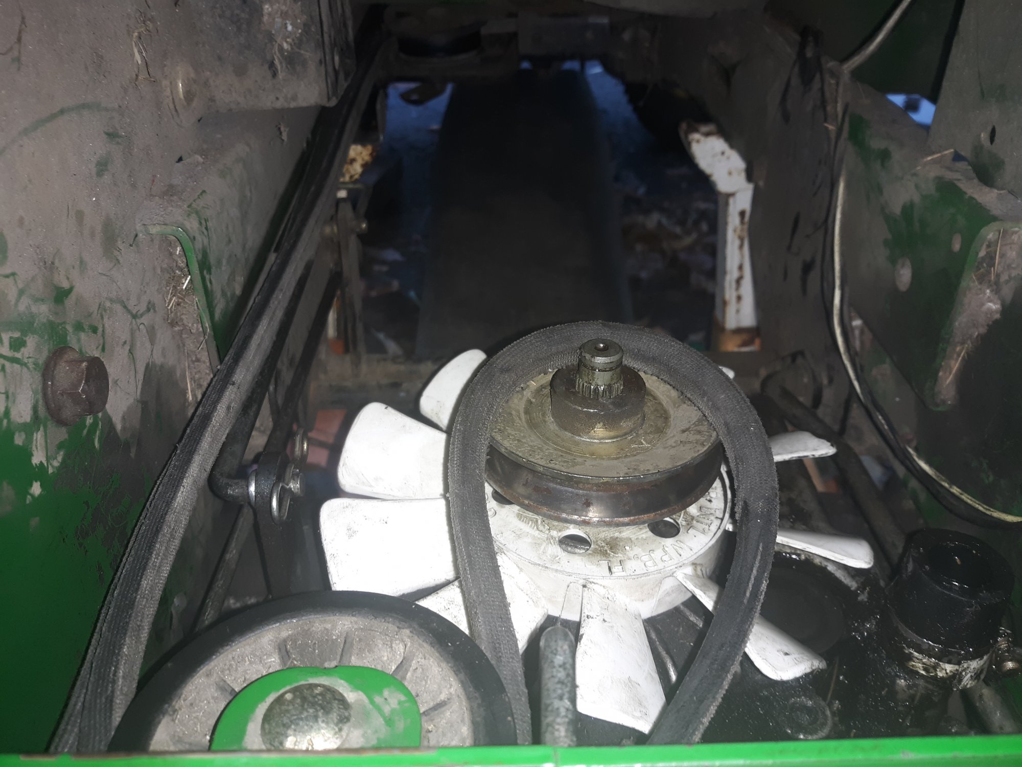

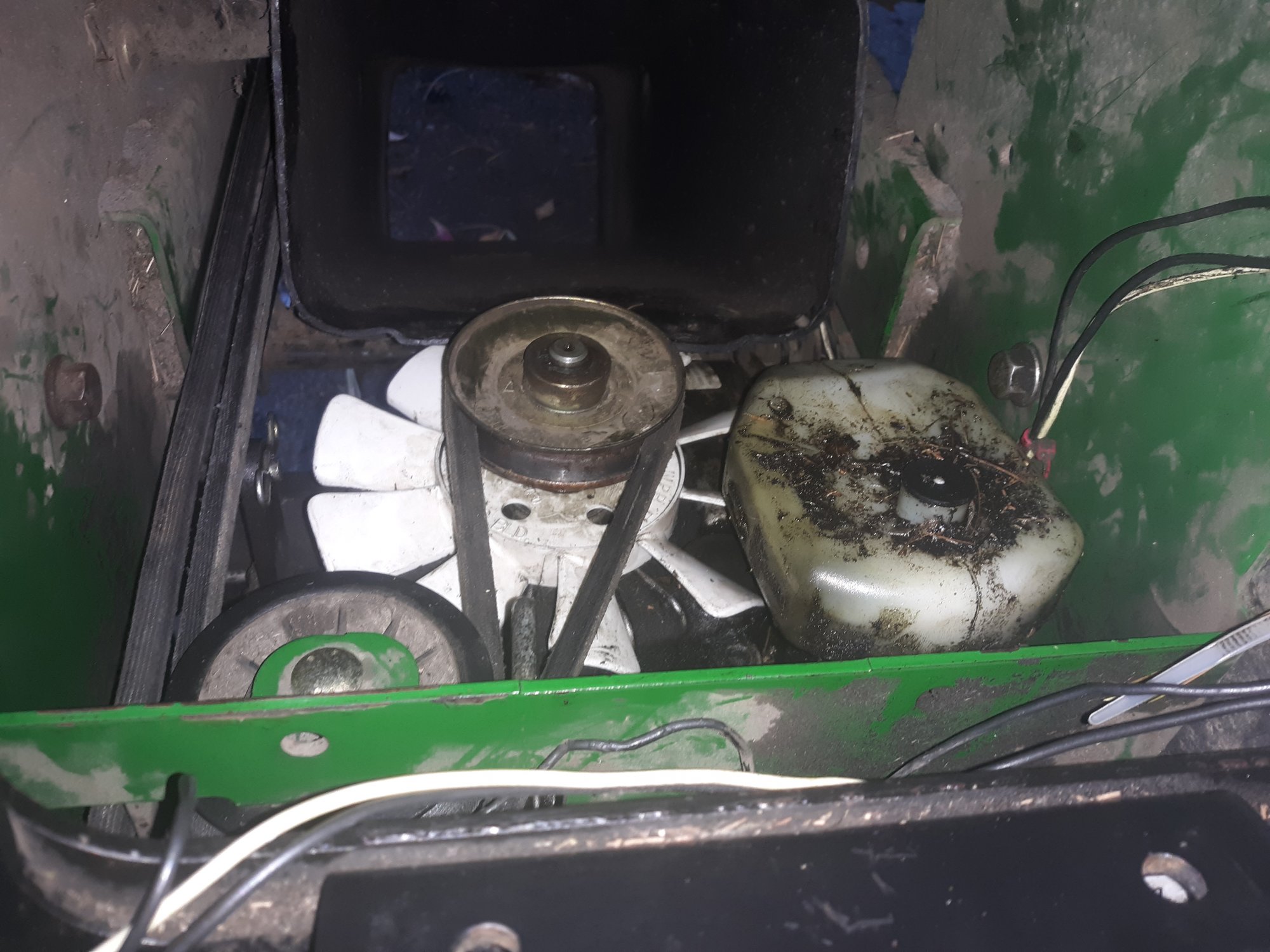

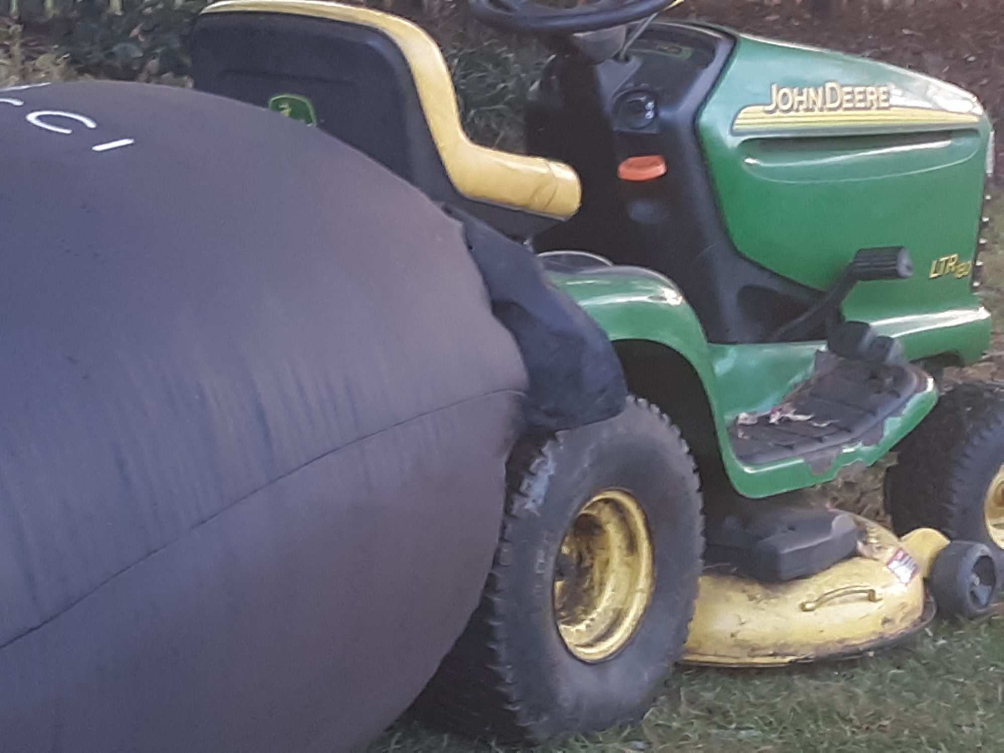

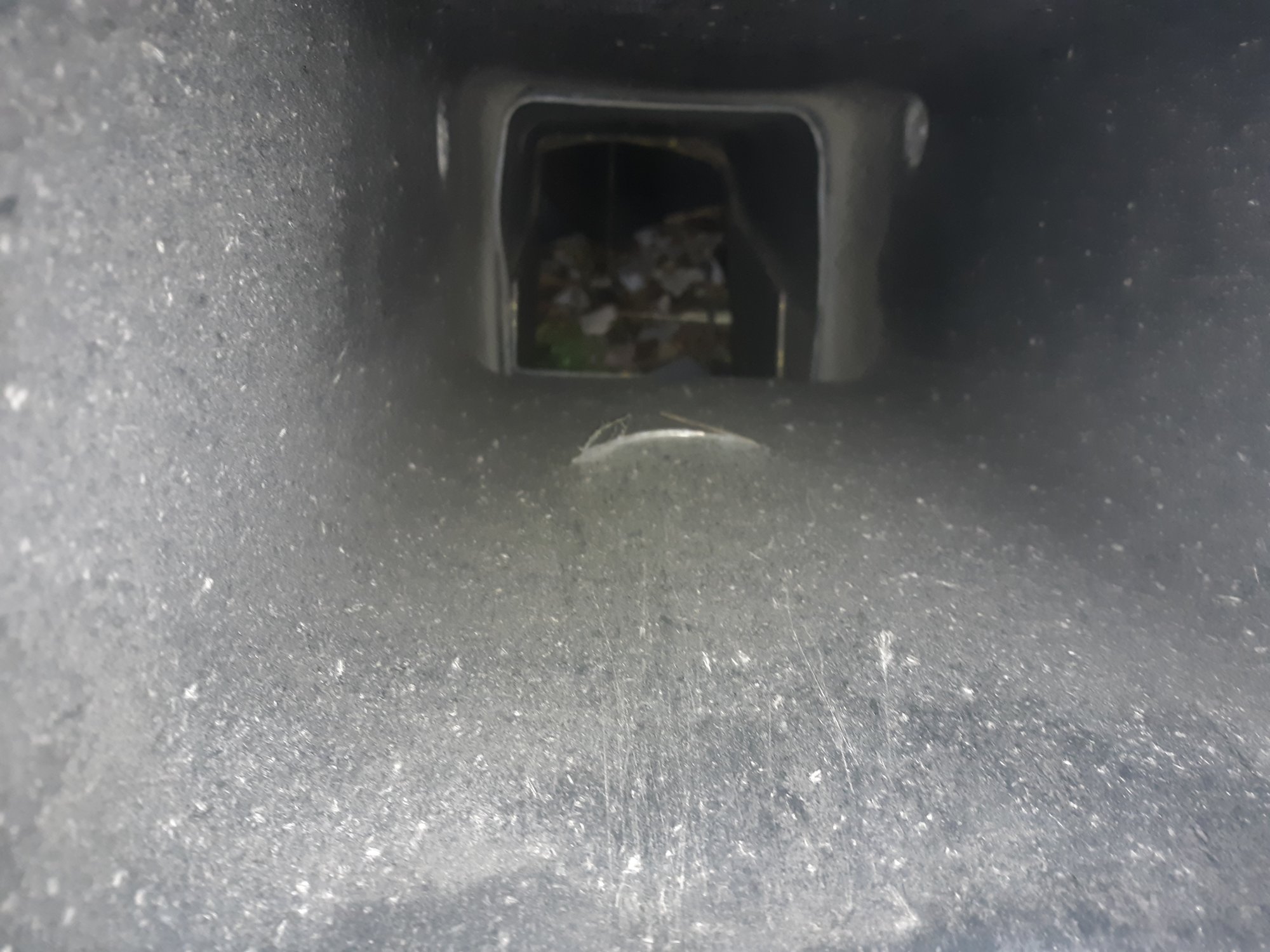

Hope you had a nice turkey day. Last Wednesday I mounted trans, chute and deck figuring what could go wrong with new trans ... Went to drive let up drive pedal pushed forward and NOTHING!!!!!!!!!!!
Tried unbolting chute to see top of trans was able to push chute back about 2 inches and can see belt was off?? WTF! Belt was wrapped around fan. had to remove small clip to get pulley and fan off. Dont know if pulley is about 1/4" higher then original (K46)? so belt on slight downward angle off trans to rear pulley, so fan clips the belt? Original (K46) the spline spacer is between fan and pulley so there is about 1/3rd in clearance between fan and belt. I cannot put splined spacer between fan and pulley (as original) as it drops fan down too low and hits hump in trans. I was debating wether I could just add spacers to lower trans so I could add a little more clearance by lowering trans would add a little room and belt a sight angle upwards. But I decided to R&R trans since I also had issue with spacers not fitting on rims wanted to double check the axle swap any way. and decided to swap the trans pump, gears, charge pump... to my original K46 trans.
Reactions: Glideslope

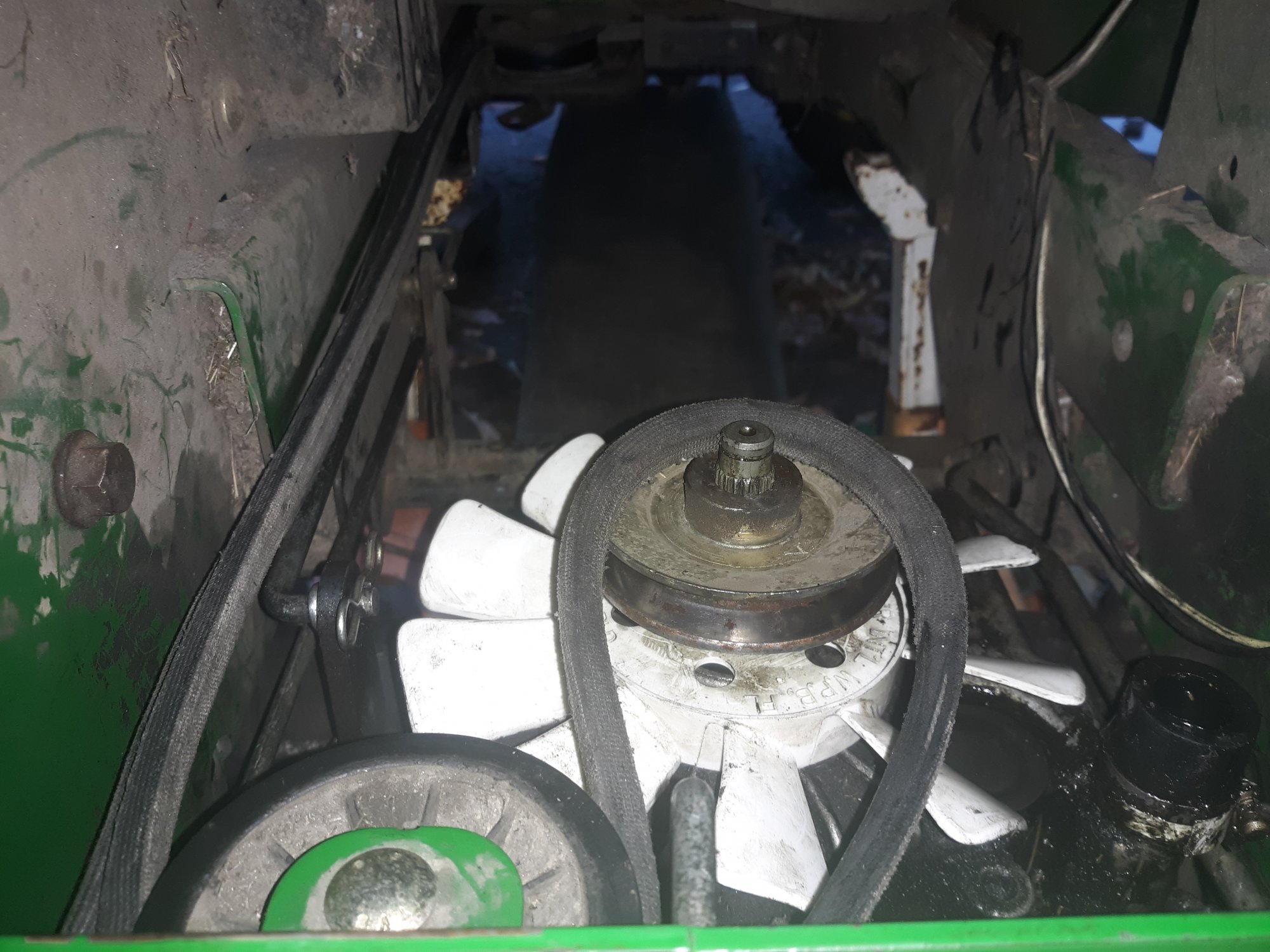

There is a difference in pulley height. I mention this in one of my first posts a long time ago. It's amazing to see the thread still going in here. It's like a thread from "Green Tractor Talk." 😉😉😉
I remember reading that I thought I would have had the clearance though. my first attempt the fan hit belt as I had to put spacers under fan, as the hump using the K57 case was higher and hitting fan. But that put fan too close to belt and with higher angle belt wrapped around and broke the fan. So I swapped cases using the k46 no hump, w/ reservoir as u can see fan sits under it. So when I had the extra clearance I used 2 spacer between pulley and fan, give more room as I only had 1 extra fan, as u see 1st pic using 2 spacers between fan and pulley, pulley wore hole in chute and kicked belt off. So I lowered trans about 3/8" w/ spacers, and also lowered pulley moving 1 spacer on top and 1 below pulley. And off to the races🙂 Tractor K seams to go faster in reverse then forward (pedals F & R are good) I assume would need to reverse motor wedge and also reverse F&R lever to fix this but She works and I can finish leaves for the year

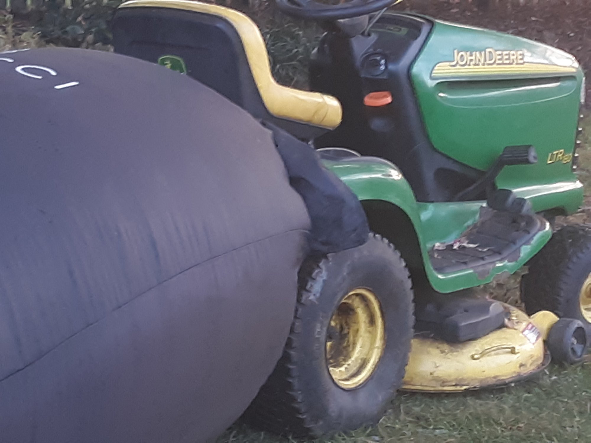

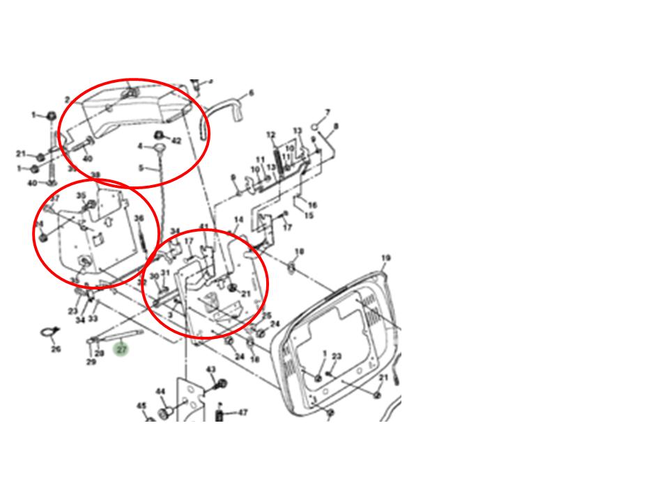

As stated by others, if you want to keep the existing control setup you need to flip the wedge (part #36, "motor housing") to reverse the gear action (this transaxle was intended for some Husqvarna models with a different control scheme). In order to do the flip you must remove the pump & housing drive line that runs through the wedge.
