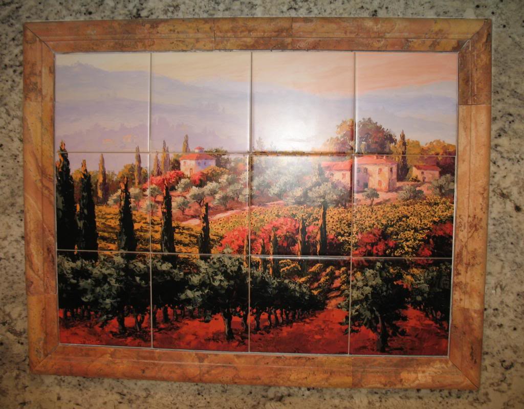

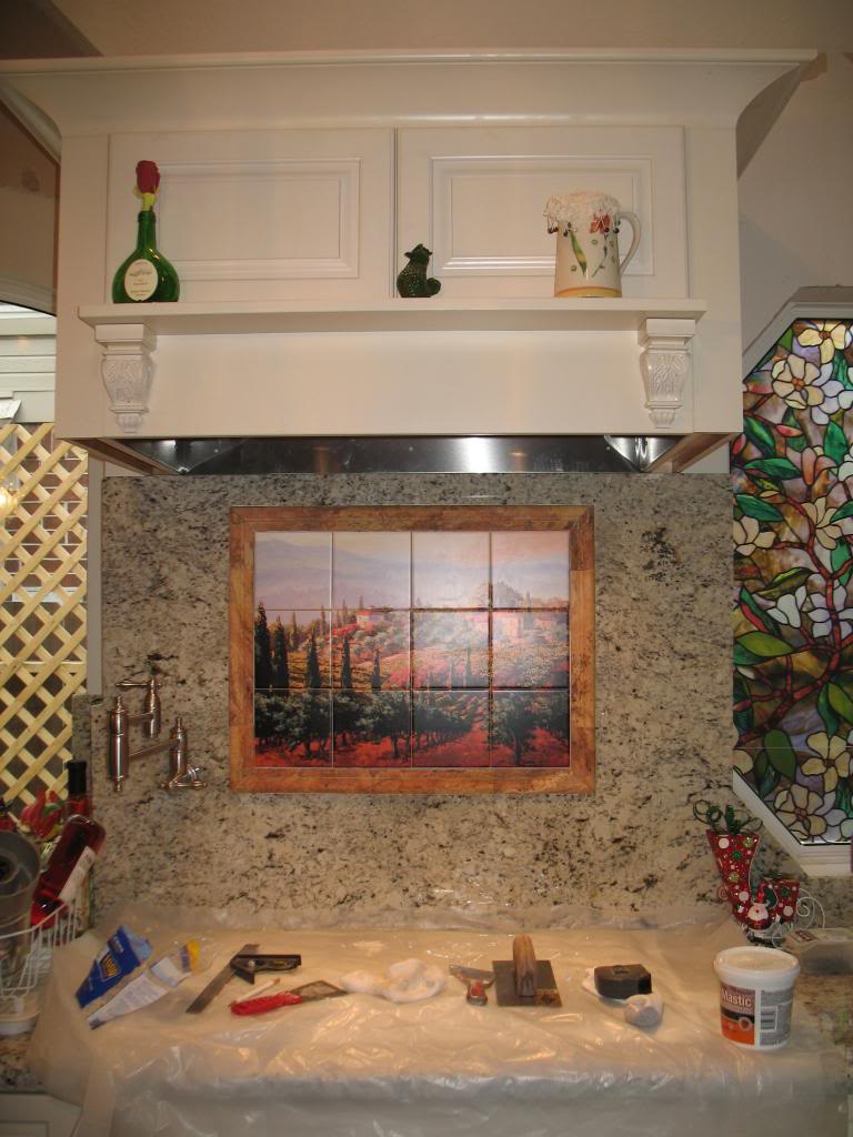

Kitchen Mural Up:
Consists of ceramic tiles with image baked on. This one is 18x24, but they have larger ones and as someone who has shopped for specialty tile lately, the price ($200) struck me as reasonable. Find more at: Pacifica Tile Art. The border is separate edge tile we found at a local tile store on clearnace for $1 each. Quite a deal as they can easily go for $6-10 each.
That looks really good! Good job! How is the rest of the kitchen coming along?
Thanks for your interest! 🙂
I'm replacing pantry doors with ones with glass inlays. They will need to be painted. After that all of the major components of the remodel will be in place. I still have some small panels and trim that need installing.
Then I'll curse the so and sos who painted over wall paper, and the original builder who put up the wall paper without first sizing the walls. After that is removed, we'll either paint or wallpaper. Although I like the look of wall paper, I"m working hard at trying to talk my wife out of it. It seems to be out of fashion these days. Not that we are planning on selling anytime soon, but wallpaper is a minus and it's a lot more work than painting.
After that and when the kitchen has been cleaned up, I'll post some finished views. Have no idea of the time frame, maybe a month or two. I'm not spending long days "at it". 😉
