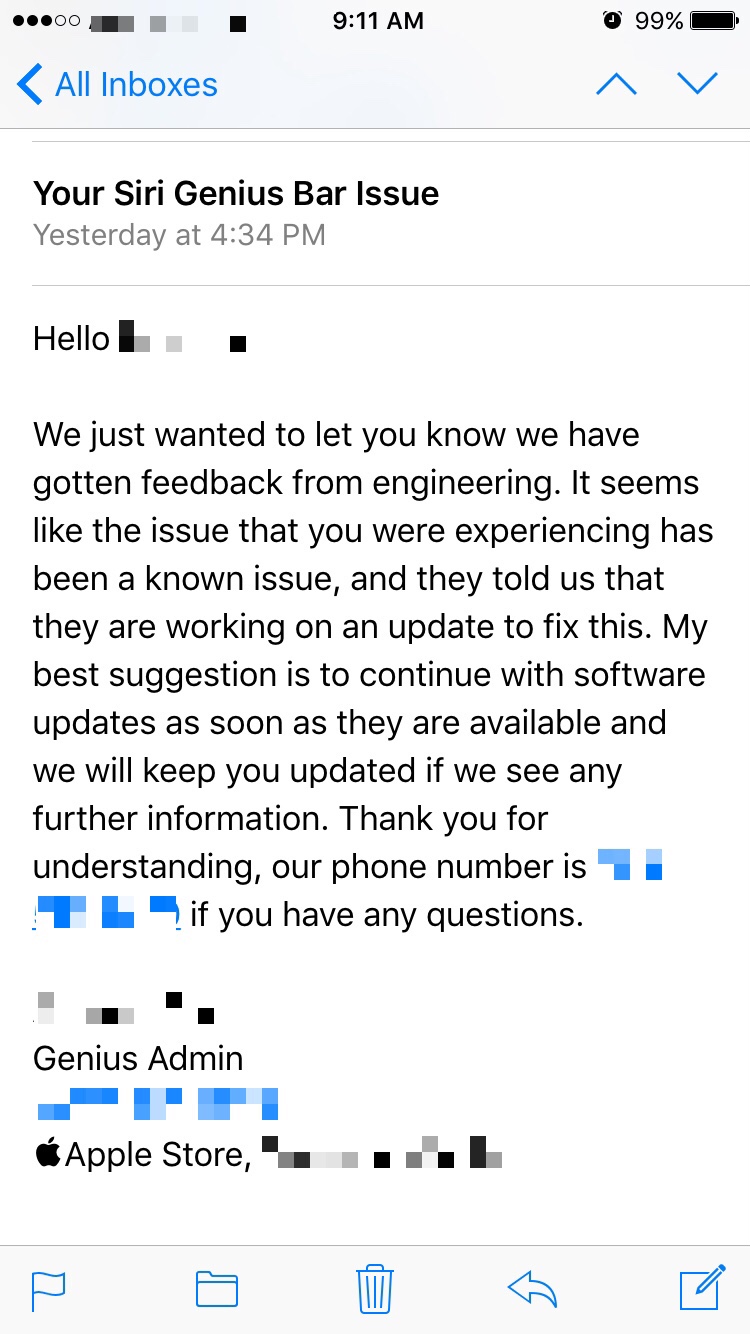

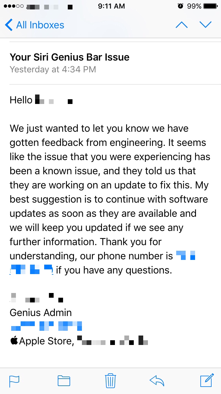

Siri will not process my requests to set alarms and timers, add events to my calendars, set reminders (amongst other things). S/he will make calls to my contacts, occasionally. I've called Apple Tech Support. I sunsequently made a Genius Bar appointment a week ago Thursday, and the Genius ran it through a bunch of tests, did resets, etc., and told me she'd call back at the beginning of the past week.
Since I never heard back from her I stopped in yesterday and spoke with another Genius. He told me he had intermittent issues with Siri as well. I told him I understand, but Siri hasn't worked for me for three weeks in this more peculiar fashion (some requests work while others consistently do not). The Genius sent me this email shortly thereafter:
