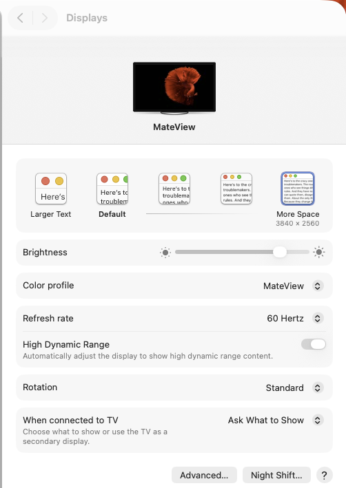

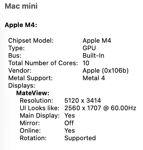

From my M4 Mac mini, I can run 3840x2560 (3:2 monitor) / 60 Hz / HDR via a TB4 cable to my Huawei monitor, but that is the native resolution, so not scaled on the Mac.
I normally run at 2560x1707 though, so the resolution rendered is 5120x3414.

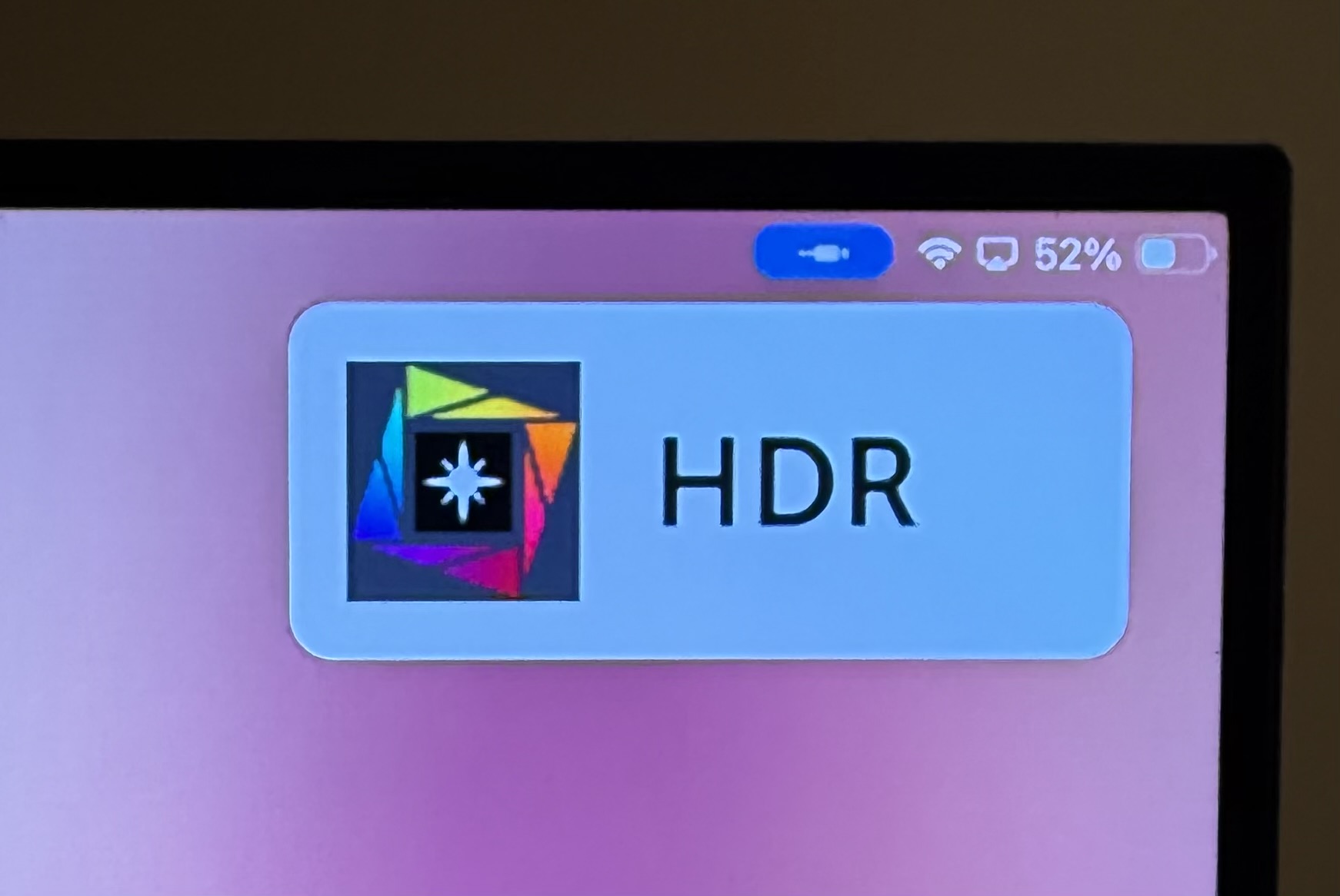

True HDR, right? verified with HDR video.
Looks like i am going to return lg 32 6k, and buy G32p instead. G32p is clearly the winner now.
The G32P says "HDR/On", and the iPP has the HDR switch (which is on).

This was when I had the iPP connected.
I don't have a mouse/kb connected to the iPP, so all I was able to see was a 2nd screen (a screen to which I could move a window, yet not be able to interact-with it).
It was the G32P Menu which stated "3840x2160/60Hz" and "HDR/On".

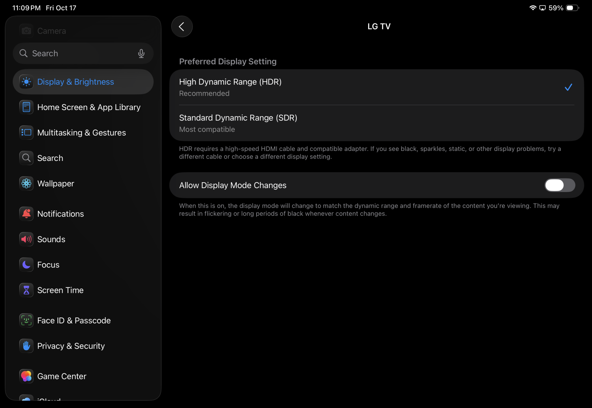

Just out of curiosity, I tried my M4 MacBook Air and my M4 iPad Pro with a Plugable USB-C 3.1 —> HDMI adapter (which came free with my Plugable TB4 hub), connected to my LG C8 4K TV, so no Thunderbolt involved at all.
I get 3840x2160 (clear text) out of both of them, but only the iPad Pro has HDR. No HDR option on the MacBook Air.
My TV and HDMI dongle are both HDMI 2.0, not 2.1. HDMI 2.0 is limited to 18 Gbps.
It appears I’m getting 4:4:4 colour too, so 4K 3840x2160 / 10-bit HDR / 4:4:4 through USB 3 / HDMI 2.0.
I would have thought it is 60 Hz, but I can’t actually check that. It doesn’t feel choppy like I thought 30 Hz would, but I didn’t think 4K 60 Hz 4:4:4 HDR was possible over HDMI 2.0. However, the TV clearly indicates I’m using HDR, so maybe it’s 30 Hz after all.
yes, 4K60 4:4:4 requires 15.68 Gbps but HDMI 2.0 can provide only 14.40 Gbps so it's not possible.
I assume you mean 4K60 4:4:4 HDR, because without HDR it’s only 12.5 Gbps.
Anyhow, assuming @splifingate’s M4 iPad Pro is putting out 4K60 4:4:4 HDR, that’s no big surprise for its Thunderbolt port, since it only needs 15.7 Gbps. No TB5 or DSC required.

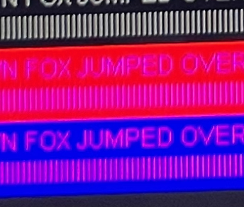

No HDR at all (so-far). I have tried both a USB-C -> DP, and a Cable Matters TB5 cable
did you try 1080p hiDPI resolution? Or 4K lowDPI?
thank you very much for this test!
Unfortunately, my worst fear came true. Your result proves that DSC doesn't work with this exact resolution - 6144×3456 in macOS when connected via DP1.4 so it means that users get 4:2:2 chroma subsampling instead of full RGB 4:4:4 on the monitor.

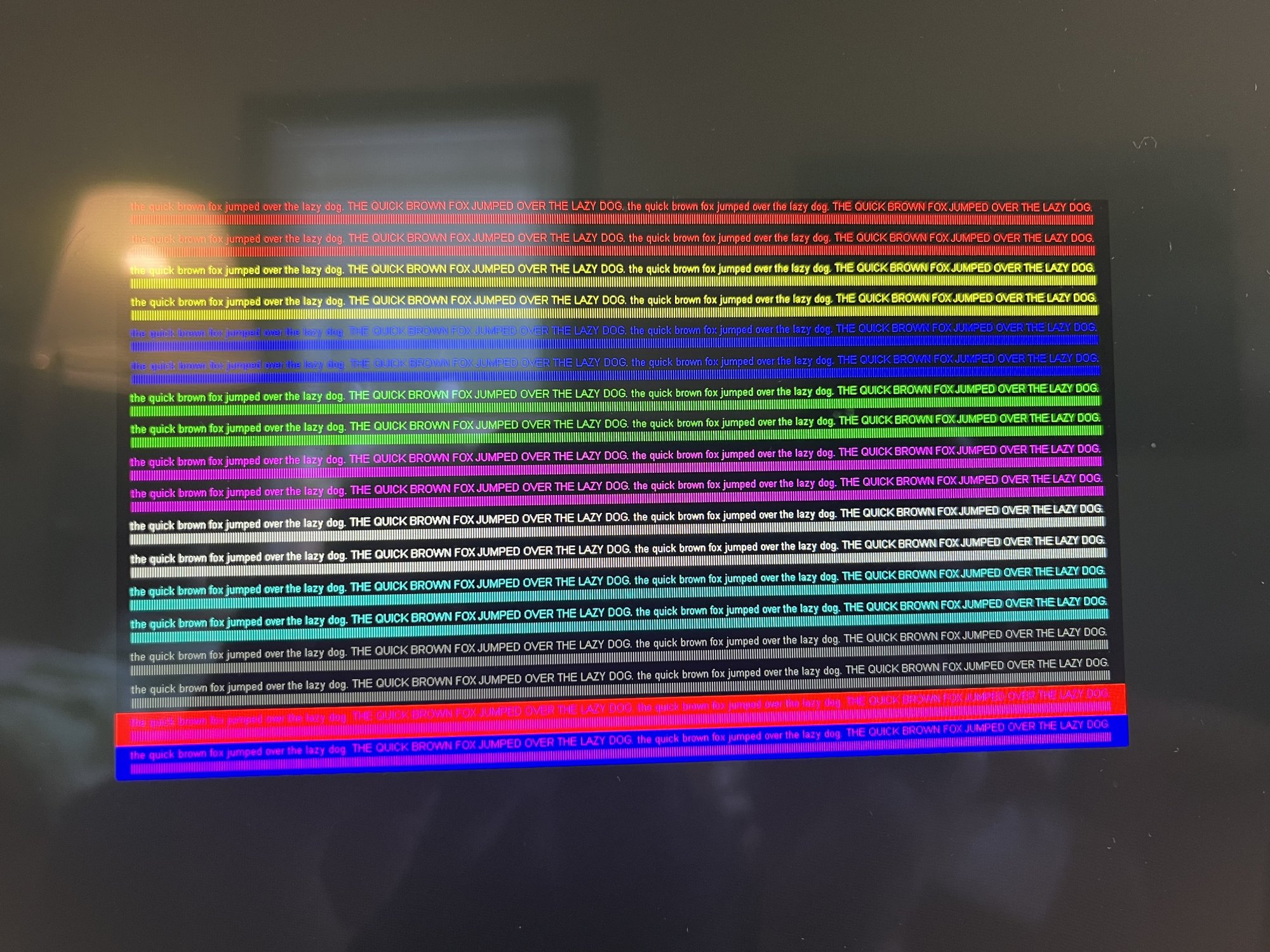

Personally I cannot call 4:2:2 chroma subsampling image retina quality.
Hmmm... @splifingate's picture actually looks to me like 4:4:4 but with motion blur or incorrect focus. Another shot may help.

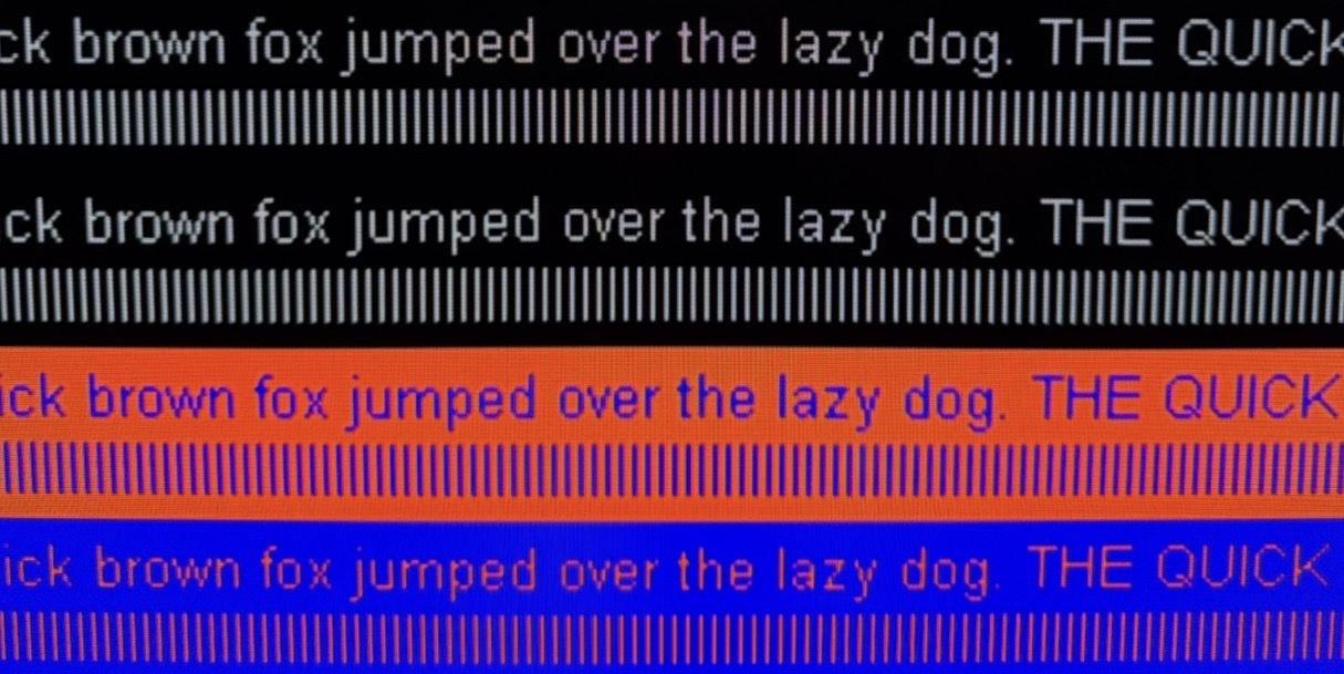

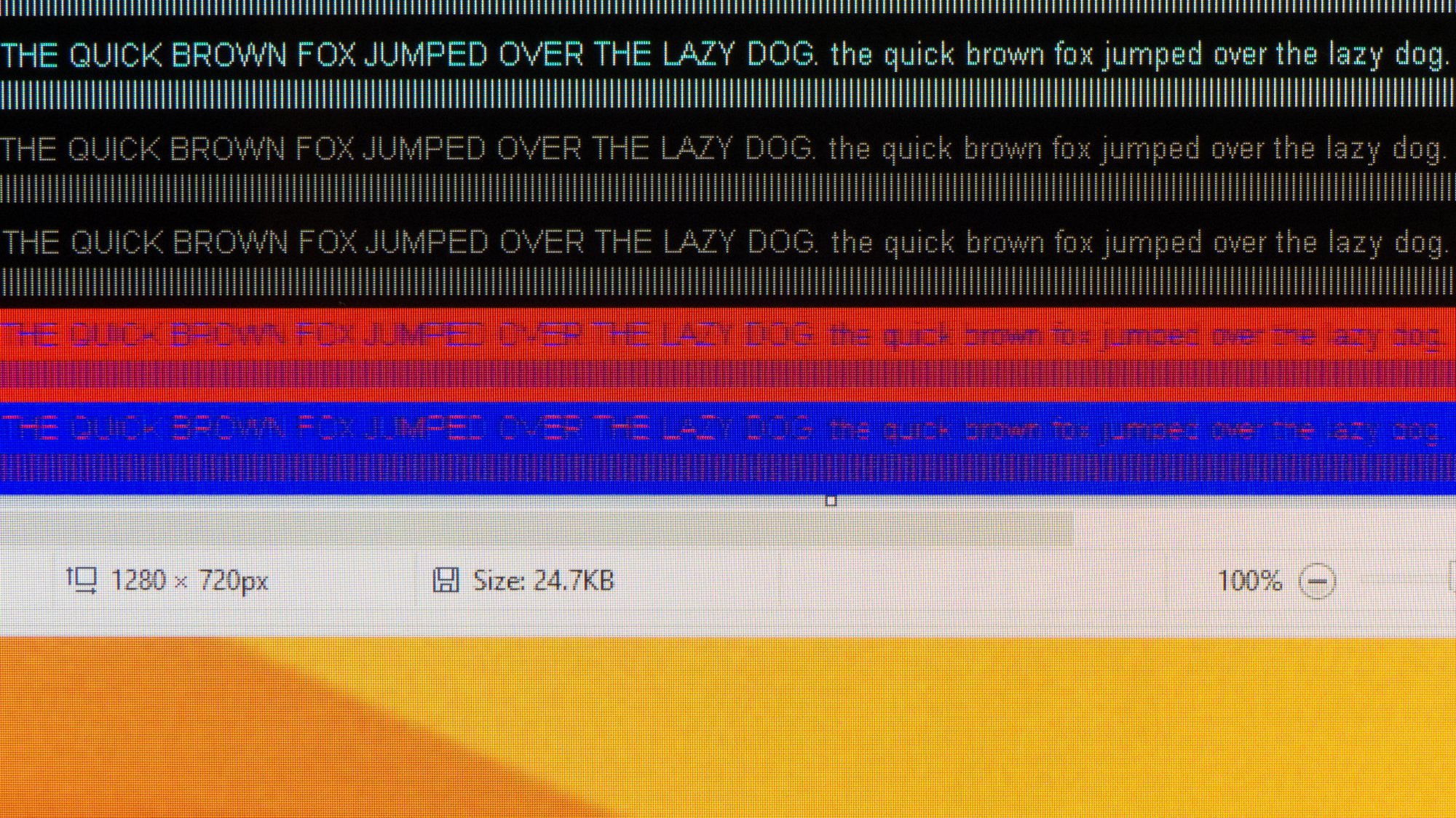

Just snapped this photo (with my iPhone 13-Mini @ 1x) of the rtings ref. image in Firefox (DGX OS 7 (basically Ubuntu w/perks); DP Alt Mode @ 6144x3456/60Hz/100% scaling):
what picture are you talking about? That's in your message? It looks like 4:2:2 to me.
If you mean post https://forums.macrumors.com/thread...x3456-ips-black-monitor.2459111/post-34232165 it's obviously 4:4:4 but it was taken on Linux OS which doesn't have the bug anyway.

I mean the photo that I had included in my post, which came from this post:
It looks like 4:4:4 that is blurred, either by camera motion or lack of focus, or both. If you look at the white text, you can see just how blurred it is.
4:2:2 would look even worse.

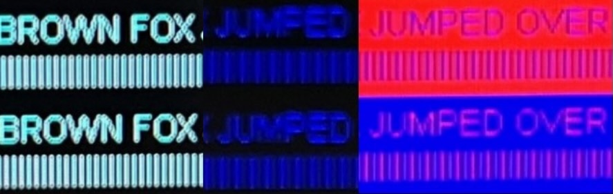

Below is RTINGS’ 4:2:2 picture. Note that the other text lines above the red and blue are in perfect focus, yet the red and blue lines are still worse than @splifingate's.
I disagree. I see a clear difference between that image and image in this post. So my conclusion is that the latter is 4:4:4 and the image in your post is 4:2:2.
The new picture you linked is in much better focus. Like I said, look at the white text to compare the focus. Until @splifingate can provide a better picture in macOS, I think it’s a mistake to conclude that earlier blurred picture is 4:2:2, because the whole picture is blurred.
The focus isn't great here but even with such non ideal focus I see patterns only on the colored sections where there's no uniformity in lines. I'm already convinced this is 4:2:2 but also agree - if we have better photo it would clear all doubts.
I see it now (the new clarity of the white row).
To be sure, the G32P (the *er* focus in my first submission) is not matte.

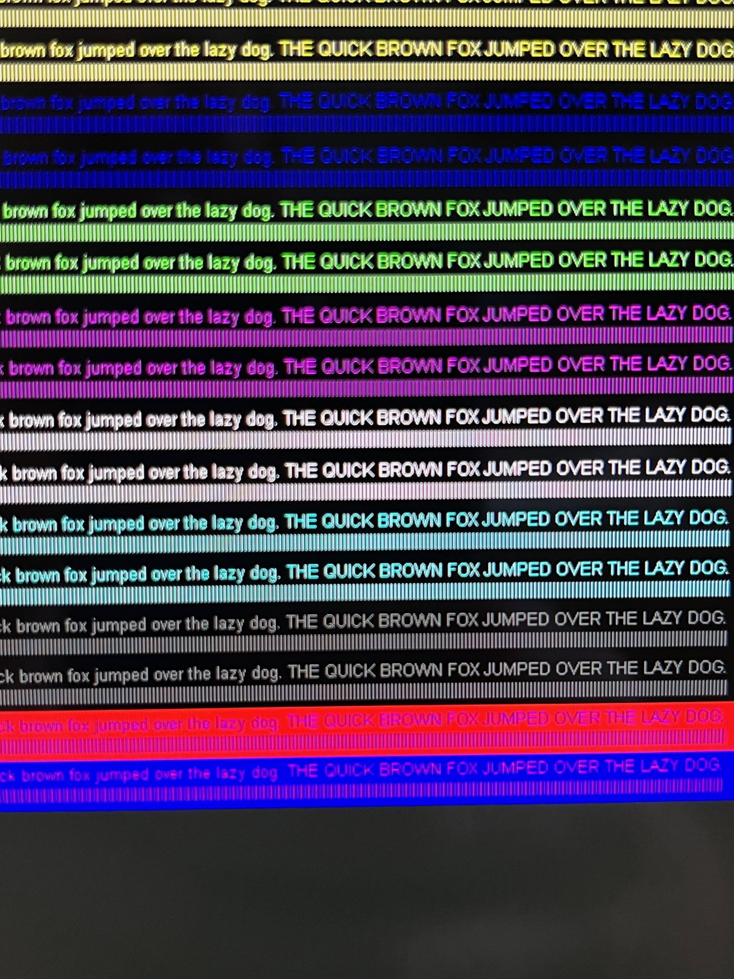

These are two photos taken by me; with the same camera (if you can call what my 13-mini houses such); same screen; same browser; different platform/soft.
If I read the room correctly, EugW was just quietly asking me to snap a new photo ;)
Yes. :D I find that taking these shots can be difficult because of the low brightness and the need to maintain some distance from the screen so the phone can focus. A stable base helps though.
Anyhow, thanks for all the pix!

The YCbCr 4.2.2 encoding shows itself in the RTings test mostly in the vertical line 'pipe' symbols:
The '4' means every pixel gets full luminance information, parts of the image that include some 'whiteness' are very well displayed.
The '2.2' means that the Cb and Cr component information are is transmitted for every second pixel.**
With pure blue and red pixels, there is very little Luminance (Y) component, so you only see one pixel instead of two.
Where there is a brighter pixel that has a Cb or Cr component, one pixel will have colour, and the next will be only white.
This is what @splifingate has posted. The camera shake is irrelevant, the image shows clearly that Cb Cr components are only being shown in every second pixel - when there isn't a bright luminance component.
The 4.4.4 images clearly don't show this artefact,
**Edit: My reply is simplified, because in the RTings image every coloured pixel in the rows of pipes is followed by two black pixels.
But they have constructed their image in such a way so as to clearly display the component compression algorithm - by ensuring some of the pixels that have Cb or Cr information fall on a black area of the design.
The following coloured pixel then has a luminance of zero, so any 'colour' doesn't get displayed. 😉

That makes sense and you and @thenewepic may be right, but it'd still be nice to see an updated pic when @splifingate isn't swamped with work.
Don't use Firefox. Open the .png in Preview with 100% zoom is the best, as I found Firefox has issue when displaying png in hidpi mode.

This is a crop from the previously-shared DGX screen:
Just an iPhone 'photo' I took.
This being shared: while the G32P is an exceptionally nice screen, I am not feeling the urge to spend USD1,9K on another. 6Kx32" might be enough for near-term single-screen work!
