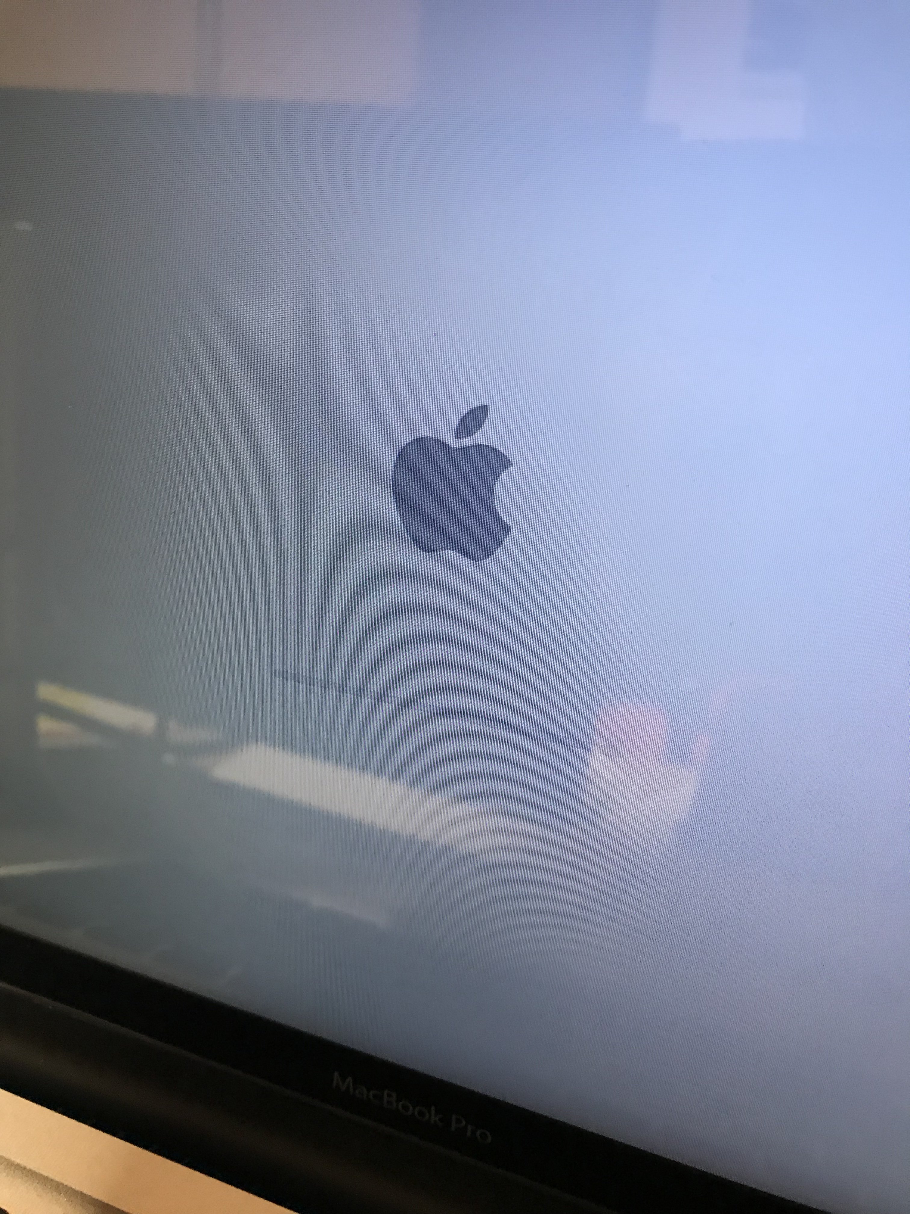

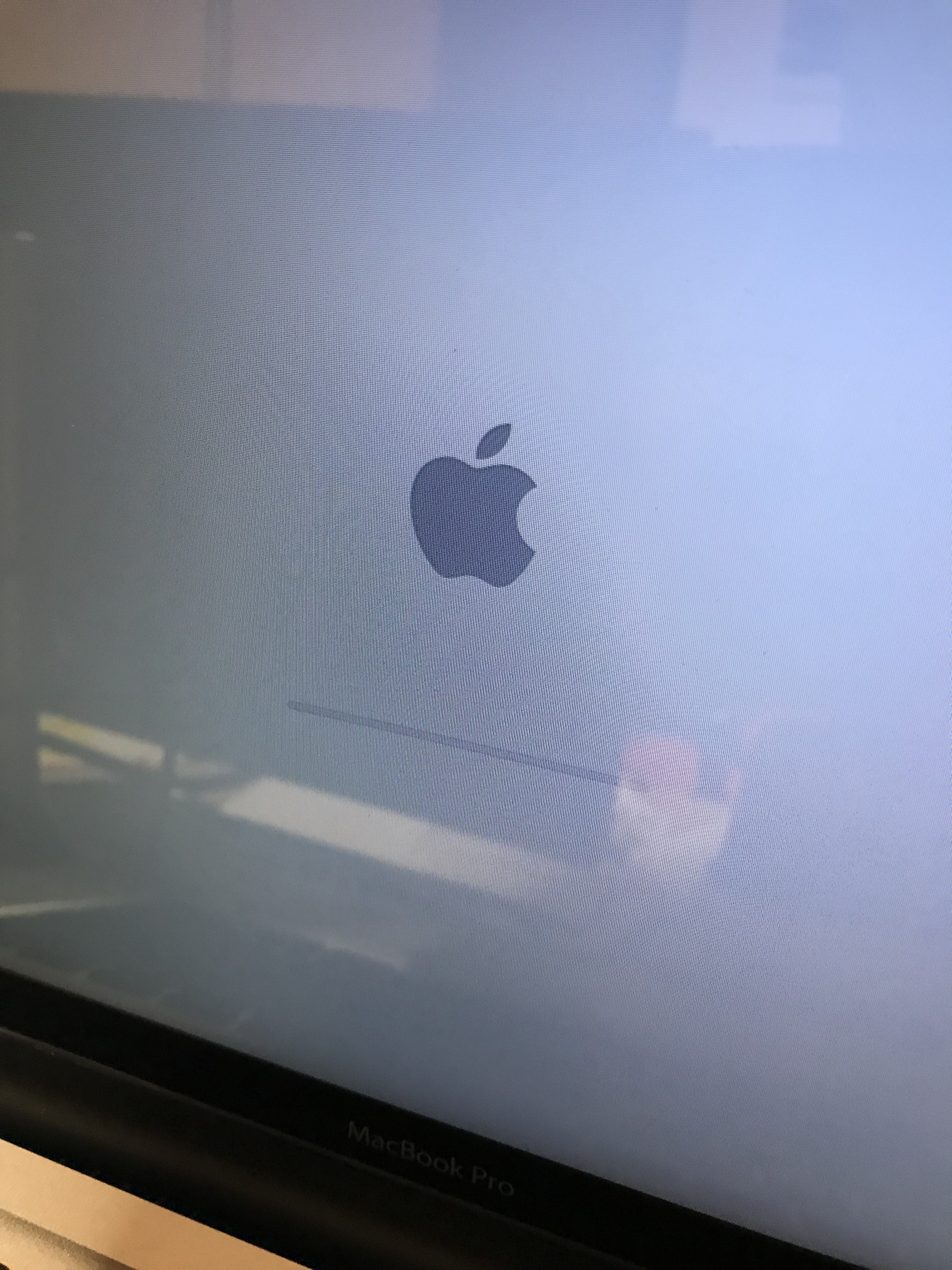

I tried it again and now it gets stuck on the Apple logo screen with the progress bar not moving at all - same as after the update earlier when I had to manually shut it down...
What to do now? 🙁
What to do now? 🙁
EDIT: after shutting it down again it finally loaded again and now I’m finally able to log into the system!
What to do now? 🙁
