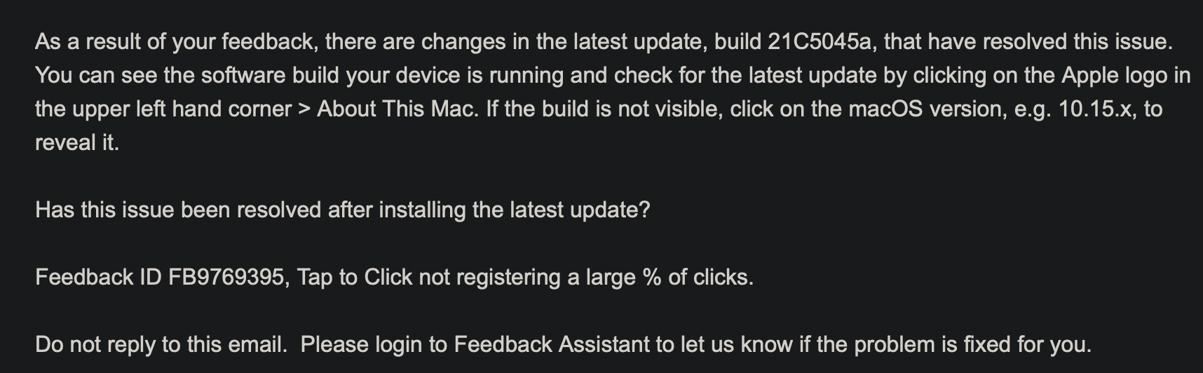

Is this email something everyone gets that reported the tap to click issue? If not you can all thank me and send me beer, girls, and money.

I’m using an external mouse, and the scroll jumps with a lot of miss clicks and at times opens things in 2-3 instances.
Is this issue related? I have trackpad still enabled with tap-to-click on 12.0.1.

No it didn't fix it completely. cmd+click still doesn't register sometimes. Not to mention other trackpad gesture issues
