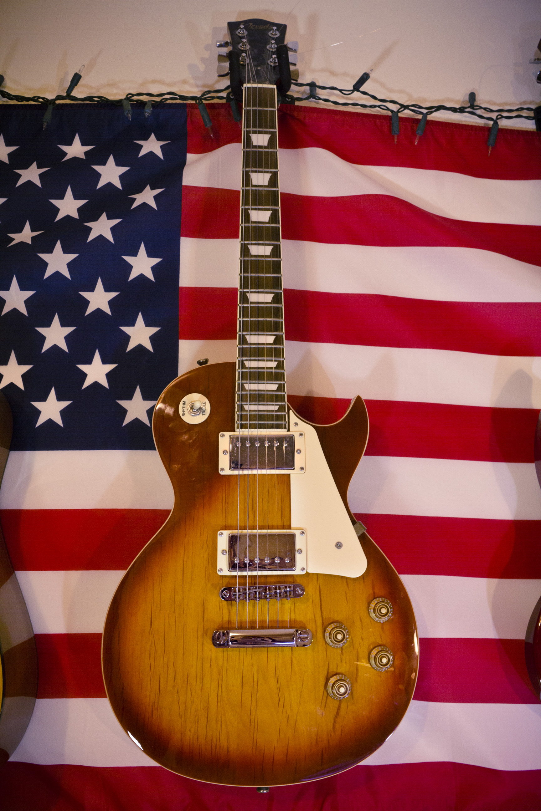

Here's the guitar, I'm going to spend tomorrow taking it apart, sanding down the paintwork and beginning to get it all nice and smooth for the initial primer.

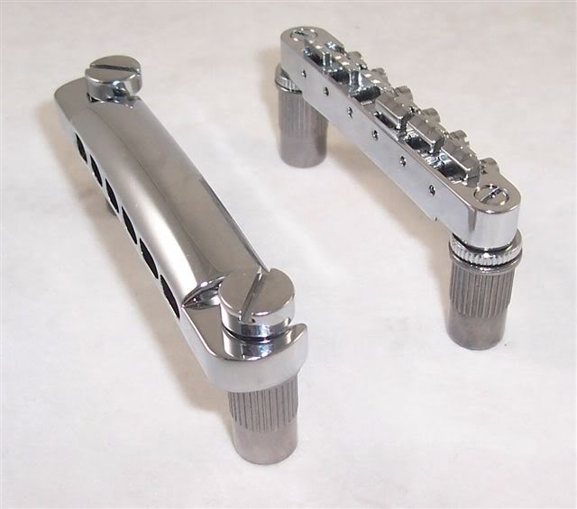

12 string bridge and tailpiece:

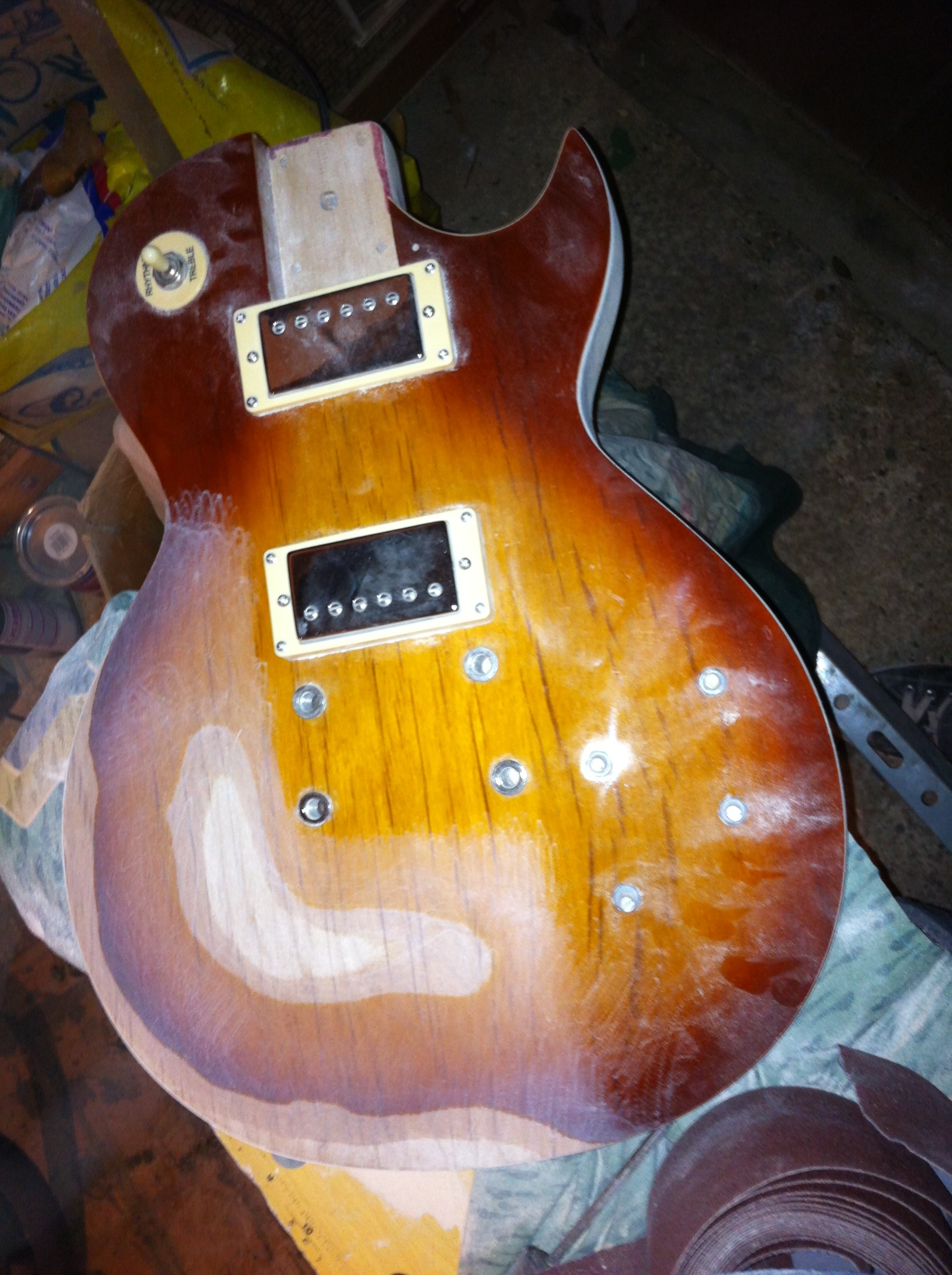

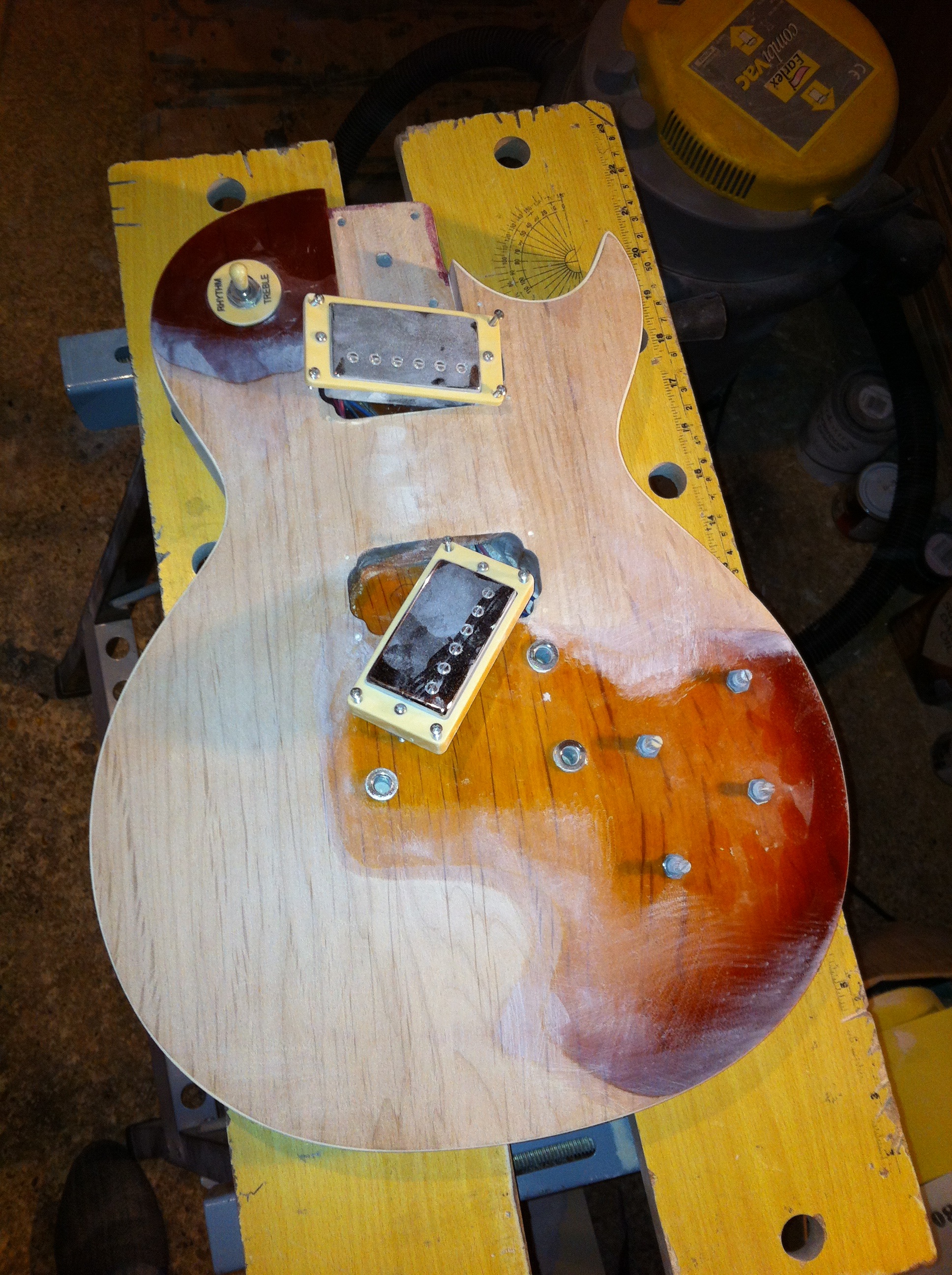

Here's some photos of sanding today, almost completely finished, just gotta get the last few bits done then it's all good to go, paint won't arrive for a while so it'll remain like this for a bit, will probably get build before it gets painted thinking about it.

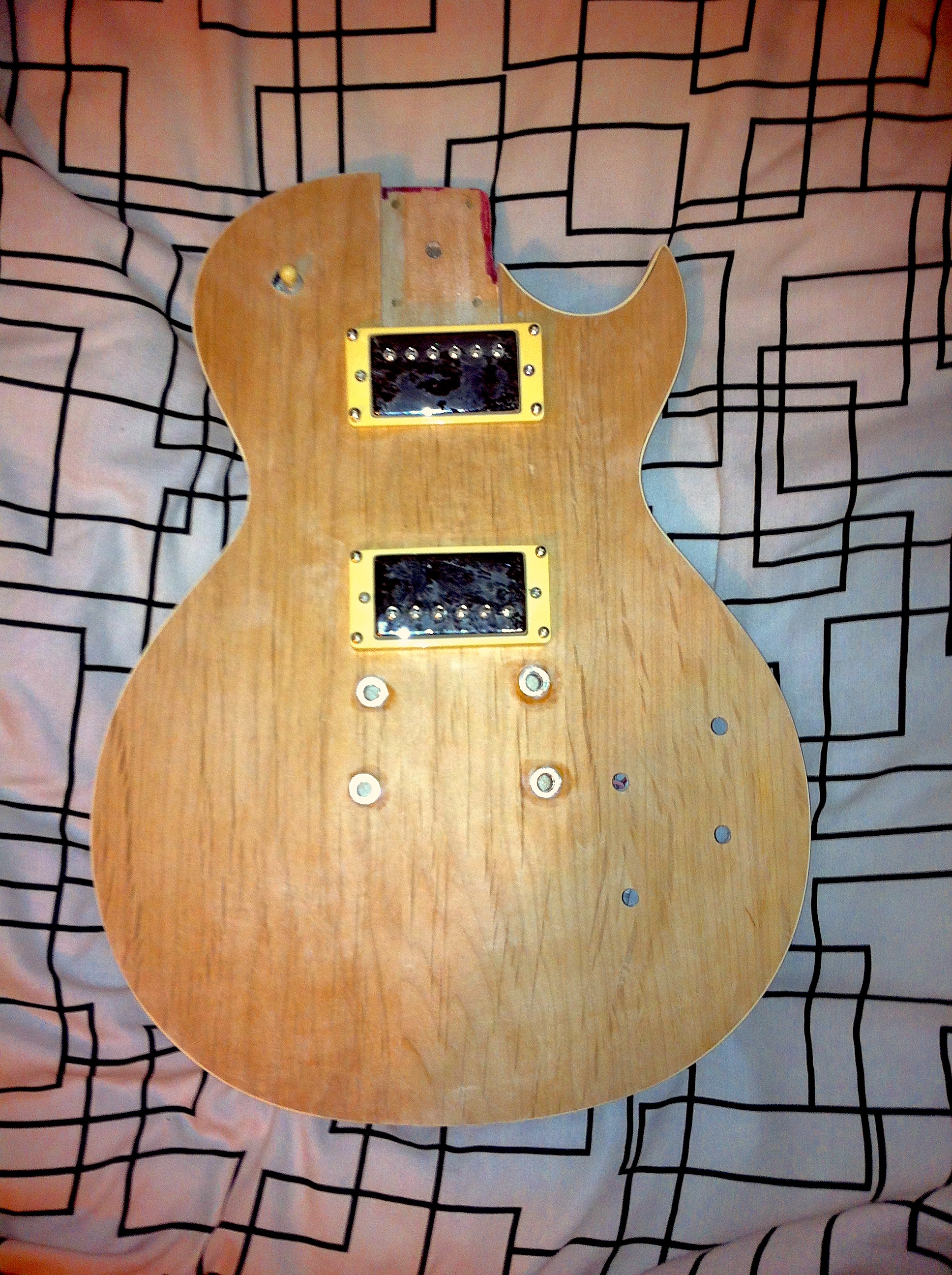

So here's the initial sanding finished, still very rough in places, definitely needs some much finer sandpaper on it, very tired now though and enough is enough for tonight. Still not received the neck/headstock, the tuners have arrived though which is good.

So, ignoring the crappy quality of the photo I took, I'm thinking about having it natural, it looks quite a bit lighter in real life and I think it might just look a whole lot nicer than painting it pale cream, which is pretty much the colour of all the decals.
Thoughts?
