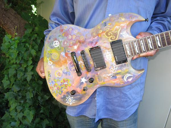

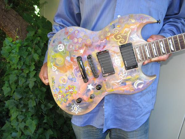

Right now, I am taking on a slightly less ambitious project but still time consuming. It's my own little take on making my very own Custom ESP Viper without having to shell out four or five grand.
I have an ESP/LTD Viper 301 (SG copy) which I have previously painted similar to Eric Clapton's Cream-era SG (see hippy guitar I own right now) and I :
1) took off the artwork on the painted side on the back.
2) After that, I shaved off a lot of the mahogany of this LTD/ESP to make it thinner and lighter in weight like the Gibson SG. The ESP Viper, like the attached pictures of the black and white ones which show the side view and larger mass of this model, show just how thick this guitar is compared to a Gibson of a similar design. The only advantage is that the heavier body makes this guitar balance better while standing up.
3) Today I finished putting a slightly reddish sealer and primer on the back of the newly thinned out body. I may sand and put on another thin coat.
4) When sealer primer is set down in place and pretty consistent, then I will repaint another '60s inspired design on the back of the guitar. As to what it will be exactly, who knows, really?
5) To finish off the overhaul, I may take out one or both of the high output EMG passive humbuckers (EMG HZ-1s) and put in a more moderate pickup like a DiMarzio Eric Johnson model, DiMarzio Air Classic, Seymour Duncan Phat Cat, Fralin P-92, or similar brighter, less powerful pickup. It will be a lighter weight instrument with a lighter sound, too. 🙂

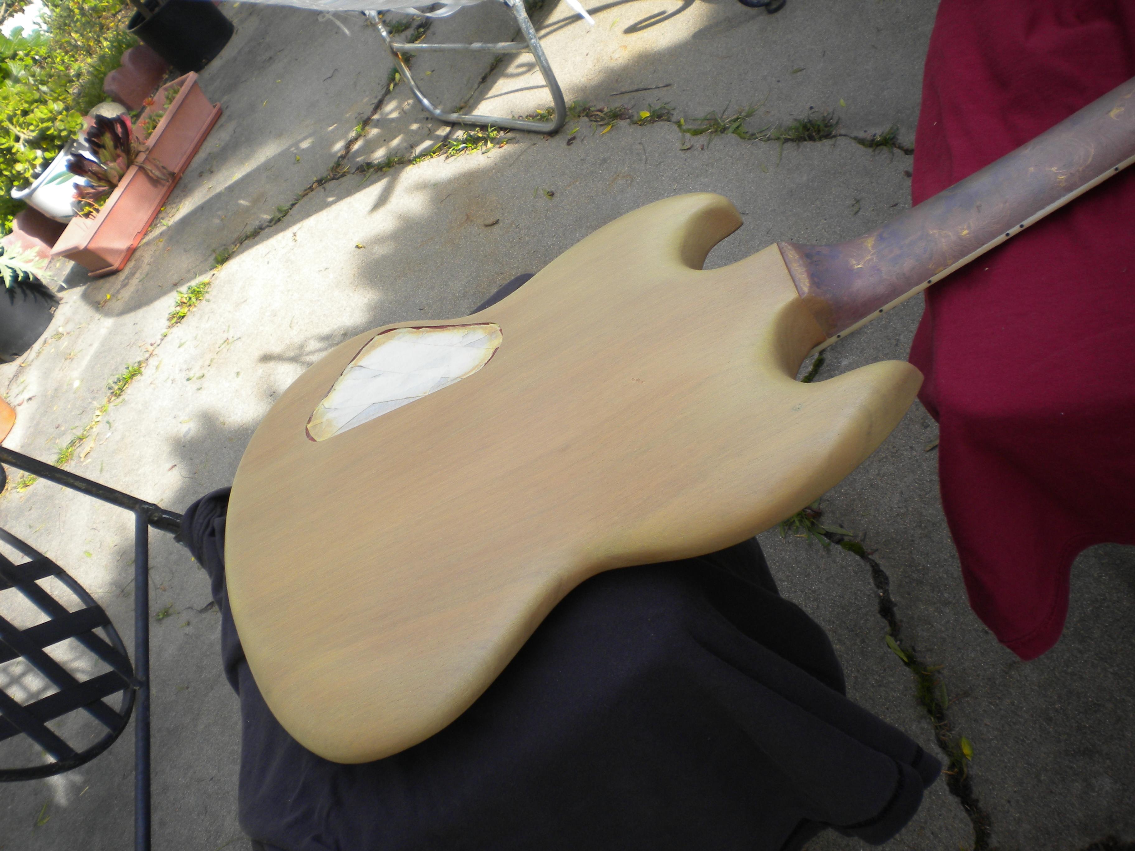

So here's the initial sanding finished, still very rough in places, definitely needs some much finer sandpaper on it, very tired now though and enough is enough for tonight. Still not received the neck/headstock, the tuners have arrived though which is good.

More sanding today, much finer paper, much smoother now, probably going to be a while before I post again as there's not much more I can do till stuff arrives, that and I've got to deal with trying to get a refund for my TV, the stand completely broke, fell on the floor, smashed the screen, always nice to come home to.

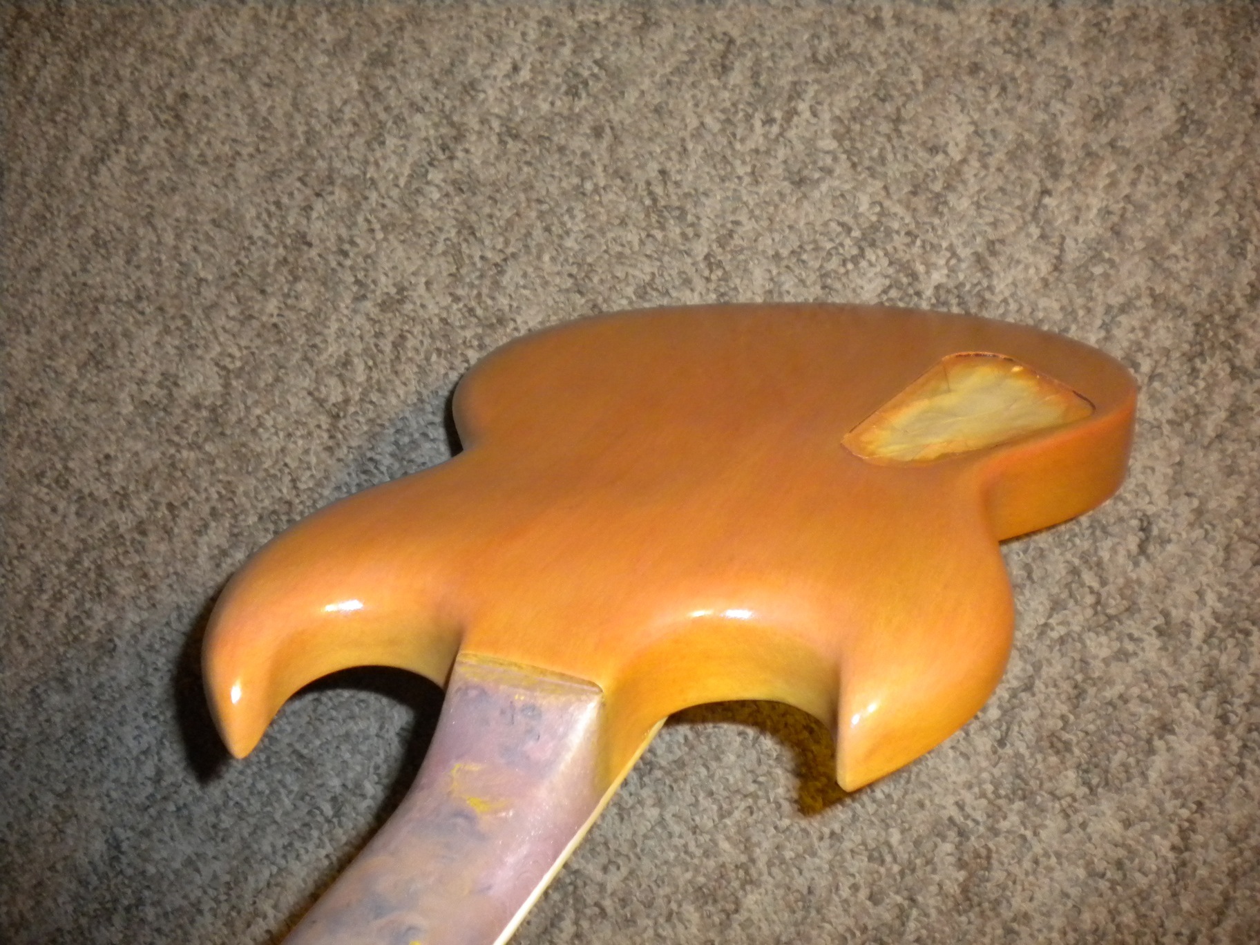

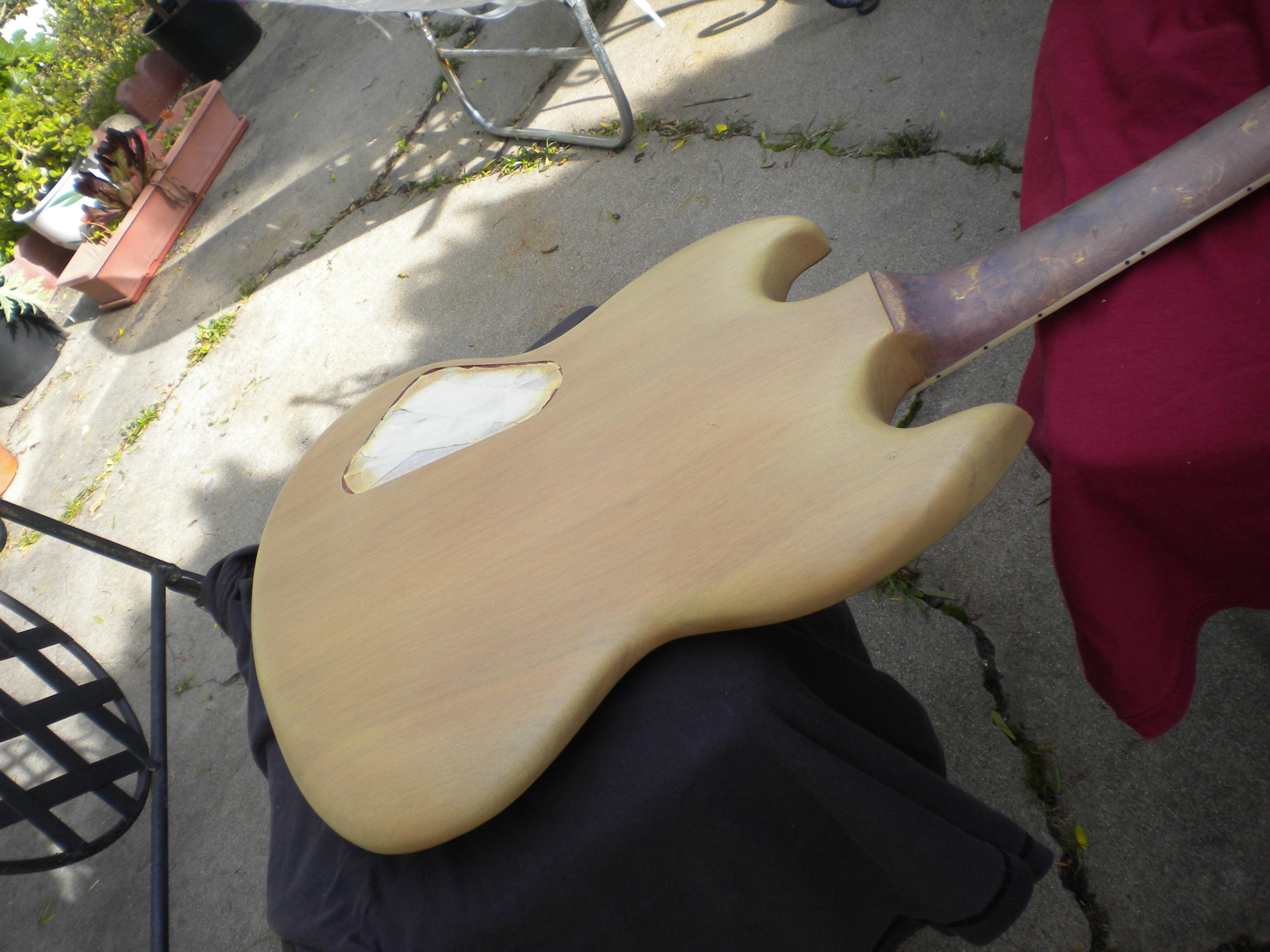

Anyway, here's what I just finished an hour ago on thinner body for SG copy which makes guitar about one pound less in weight. Isn't this all fun? 😕
You can see detail in pix with magnifying glass icon and it looks like I need to sand it off some more before second coat. What type of sand paper should I use? There is a little roughness coming through the wood past the finish (water based opaque polyurethane diamond coat over reddish brown wood stain).
update: Newer picture (1/5/2011) is after putting a little more red to tint and a couple of coats of polyurethane. Much of the air bubbles from wood grain poking through is covered up due to in between sanding but it will take a coat a day, with more sanding in between, for a few more days to get a uniform sheen to cover up boo-boos and two places where I once had misplaced strap buttons.
Oddly, after that, I will rough it up a bit for the artwork to go on it. I think it's going to be a detailed art thing with sharpies and then several matte clear coats over that similar to the acoustic guitar picture with artwork drawn over natural wood finish. The back of the neck and front of the guitar will retain the purple acrylic artwork that was painted on it six years ago (post #28). It's so hard to envision just what this whole thing will look like. If I didn't have a set-in neck, I too would consider making this six string electric into a 12 string electric like yours.

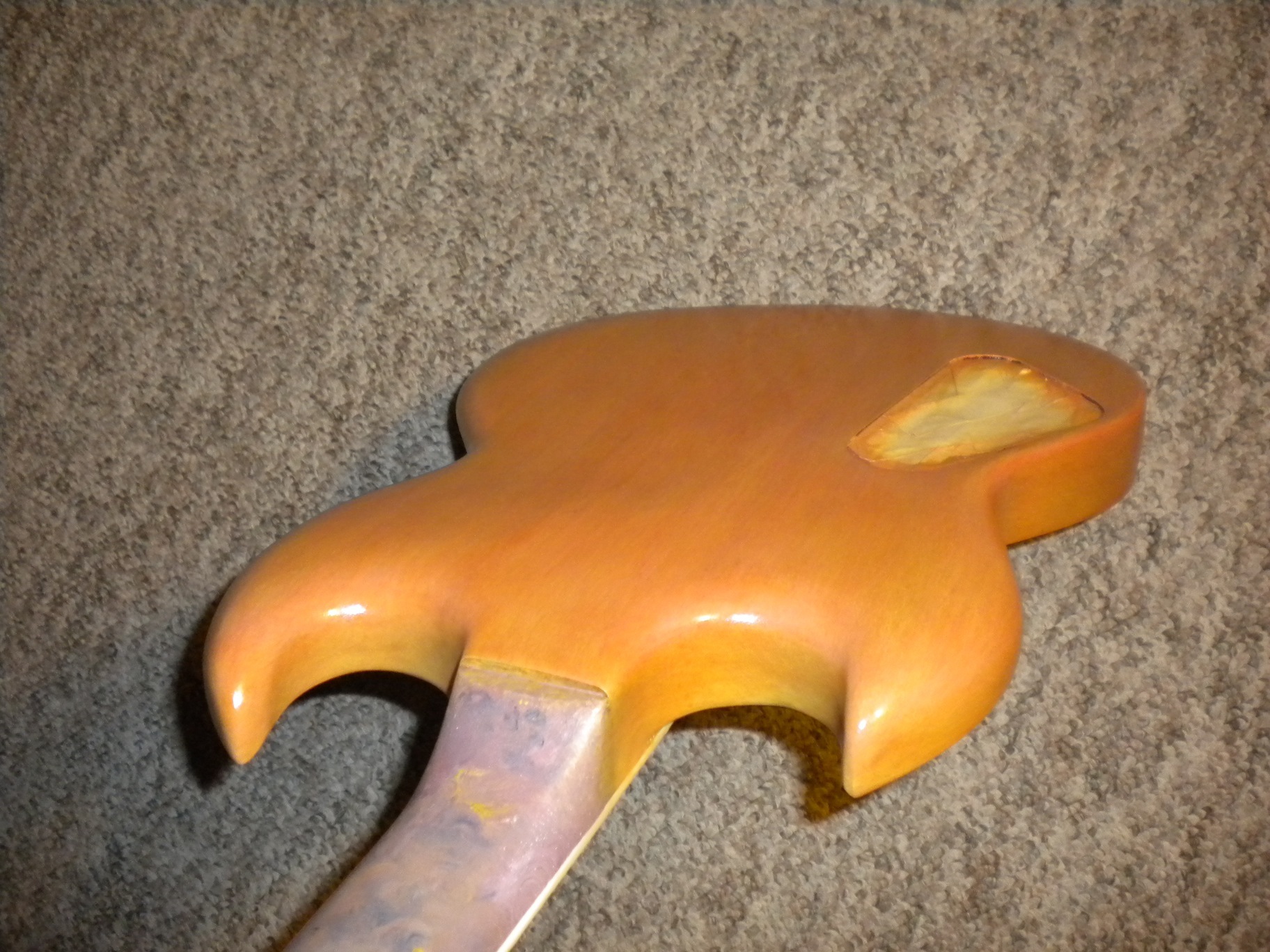

That's awesome man, looking good, I like the super rounded edges, that something you added in whilst thinning?
Definitely keep sanding, I used 60 grit, then 80 then 120 and mines pretty damn smooth now, takes a long time though, specially with the 120, and it gets really frustrating if you notice a tiny dip, gotta break out the 80, then 120 all over again :roll eyes: Tedious work.

Just when I think I am able to paint design on back (like front), then I see a flaw I have to pick up. I used very heavy grit to thin down guitar and round edges to make it more ergonomic, medium heavy to make it smoother to approximate shape ready to seal, and medium fine to get it as good as I could by hand without professional sanders.
I only used finer stuff between coats. The hardest part is to hide roughness from mahogany grain. It's altogether much more tedious than alder or maple which are much easier to seal up and put a final coat on. I have to leave some roughness in order to paint design on the back and then put a few final coats of matte art sealer on it to protect art work.
When I get a few more coats on it and sanding between coats (unfortunately without buffer), I will get a design on there and post the finished project. Much later on will I get a pickup or pickups (to work out a much more treble like snappy tone) and then post the finished project. If I had a sprayer and buffer I could make much quicker work of this all but the doing the thing by hand (with brushes, cheese cloth, and tons of hand sanding) makes me appreciate the guitar builders of old before electricity much more.

I used a combination sealer/stain in a redwood color to make the white mahogany get a Honduras red mahogany undertone.
