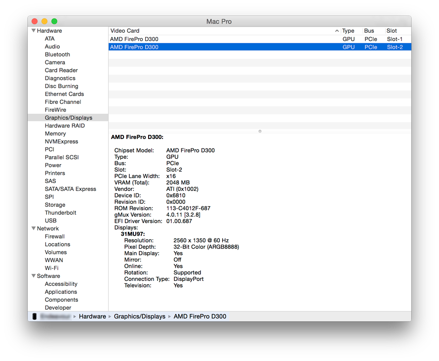

To check the refresh rate. Choose "About this Mac" from the Apple menu and then click on "System report". Under "Graphics/Displays" you'll be able to select the graphics card and see the refresh rate.
Here's mine - as you can see running at 60Hz. 🙂
Checked it and 60Hz it is. Thank You.
