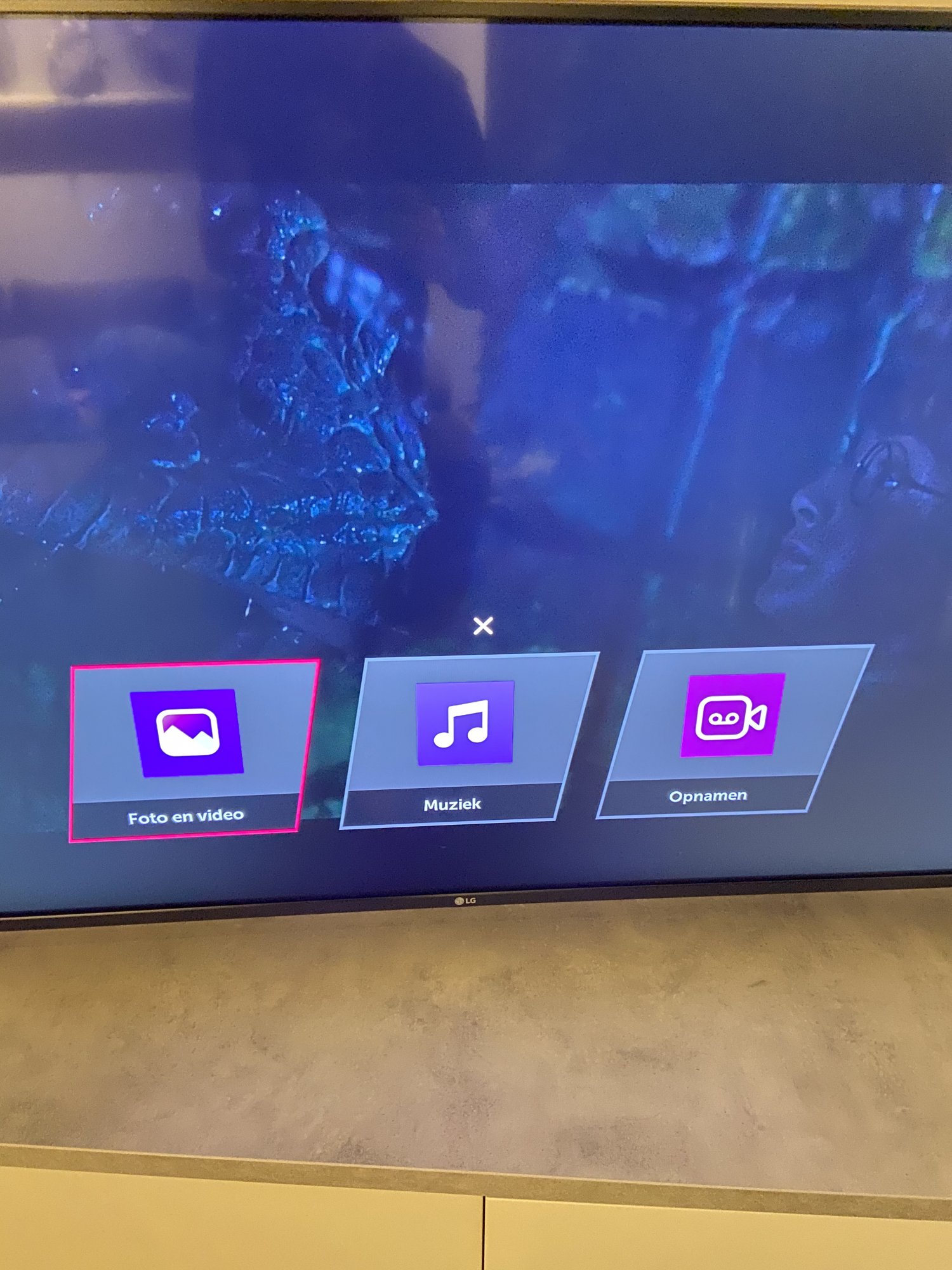

I formatted both as FAT32 and as NTFS and it my tv does not str-art the update on any of the 3 USB ports
I get this image all the time whatever I try

Yes I was meaning formatted, sorry. For me it worked.
Have you tried with another USB memory device?
I tried a
USB2.0 4GB usb stick
USB3.0 8GB usb stick
External SSD 250GB
And all tried NTFS and FAT32
None of them worked on any of the 3 USB ports on my tv
I don't get it...
Question to those, who did the update with the USB-stick and didn't succeed: did your TV say, that you have the wrong firmware?
Background: I have an OLED55B87LC and on the support page of LG isn't any firmware version for this TV (but I did get frequently updates). I would like to try the firmware of this post because I have an Austrian model (not Australian haha) and think they could be compatible. But I don't want to brick the TV.
As far as i know and tried if the software does not match with your tv, nothing happens. The file is not read by tv. I tried with my 55uk7550pla but could not update it :(
