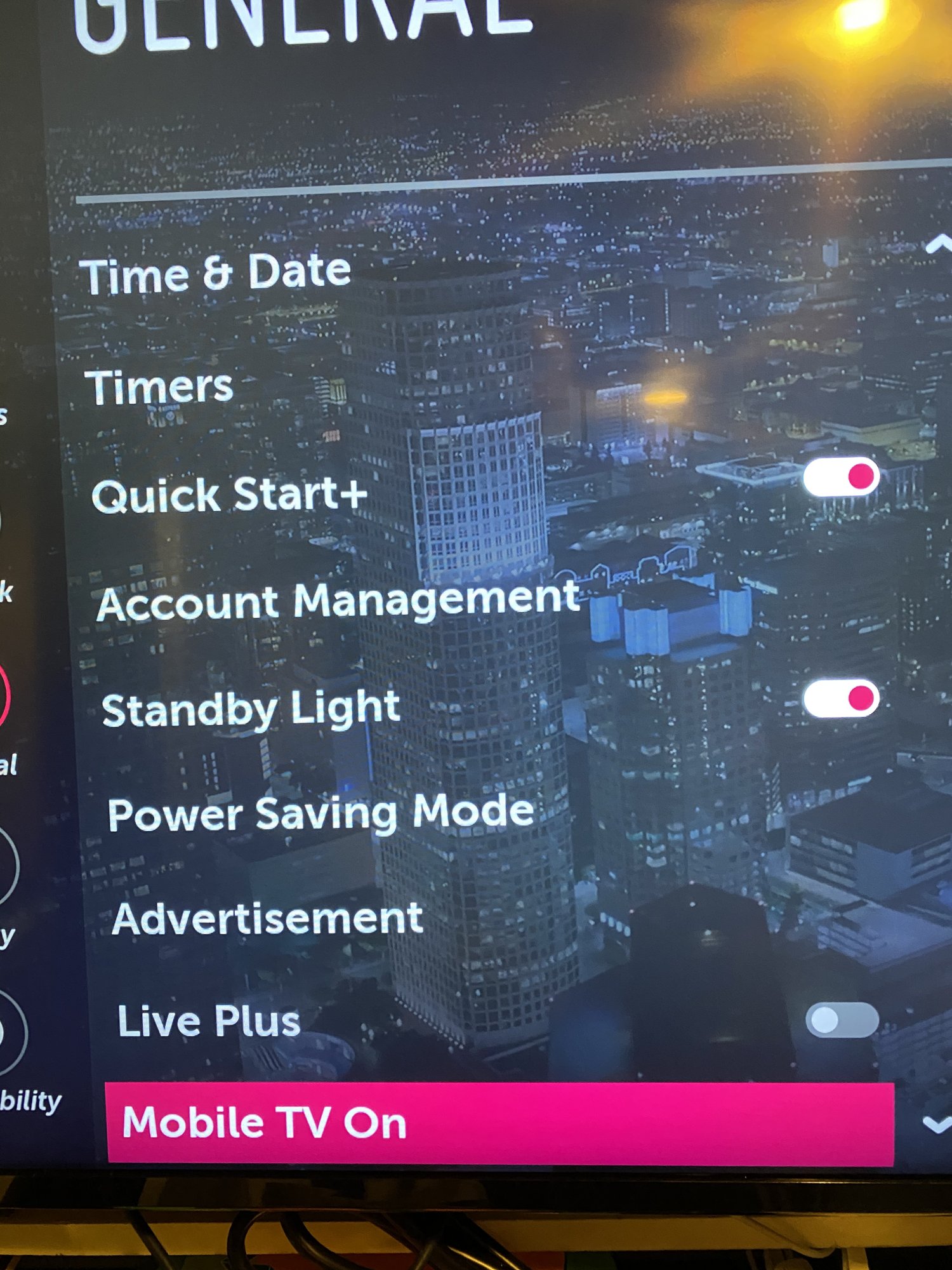

OK, so when I checked the LG site here in the States, it showed the 05.30.10 update available for my 43UK6200PUA. But no matter how many times I tried to grab the update OTA, I couldn’t.
So I downloaded the file, slapped it on a USB stick, and updated the SneakerNet way.
Everything is running fine except… HomeKit/Siri can’t turn the TV on. When the TV is off, it shows as “Not Responding” in Home.app.
I’ve got all the relevant functions turned on in Settings on the TV: Mobile TV on, Quick Start+ on… How the heck do I get the TV to respond to the power on command?
Is your phone or device near the TV and does you TV have Bluetooth?
My phone is about six feet away. My HomePod mini is literally under the TV. And... I don't know if the TV has Bluetooth. I didn't see anything in a menu about it.
So apparently LG made it where it connects to HomeKit via Bluetooth instead of wifi, and it connects to you device rather than the HomeKit hub, both of which are stupid.
