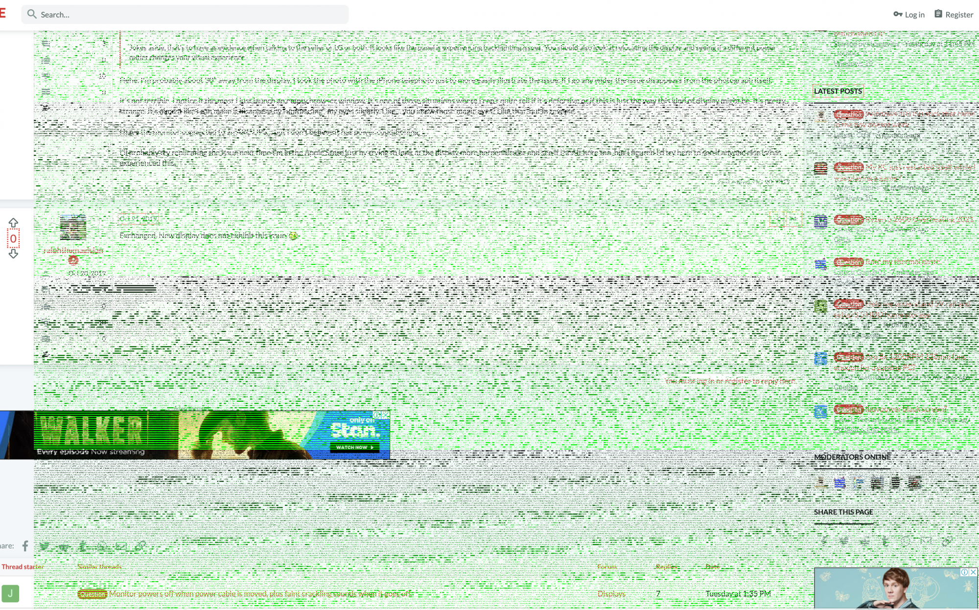

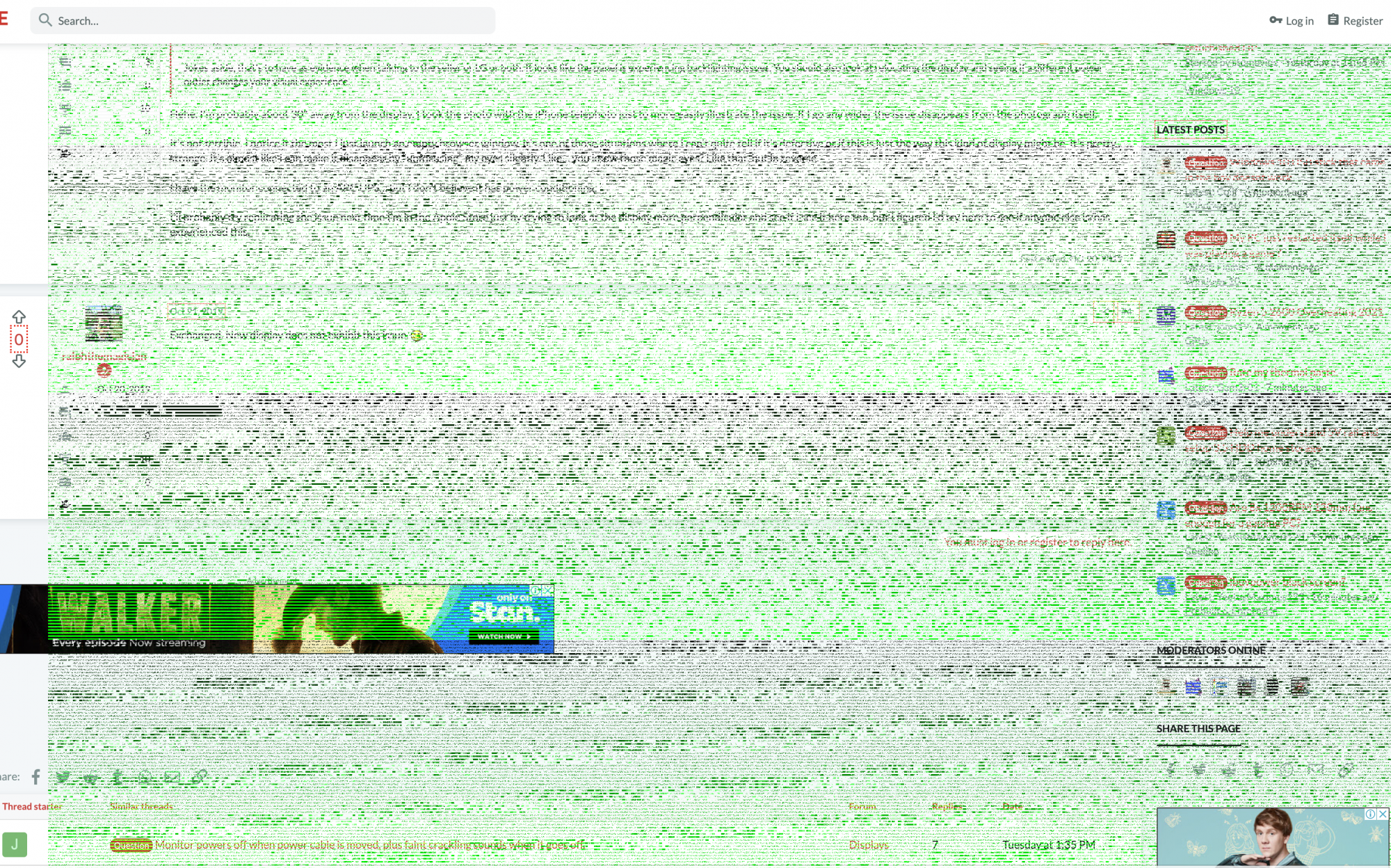

I suddenly get the same thing on my LG5K running off a 2020 MAckbrook Pro 16. I have the same setup at my office but the screen at home does this - image attached.
Apologies for a dumb question, but what should I say to Apple support> You say this is best described as a backlighting problem. I just know from past experience that if you don't have a clear enough description of your problem they will bounce you around.
I run the monitor through a Caldigit docking station.
Thanks
Sorry.. just seeing your question. When I talked to Apple I said it appeared to be a backlighting issue where part of the LED's would dim when I'd dim the screen but the other part would stay lit. But it's been about 4 years so I don't really remember what they said other than Apple pointing the finger to LG and LG pointing the finger to Apple. I just bought another monitor and returned the defective one. Haven't had a problem since. The picture you attached, however, does not appear to be a backlighting issue--I'd try seeing if not running it through the docking station makes a difference and if you have another monitor you can swap out, see if that one works. I'd think (and I'm by no means an expert here so this is just a guess) that if the other monitor works, the problem is with a defective LG; if the docking station removal and connecting the monitor without using the dock works, it's the dock; and if the other monitor works, maybe it's a bad graphics driver? Good luck--hopefully you already got this fixed.

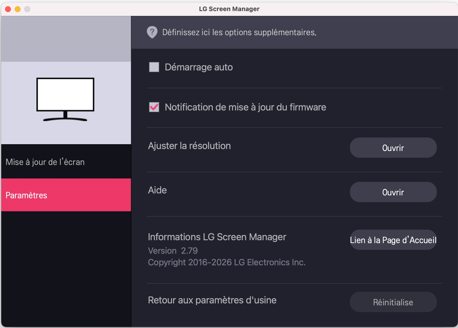

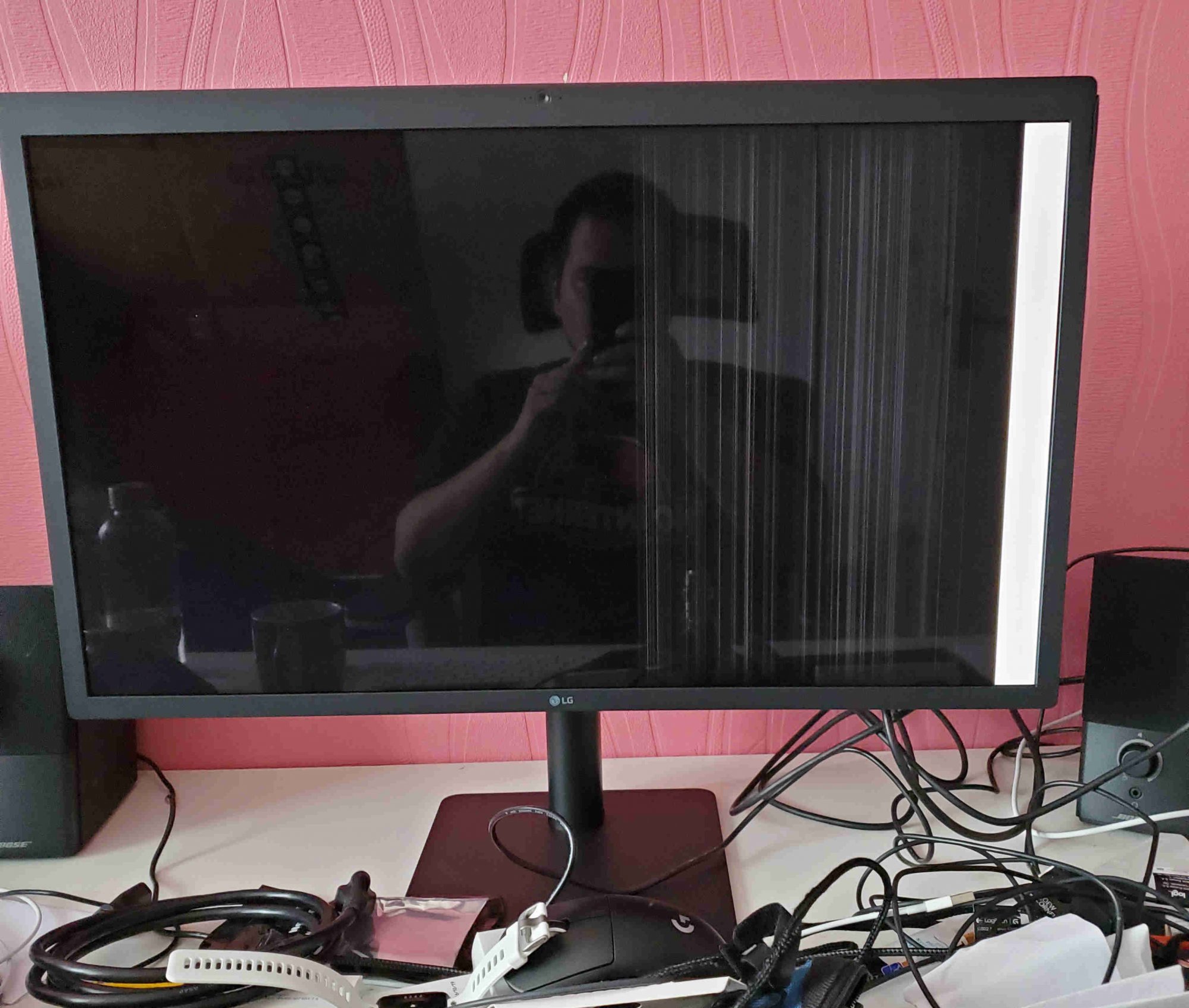

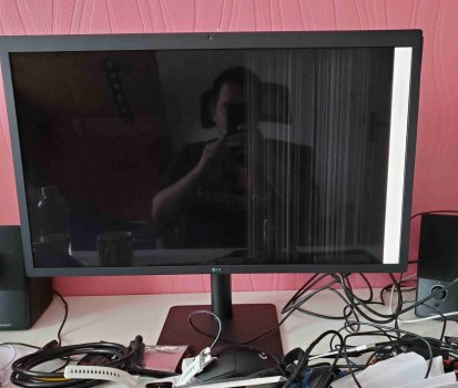

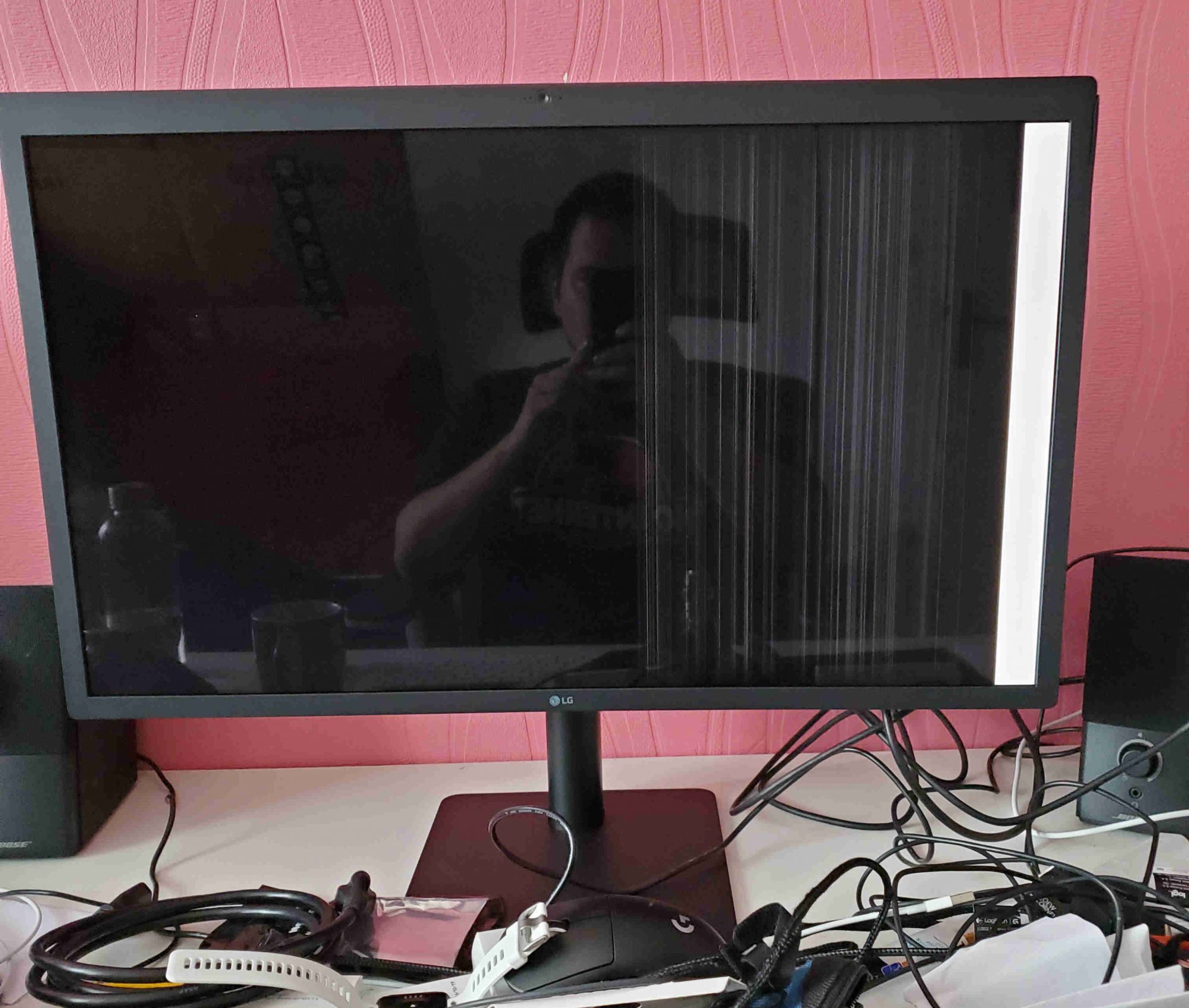

hey,
Just bought a used LG Ultrafine 5K (for Mac) on eBay for my Macbook Pro M1 (Big Sur with last updates).
It's not working 🙁
I downloaded LG Screen Manager en Apple Store. No firmware update is available.
What can I do to fix that ?

hey,
It's not working 🙁
Verify you are using a good TB3 cable. Use the TB3 port, not any of the three USB3 ports. Otherwise send it back as dead on arrival.

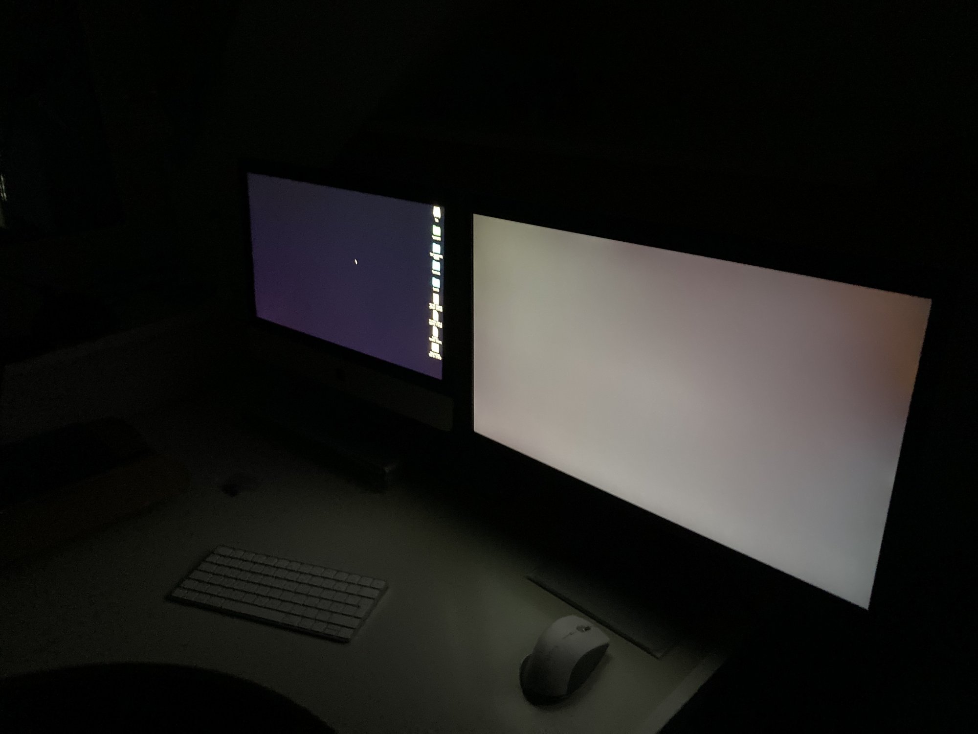

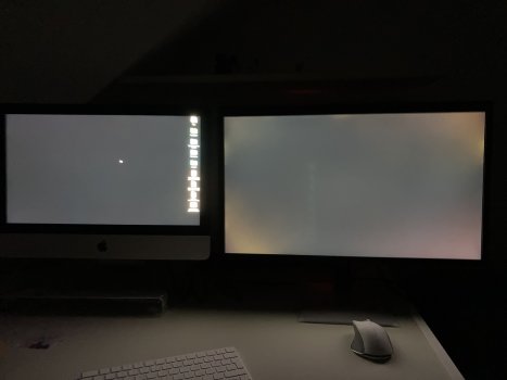

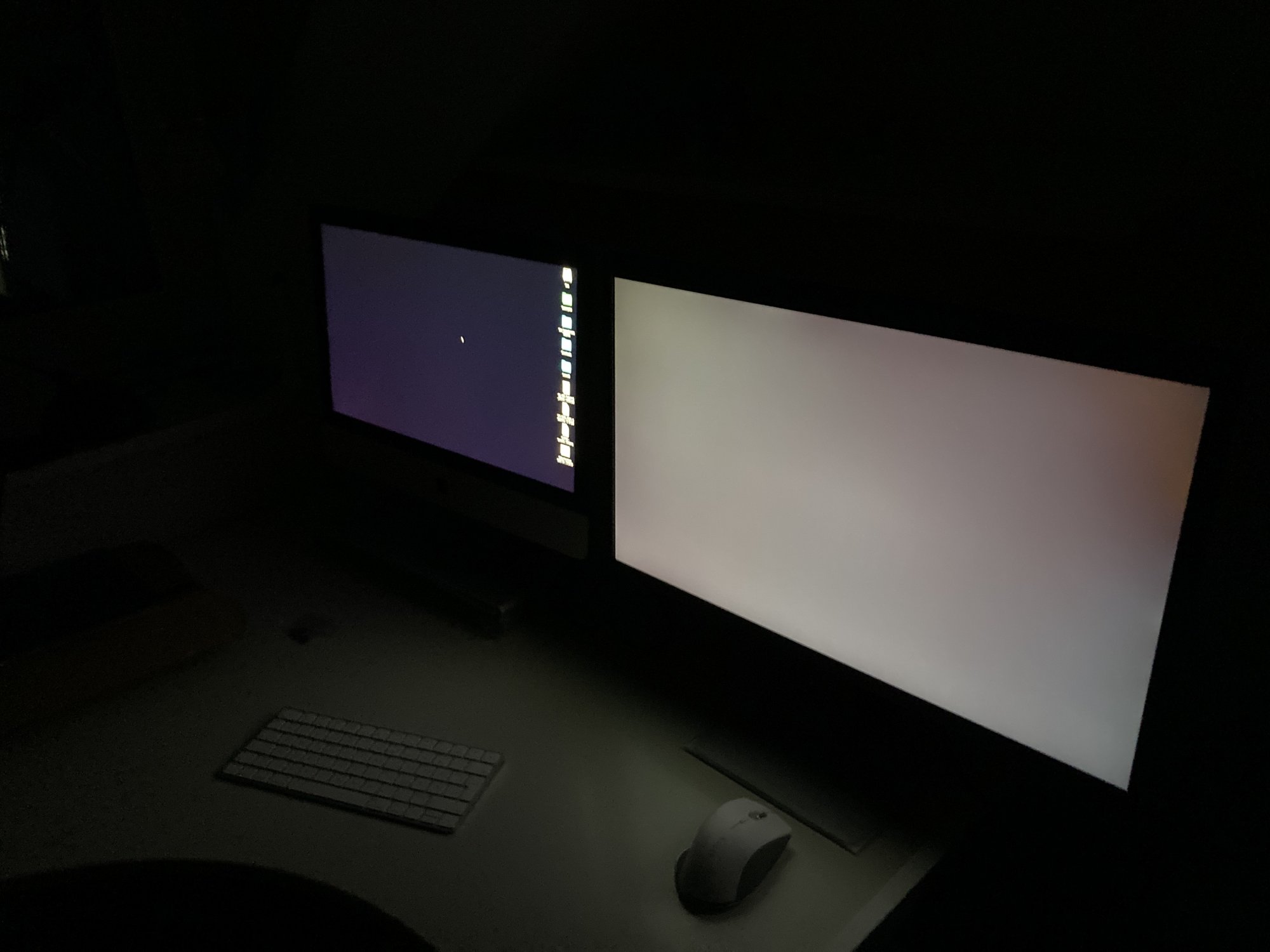

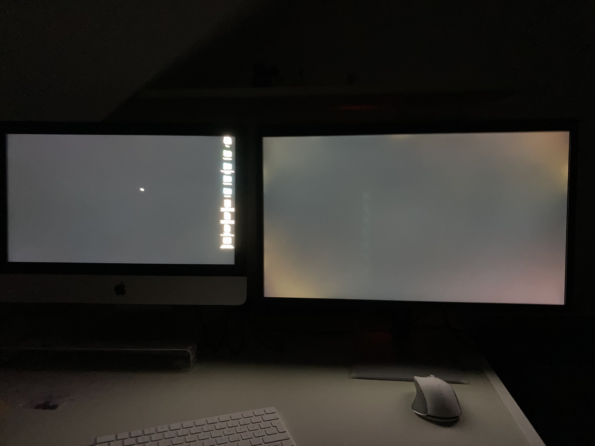

Got the LG 5K today to accompany my iMac 21.5 – but the viewing angle stability and the color shift on the edges are much worse on the LG. For the pictures I turned off the light in the room and used plain black wallpaper on both displays. The photos exaggerate the problem a bit, but I'm definitely disappointed about the image quality of the LG.

^ YIKES! Thats unacceptable
