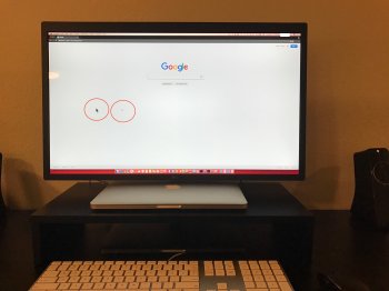

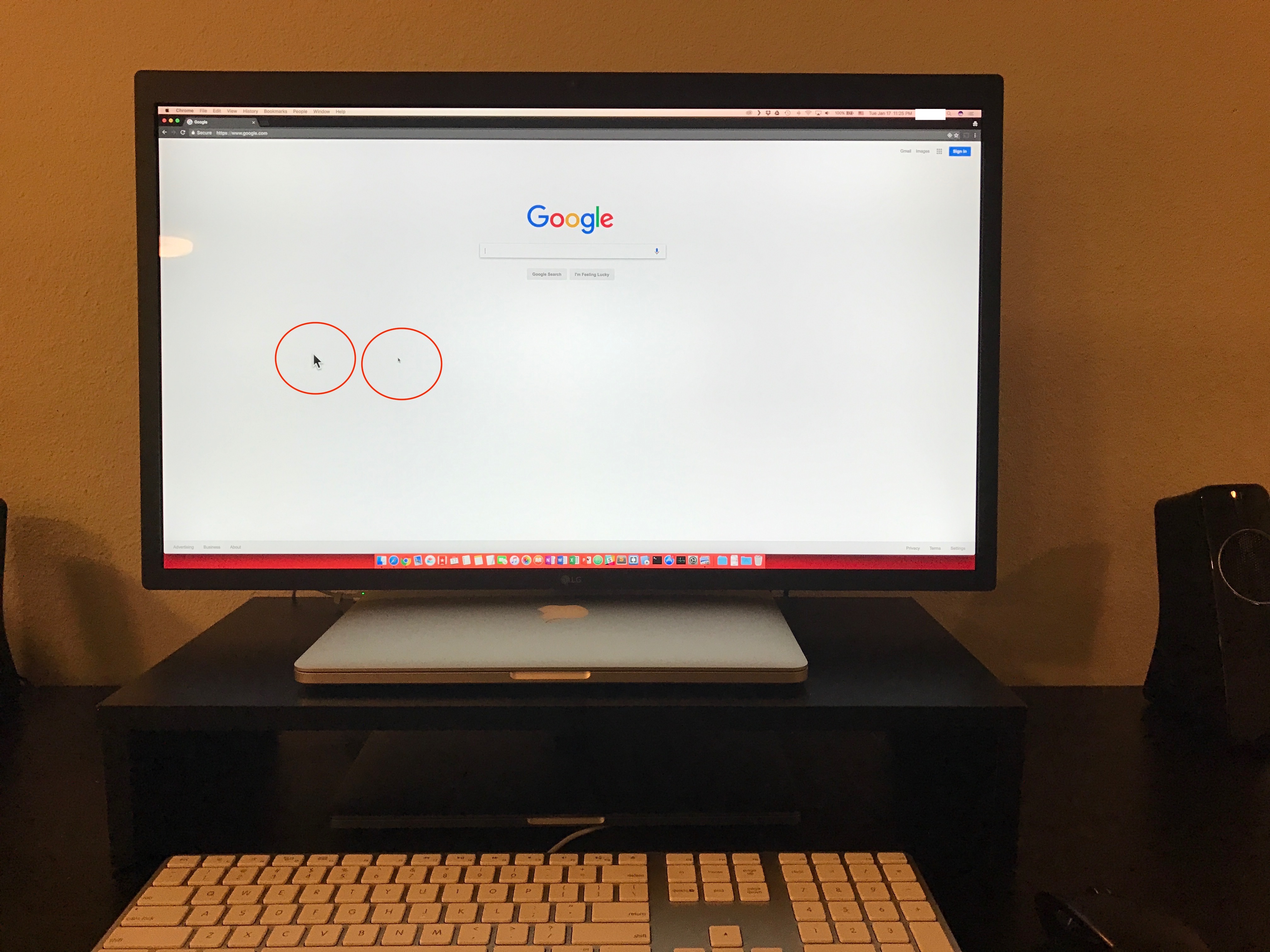

Everything works smoothly with my base 13" tbMBP, except the weirdest bug: if I accidentally engage the enlarged pointer by moving my mouse too quickly, even for a split second, it "sticks" and nothing I do (short of a full restart) can get it to go away. It doesn't show up in screenshots, so here's a picture.
Edit: the regular mouse pointer continues functioning as normal. There's just an additional frozen enlarged pointer stuck on the screen from that moment till I restart the machine.
You can turn that feature off...at least you may want to until Apple fixes the problem.
Also happened to me. Unplugging and replugging the monitor solves the issue (without needing a full reboot). That being said, this only happened twice so far (both on the 1st day of my setup). Hasn't happened since.
