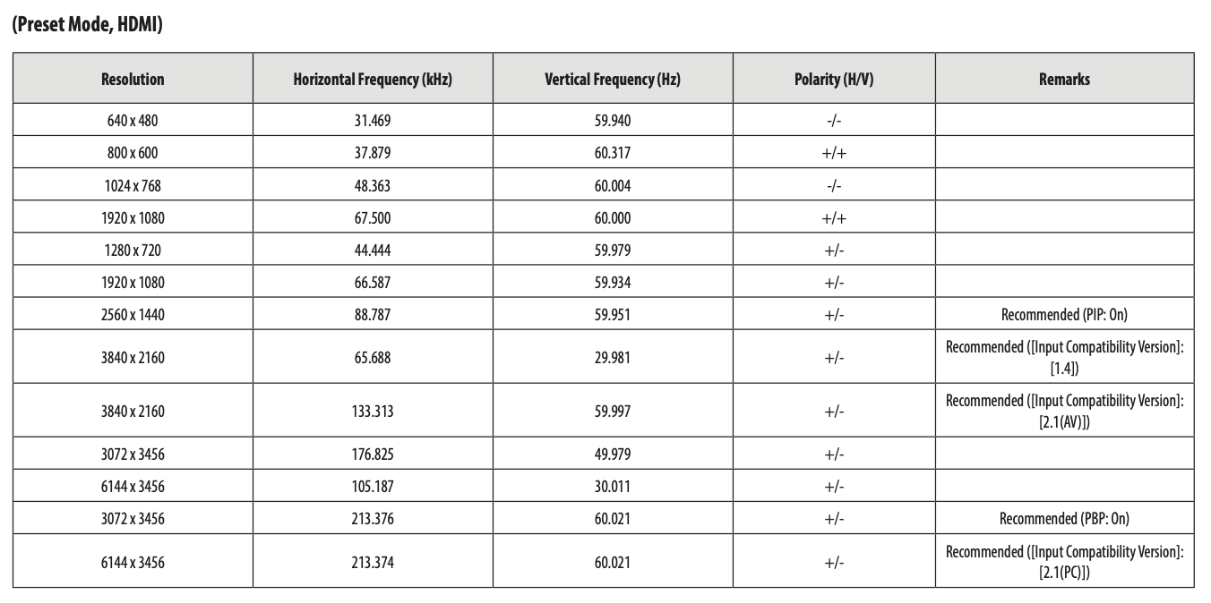

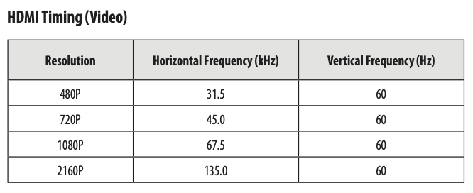

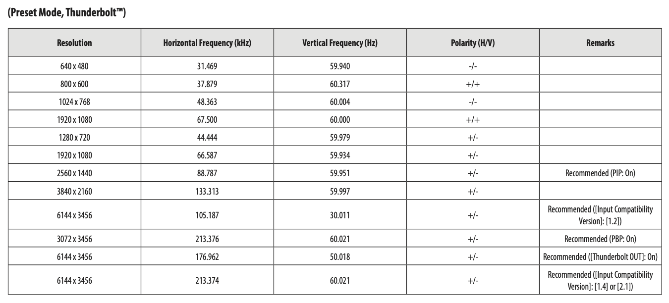

But did you notice that the 6K Kuycon G32P Glossy Screen offers 4K 120Hz and even 144Hz in WQHD?
It would be very interesting to know if the LG 6K can do that too.

Well, that's great, but even with just 60 Hz some people with the Kuycon 6K are having Tahoe compatibility issues on Thunderbolt 4.
Just reached out to Kuycon re updating to MacOS Tahoe 26 and received this response:
"Based on previous user feedback about slow response, it is recommended not to upgrade to OS26 yet"
When asked to elaborate they replied:
"There are no settings available on the monitor side; we need to wait for macOS to continue updating and become compatible"

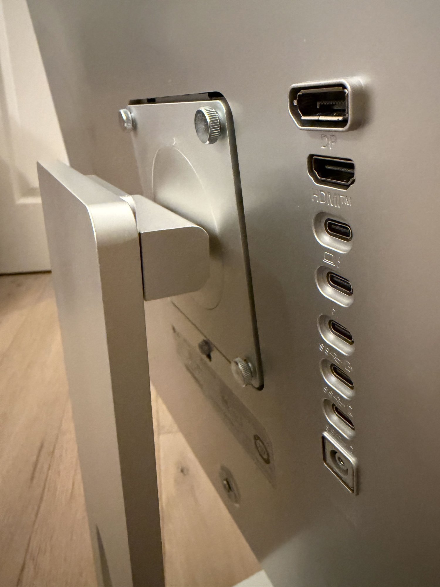

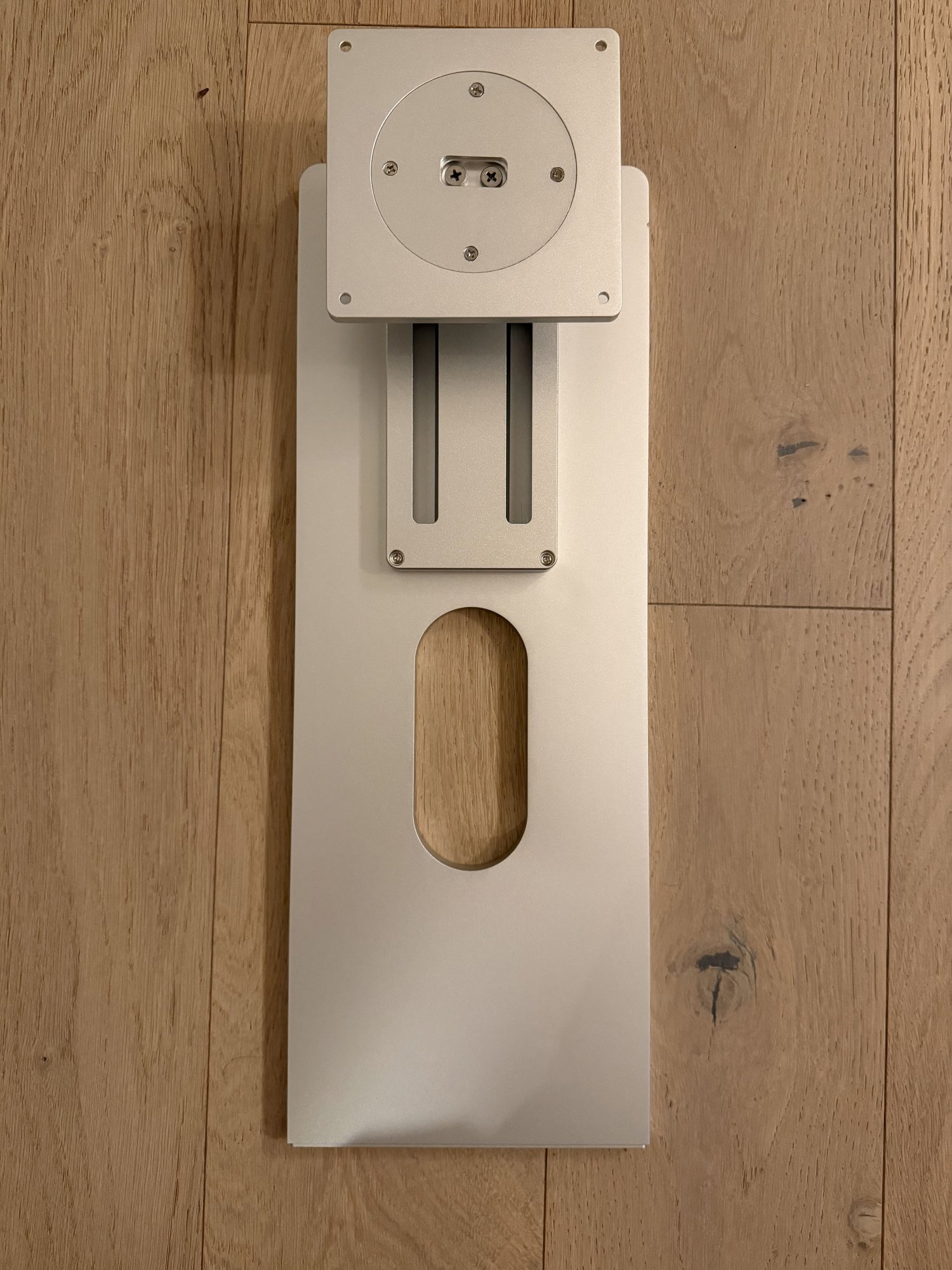

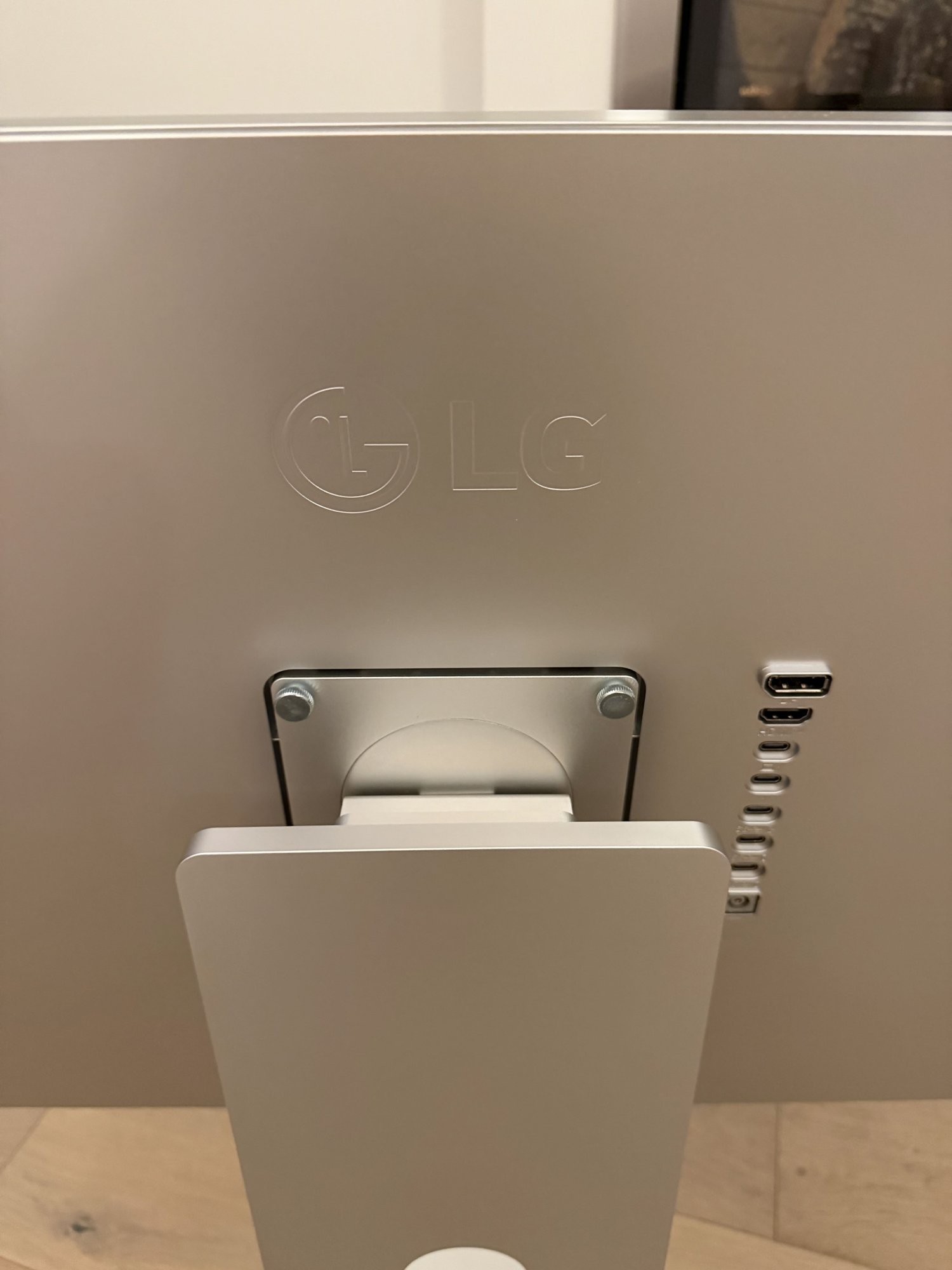

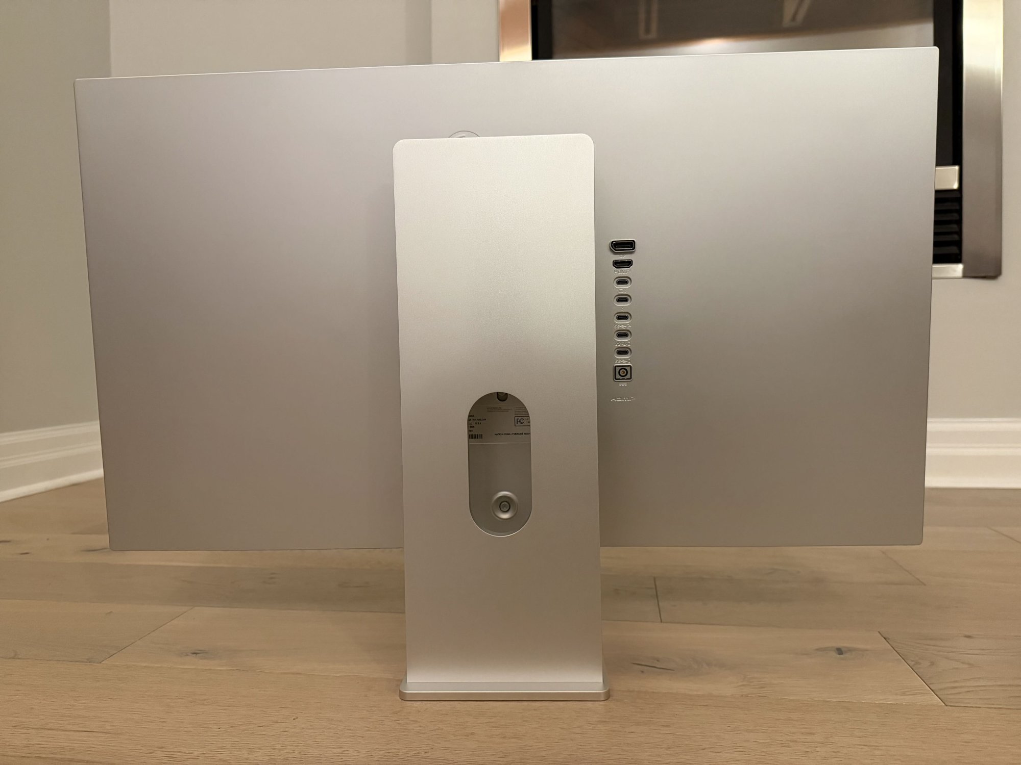

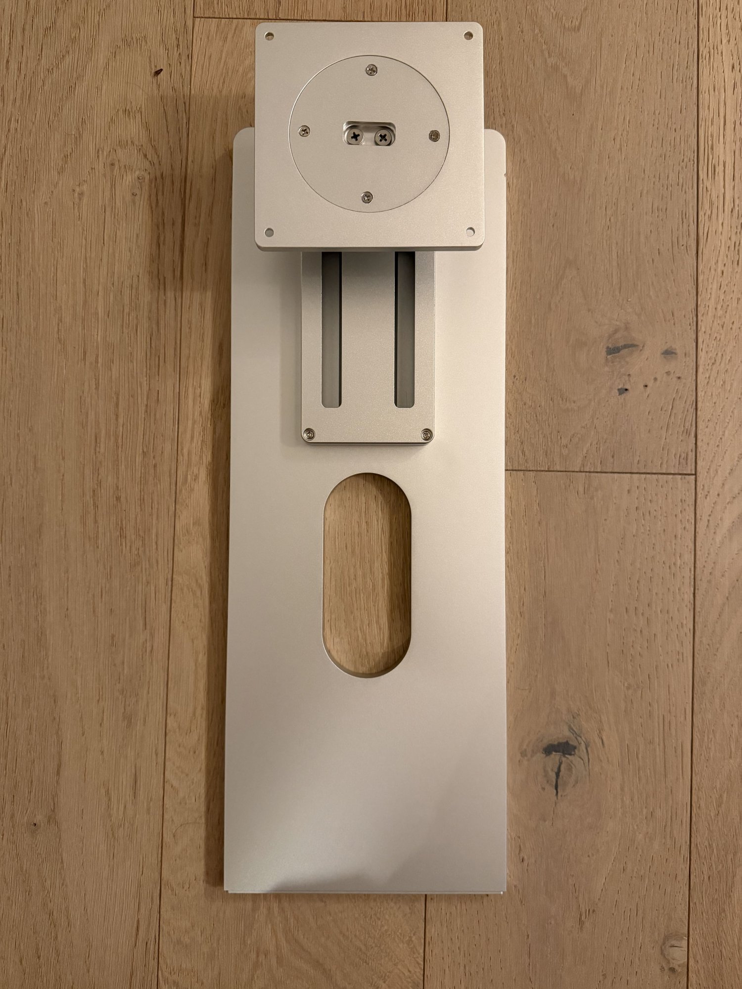

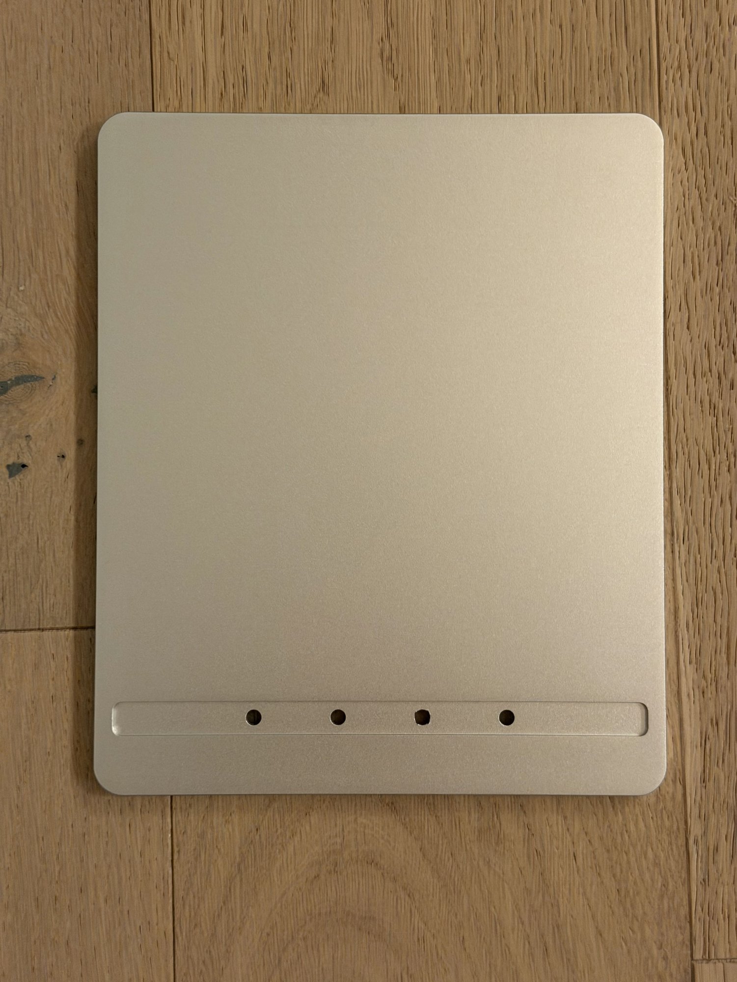

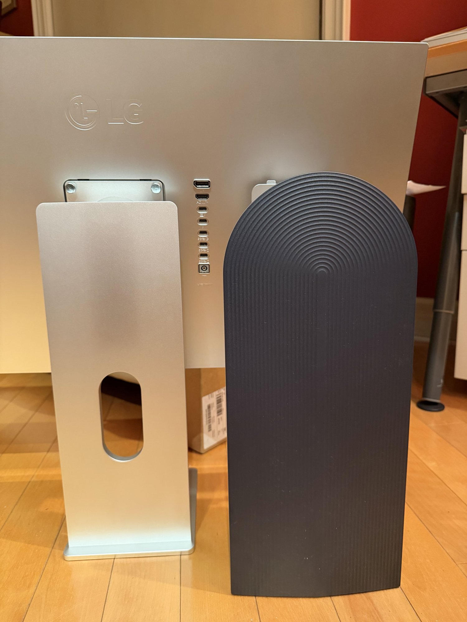

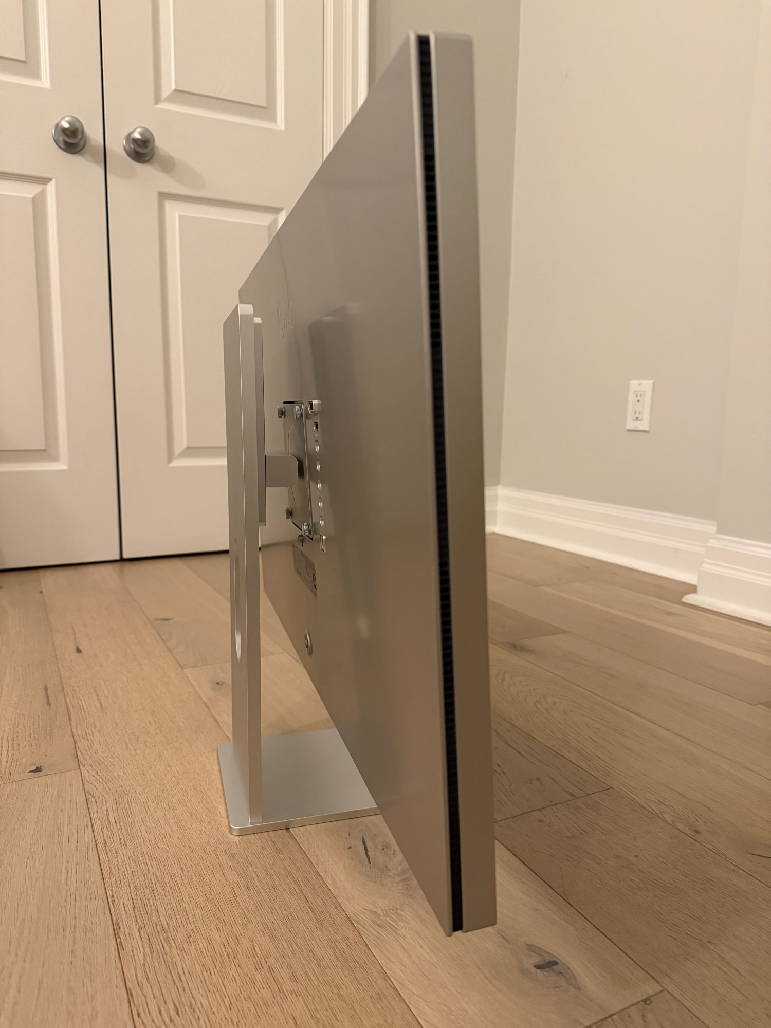

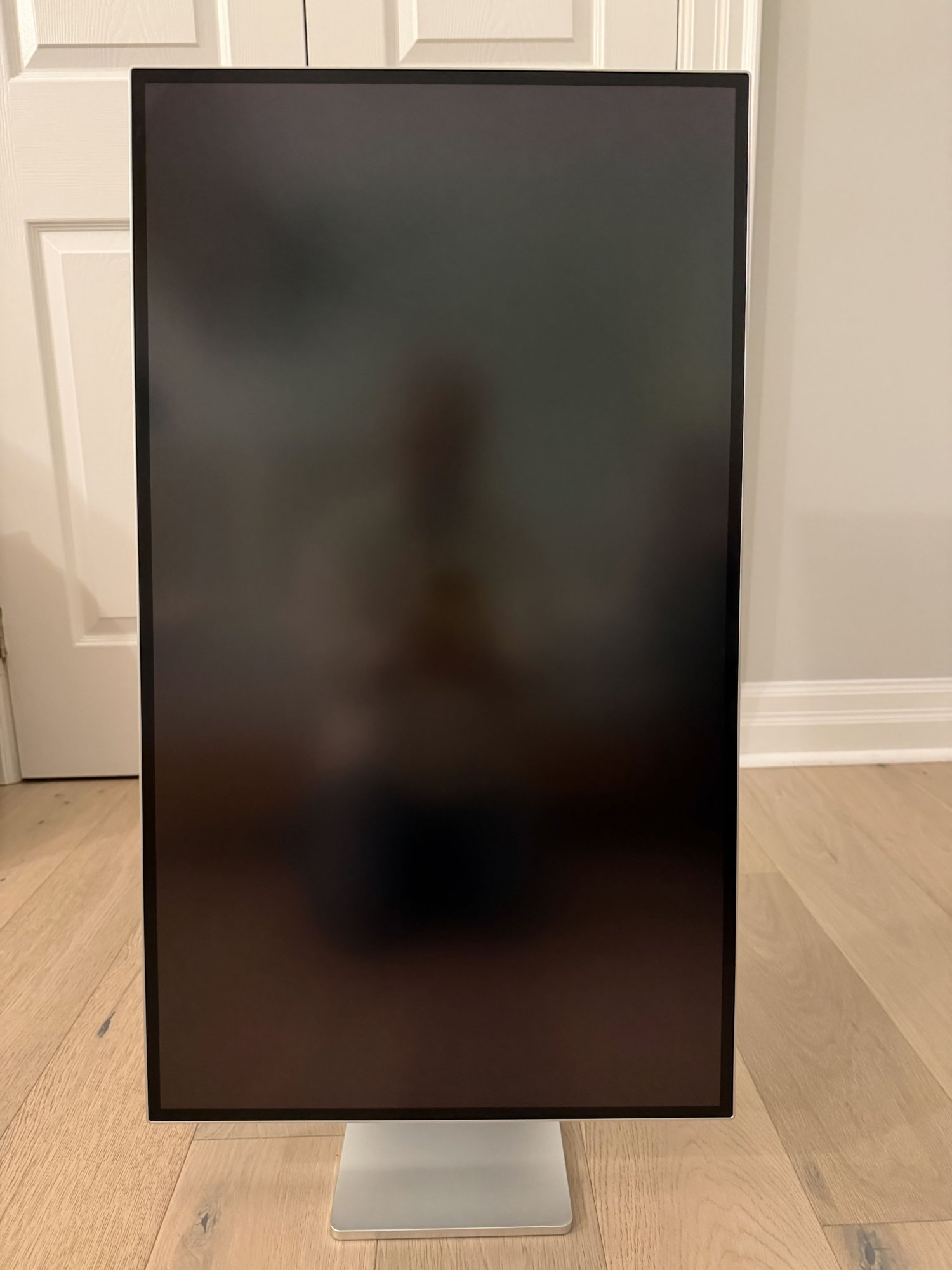

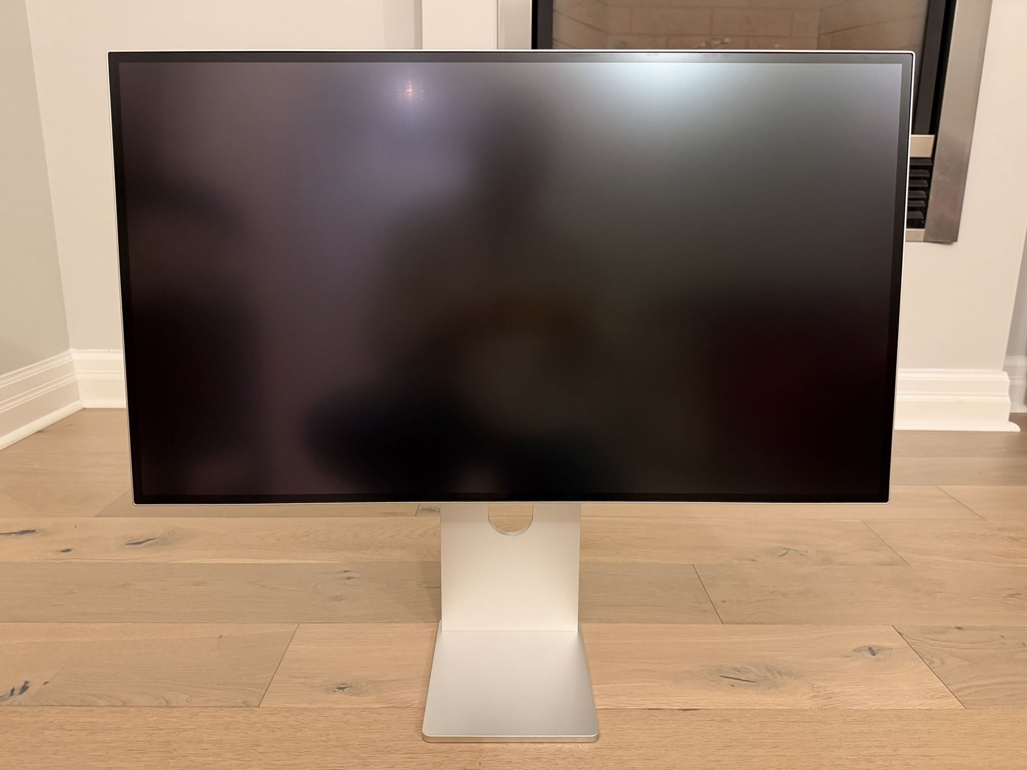

That Chinese aluminum Apple knockoff stand is a great match to the LG UltraFine 6K.

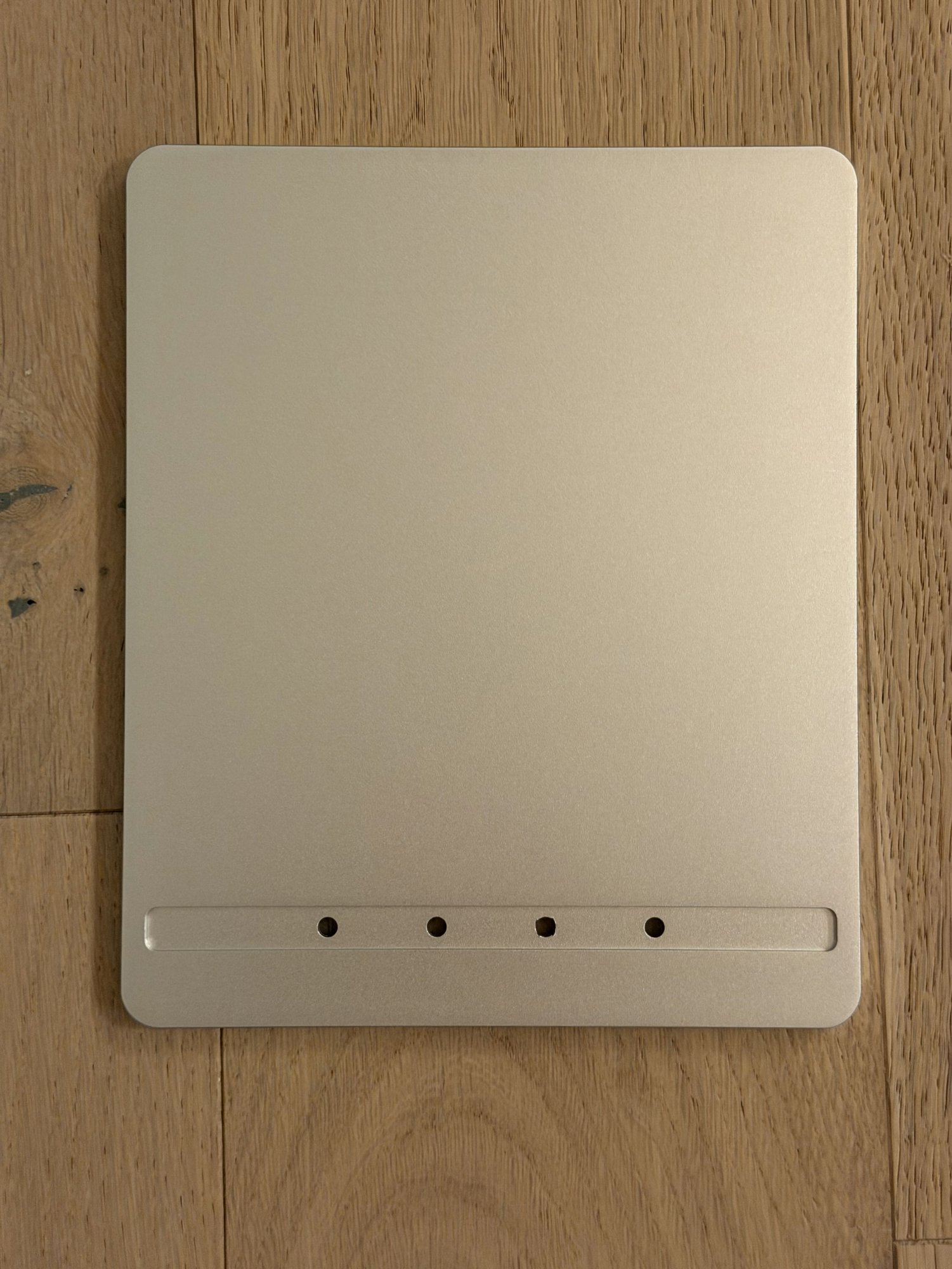

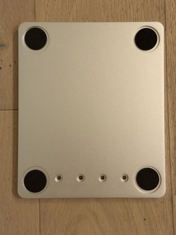

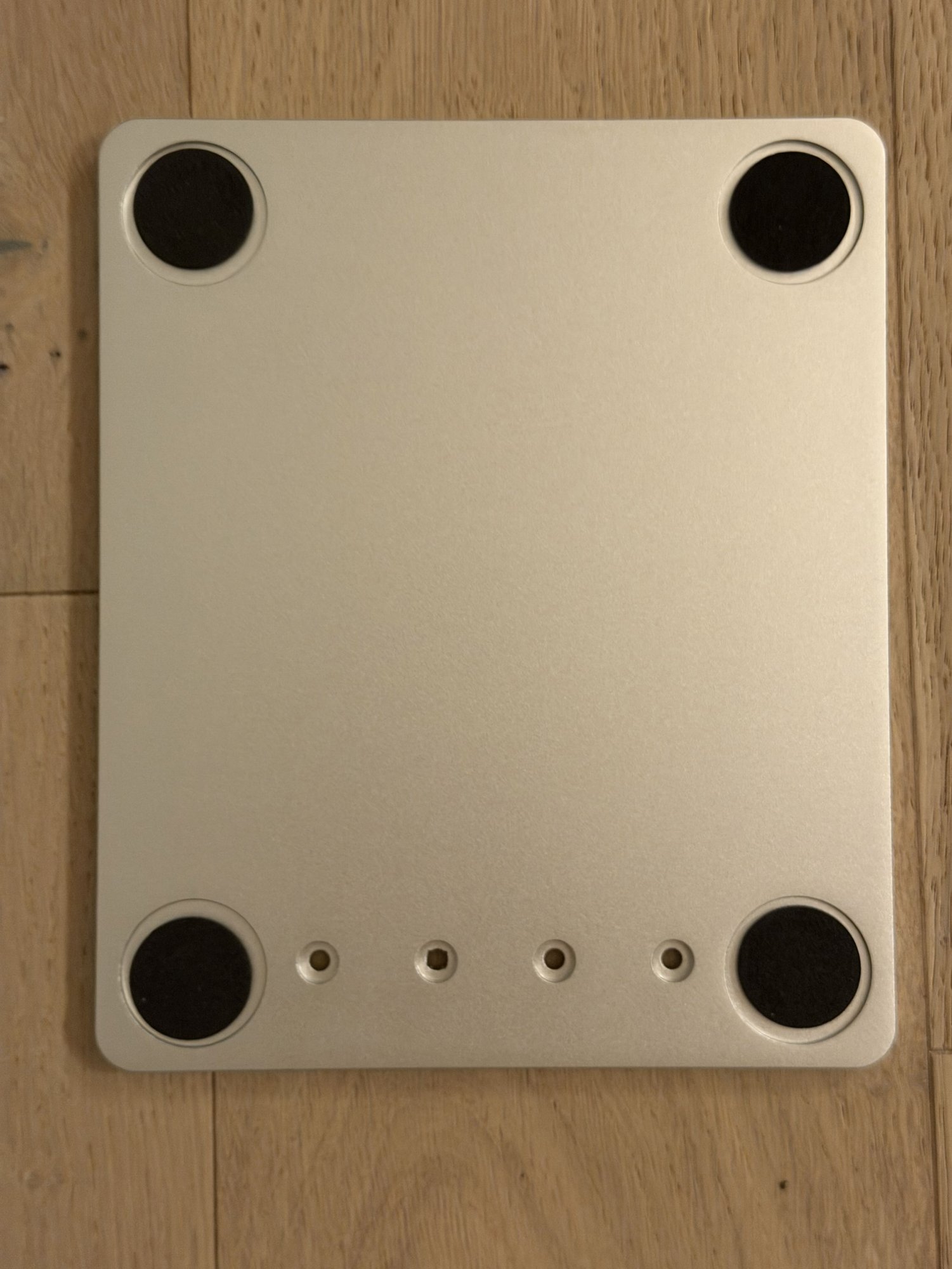

Base top surface and bottom surface. Four screws attach it to the main part of the stand. Screw holes are recessed.
As you can see, the base comes with pads to protect the surface of the table. They are in partially recessed cutouts.

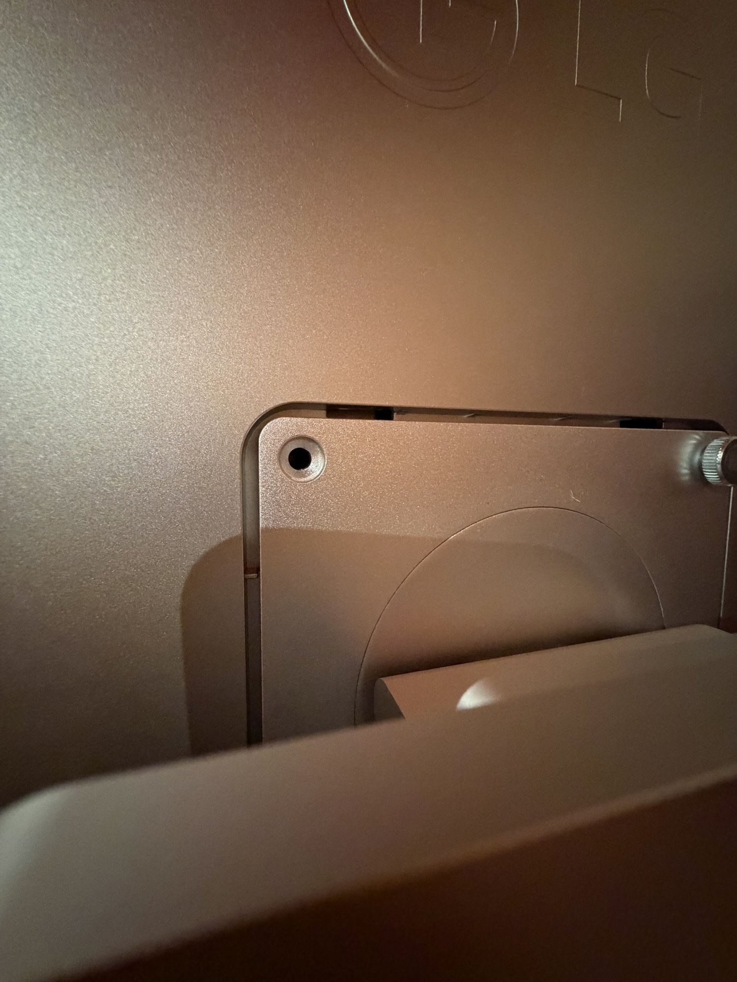

It turns out I didn't need the spacers/washers I bought for the VESA mount. The standoffs I mentioned before on the LG 6K monitor inside the VESA mount cutout don't interfere with the mounting plate of the stand. Contrary to the schematics on the website listing, the stand does NOT have a 12 cm mounting plate. It's ~11.5 cm, and those standoffs are each ~2.5 mm wide, so it's an exact fit between the standoffs. Is 11.5 cm a standard size for such mounting plates? Cuz it looks like those standoffs were designed specifically to align the mounting plate. Note that it did not come with those protective washers for the VESA screw mounts, and I didn't bother to add any.

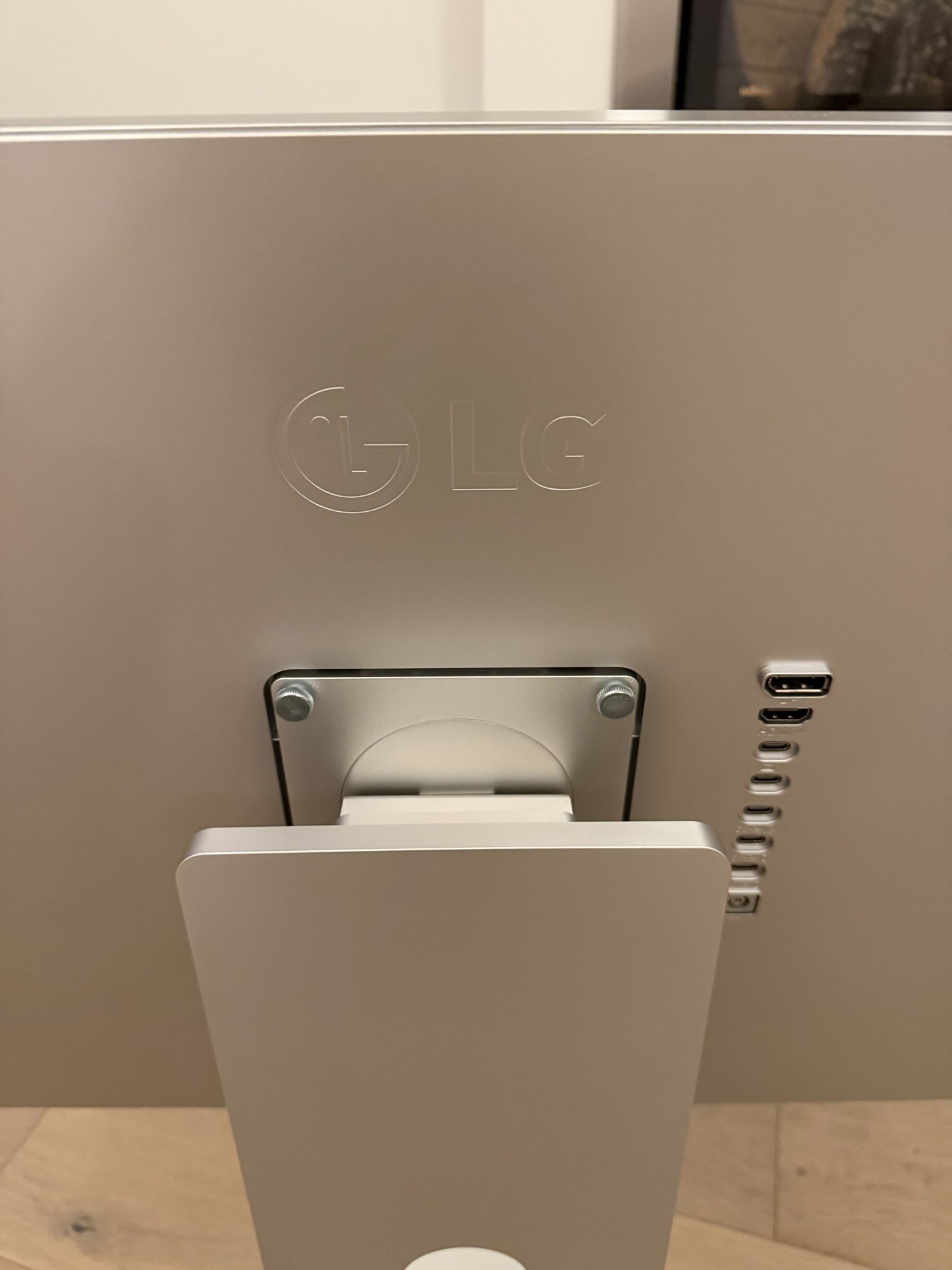

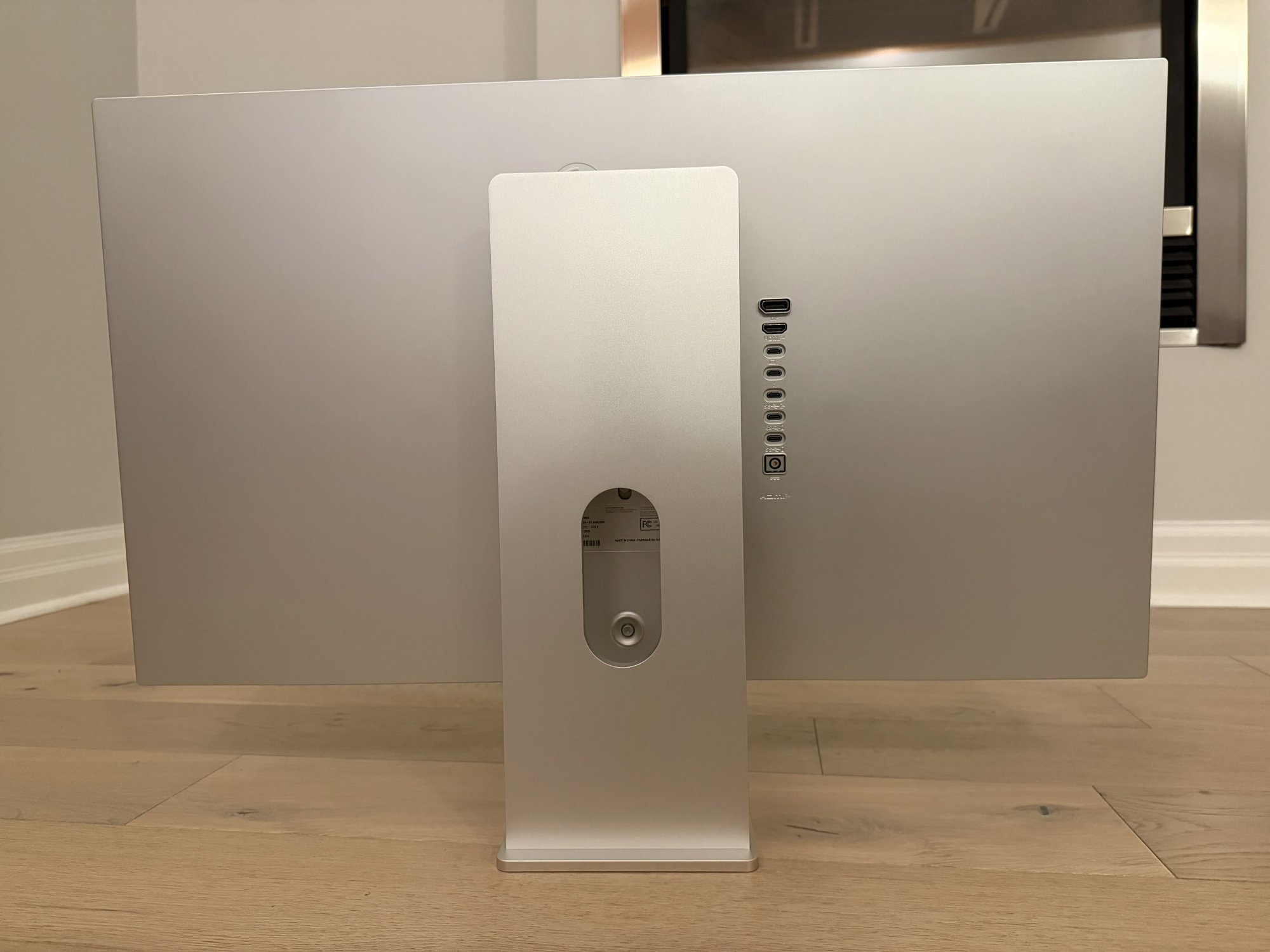

Stand showing the VESA mount and the lift design. The closeup of it partially mounted shows the standoff aligning the plate.
The stand came with thumb screws. The screw holes are recessed, and the collars of the thumb screws fit inside.

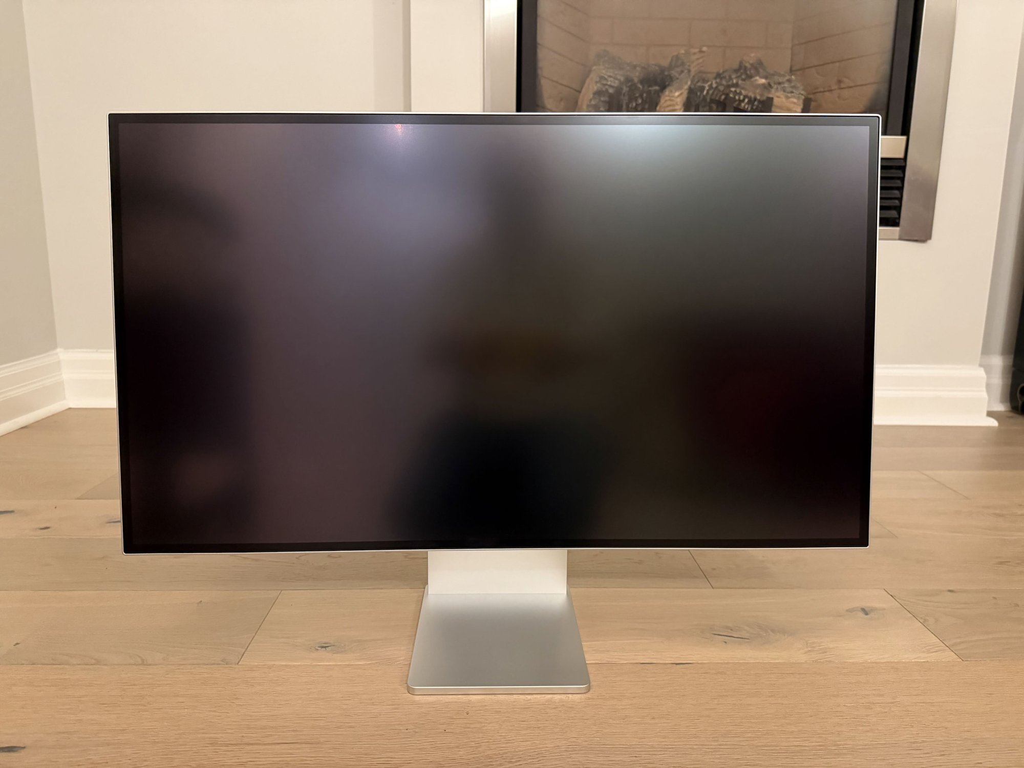

Monitor lowered

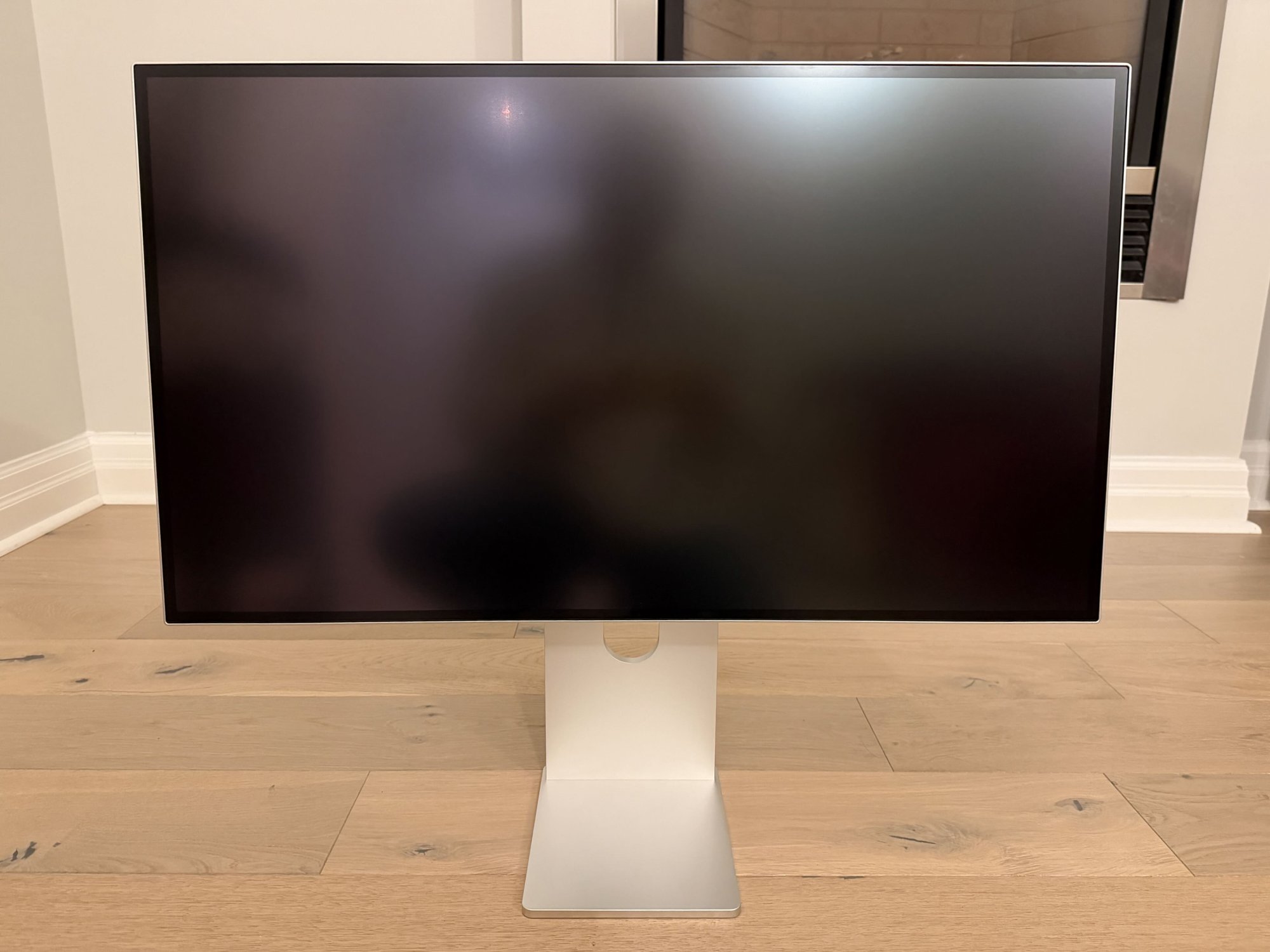

Monitor raised. In the first pic you can see those standoffs again on either side of the mounting plate.
Highest vs lowest, front view

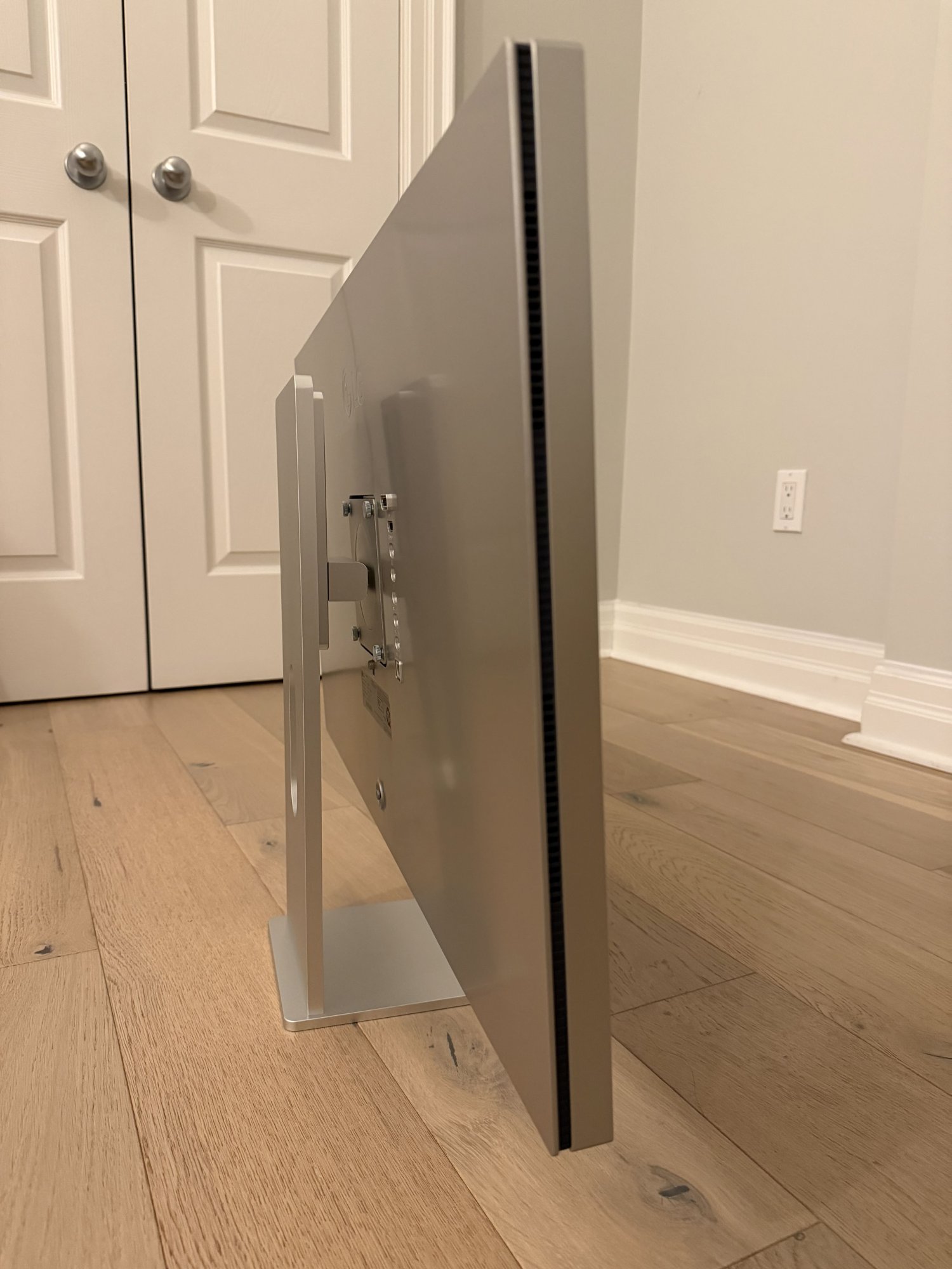

At minimum height the monitor's bottom edge is 3.75" above the table, and the monitor's top edge is 20" above the table. That means I was able to lower the monitor 1.6 inches compared to the stock stand.
Rotated
New vs stock
Thumb screw type. That collar is narrower so it fits inside the recessed part of the screw holes.
It stays put after raising or lowering it. If your table is not stable the monitor can wobble a bit, but it seems pretty stable in my setup. The hinge tilt mechanism isn't the smoothest, but it works fine.
It arrived in 8 calendar days from China, and I didn't get hit with any additional fees (so far) even though it was supposed to be a DAP shipment. I paid US$82 shipped, but it seems I got very lucky because now it's ~US$130 (to Canada at least) with the same Alibaba Premium shipping method, or ~US$115 with Standard shipping.

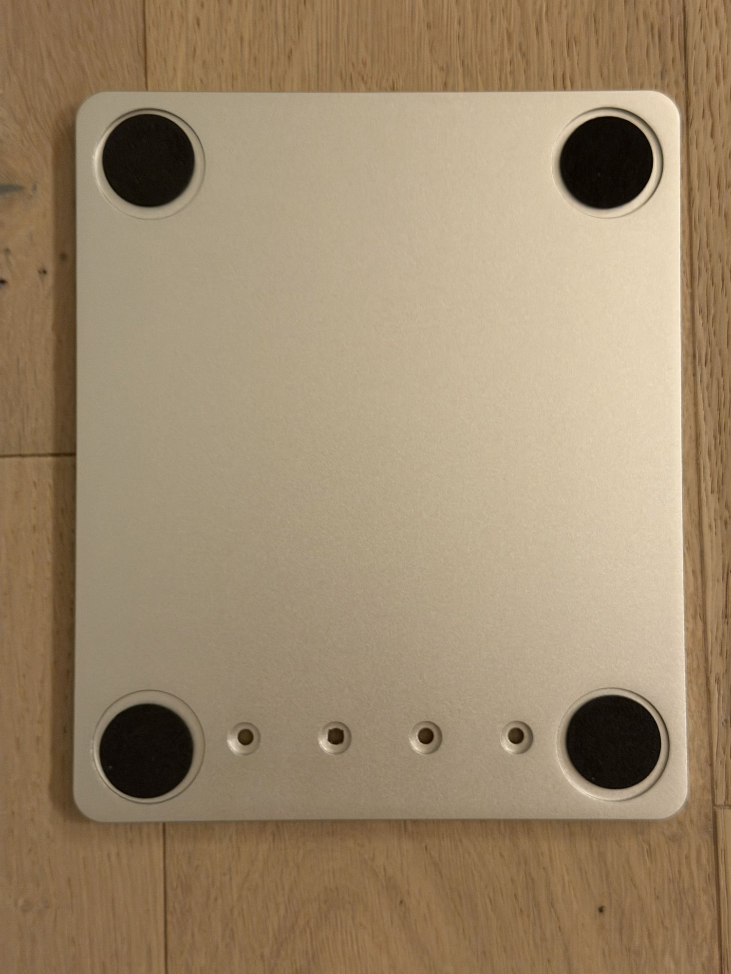

View attachment 2578212View attachment 2578211

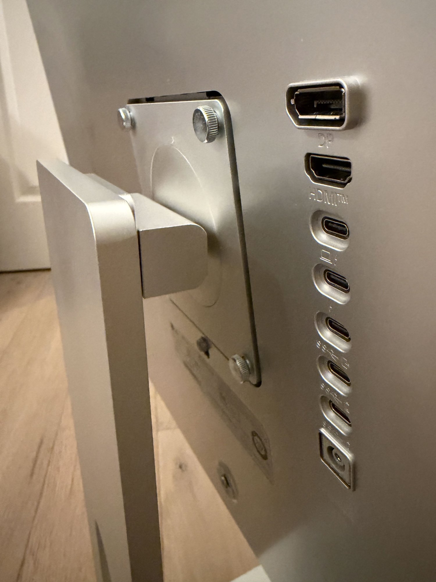

View attachment 2578213View attachment 2578215
Monitor lowered
View attachment 2578216View attachment 2578219
View attachment 2578218View attachment 2578217
View attachment 2578244View attachment 2578221
Rotated
New vs stock
That is great! How much distance is there from the bottom of the screen to the table when it is at its lowest setting? Is it a lot lower then the standard LG stand?
Never mind I just read your post properly, thanks for the info. Hmm I am split between this LG and the Asus 6K, or even the Ben Q 32" Mini LED monitor. I won't be calibrating it, won't be using it for photography or video editing, but aesthetically the LG fits in the best with the look I want, and this stand mod actually makes it usable, with the standard stand I would have to work out a way to fit it in as I have a riser and it would sit too high on that. With this stand it would be fine.
You said the stand came with those thumbscrews you are using? And you didn't use any washers?
Correct and correct.
Oh, I didn’t know that. If LG offered that, that would be incredible. I don’t think it does (which is a shame), but my order for two monitors has been placed (no tracking number yet), so hopefully I’ll find out soon!
Rotated

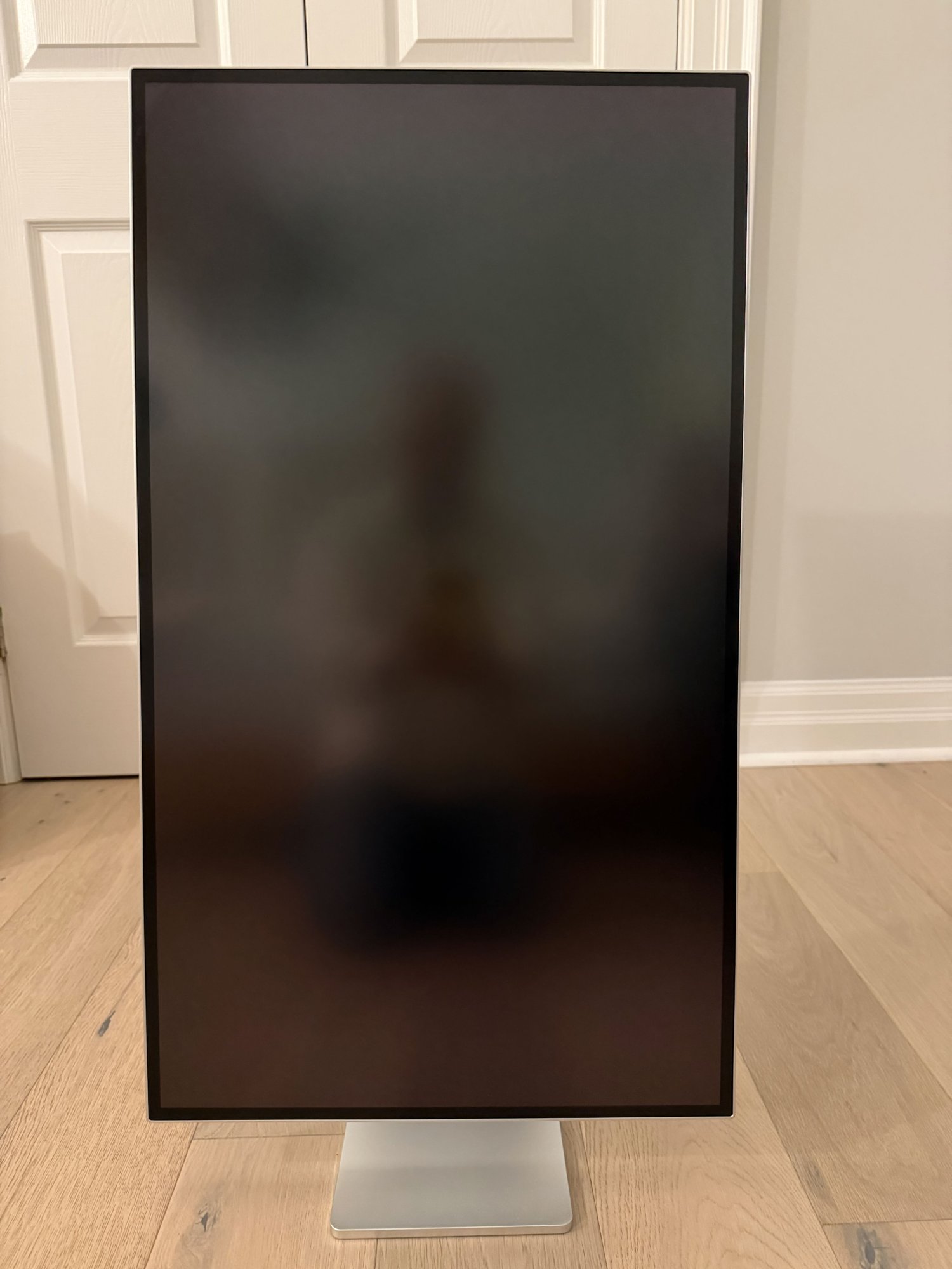

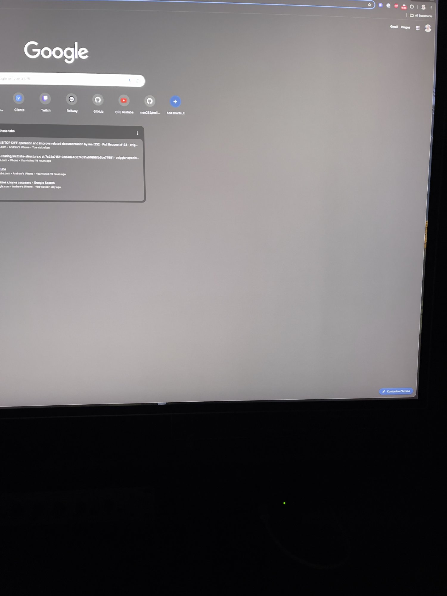

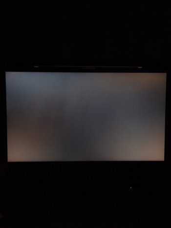

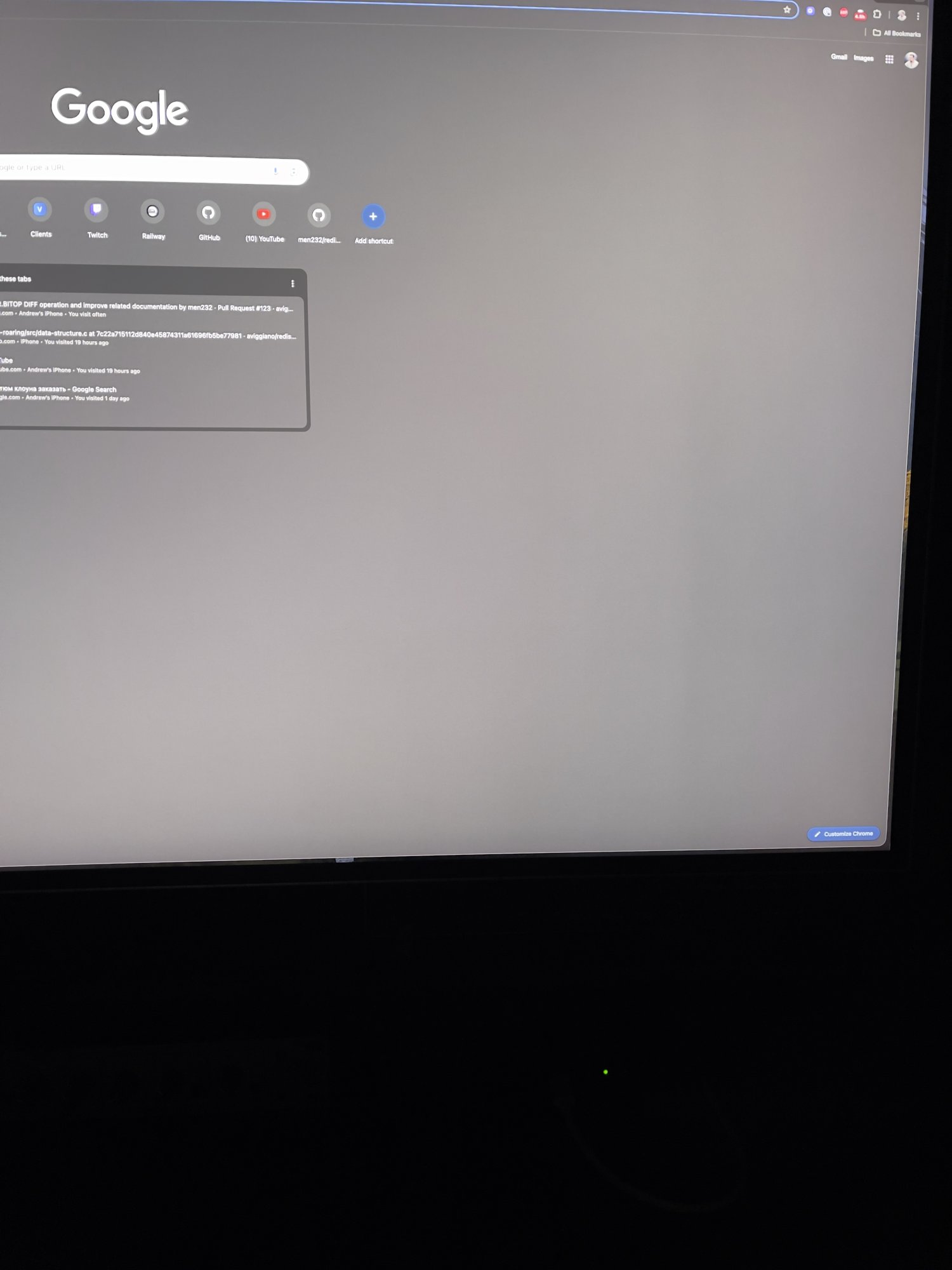

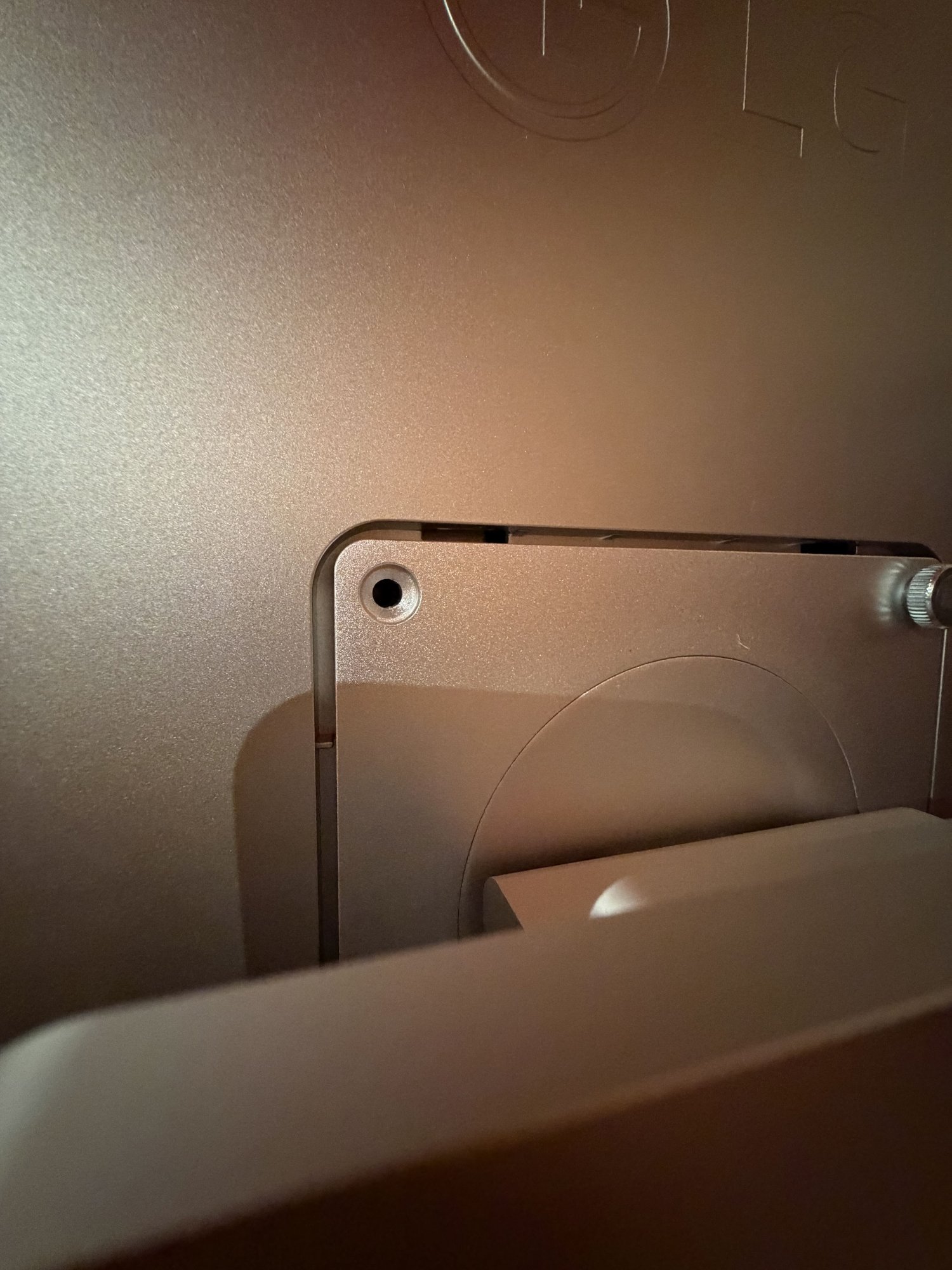

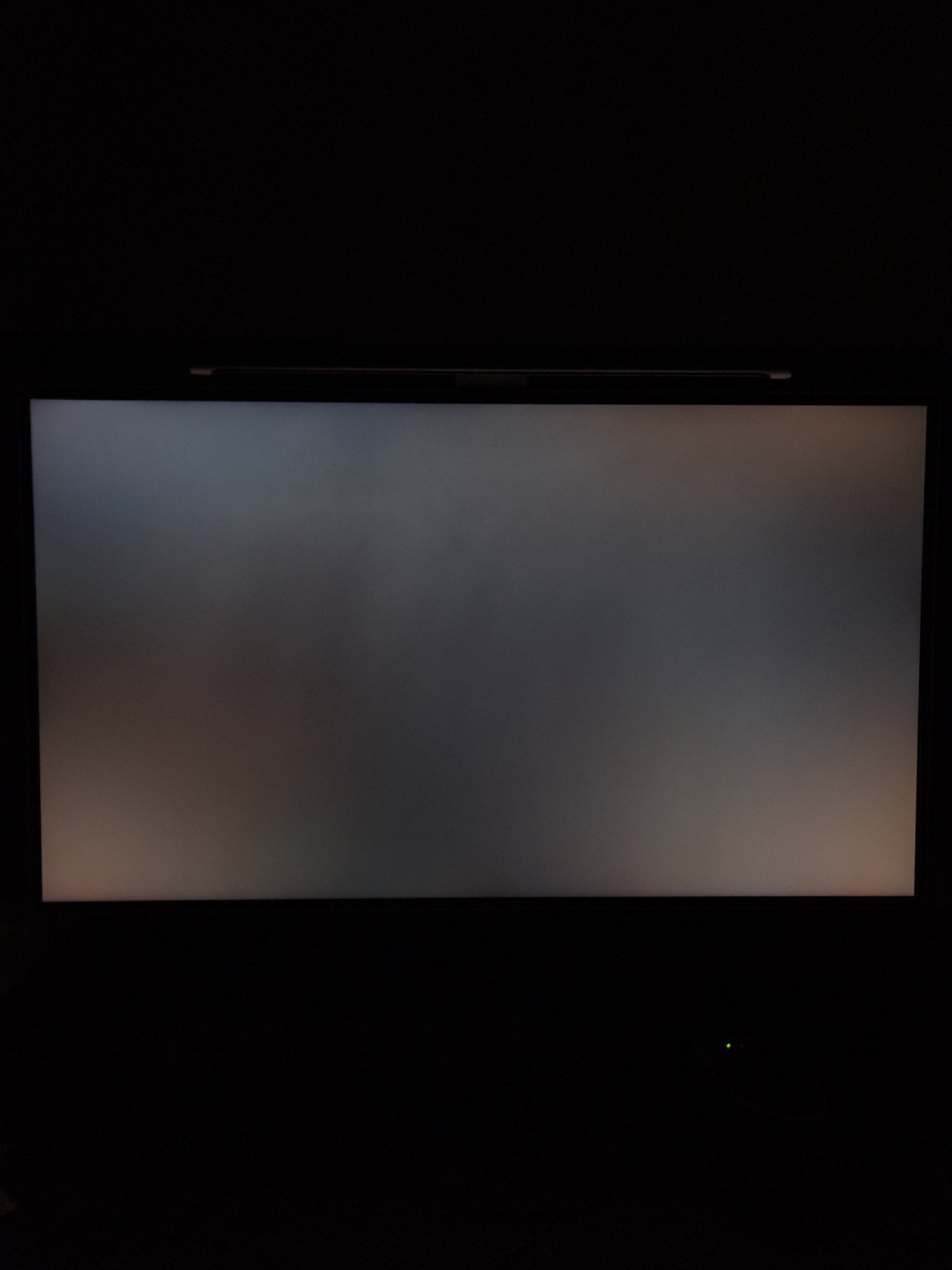

I pre ordered this monitor on Oct 15th and was really looking forward to it. Unfortunately, I’m very disappointed. The matte screen completely kills the benefit of the high resolution and I also noticed a dark shapes on the right side. For such a high price, the quality just isn’t acceptable. I’ve just sent it back and I’m not sure yet if I should try ordering a new one, maybe I just got a defective one

Most vendors of my stand say the maximum supported weight is either 6 kg or 7 kg. One even said 8 kg, but it was an exception. The LG is 6 kg and the ASD is 5.5 kg with VESA mount.
I don't know the weight of your 5K iMac with VESA mount. If within that weight limit it will be fine, but if significantly heavier you might want to consider a different stand. There is a Pro Display XDR knockoff stand that is the same one that Kuycon sells as their universal stand, and it holds up to 10 kg. I believe it is made by the same company as my stand, just a different model.

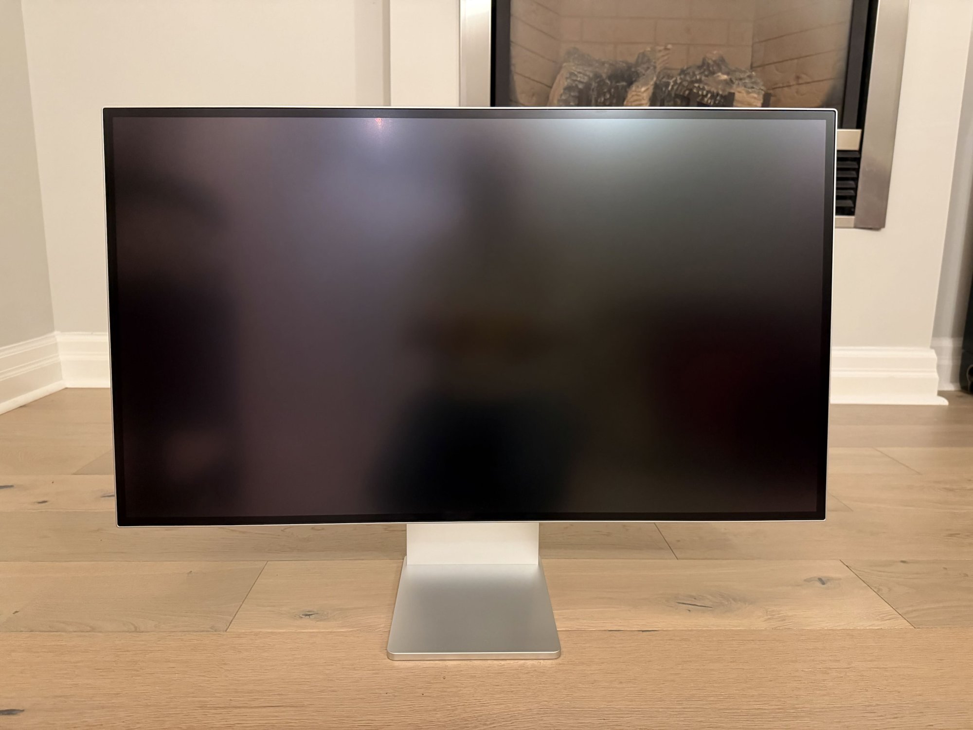

Those dark shapes appear to be dirty screen effect. I have some of that too. The bigger the screen, the more common that is. It's extremely common to see on TVs for example, often easily seen in hockey games (solid white ice rink). I suspect that is one of the many reasons the Apple Pro Display XDR is so expensive. Apple only uses the best of the best panels for their 6K model. As for the matte, I personally think it looks decent, and I think text quality on the LG 6K is excellent even as a someone who also owns a 5K iMac.
I suspect most of these LG 6K displays will have dirty screen effect to a certain degree but that degree will vary greatly. It is the panel lottery I was referring to before in these threads. My bigger concern is backlight bleed though. I previously said I don't have any but now after nearly two weeks of usage if I look closely in the dark I can see spots with slight bleed, but it's really minimal, nothing compared to the 4K and 1440p 32" Asus ProArts I had tried. After thinking about it a few days, I decided to keep mine. I didn't want to try repeatedly buying units until I got a perfect one, considering I already have one with minimal backlight bleed.
The LG 6K does not offer higher than 60 Hz in any mode AFAIK.

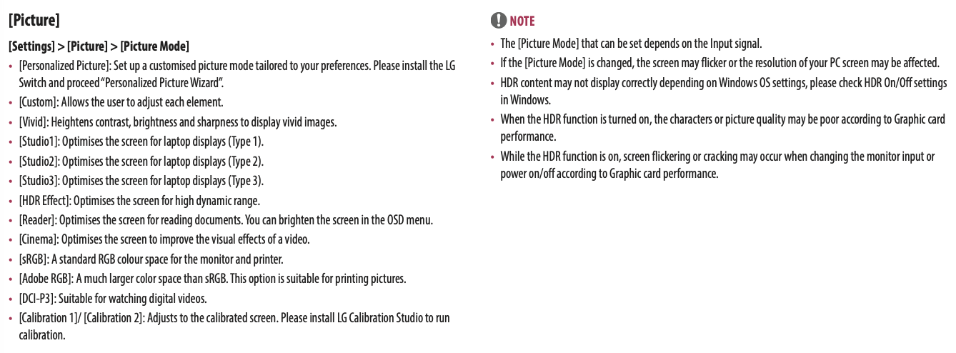

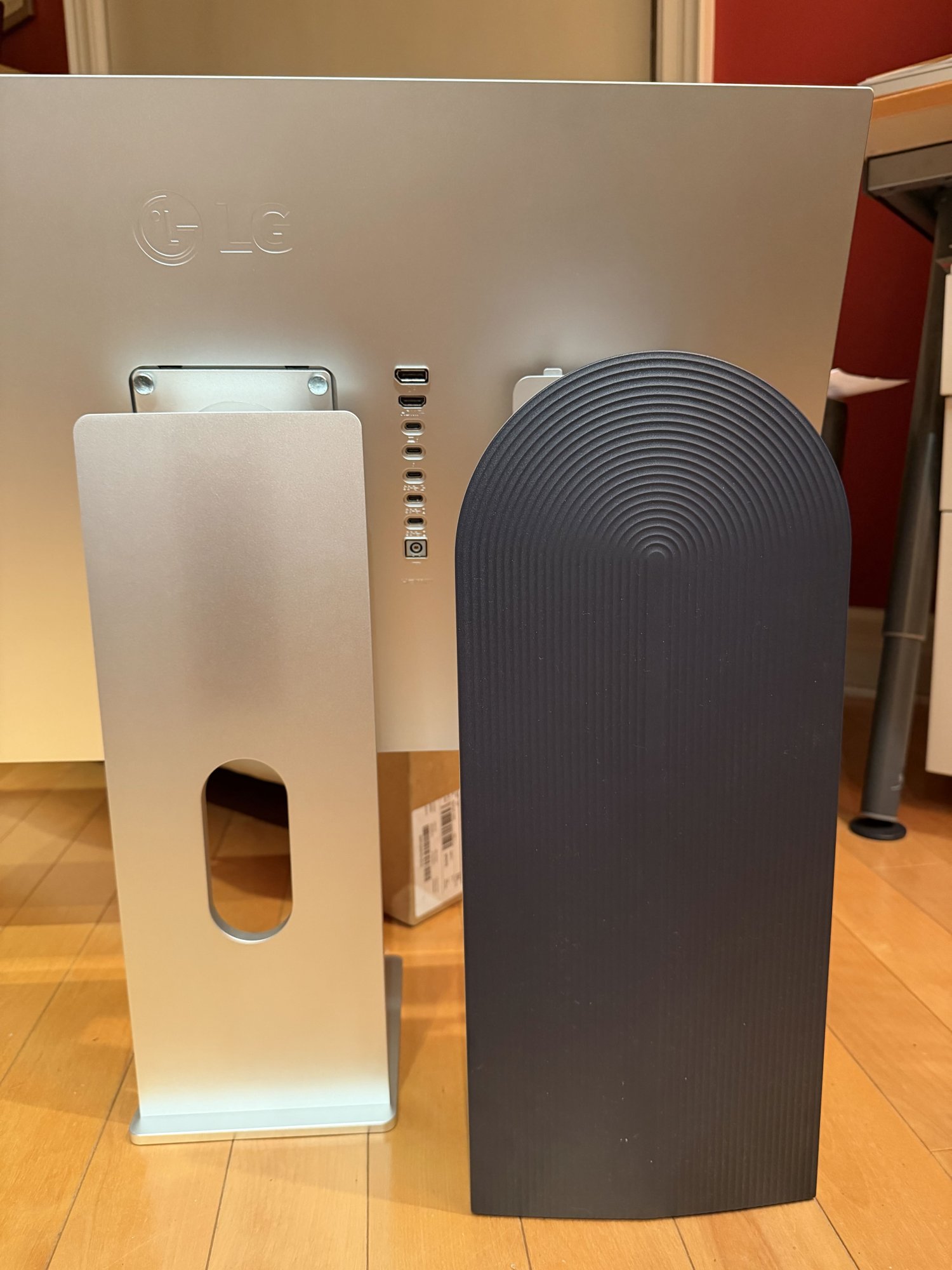

1. As @smirking mentioned, it's been posted previously. Anyhow, on my unit the stock stand can go as low as 5.4" above the table, but LG USA said for their in their own office, it's like a half inch higher or something like that. I don't know why there is such a discrepancy, but it may be because the hinge resistance is higher at the extremes so you have to kind of force it a bit to go down to 5.4". My aftermarket stand reviewed above goes down quite a bit lower though, so the monitor is 3.75" above the table.
2. The monitor has two hardware calibration entries for the user to program right into the monitor, called Calibration 1 and Calibration 2. Using their LG Calibration Studio software, I programmed Calibration 1 as Display P3 (P3 colour gamut / 6500K / gamma 2.2 / 120 nits) for general Mac use. The monitor already has a preset for DCI-P3, but not Display P3. With the latest firmware there were three new presets added called Studio 1,2,3, but I can't find anywhere what exactly they are set for. The manual just says they are three different presets to use with laptop displays. Not very helpful.
When you create the calibration setting, it creates an ICC profile to match, but strangely enough it doesn't put it in the proper ColorSync directory. So, if you switch away from that ICC profile to use a different profile, then try to switch back, you can't because the LG ICC profile has disappeared from the list. Stupid. The ICC profile is actually still on the Mac but in a different LG directory, so what I did was just to copy it to the proper ColorSync directory and it shows up in the Displays calibration settings list. The other problem though is LG's ICC profile naming scheme is kind of cryptic so it can get a bit confusing if you have more than one of them.
There are also two settings entries called Personalized and Custom, but I don't know what they are actually. It also has an sRGB, DCI-P3, AdobeRGB, and Cinema setting, and others. I assume their AdobeRGB is 6500K, gamma 2.2, but I don't know for sure, and I don't know what brightness it's optimized for. FWIW, their LG Calibration Studio software often defaults to 100 nits for DCI-P3 calibration so I had to manually change it to 120 nits when programming my Display P3 setting.
When I validated my programmed Display P3 calibration setting using the LG Calibration Studio, average delta error was 1.x, so that's excellent. However, if you look at the individual colours (not including numerous greys tested which were all excellent), 22 out of 24 colours had dE at 2 or lower, but one of the oranges and one of the reds was around dE 3.3ish. Still good but not excellent. As I am not a creative professional, and overall it looks great to me in Photos, I'll continue to use that calibration for now. My Datacolor software does not give such fine grained detail since when I bought it I bought the Pro not the Elite version. I also tried the popular DisplayCal, but it doesn't seem to work on my setup.

Thanks for the detailed reply. The OEM stand is a bit high - that's a shame. Two slots could be OK, but I do want it to be very accurate. The ICC thing is strange, and I found this January video that talks about the very same thing. It looks like they haven't bothered to fix it yet, or they don't consider it an issue.

Just an FYI, you can only fit different stands to the Apple Studio Display if it has the VESA mount on it, if you have an ASD with Apples own stand you cannot change it, the monitor literally has to be taken apart to do so.
I have a VESA mount 🙂. Thanks anyway!

Thanks again for this information! I read that you bought this aluminium stand, which probably also fit the ASD, from Alibaba (?). Qne question: Is there a minimum amount you have to order since Alibaba ist mostly B2B (e.g. wholesale) only. Or did you just place your oder for a single stand? For private customers, Aliexpress is more suitable as a B2C platform; However, prices at Alibaba are lower than on Aliexpress.
Minimum order is 1 with my vendor but each vendor is different. However, shipping is expensive and it’s DAP shipping from my vendor. With DAP shipping the buyer is responsible for import fees, but I didn’t get hit with any import fees so YMMV.
In the past, other people have claimed that Alibaba Premium shipping (which is what I used) often gets treated like DDP shipping so the buyer is not responsible for import fees, but I have no idea if that’s true or not.
Unfortunately, Premium shipping costs almost as much as the VESA stand itself. Standard shipping is cheaper but also slower, and I don’t know if it means a higher risk of having to pay import fees.
@EugW what colormeter did you buy for the LG. I had a thing a million years ago but it’s long gone and I’m not here for spending a ton on one I’ll use twice.
Thanks @EugW !
Did you directly buy from this dealer here (as mentioned in your review):
27inch 32inch All Aluminum Alloy Stand Xdr Style Monitor Cnc Rotating Lift Table Vesa Bracket For Desktop Computer Screen - Buy Factory Wholesale 24 27 32 34 Inches Monitor Lift Swivel Stand Desktop Computer Screen Vesa Bracket desktop Computer Full
27inch 32inch All Aluminum Alloy Stand Xdr Style Monitor Cnc Rotating Lift Table Vesa Bracket For Desktop Computer Screen - Buy Factory Wholesale 24 27 32 34 Inches Monitor Lift Swivel Stand Desktop Computer Screen Vesa Bracket desktop Computer Full Set Used 22-27 Inch New Computer Monitor...
www.alibaba.com
www.alibaba.com
Thanks @EugW !
www.alibaba.com
www.alibaba.com
Yes. Make sure you choose the right model, fixed height vs adjustable.
