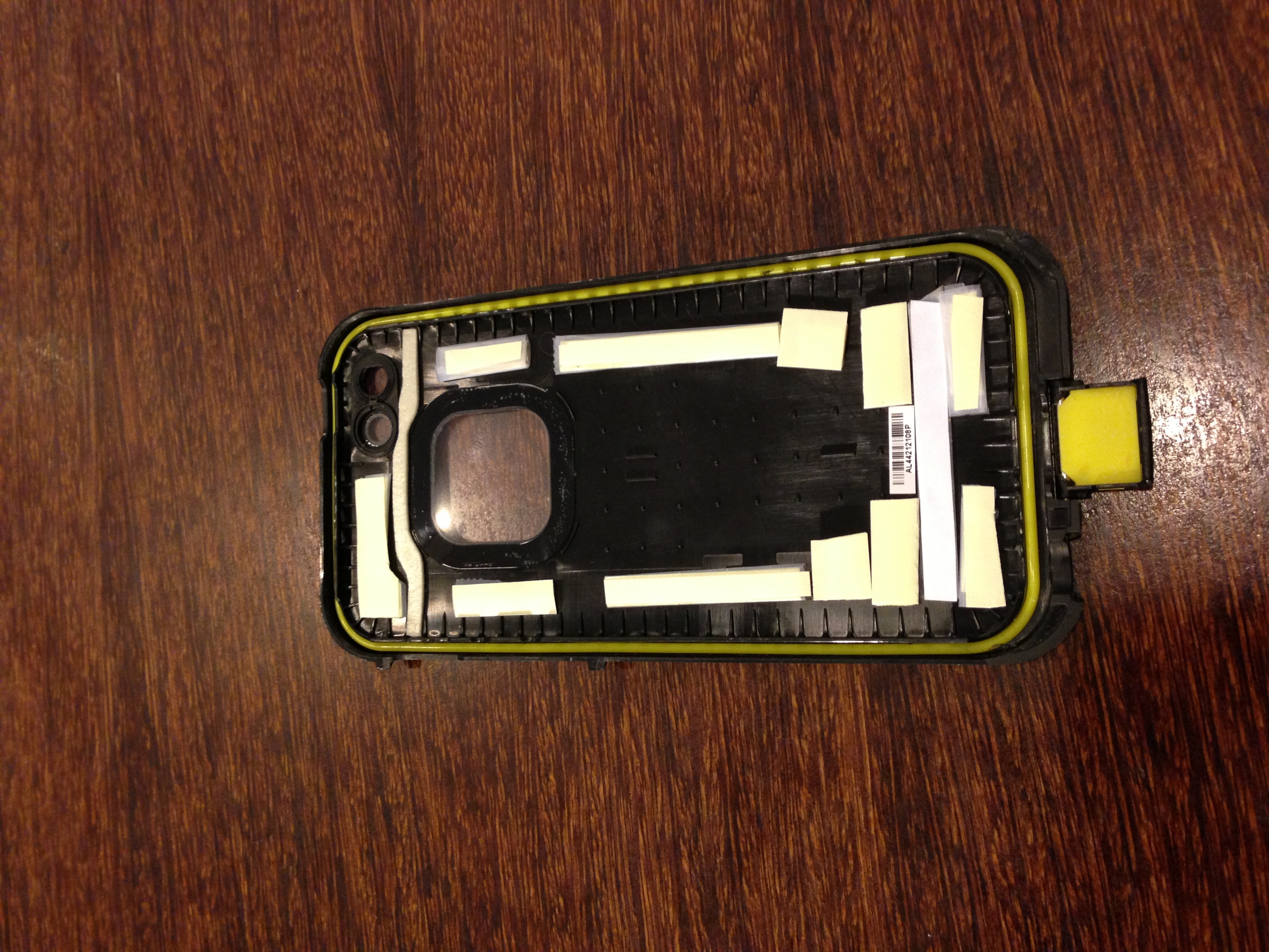

Hi everyone, was able to, after some trial and error bootstrap a fix so I simply press next to the prox sensor while hanging up/ putting in numbers etc until lifeproof can send me a case that works flawlessly. Simply add packing to the back part of the case to the level of the existing foam inserts and twice that behind where the prox sensor will be pressed into the front of the case by building up padding on the back.
Just make sure you don't pack it too much or it won't deal!
Obviously I take no responsibility for this advice but it's working great for me! Hope this helps

What you guys gotta understand is that these cases are injection molded (as are all of them) to _close_ but not, in all instances, exacting standards. As more and more cases are pulled from the steel molds, the molds, whose size tolerances might have originally been .015" may now have grown to .020" or .025". Get a case made from the latter part of an injection run and it fits your phone in a rather sloppy fashion. That's why makers of the LifeProof cases started sending them out with thin foam on the back.
Rather than use packing foam, if you live near a fishing supply store that specializes in fly fishing, there's a micro-thin foam marketed called, oddly enough "Micro Thin Foam" in 3" x 4.5" sheets by a company called Hareline Dubbin, Inc. Comes in 3 sheet packs and runs about $2. Using sections of this will remove any "play" between your case and the phone, especially the screen protector.
Sending he case back to LifeProof gets you one of 3 things: 1) a case from a different run that fits perfectly; 2) a case from a different run that fits the same or worse; 3) a case with their foam strips installed which may (or may not) fit exactly. The $2 foam fix-it-yorself is far superior and easier to do.
