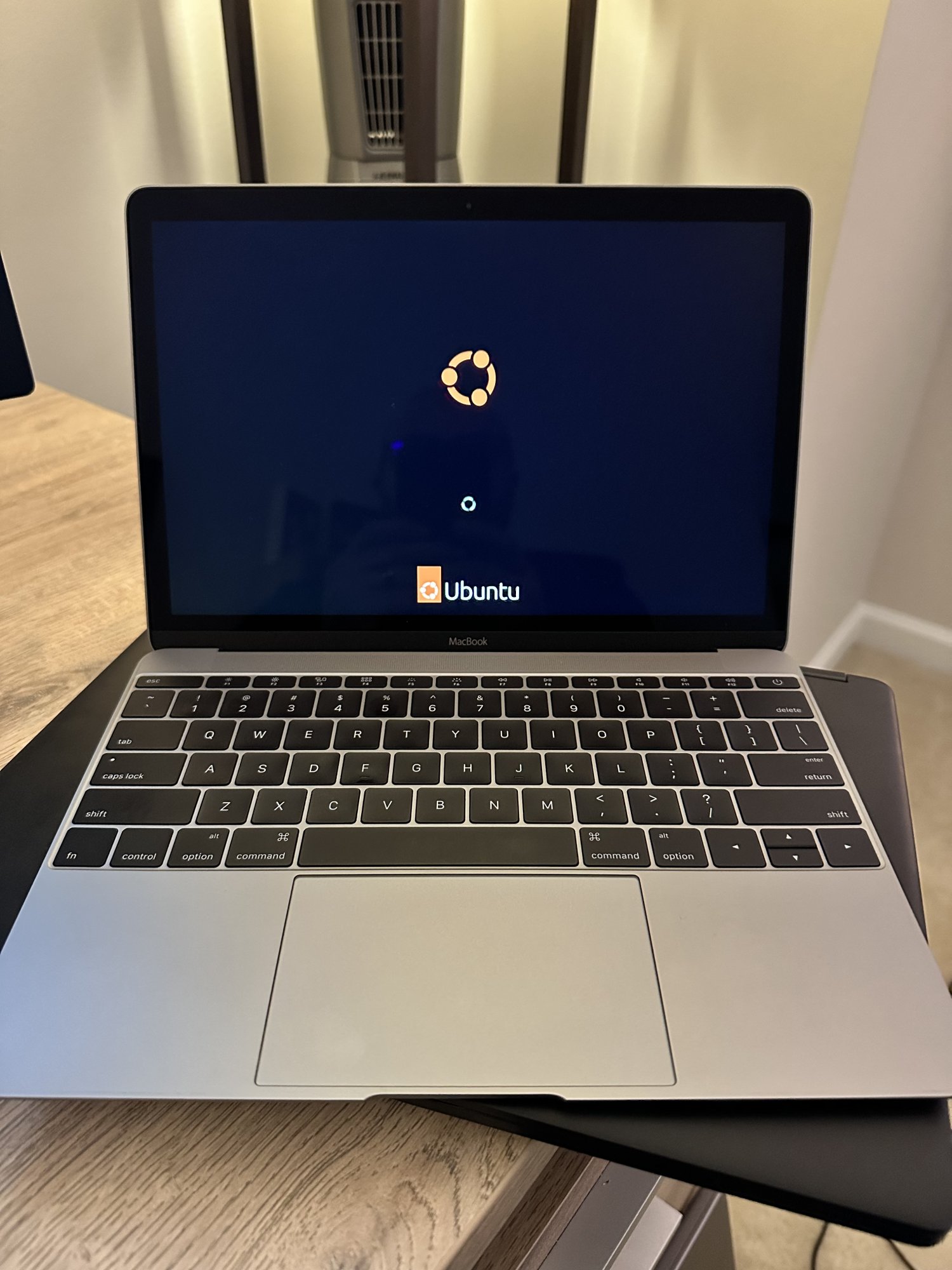

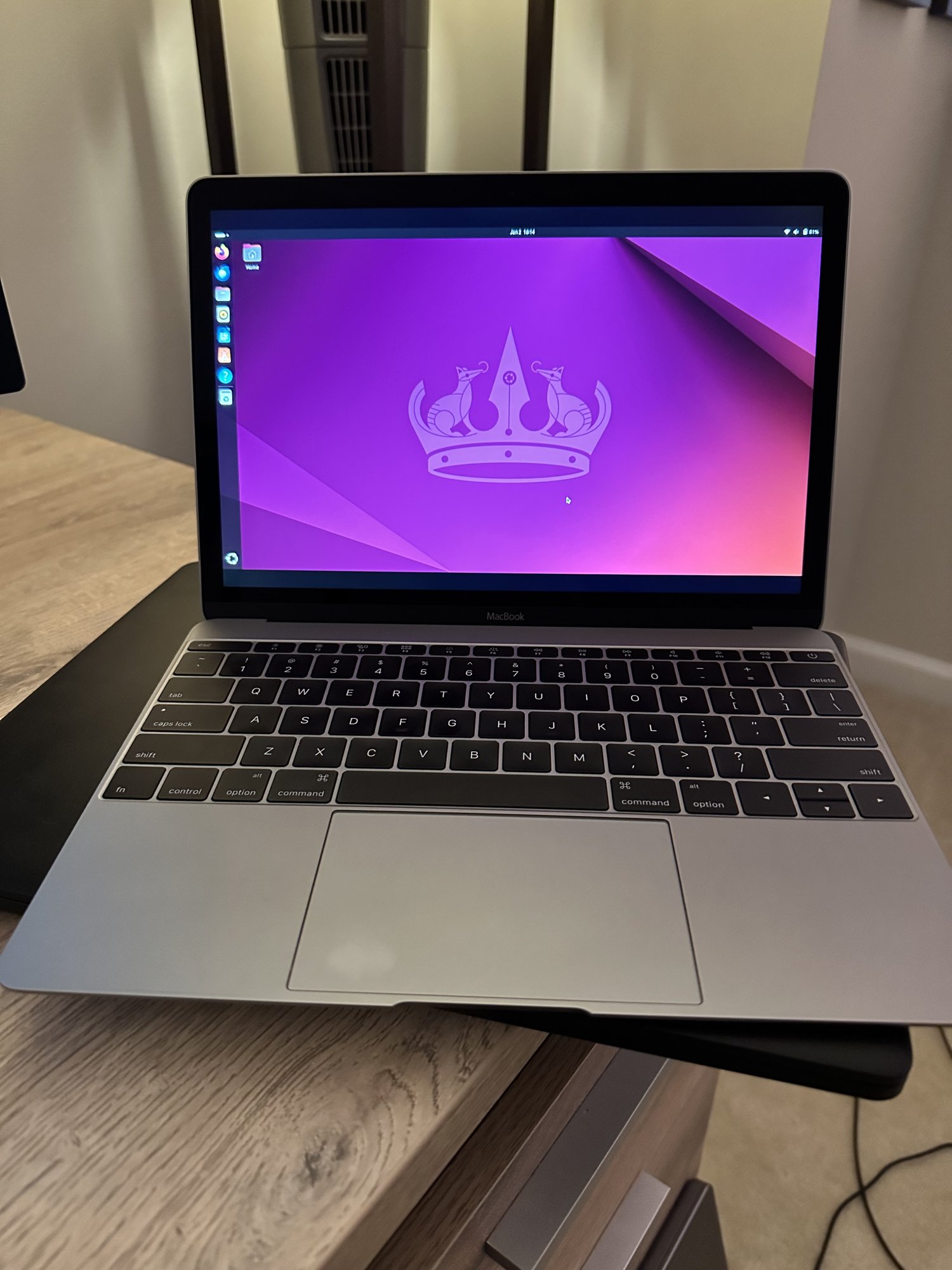

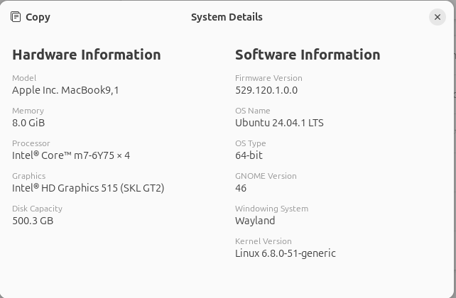

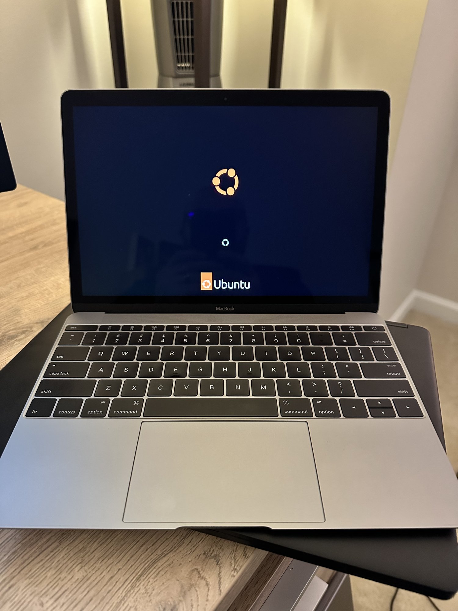

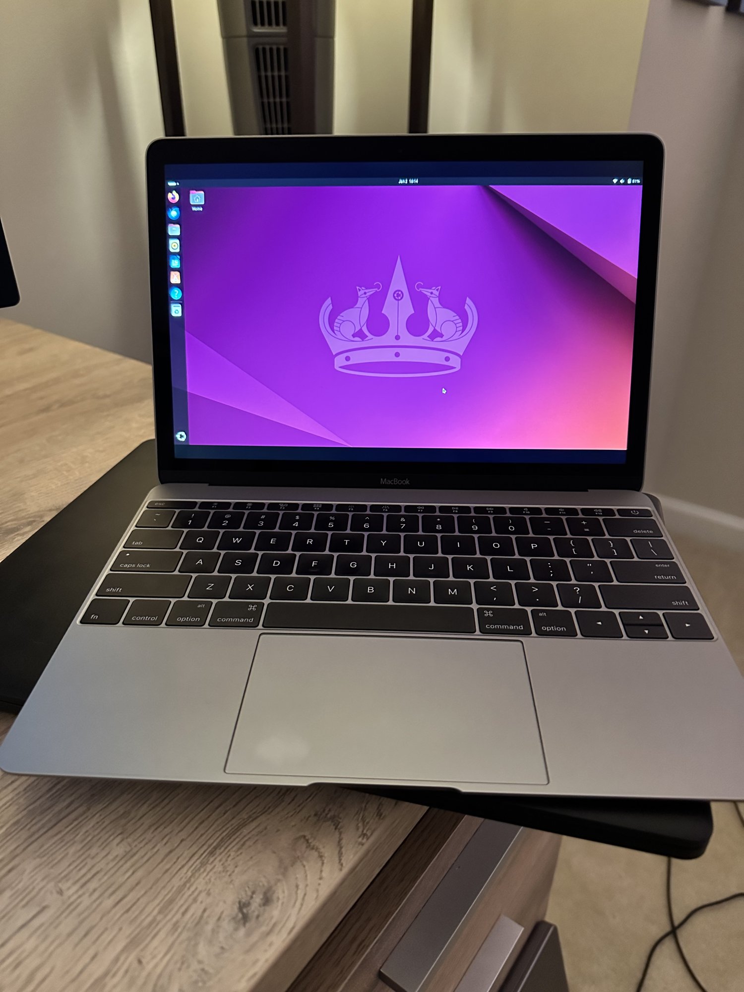

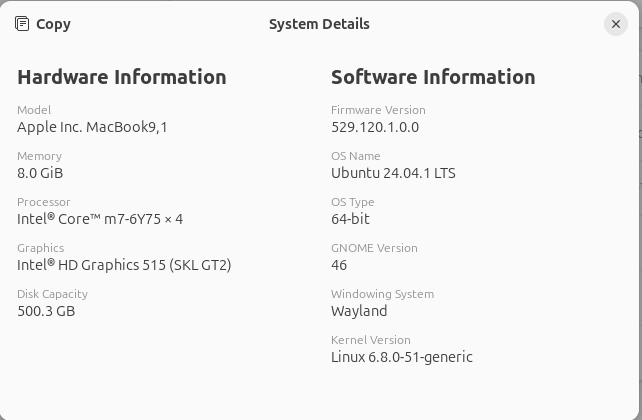

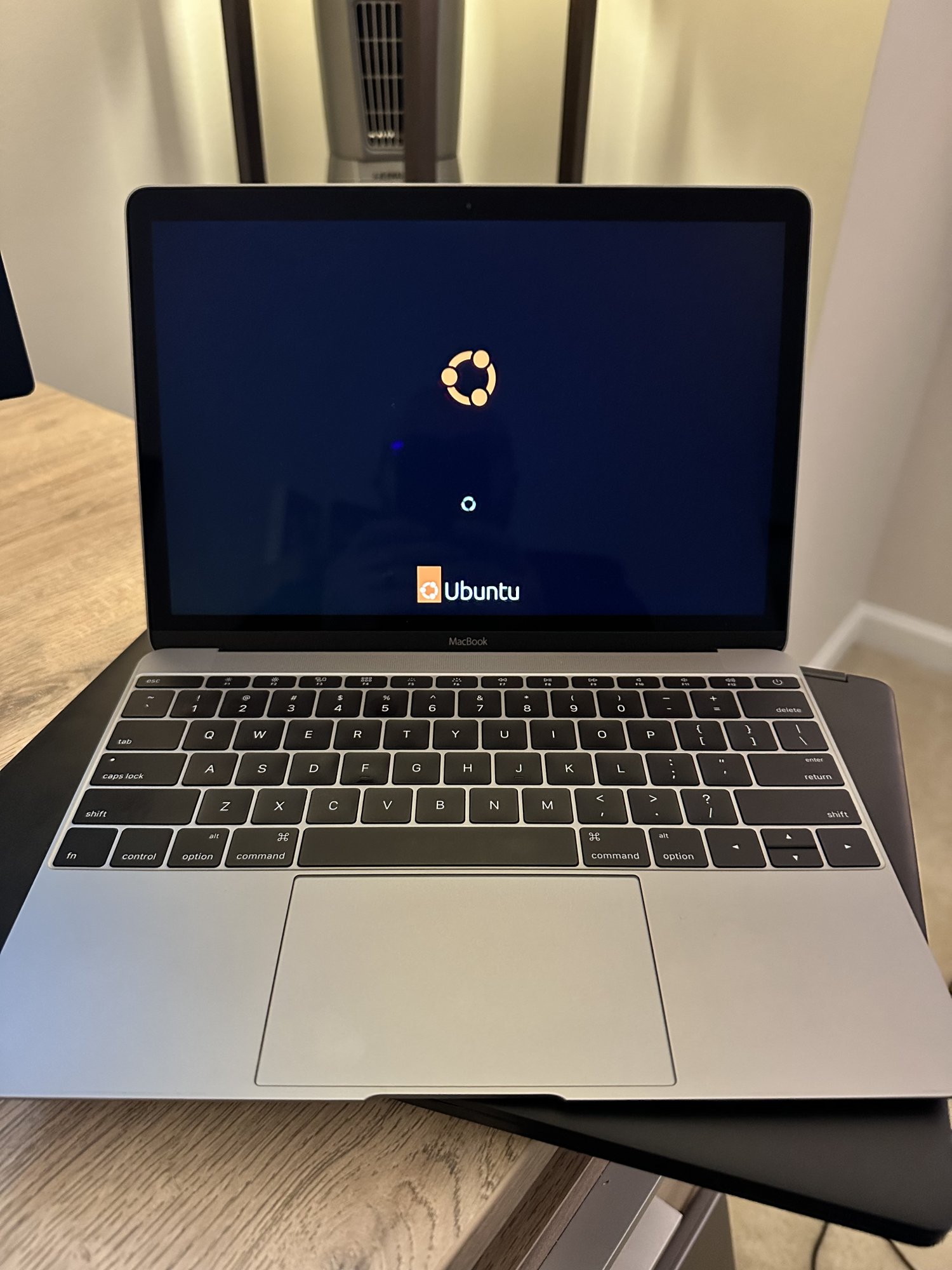

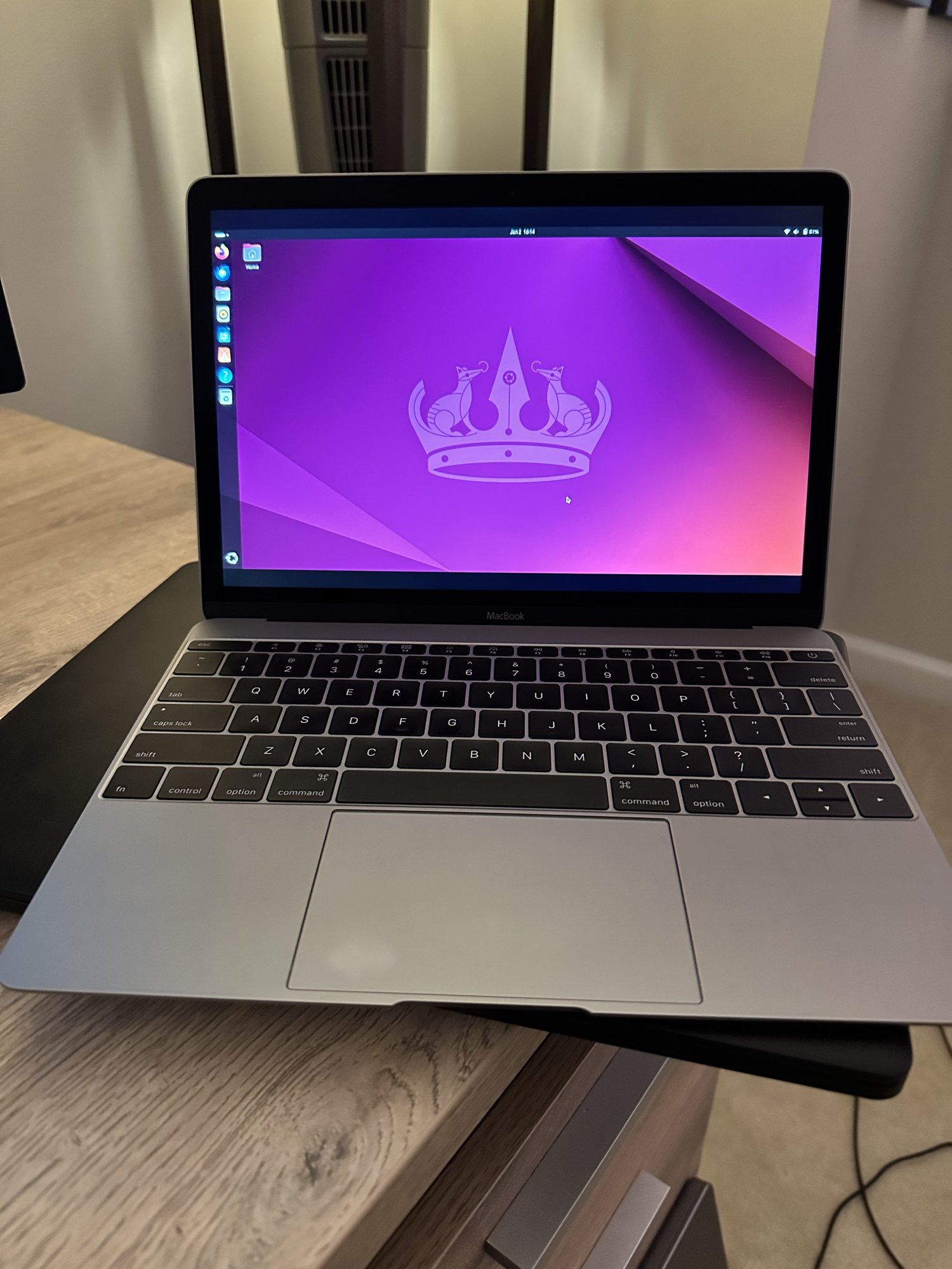

So I did it - installed Ubuntu 24.04 on my early 2016 Retina MacBook. I did a complete wipe of the drive and installed Ubuntu solely on the system, no dual boot. I havent tested out Bluetooth yet, but I had no issues connecting to my wireless network, and the system is chugging along nicely. The battery life even seems improved over what Monterey was giving. Only downside I've noticed is after the machine goes to sleep it wont accept my password for signing in, and I need to hard shut down. This isnt a machine I actually plan on doing anything with, but I was bored

Looks great. Ubuntu takes a while to wake up from sleep on my 2014 MBP but otherwise works great. BTW I switched the Gnome desktop to smart mode and moved the dock to the bottom of the screen and changed it to not extend to the screen edge like the MacOS doc.
I'm going to do some tinkering with it over the weekend. I did check sound and microphone and I'm not getting anything from either.
Sound works for me, haven't checked the mic but it is not a feature I need on Linux.
Yeah, I'm not really too concerned with no sound or mic, just something I noticed. Other than that, the system is running quite smoothly.
One problem I have just discovered, the internal SD card reader does not work which is quite disappointing.

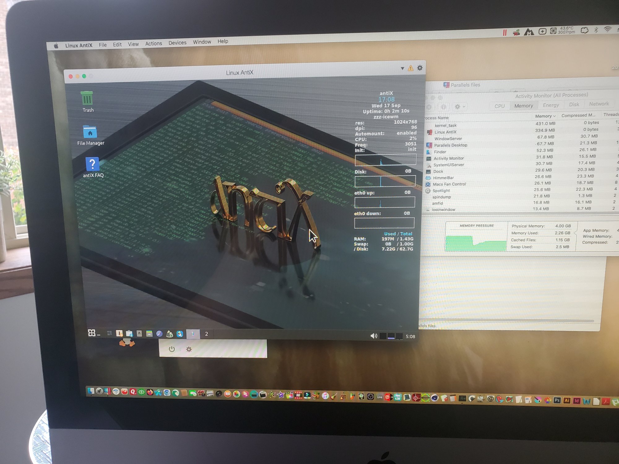

Below is visual proof that not only will a full-featured GUI Linux run on a 15yo Mac, it will do so as a VM inside a host MacOS. Pictured: 2009 21.5" iMac, 4gb ram, with High Sierra (partially debloated by disabling MRT, MDS_Stores, ReportCrash, and Spotlight-indexing) spinning at 5400rpm. AntiX Linux is using less than 200mb of a total 1.5gb granted by the VM (whose shell is using another 140mb or so, for about ~335mb total uncompressed. I could actually have Photoshop CS6 running without triggering swap (unless I opened something really huge).
What to do next? Spend money on new ram and tear the case open to put in an SSD? No. I'll keep carving away Apple's bloat, namely all the underhood garbage between Snow Leopard and High Sierra that has the latter gobbling an extra gig of ram at rest for the privilege of being one quarter as snappy. Next step is to see if the same VM (created in Parallels 18 on a Mojave machine) will still open in progressively older versions of Parallels such as would run in, say, MacOS Lion. This would free up a lot of ram for use by a "modern" browser in the hosted Linux.
