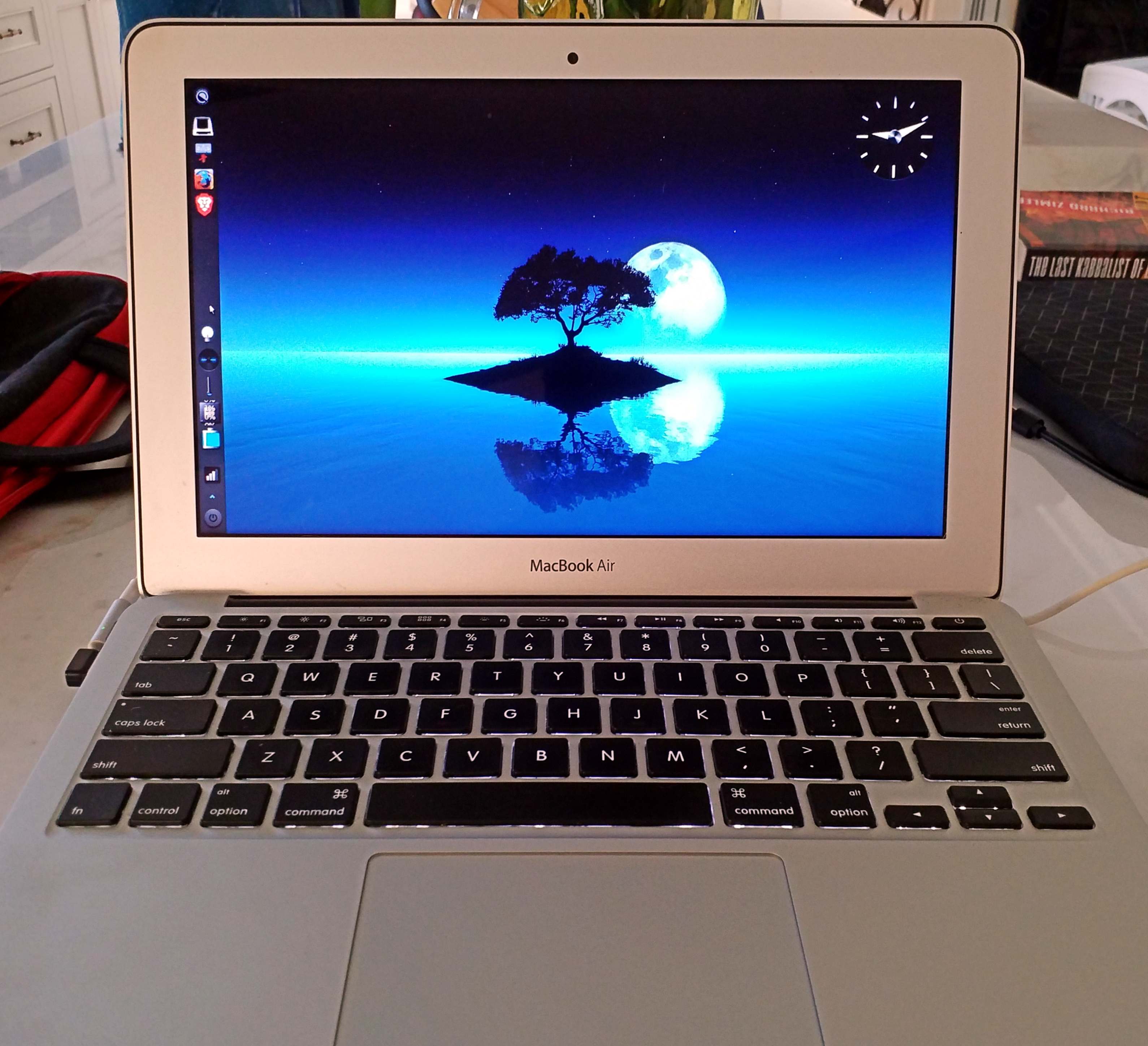

Switched to Bodhi linux. Comes with Moksha de, a forked version of Enlightenment de. Super fast and efficient, wifi worked out of the box, had to fix kb backlight. Enrolled in free Ubuntu Pro to get support/security updates thru 2032.

How did you fix the backlight?
That is not the standard out of box look for Bodhi, I added theme Mokshadimensions and Bodhi-Moonlight wallpaper, put shelf on left . Very customizable.

Googled it and got AI help for kb brightness- this is the process I used.
Installed "brightnessctl" (sudo apt update && sudo apt install brightnessctl)
Added user account to the video device group (sudo usermod -aG video $USER)
then reboot.
Mapped the Bodhi Linux Keybindings using "xbindkeys"
(sudo apt install xbindkeys
xbindkeys --defaults > ~/.xbindkeysrc
nano ~/.xbindkeysrc)
Added the binding codes to bottom of that file and saved.
• For F5: brightnessctl --device="smc::kbd_backlight" set 10%-
• For F6: brightnessctl --device="smc::kbd_backlight" set +10%
