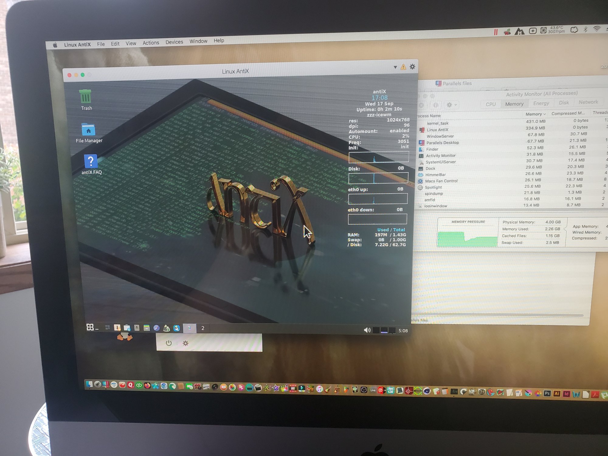

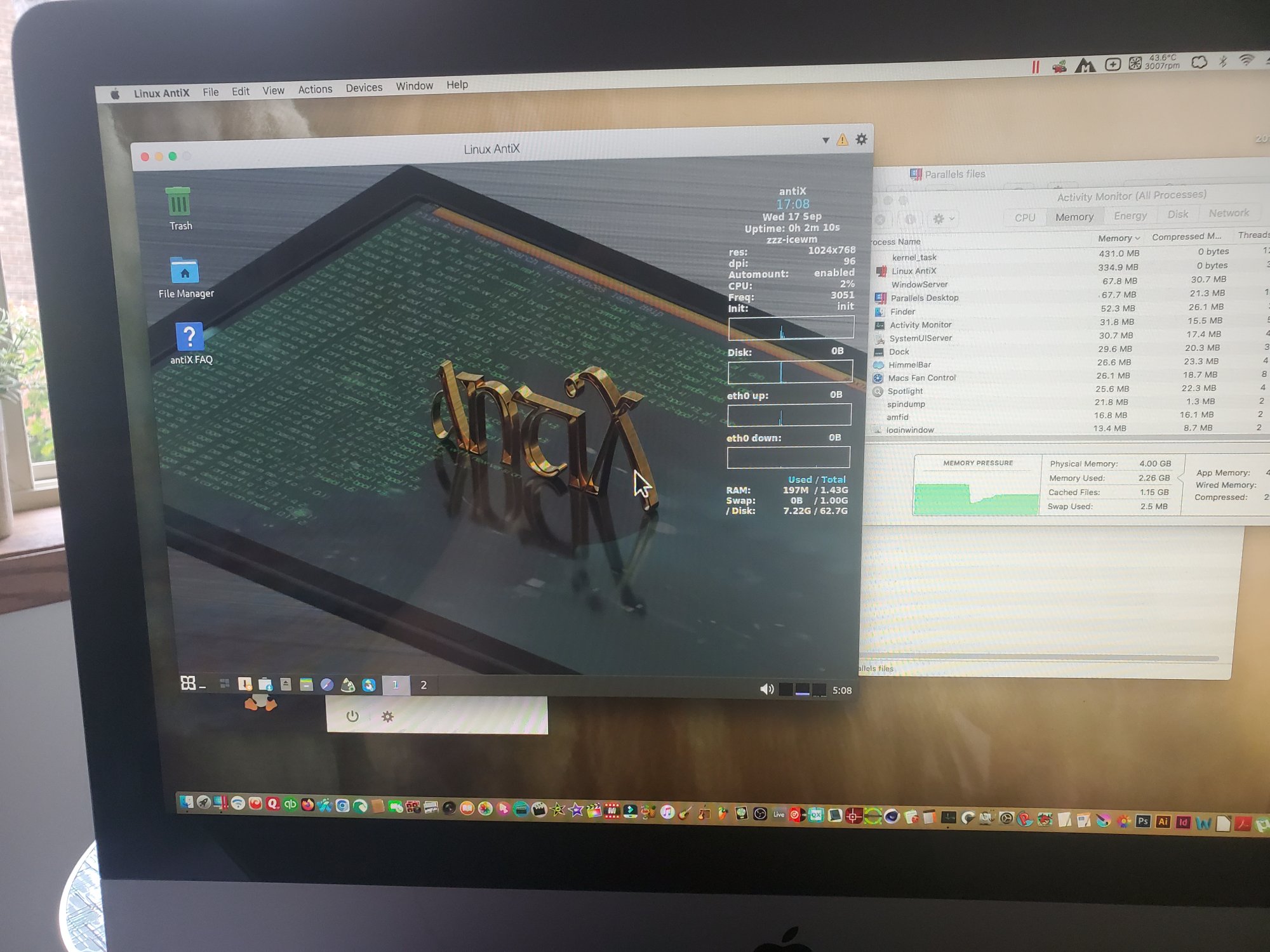

Below is visual proof that not only will a full-featured GUI Linux run on a 15yo Mac, it will do so as a VM inside a host MacOS. Pictured: 2009 21.5" iMac, 4gb ram, with High Sierra (partially debloated by disabling MRT, MDS_Stores, ReportCrash, and Spotlight-indexing) spinning at 5400rpm. AntiX Linux is using less than 200mb of a total 1.5gb granted by the VM (whose shell is using another 140mb or so, for about ~335mb total uncompressed. I could actually have Photoshop CS6 running without triggering swap (unless I opened something really huge).
What to do next? Spend money on new ram and tear the case open to put in an SSD? No. I'll keep carving away Apple's bloat, namely all the underhood garbage between Snow Leopard and High Sierra that has the latter gobbling an extra gig of ram at rest for the privilege of being one quarter as snappy. Next step is to see if the same VM (created in Parallels 18 on a Mojave machine) will still open in progressively older versions of Parallels such as would run in, say, MacOS Lion. This would free up a lot of ram for use by a "modern" browser in the hosted Linux.
Dude I love this. Old hardware is very capable.
