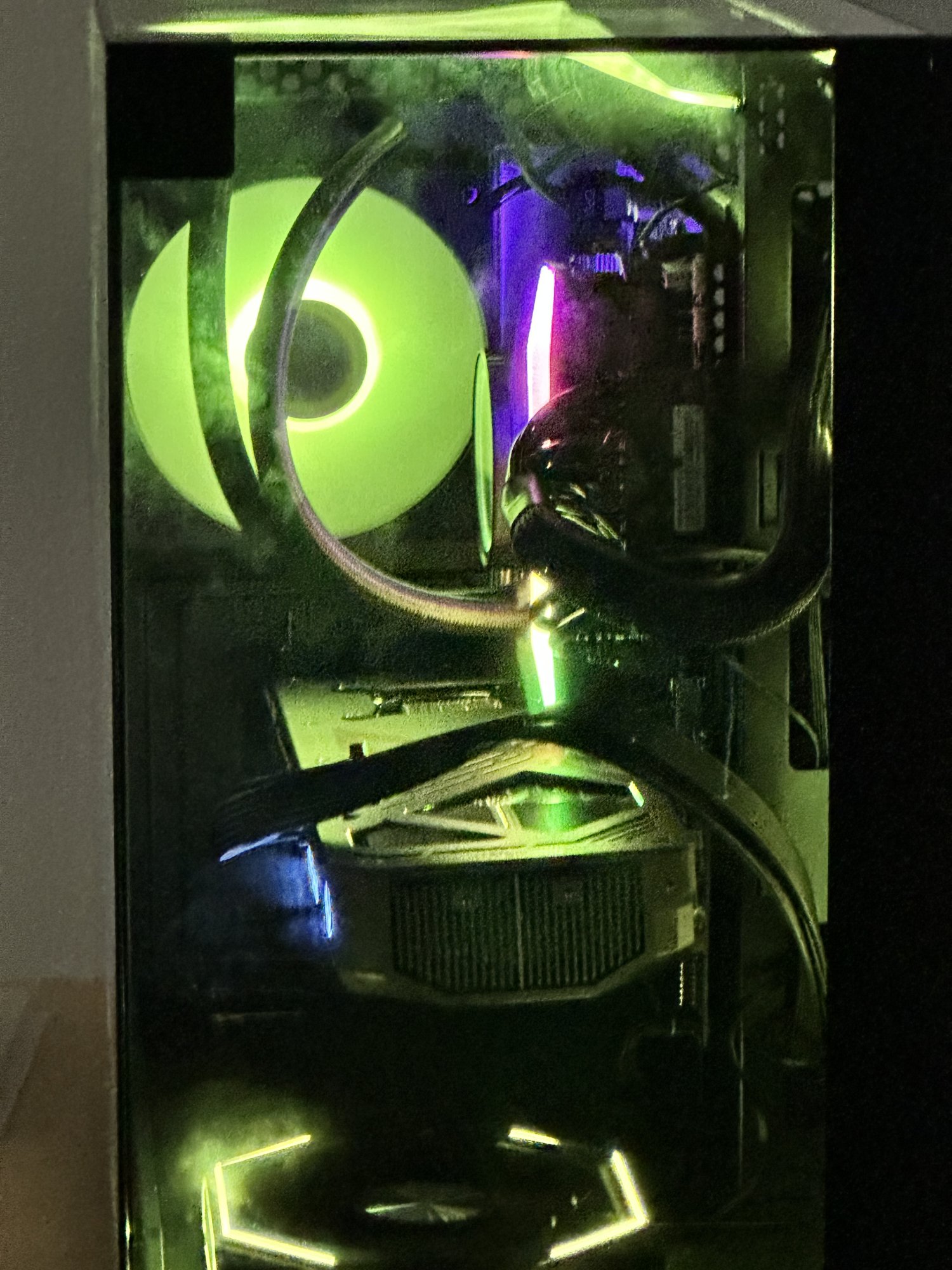

Not sure yet of cpu temps though load is 90's cod 6 loading screens.
Mid120's fps @4k prob drop to 1440.

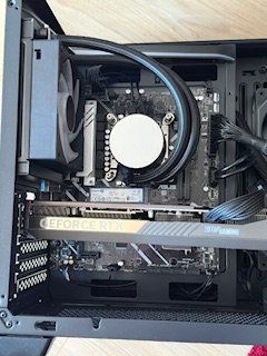

Meanwhile is gpu Covering 2nd M.2 Slot.

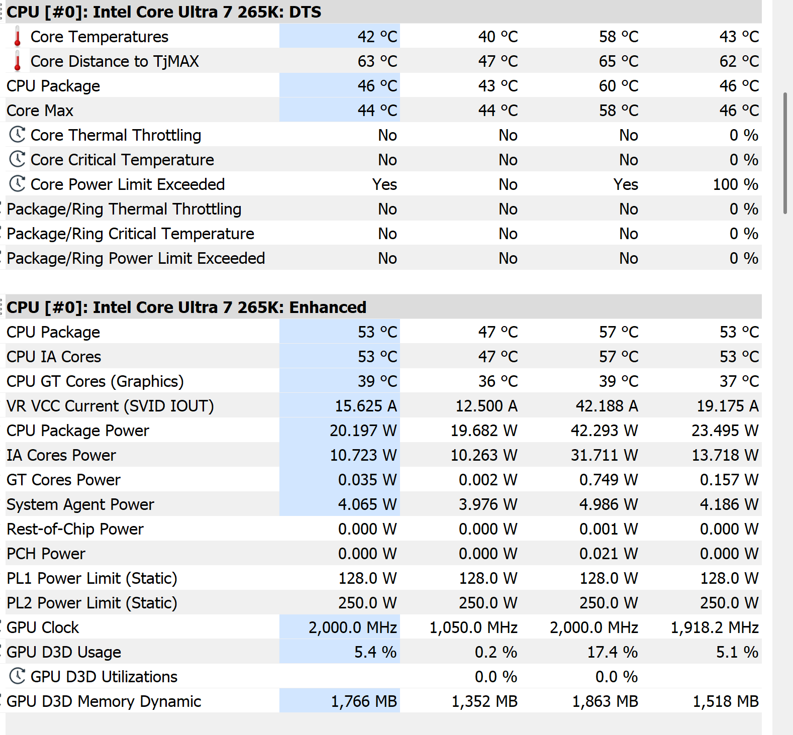

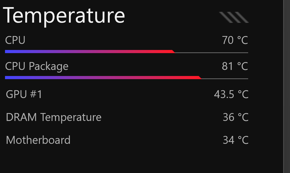

Cinebench multi core running...cpu temps

For the size of the radiator those temps are probably fine. I wouldn’t do any overlocking though. What frequencies are you seeing for the Performance and Efficiency cores?
If its in the 90’s in the cod 6 loading screen, then its thermal throttling in cinebench, temps should be higher in cinebench which is maxing out all the cores vs call of duty, temps will drop when it throttles itself. But as long as it’s performing to your satisfaction, that’s the main take away from it.
Reactions: Donfor39
If hwinfo64 is accurate, he is hitting power limits before thermal limits. I think the H810i board limits to PL1 which the 120MM AIO should be able to cool. I would be curious to see the highest CPU Package power he is able to get under Cinebench.
I noticed the power limit exceed as well but the max wattage shown in that screenshot was 42 watts. Pl1 for that chip is 125 watt. So how bad is this board hampering that chip? Seems wasteful if that’s how power limited it is

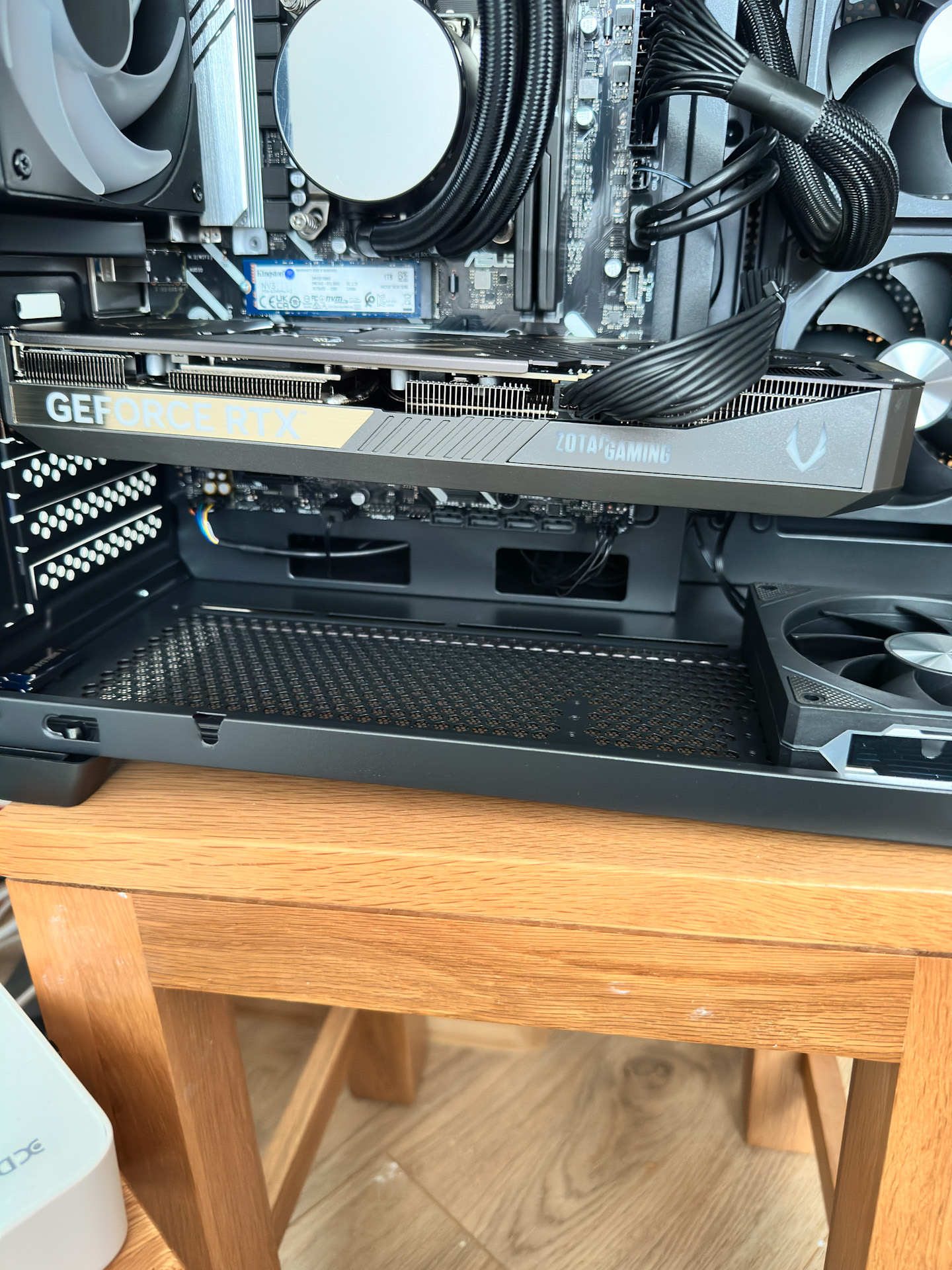

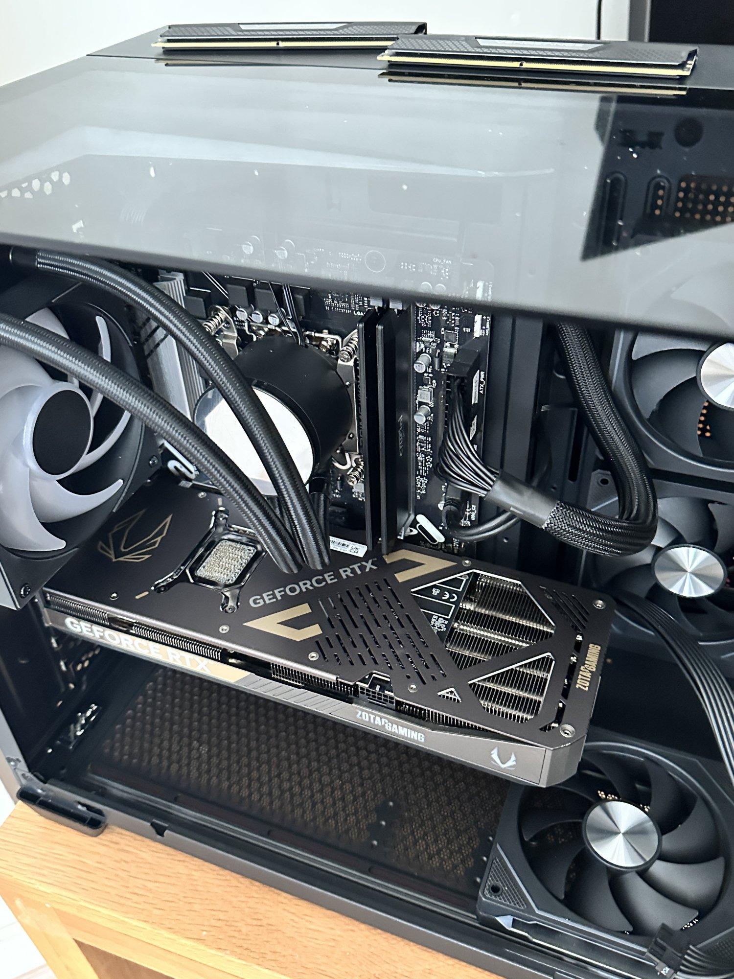

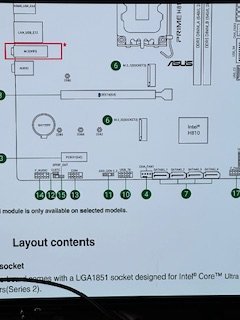

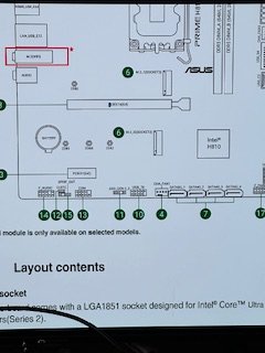

I continue to consider placing it on one side, is 2nd m.2 slot visible via my recent photo's
If I refer to Asus it should be underneath gpu approx.

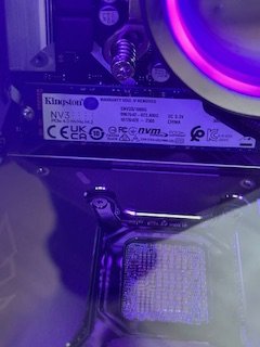

+Does pcie-4.0x2 mean if I add 2nd ssd does this half speed of pre m.2 ssd 1st slot is pcie-4.0x4.
Existing ssd sits above gpu -where is 2nd ssd slot which should be below.

Existing ssd sits above gpu -where is 2nd ssd slot which should be below.View attachment 2505000
Yeah it gets half the lanes and thus half the bandwidth.

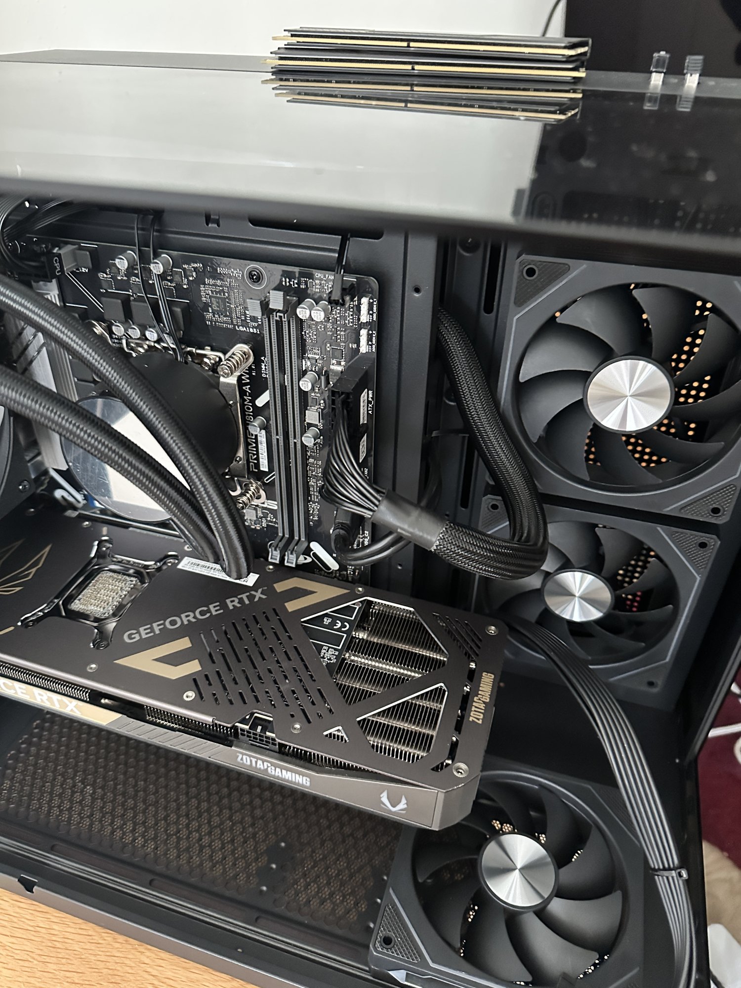

Help required pc is to be returned from Scan as I failed to swap 16gb ddr5 to 32gb.
Example includes 1 open slot 1 closed slot.
What is the correct method whilst reinserting each ram stick.
Is it from bottom Fixed end 1st /Top End or hold both ends above slot and drop in.
I recall 1st slot didn’t auto close top end when 2nd slot did Auto Close.
I added 2nd example with ddr5 swapped which led to failed boot flickering led.

The ram should slide in evenly. Keep pressing until it clicks.

Why is Primary Kingston ssd m.2_1 PCIe 4.0x1 PCIe4.0x4
Secondary Crucial ssd m.2_2 PCIe 4.0x2 PCIe4.0x4
Why would Link speeds connect from x1 from primary yet locked at x2 from 2nd lane.

Primary usually comes off the CPU the secondary off the chipset. So maybe the lane distribution for your 5070ti is the culprit?
This new Corsair Pro requires some precision to seat even with slightly curved connectors both sides.
I've reverted to original 16gb vengeance which needs bios battery removal to boot.
Agreed to order 32 gb vengeance rgb grey which Is listed via mb QVL as pro isn't.
