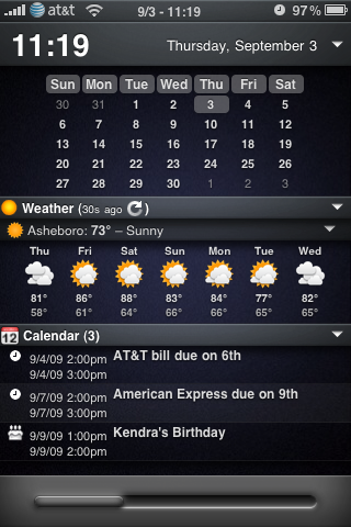

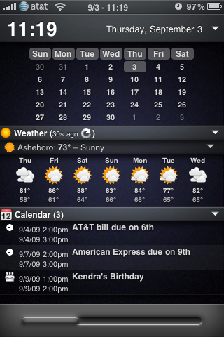

Just recently discover this wonderful app and I love it! Big thanks to the developer. A donation is on the way. I encourage anyone else that loves the app to do the same.
Maybe a simple question, but is it possible to make it so you can scroll through your info screen and have it not snap back to the top? I get a lot of emails and events and such and I'd like to be able to scroll down and see everything on the screen. I've played with some of the settings and sometimes... it works for a bit but then stops and starts snapping back again.

You can scroll, but as soon as you let go of the screen, it will snap back.

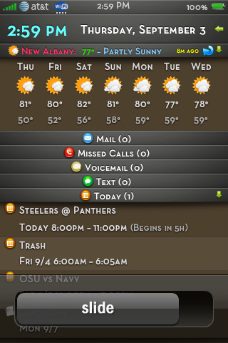

After a bit of messing about I finally got this to work and it looks good.
A simple question I hope, how do I get the sections headings (Mail, Calendar etc) to be left aligned rather than centred?
You have to edit your config.js file I believe. I forget it's location but I'm sure a quick google will find it.
You need to edit the structure.css file. It's located in Gruppled/Bundles/com.ashman.lockinfo/css. Find this text...
