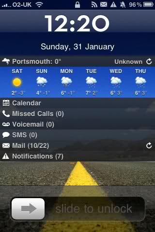

Anyone know how to change the opacity, so I can see the background clearer?
Is it possible to use the Gruppled theme too?
It's under the iPhone "Settings" then under "LockInfo" then adjust "Background Transparency" with the slider.

I tried changing the Background Transparency but it doesnt seem to do much 🙁
Yeah, weather is just from the Lockinfo plugin's

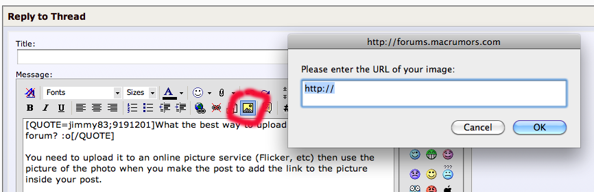

What the best way to upload screenshot to this forum? 😱
You need to upload it to an online picture service (Flicker, etc) then use the picture of the photo when you make the post to add the link to the picture inside your post.
<snip>
With Gruppled HTML none of these settings will work. You can use Gruppled Art because it has a native LockInfo theme.
I'm assuming you want to change the transparency of the section headers (the bars that say calendar, phone, etc...). The only way to do this is to edit the images that are being used.
To edit the default ones they are in /Library/LockInfo/SectionHeaders.png
To edit the ones with Gruppled Art /[your themes folder]/Gruppled Art.theme/somewhere in here you should see the sectionheaders.
You can change the transparency easily in Gimp. 😀

Ok thanks, I used the Gruppled theme with WB a while back but ditched WB as iam on the 3G...can I install the Gruppled art theme without WB?
Thats a shame about the transparency 🙁
Ok thanks, I used the Gruppled theme with WB a while back but ditched WB as iam on the 3G...now lockinfo doesnt use WB iam using it again so was hoping to use the Gruppled theme 🙂
Oh, then you can apply the theme manually. I have put directions here... a good number of times, haha.
Basically you need to replace the sectionheader.png files from lockinfo with the ones from the gruppled art theme. That's about it.
