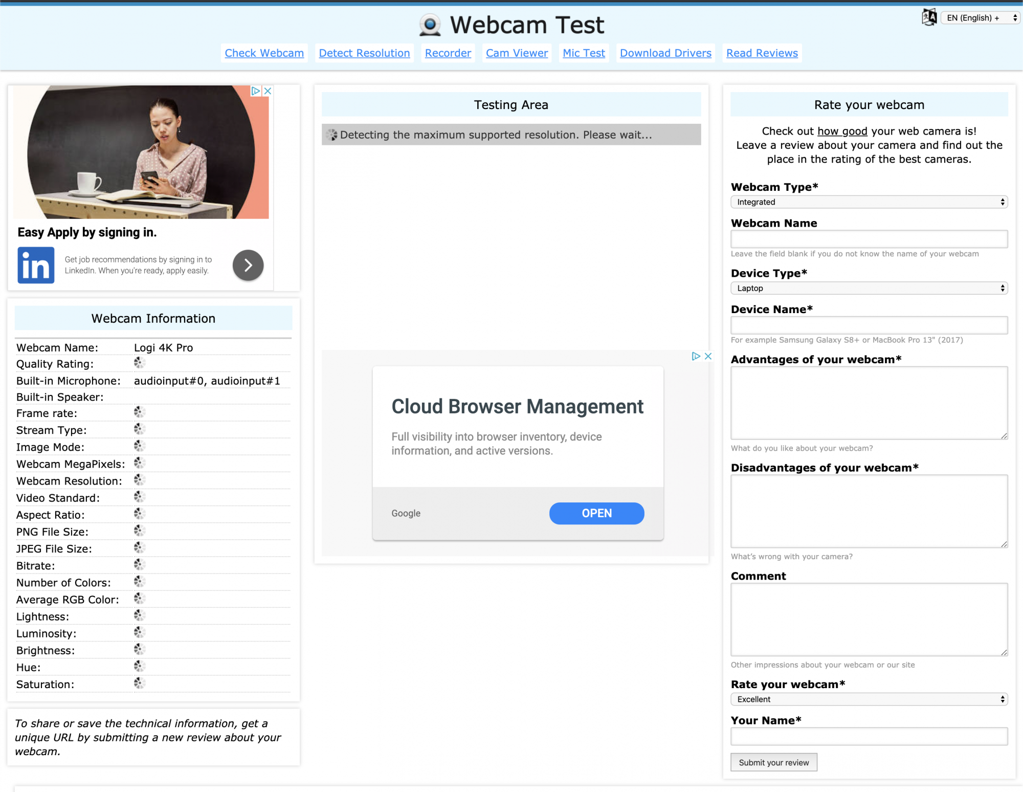

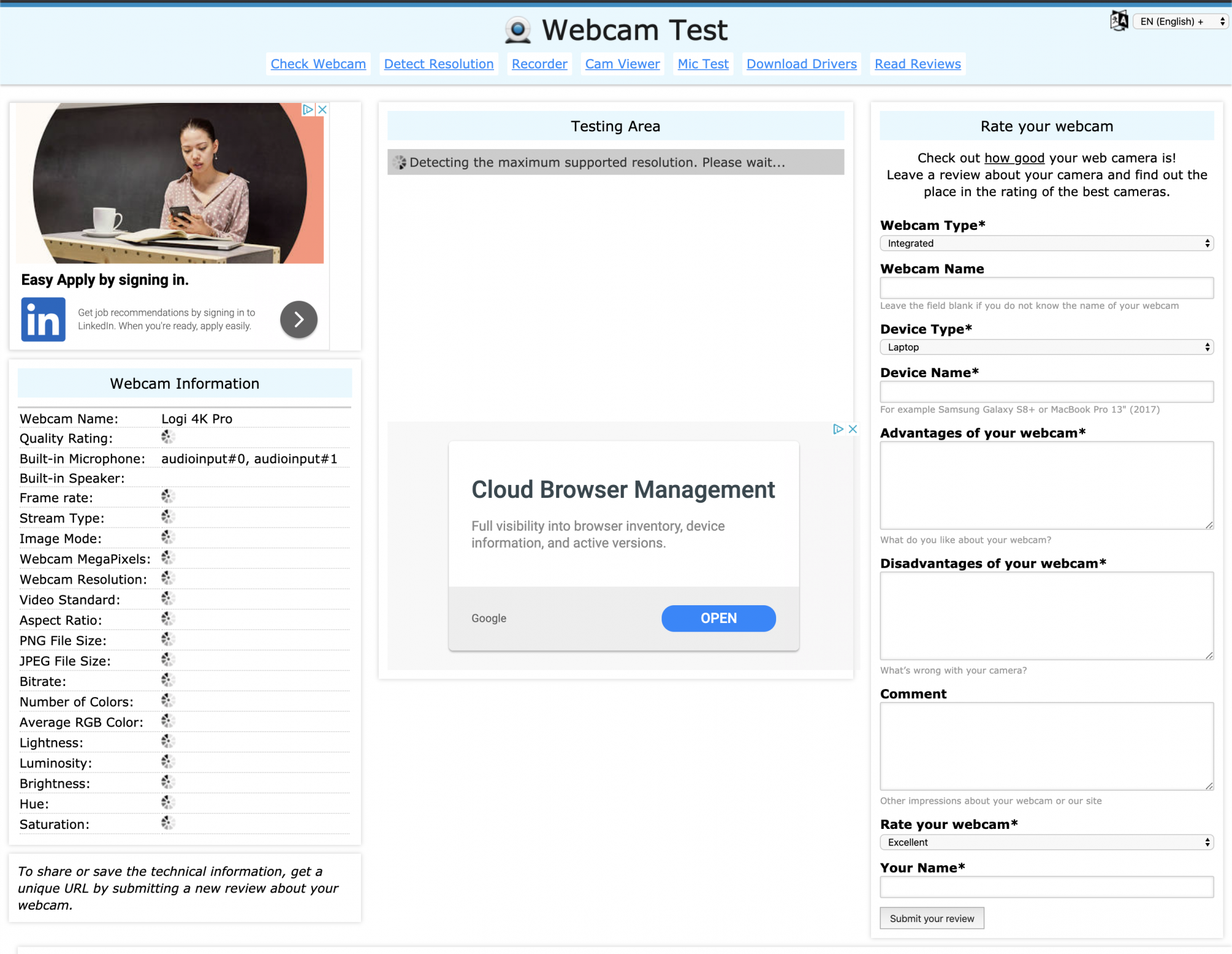

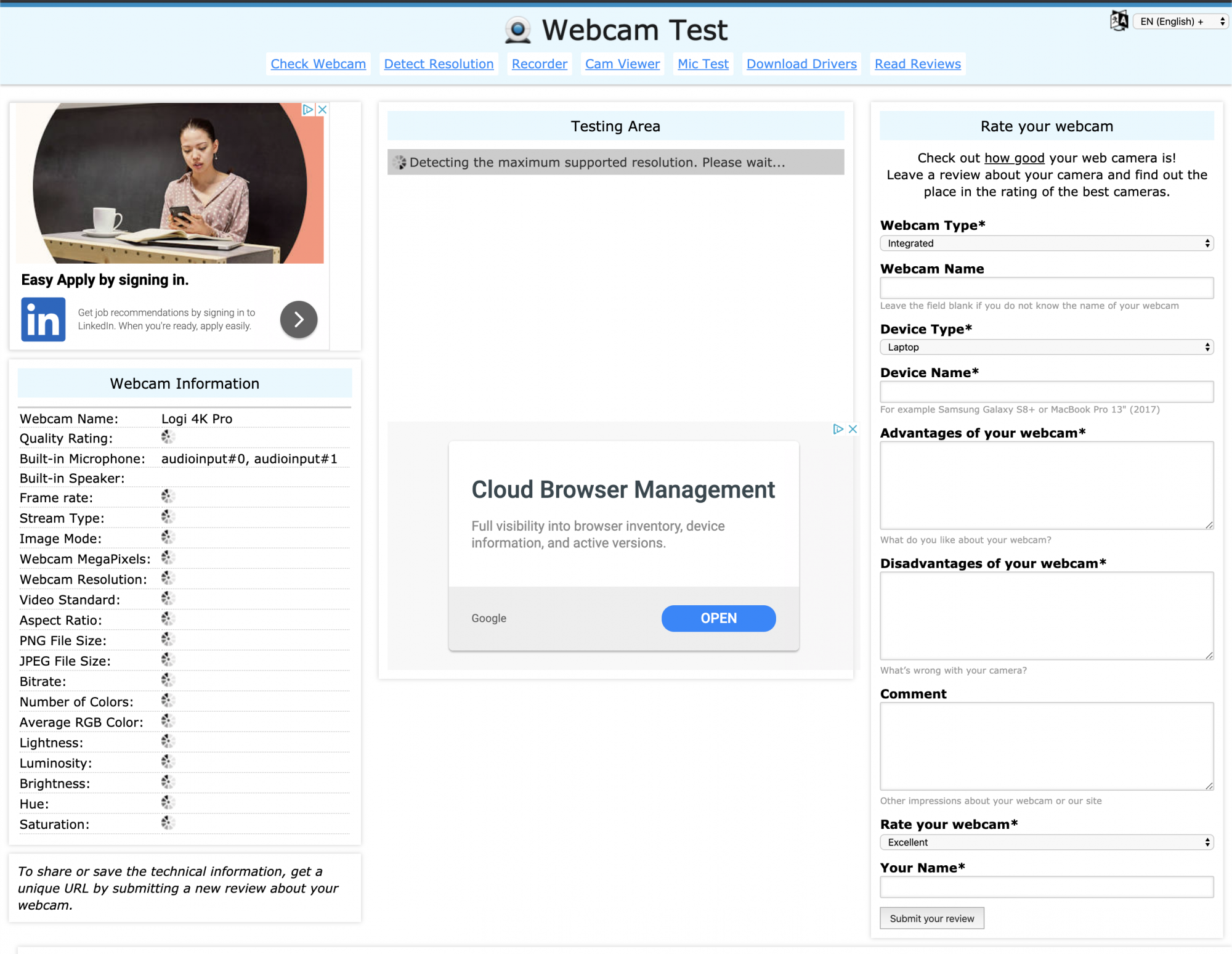

Just beware that that Logitech 4K Pro Magnetic Webcam for the Pro Display XDR does not work with any Chrome driven apps or web apps. It does work with FaceTime and QuickTime apps but the second you want to use Chrome based conference services it will not pull a video signal (microphone does work). It fails to show video in Chrome web cam testing sites. Unfortunately the one service our company uses, LifeSize is based on Chrome for the UI so I'm SOL until I can figure out a work around. Anyone have any ideas?

Well it’s not a fix but I have information to add on this issue. The Logitech 4K Magnetic Webcam will not work on online webapps using Chrome as the engine (such as LifeSize). I figured out that a work around is to set the resolution to 480p, a far cry from 4K. Anything higher does not work with this webcam. This is also true of webcamtests.com.

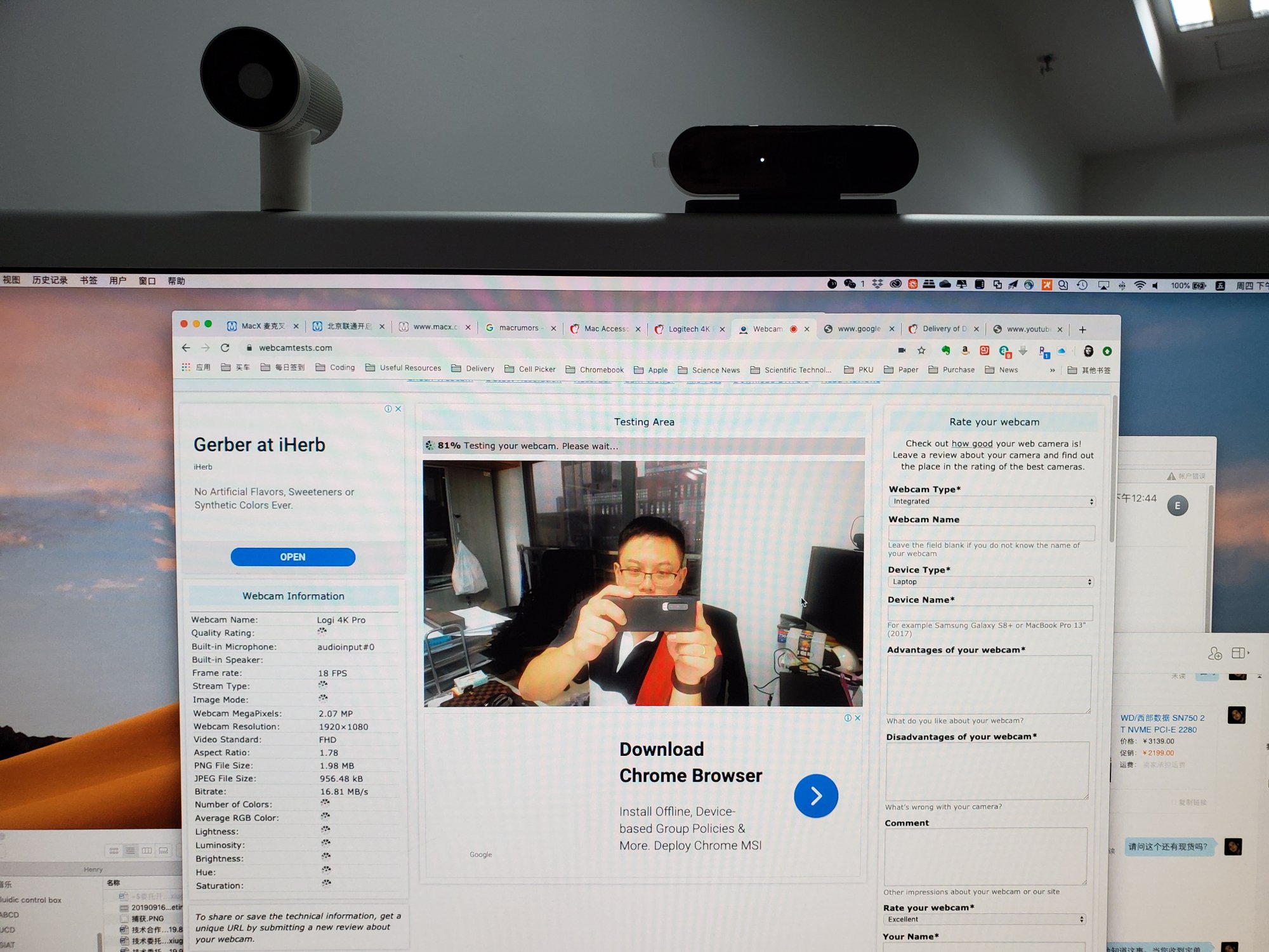

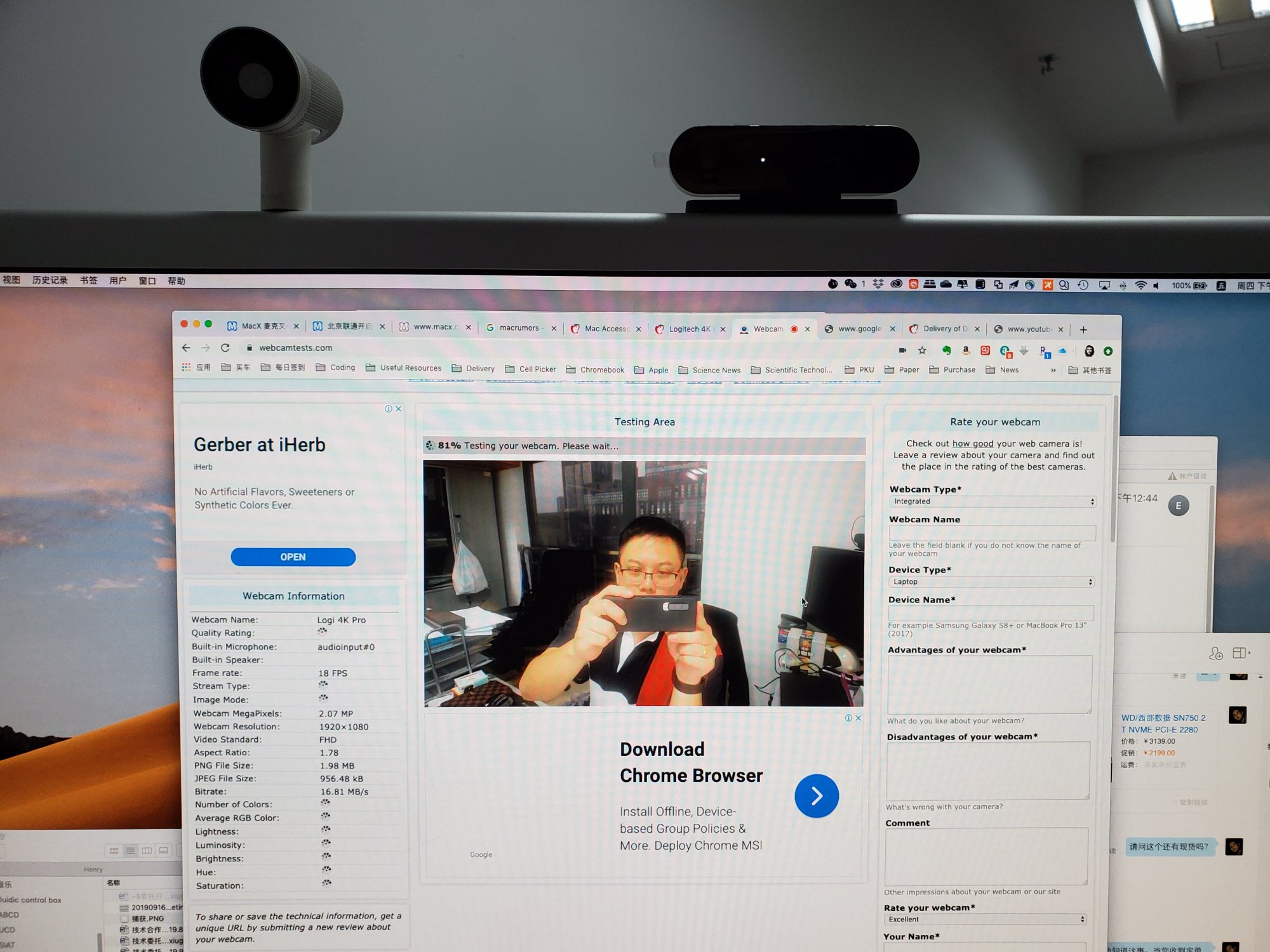

I tried with the https://webcamtests.com/, and it turned out that the Logi 4K can work at 1080p with my computer.

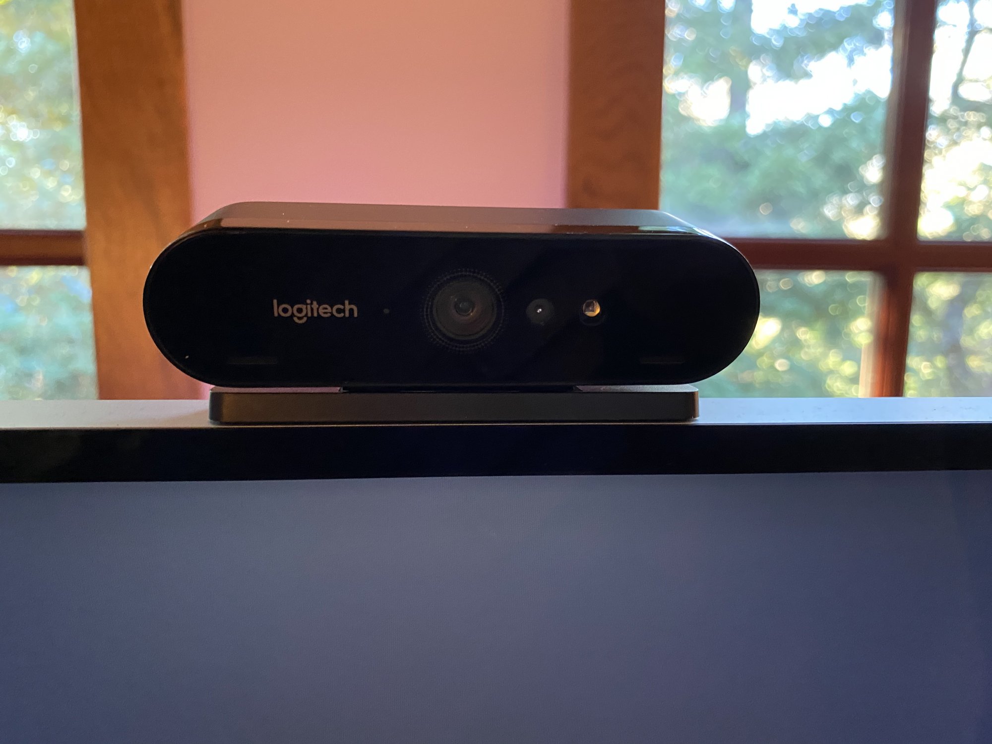

My current set up is 30" ACD + '17 MBP 15" + Logi 4K. I'm waiting for the nano-texture Pro Display XDR to arrive. I found that the Logi 4K's magnet can work/mount on top of the 30" ACD, but the force is not as strong as the traditional iSight camera (also shown in the picture attached).

Also, seems to be working for me on the webcamtests website using Firefox. Using Chrome, I get stock on the same "Detecting max resolution" screen as above.

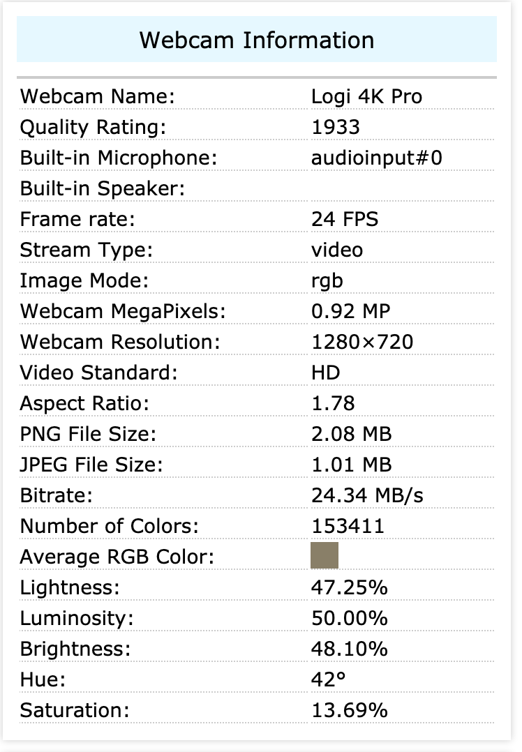

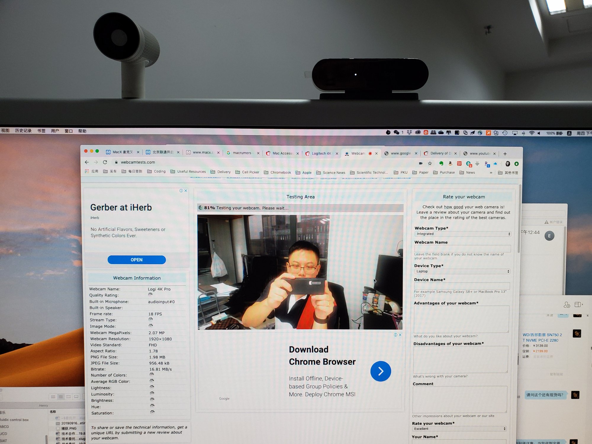

So you are correct about FireFox able to complete the test but if you look at the test results you will notice that it fails to achieve a resolution above 720p. So really it's the same problem but FireFox is smarter about not getting stuck unable to grab anything higher than 720p.
If you test this in Mojave you'll see that you are able to get the full 4K out of it in Chrome or any browser.
