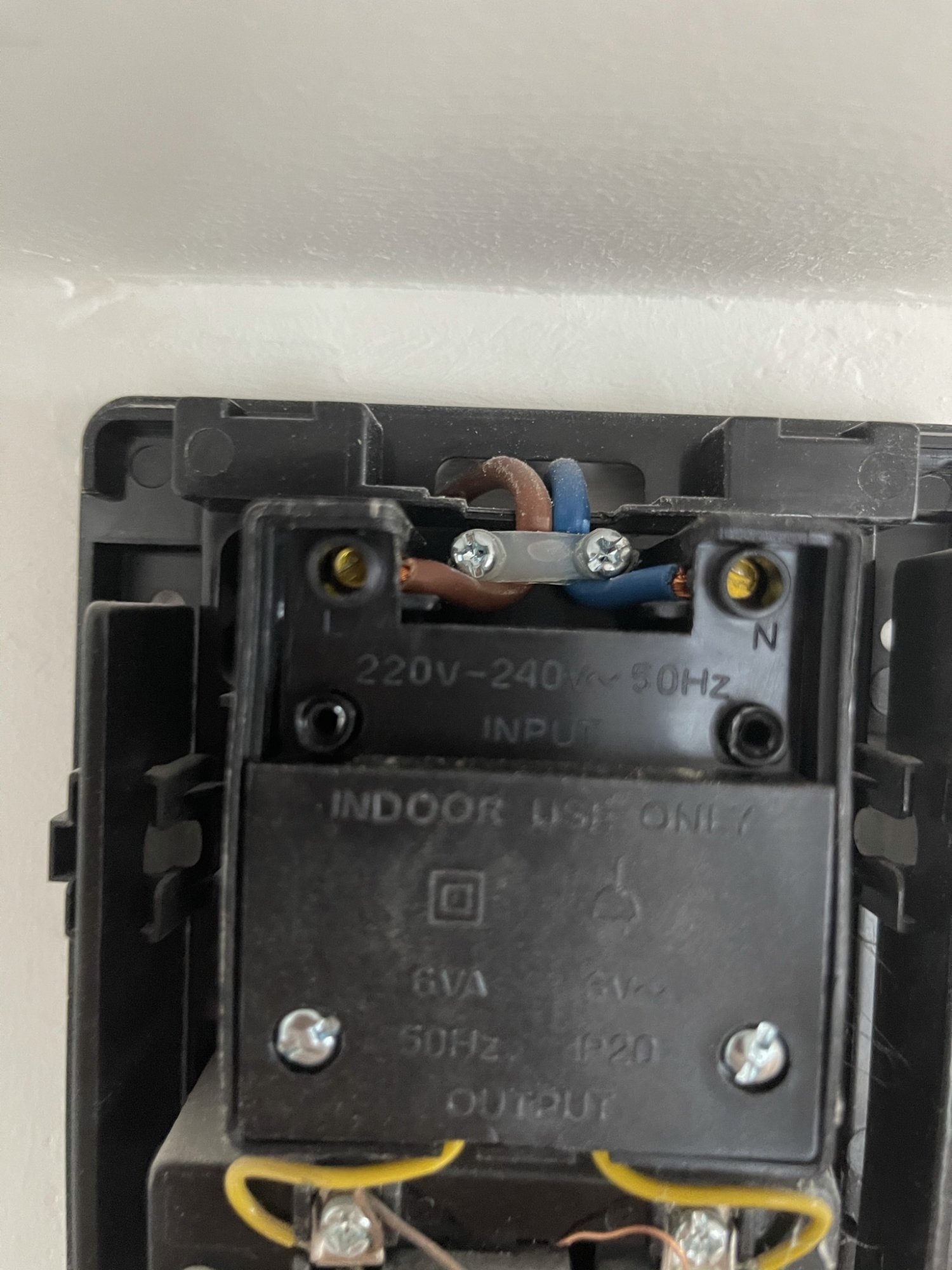

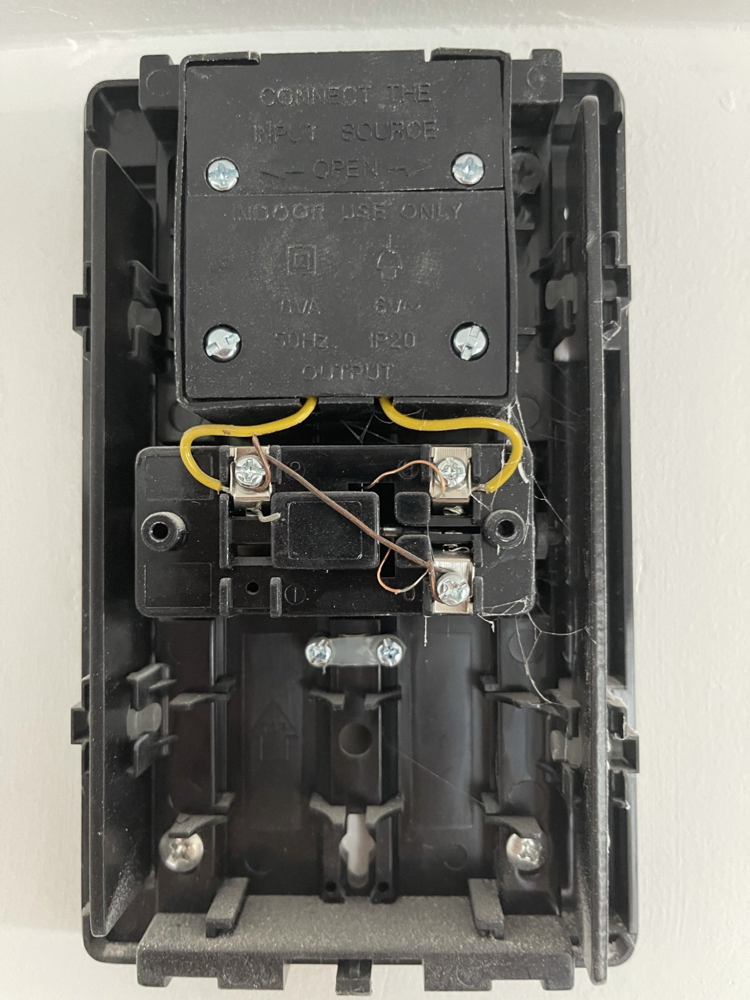

Hi guys,
Anyone could shed light if the Circle View doorbell would be compatible with the attached doorbell. Ive submitted tickets but no response from Logitech yet so i thought one of you may know. Thanks in advance

Quick look at the website says 10VA min. Looks like you only have 6VA transformer.

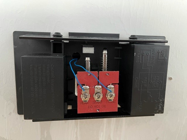

Finally picked one up today and had the professional tech come out. Unfortunately when he wired it in to our existing doorbell wires (just a standard push button) the led just stayed blinking. As soon as we plugged it into the wall it turned green and connected in the home app. He said that meant our wiring isn't powerful enough.
From what I can gather I should have enough power for this (brand new house) but maybe I am missing something?
I did find it odd that there isn't a wire attached to the one labeled transformer, but Front & Rear (we do not have a rear doorbell).

Did the "professional" not look for the actual transformer to verify what kind of power supply it had?
Did he put the old doorbell back together like that? Does it work? In my experience your doorbell should not work without a wire hooked up to the transformer terminal.
If you don't have a rear doorbell the wires would normally be hooked up to the transformer and front terminals.

Somehow our existing doorbell does work in that configuration. When I disconnected the wire from the Rear and placed it on the transformer and re-installed the Logitech, I got a blinking white LED and our chime started chiming every 30 seconds.

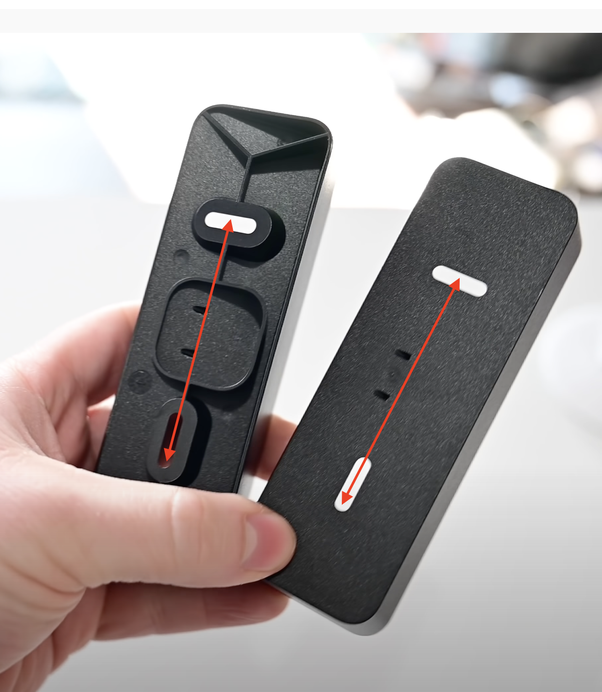

For those with an unused mount (either flat or angled), what is the farthest distance between the screw holes? ie: the distance of the arrow marked in red on this screenshot. I moved into a place where I can replace the doorbell but can only use the existing screw anchors because the area behind the doorbell in between those screws is removed as well. The current screw anchors are roughly 3.25 inches apart. I'm worried I won't be able to use this doorbell if it's less than that.
