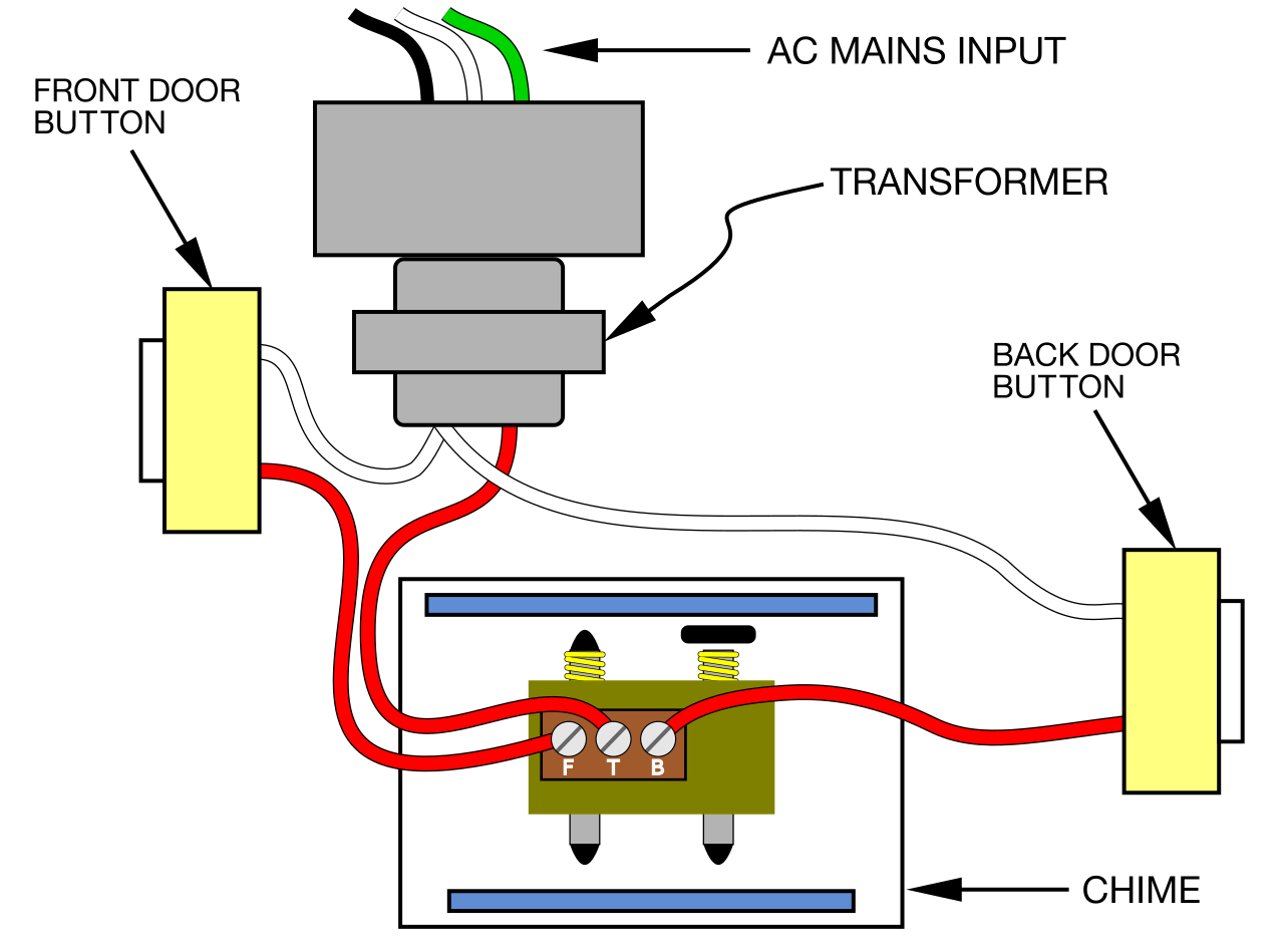

Installed my door bell as well, but I noticed two issues with it and wonder if others also have this. i want to disable to Chime Doorbell, but that settings does nothing. No matter what, the doorbell always chimes. Another issue I have is the Chime on HomePod. No matter what, my HomePod won’t chime. Any idea how to troubleshoot these two issues? can someone please confirm if these options works as advertised?
“A easier and safer solution for someone with little to no experience would be to buy a 2 plug transformer off Amazon and plug it into an outlet. Paint the wire so it blends in and then put a decorative plant or piece of furniture to cover the wire.”
and this is a traditional transformer:View attachment 1690615
A professional electrician would follow the above diagram that connects a transformer to the AC mains. As I said, it was a professional approach that you would receive if you hired an electrician.
Some people want professional results for their home projects.

Mlody no issue turning off physical chime here, perhaps double check you chime box wiring?

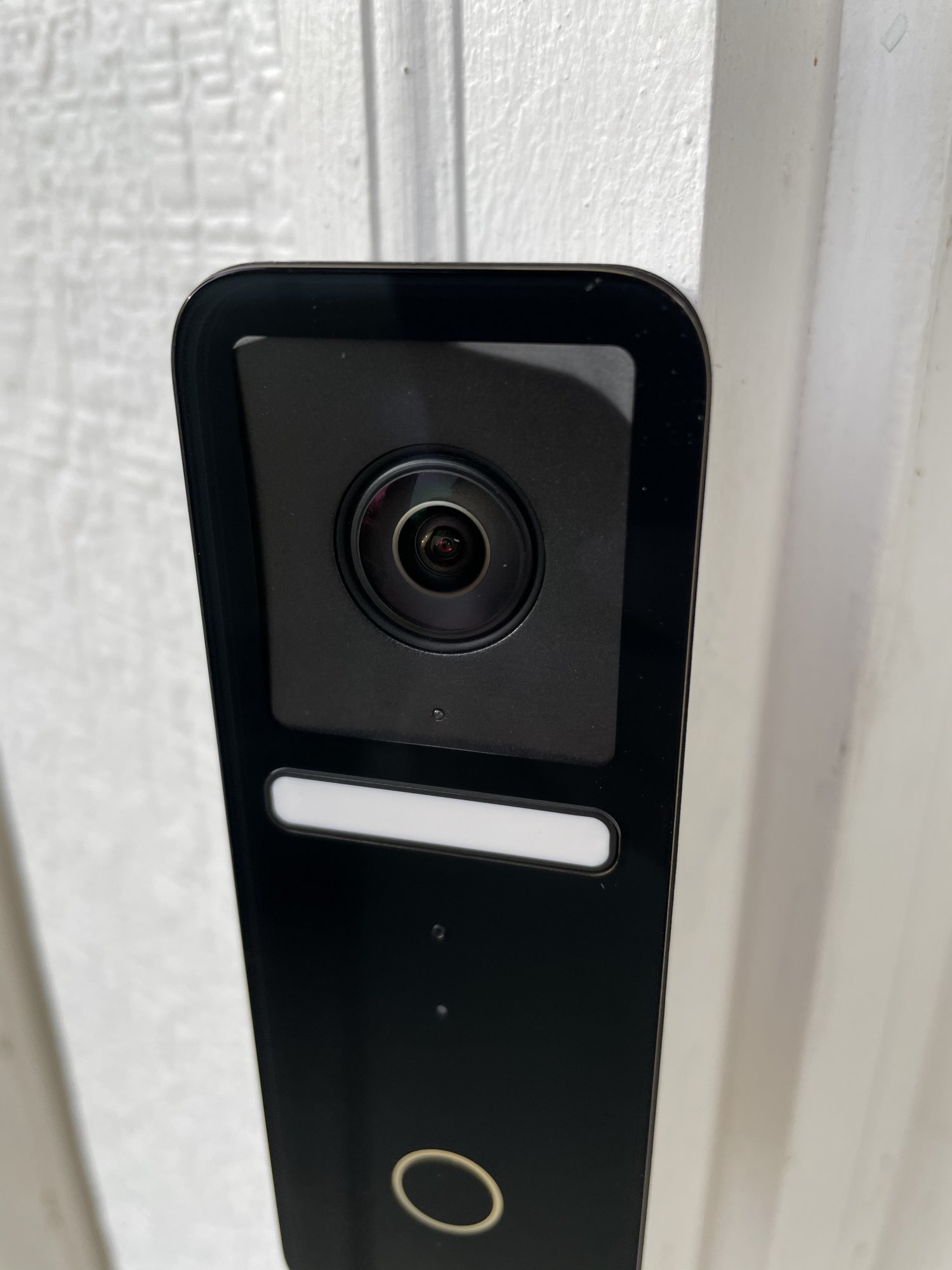

Anyone else have issues with the inside of the glass fogging up? It is about 33 degrees F outside today here.
Two thoughts:
1. the device is putting out heat causing it to fog up
2. Your doorbell wire hole is allowing warm and humid air to escape from your house and into the door bell. I would ensure your doorbell wire hole is as small as possible and seal it up with caulk.
