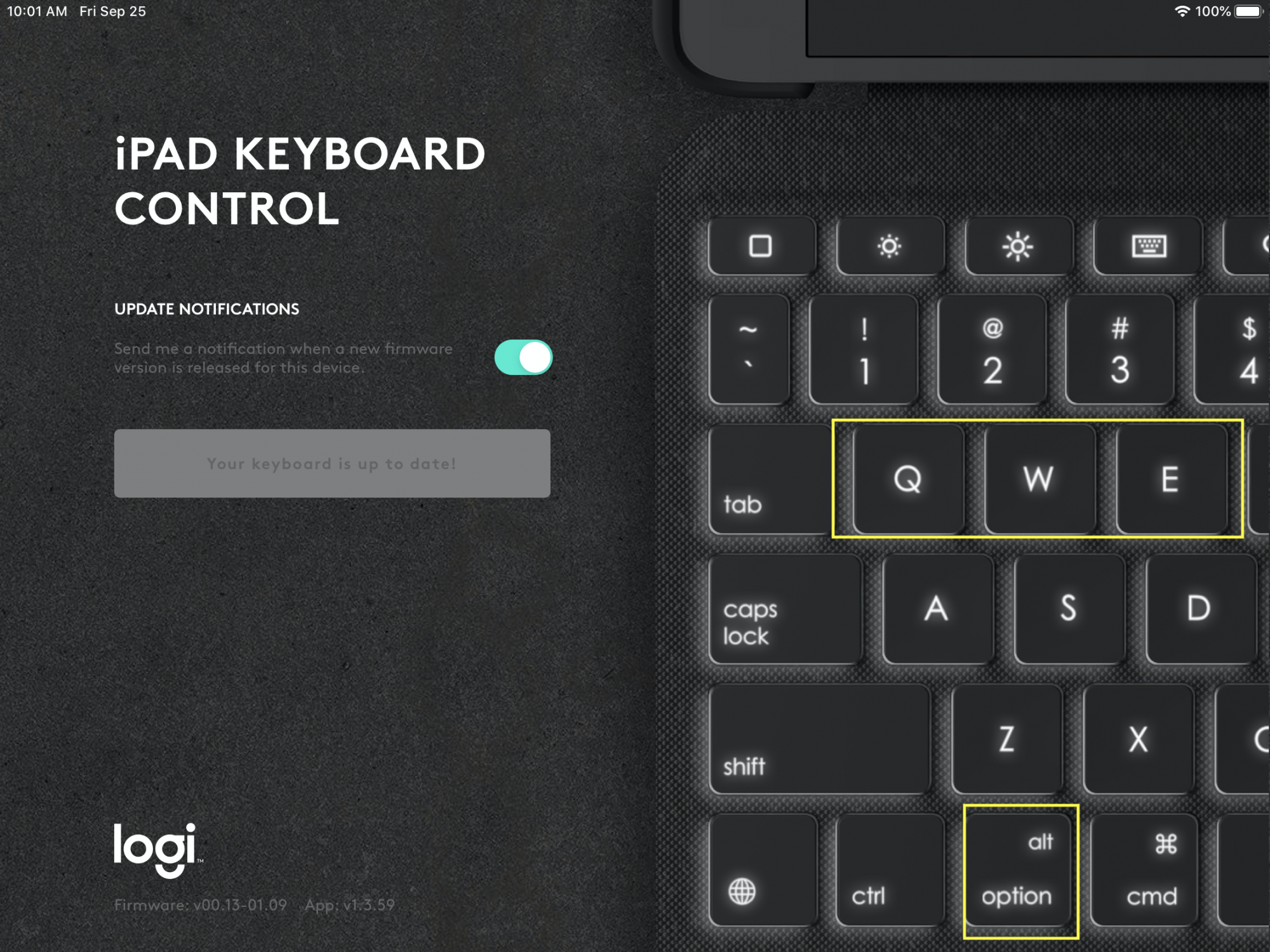

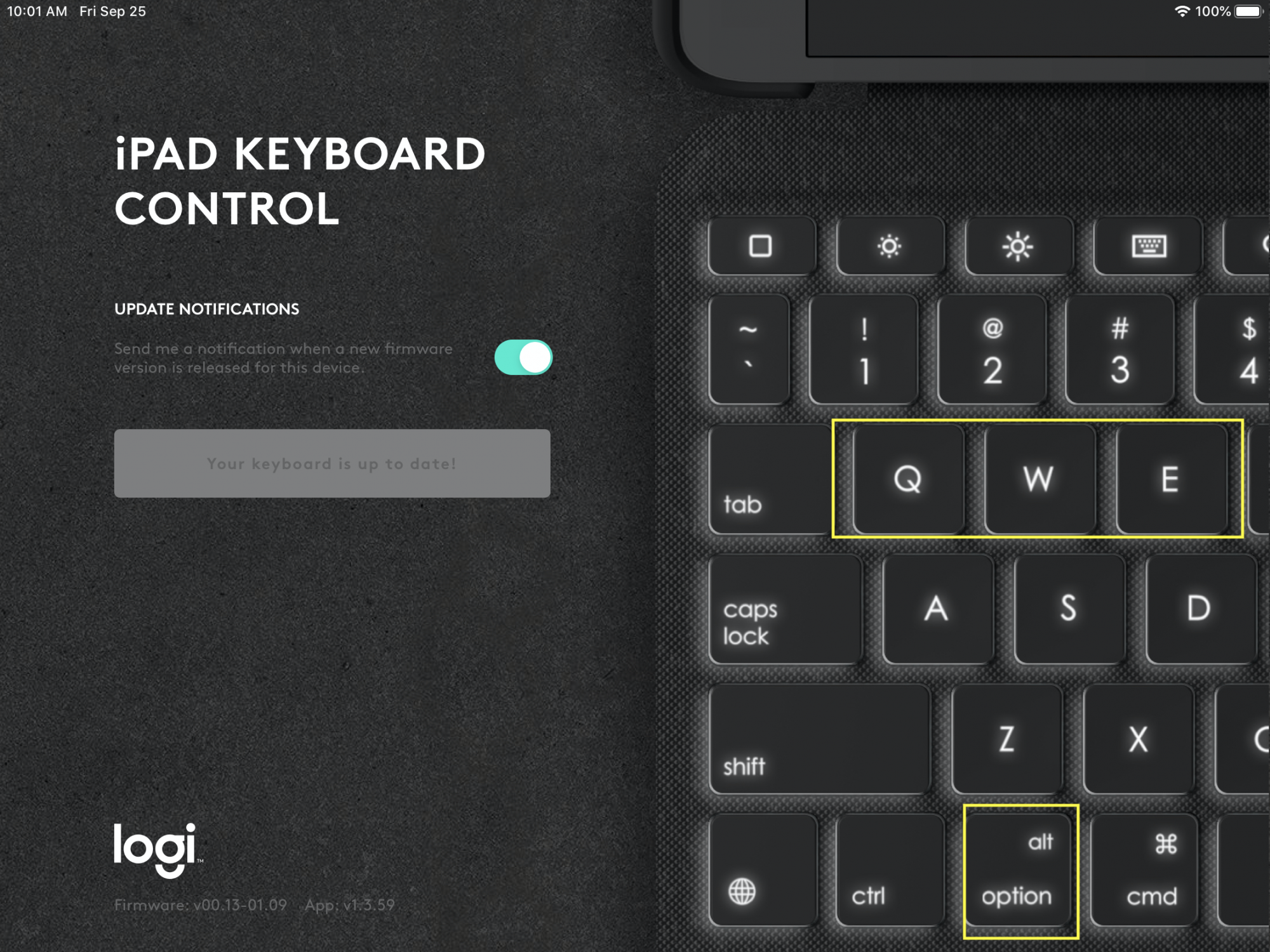

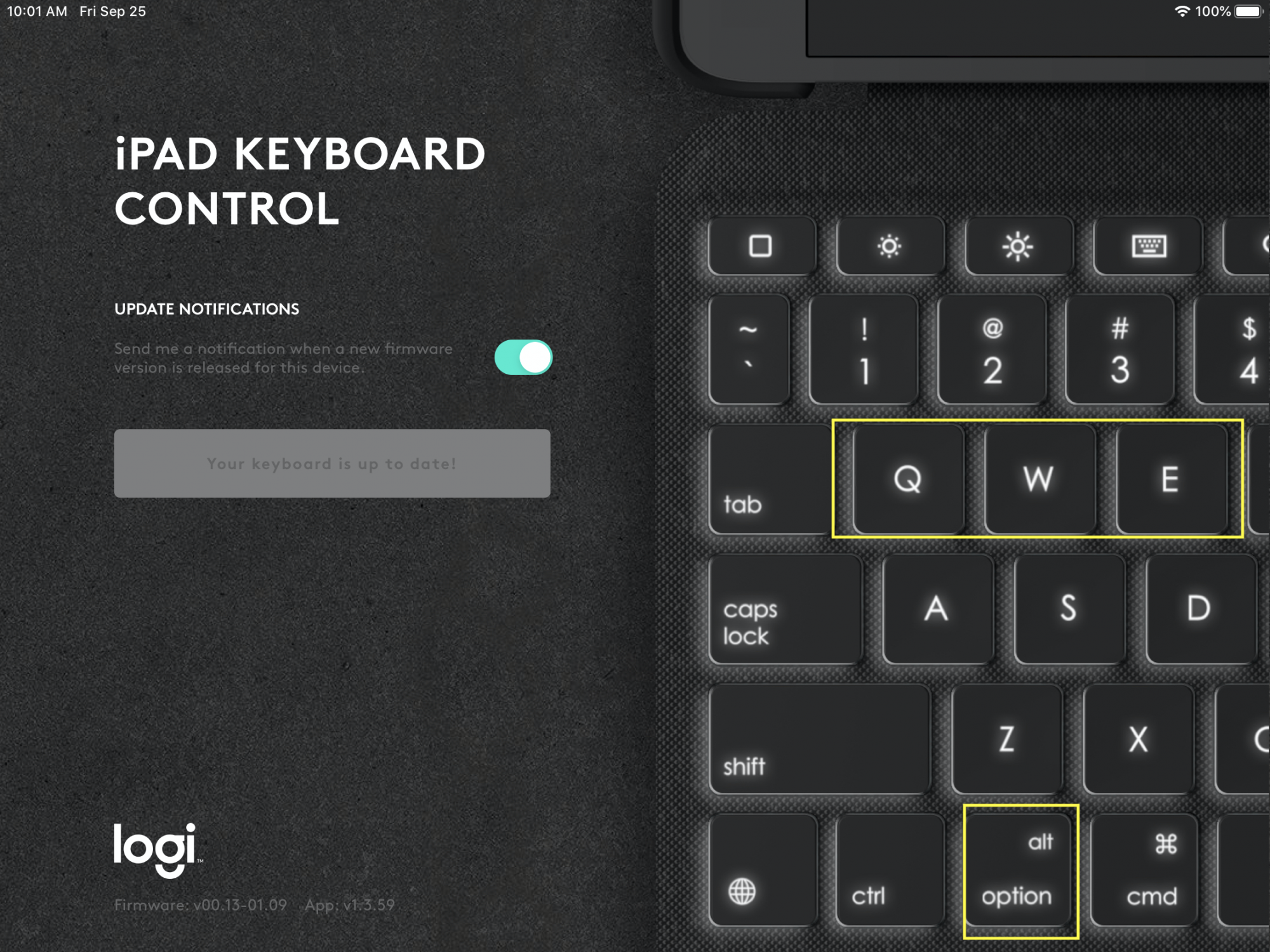

Hey everyone, I found the answer here https://discussions.apple.com/thread/251831306?answerId=253527885022#253527885022
In a nutshell - to retrigger the firmware update - open the Logitech control app and on the ON SCREEN picture keyboard hold down simultaneously Q W E Option keys (ON THE SCREEN NOT THE ACTUAL KEYBOARD). The ”Your keyboard is up to date button turns green and active and then tap on it and the reinstall of the firmware will start.
I tried it and it worked!!
I just did this and now my trackpad is working again. Thank you for finding this!
