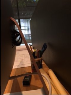

I made a device to fix this for people that are out of warranty and want a cheap solution. Currently I only have this for the 21.5 but will have the 27" ready in about a week.
I would really like to find a couple of people to test this for me and give me some honest feedback.
Looks great. Beats my putting a box under the lip of the screen to hold in place. I have the 27", and would love to try your device when you have one for that size.
I've sold quite a few of these for the 2012-2015 27" iMac. www.themachack.com
It's great to see someone being creative to solve a problem. I wonder if you could design something that fitted into the cable slot in the stand? I think it would suit the styling of the iMac a bit belter and give the appearance of being sturdier.
Have a look at the Alurack for an idea how to make the connection.
