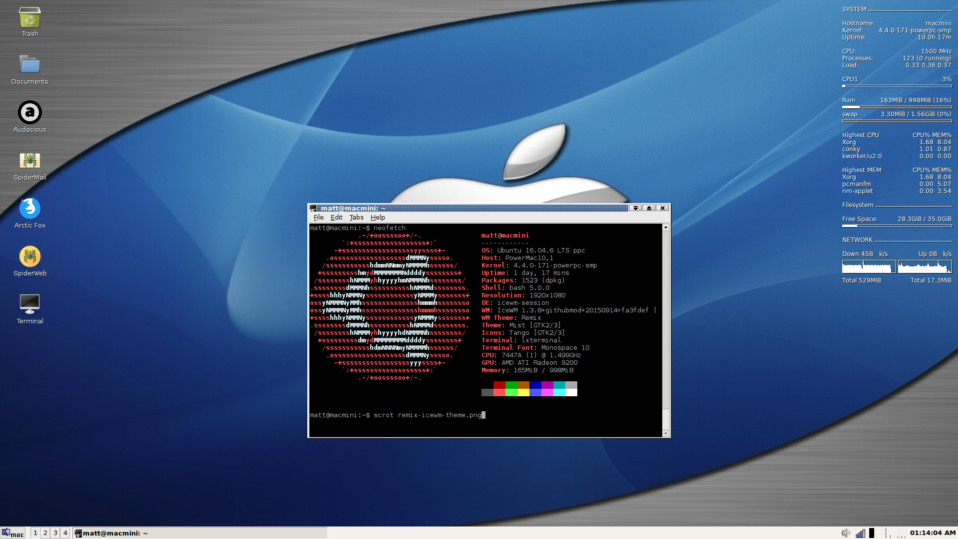

I created an IceWM theme based off of elements from 2 other themes and added an autostart script to load volume icon, network manager, desktop icons etc for Lubuntu Remix (or i suppose any other *nix as well). I prefer IceWM on my mac mini g4 as lxde/xfce etc do something that the Radeon 9200 doesn't like, and windows are laggy to drag. IceWM doesn't have this issue. It's also lighter on resources. Installation instructions are in the archive.

Icewm looks promising - (seems to have additional programs available) even if its looking rather plain compared to your screen shot, wicknix.

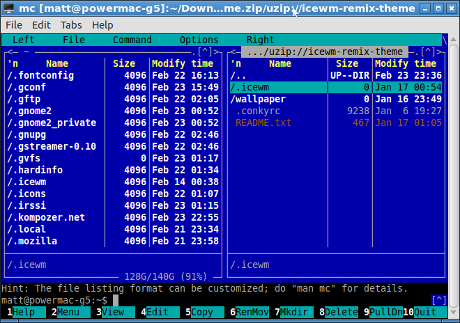

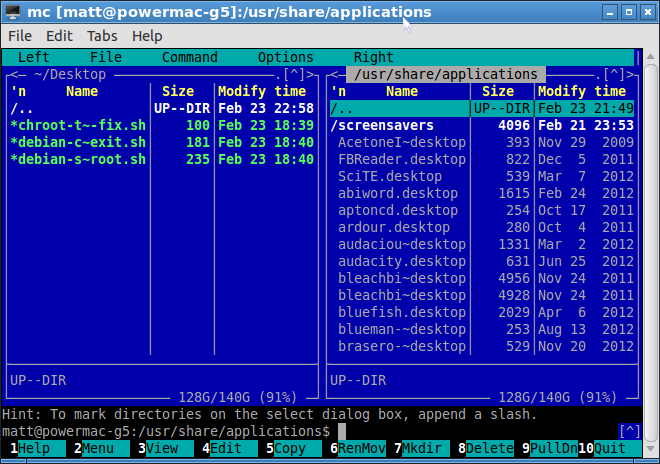

Ah yeah the nm-applet was a typo on my part. It's part of network-manager-gnome, so sudo apt-get install network-manager-gnome. That package includes nm-applet.

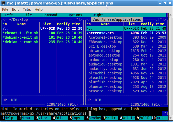

Are you familiar with midnight commander at all? It's preinstalled. Open a terminal and type mc . You'll see a 2 pane text based file manager. Navigate with arrow keys and hit enter to move into directories. The tab key jumps you from left to right pane and vise versa. Navigate to the directory you extracted the Remix theme. Highlight the .icewm directory and hit F5 (or esc + 5 if you dont have function keys, or click the lower 5copy with mouse) to copy that directory to your ~/ directory. See screenshot below:
Screenshot from 2020-02-23 23:37:40.png
Now do the same for .conkyrc. Highlight it, hit esc+5 to copy it to ~/
Now close everything and log out, then log back in. Everything should be good now.
Also if you want extra desktop icons, again use mc. In the left pane scroll down to /Desktop and hit enter. Now hit TAB to switch panes. Navigate to /usr/share/applications/ and just copy any .desktop file you want displayed on your desktop.

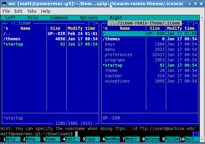

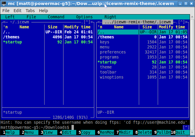

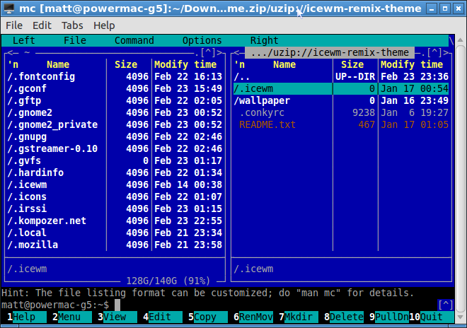

Ok, so i just tested it on ubuntu12. You'll need to delete a few files inside the ~/.icewm directory once you copy it over, otherwise the menu will be missing, and logout won't work. After deleting these files and using the defaults it's fine.
Screenshot from 2020-02-24 01:18:26.png
Delete everything except the /themes directory and the startup script so it looks like the pane on the left.
