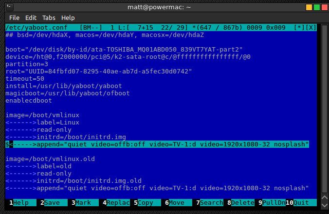

Thanks for your reply. May be i am doing something wrong. I attached the line
Code:
append="radeon.agpmode=-1 quiet video=offb:off nosplash"
to the end of the /etc/yaboot.conf, typed "sudo ybin -v" and rebooted.
Same Problem: the system locks up, the screen flashes a few times and remains frozen.
My Mini G4 is the same model as yours, late 2005, 1 GB ram, only 1.33 GHz and 32MB videoram.
I installed both of your images several times, did a p/r reset, but it`s always the same...
Edit: Yes, it works! Stupid me! I edited the "append=" line below the "image=/boot/vmlinux" and now everything is cool.

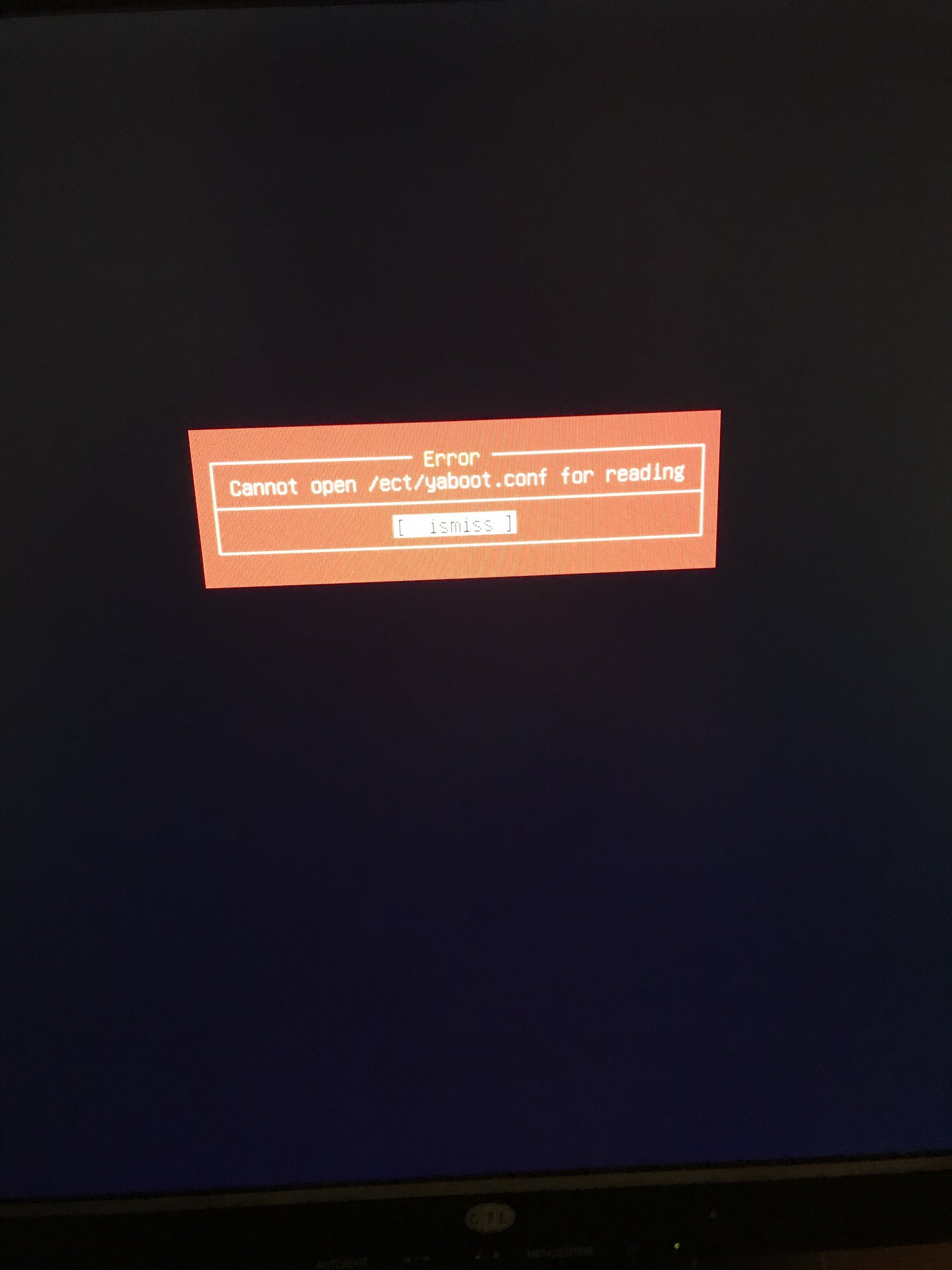

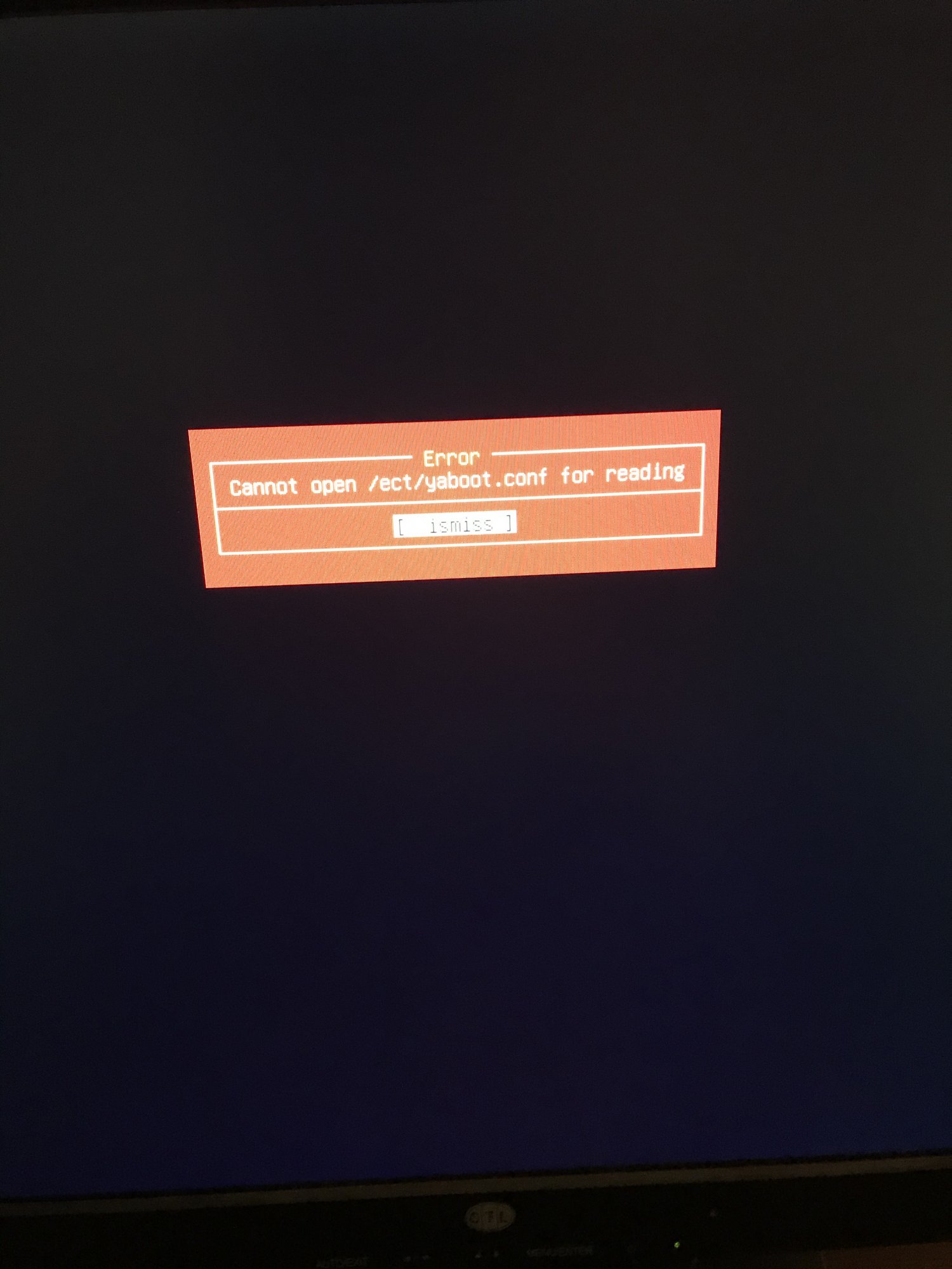

I’m not sure what happened. I just burned a DVD. I’ve installed it again using the DVD, now it boots from the HDD. However I still have the above problem. I dropped down to the command line, but after typing sudo mcedit /ect/yaboot.conf I get this:
I tried the same thing using nano instead of mcedit and nano said that /ect/yaboot.conf doesn’t exist.
The file is
/etc/yaboot.conf
(that's e-t-c) 🙂
Yours says /ect/yaboot.conf.
The file is
/etc/yaboot.conf
(that's e-t-c) 🙂
God d*****. I guess I'm dyslexic now. Disregard my last post.
I'm not a complete linux noob, but this is definitely not the first time I've typed in /ect/ instead of /etc/. Probably the 2nd or third time over the years lol

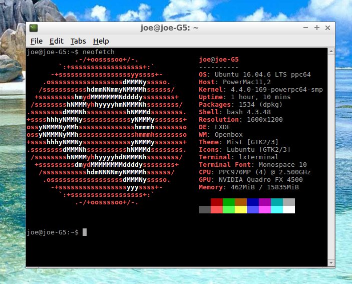

So I had some time to work with the 4x2.5 G5 system a little more, I was looking for a way to have accelerated graphics with the Nvidia Quadro FX4500. Searching around I found this thread:
https://ubuntu-mate.community/t/quadro-fx-4500-power-mac-g5-quad/11907
and the Yaboot parameter "live-powerpc64 nouveau.config=NvMSI=0" seems to work on the FX4500. I still need to figure out if I have true accelerated graphics, but the system seems very stable. This parameter did NOT work with either the 7800GT or 6600LE cards. It looks like nouveau driver has issues with MSI interrupts, the above link has much more information. This might be useful for anyone else playing with a G5 with PCIE graphics.
Thanks for all the help,
Joe

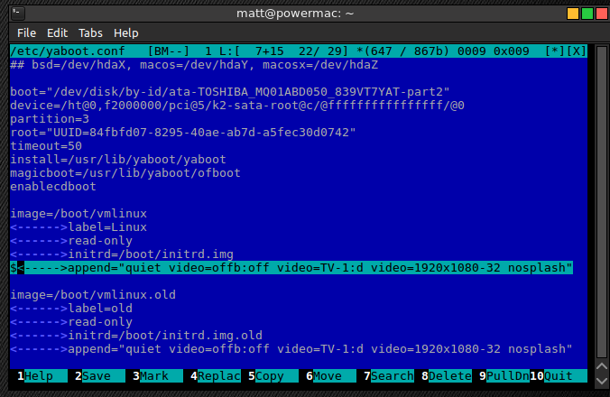

@Project Alice : Just following up to see if you got it figured out. Attached is my yaboot.conf for 1 of my G5's with a FX5200 in it. Just edit the highlighted line with the boot parameters that work with your GFX card, save it, then run: sudo ybin -v and reboot.
Cheers

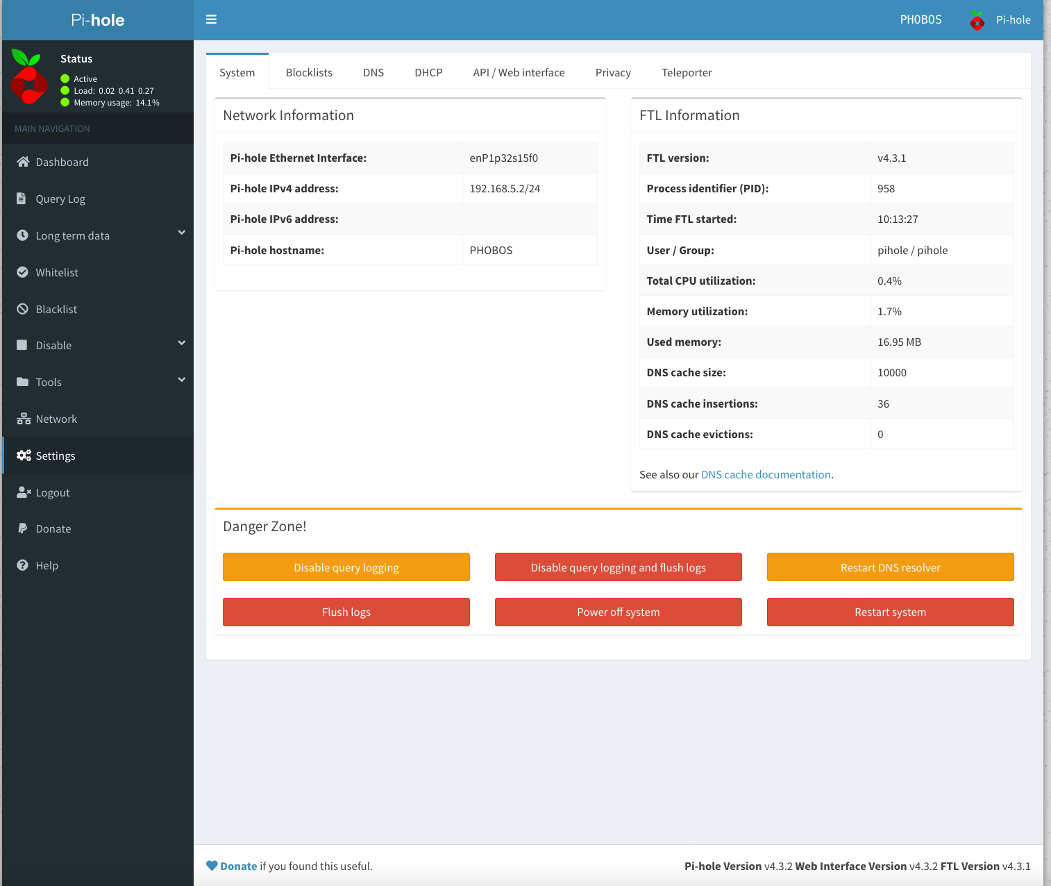

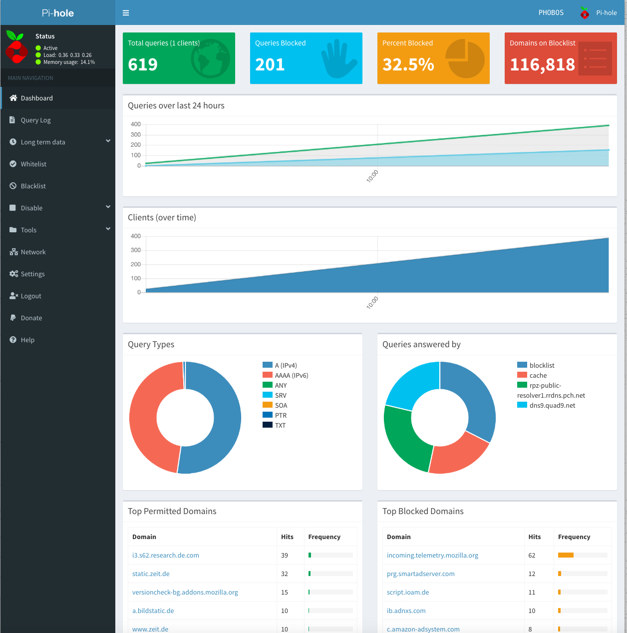

Looks like my Mini G4 has a new Life. Pi-Hole is up and running. I had to compile the FTLDNS by hand, but all ist well documented in the links.
It`s just up a few minutes, but everything looks good.
Next thing on the list is WLan, so it can be used as an AP for my IOS devices.
@wicknix: tnx for your work and support. I had so much fun with my recycled mini G4.
