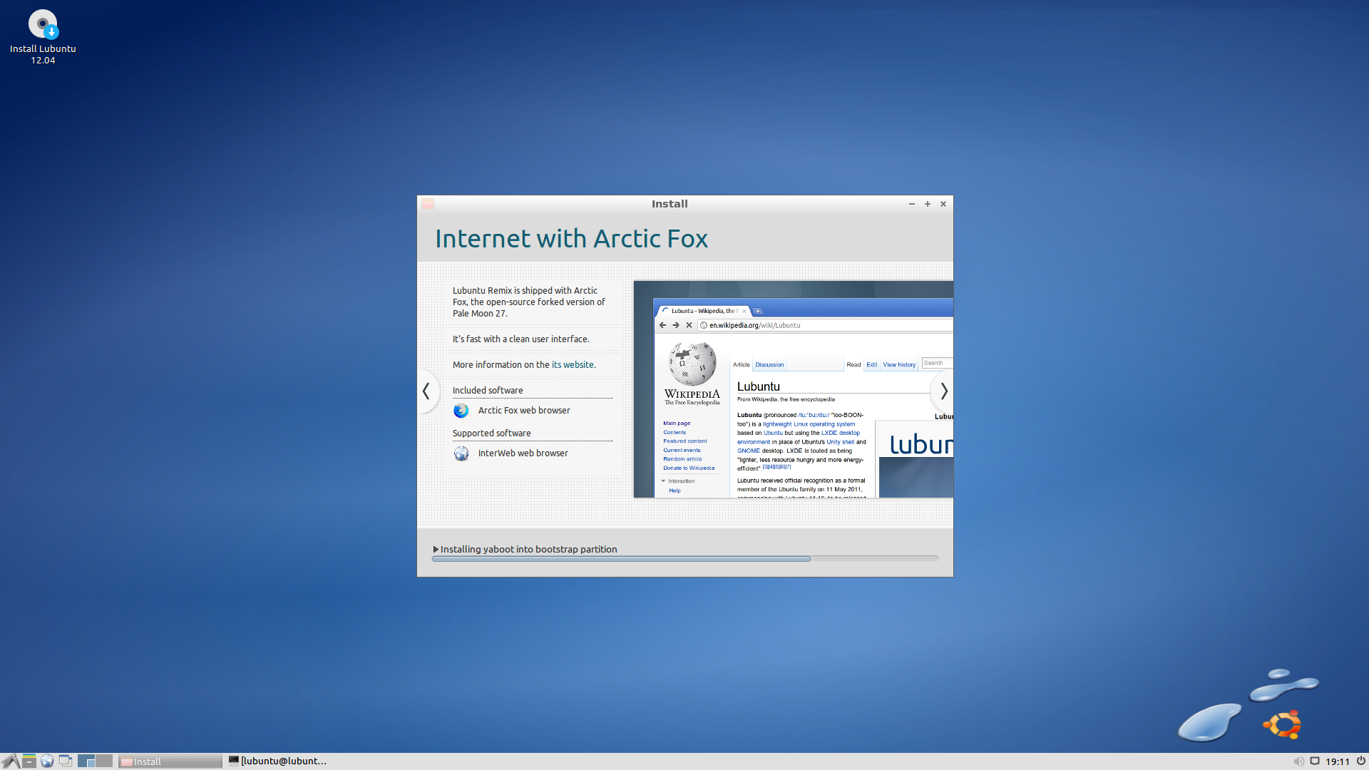

On another note, since i was off work today, i cleaned up 12.04-v2, and made v3 with a few improvements. First the installer was tweaked to display arcticfox and spidermail in the slideshow vs chrome and sylpheed. I also rebuilt a few packages to newer, or current versions, such as screen, xournal, irssi, putty, transmission, uget, etc. I left pretty much anything not internet related alone, except ffmpeg/mplayer/mencoder to keep it light and period correct. I'll upload later after more testing.
Edit: v3 download link updated on 1st post.
Screen shot of edited installer.

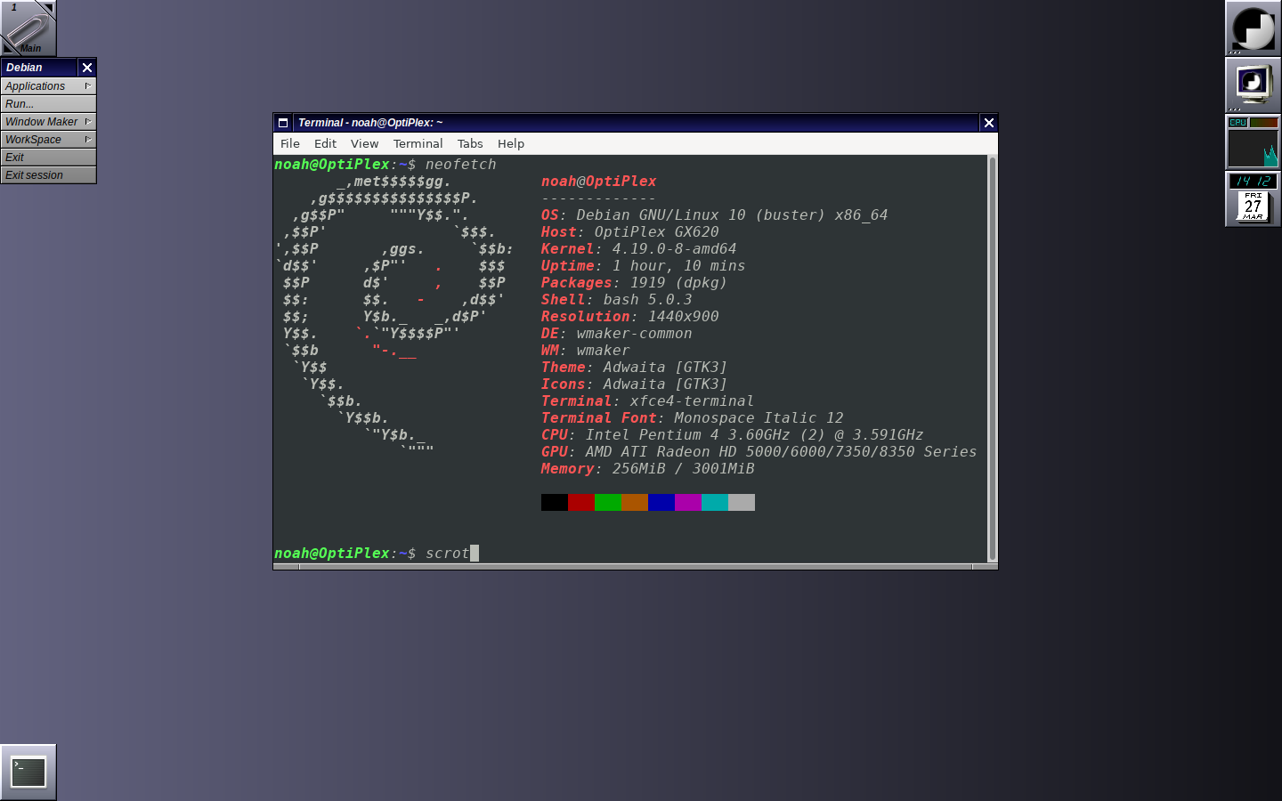

My very fast 3.6 HT Pentium 4 coupled with a Radeon 5450 [...] Running on Window Maker, no less.
I apologise for going off-topic, but I'd be interested in seeing a screenshot of your setup. 🙂

Sure, I could install it on my Dell Core 2 Duo, but then everything would just work, and where would the fun be?
