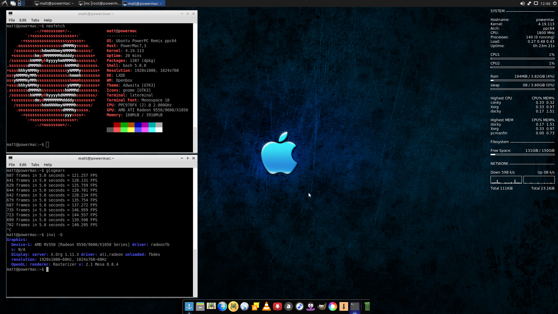

Since my PowerMac G5's don't seem to like the prebuilt 5.x kernels i decided to try building the latest 4.19.x branch from kernel.org on Ubuntu 12 remix. Works great, AND glxgears shows a significant boost. I use to get roughly 59FPS, now i'm over DOUBLE that, and 720p videos play flawlessly at 30% cpu. All in all, a few hours well spent. 🙂

So changing out the kernel improved GPU performance? Are the Radeon kernel modules different or something? This is interesting. I'm typing this from my 800 MHz iBook G3, running the Ubuntu 12 Remix. It works great, and even has 3D HW accel, after downgrading Mesa.
I have a question for you as well. When you dd your .iso images to a flash drive, are you creating a big FAT partition, or are you skipping adding a partition altogether, and just formatting it,then dd'ing the image?
That's a good question, but yes, glxgears output is much higher than with the stock kernel. My videos also don't struggle anymore at 720p or higher.
As for the flash drives, i generally format as FAT first. However that's probably overkill as dd doesn't care and just writes the .iso to the drive regardeless of filesystem type. I just do it to ensure the drive is free of possible leftovers.
Edit: Which mesa did you downgrade too? I might want to give that a test. Also, glad 12 remix is working well for you. I love it on my dual G5. It absolutely flies.

Not sure what version it is, but I just followed what @juancarlosonetti wrote here. I don't think it will work with your newer kernel, because disabling modesetting was only supported up to 4.4, to my knowledge.
