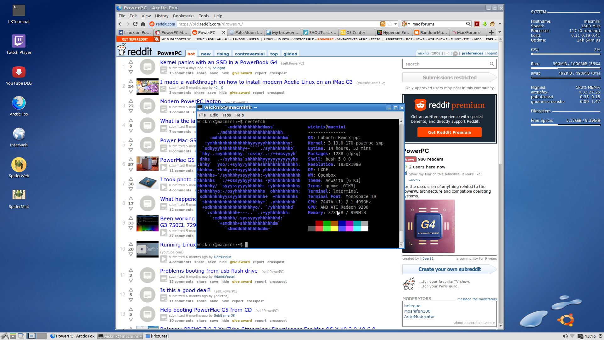

Interesting. Most of these machines are all pretty similar except that graphics cards and ram vary. I haven't a clue what would cause this either. I do know one thing though... i would never run Mate on anything less than a G5. It's way too resource heavy for a G4 in my opinion. 16.04 remix is nice and runs well. It's just too bad you couldn't experience the true speed of 12.04 remix.
Edit: FWIW, my powerbook is the 15" 1.67ghz w/2gb ram with radeon mobilty 9700 gfx card. It eats anything i throw at it. Ubuntu 12/14/16, Debian 8/10/Sid, Void-PPC, and any BSD without issue. So yeah, i'm stumped.
Cheers
