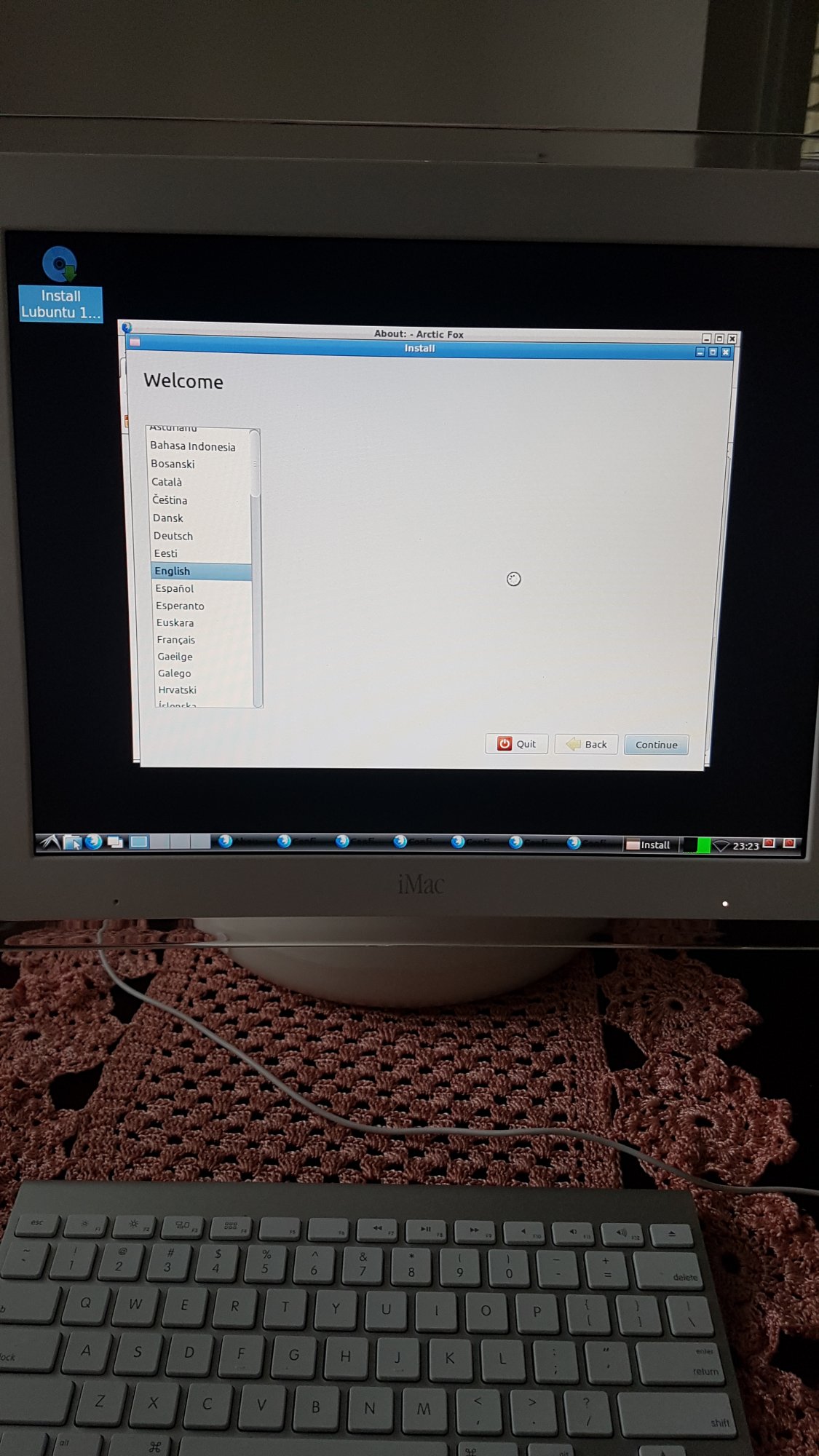

Ok, after some time trying to boot on linux using my iMac G4 800 (2002 model) with the humble NVidia geforce4 MX I found how get the X working....
1) boot usb1/disk@1:,\\yaboot (no big deal)
2)
Code:
live video=offb:off nomodeset single
3) wait "blind" for some time (the screen will be frozen but it's booting)
4) Press Enter key once (blind)
5) type 'modprobe nvidiafb mode_option=1024x768-16' (blind)
6) now you'll see the console 🍻
7) Ctrl key + D
8) startx
9) Finally there!

@Henrique Guidi Does native 1440x900 also work?
Mine is the 15'' model, so goes up to 1024x768. You will have to try...
Also, I was able to install 12.04 but with 8bit video for now.
After install you have to
1) sudo vi /etc/modprobe.d/blacklist-framebuffer.conf
And comment (#) the nvidiafb line
2) sudo vi /etc/yaboot.conf
And remove "single" from the append line
3) sudo ybin -v
To update yaboot
Now I'm working on "/usr/share/X11/xorg.conf.d/10-monitor.conf" to have color depth to 16. And also struggling with AirPort that list all my wifi networks but can't connect to my open network that I'm able to connect using OS9...
