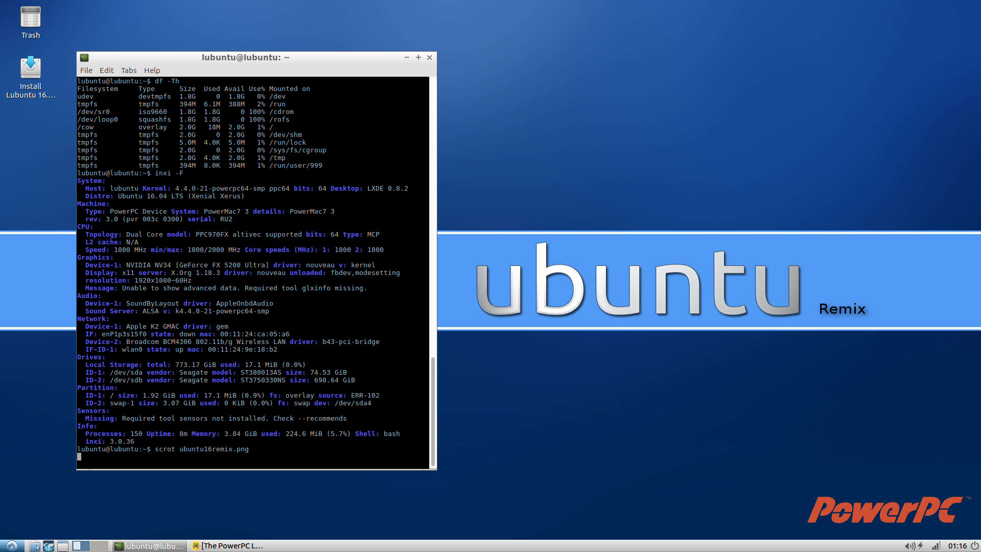

Here it is. New and improved over the stock 16.04 release. You can use as a live dvd / recovery system, or install it. What's changed since the original release back in 2016?
Added SpiderWeb, SpiderMail, InterWeb and Arctic Fox (modern web browsers and email client)
Added wifi firmware, sound modules, and windfarm (fan) modules loaded by default
Added battery indicator for laptops
Added right click for ibook/powerbook users via 2 finger tap (PB) or left ctrl + click (IB)

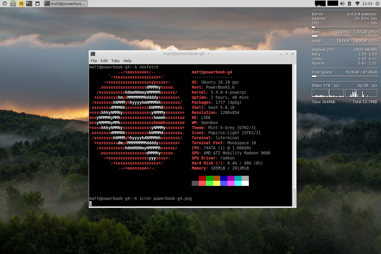

Added inxi and neofetch cli system info scripts
Added midnight commander (mc) cli file manager / editor / ftp client
Added discord and facebook messenger plugins for Pidgin
Added custom wallpapers and better default theme
Added Libre Office 6.2
Disabled the annoying crash reporter that always ate cpu cycles
Added conky desktop system monitor with custom layout (menu -> run, type conky -b)
There might be more that i'm forgetting, but that's the basics anyway.
Download is roughly 1.5gb
Sound is enabled, but muted by default. Open terminal, type alsamixer, right arrow key until you highlight "pcm", up arrow key to set desired volume level, esc key to exit. If you have a laptop add pmu_battery to /etc/modules and reboot to get a working battery indicator.

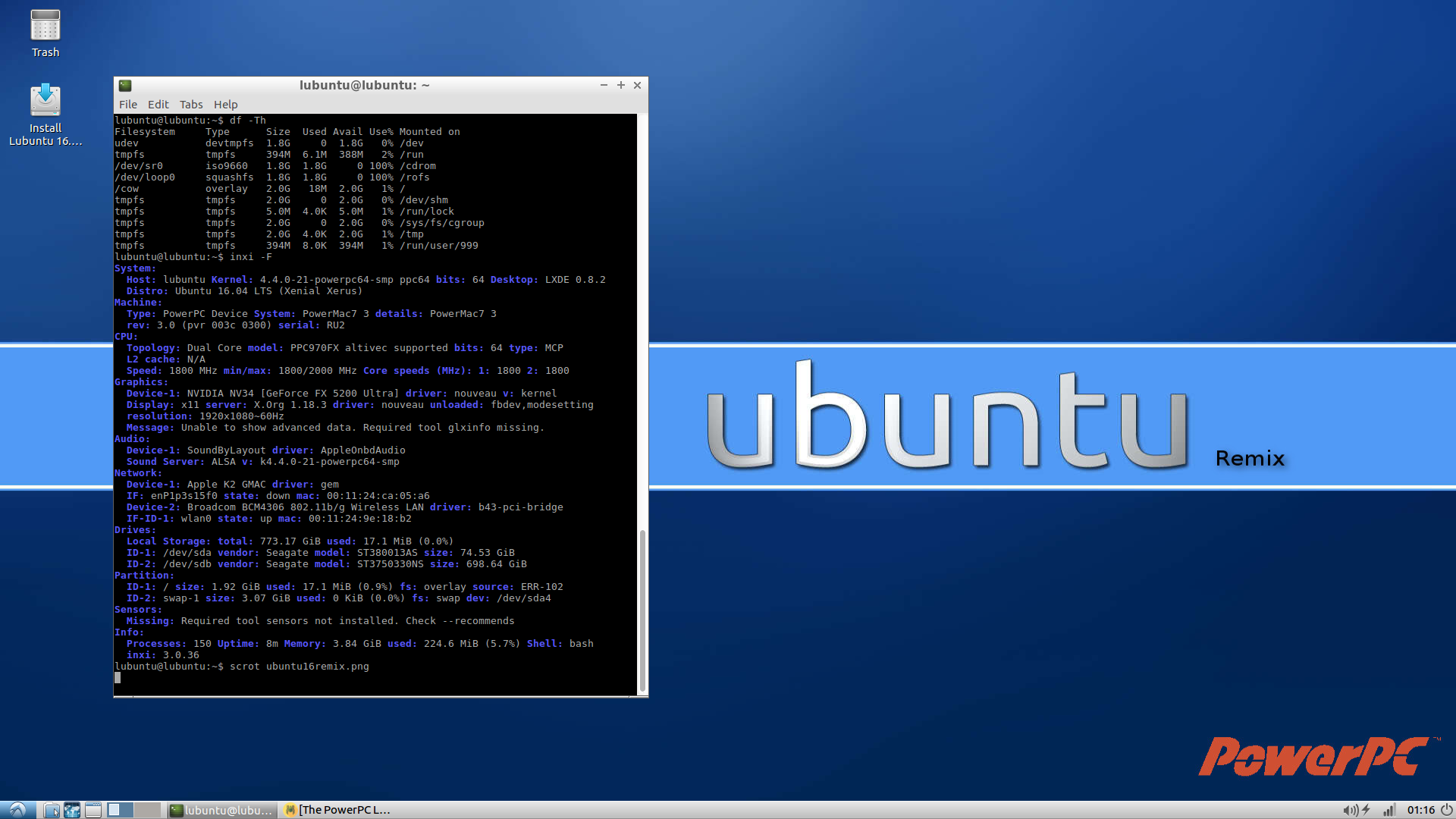

Shown running live DVD on a powermac g5

My Powerbook G4 with MacBuntu

Here it is. New and improved over the stock 16.04 release. You can use as a live dvd or install it. Live is semi limited in features vs full installation however. What's changed since the original release back in 2016?
Updated to 16.04.6 with security updates as of 10/07/2019 (not on live dvd)
Removed old firefox (not on live dvd)
Added SpiderWeb and SpiderMail
Added right click for ibook/powerbook users via left control + click (not on live dvd)
Added custom wallpaper (not on live dvd)
Added a few more openbox themes and Shiki-Wise gtk theme
Adjusted swappiness to use 90% ram before using swap (not on live dvd)
Disabled the annoying crash reporter that always ate cpu cycles (not on live dvd)
Added conky desktop system monitor with custom layout (not on live dvd)
Download is 1.8gb. Please read the readme.txt in the .zip
Edit: Sound is enabled, but muted by default. Open terminal, type alsamixer, right arrow key until you highlight "pcm", up arrow key to set desired volume level, esc key to exit.

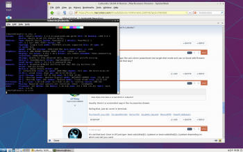

@MoerBoer in terminal type : scrot nameofimage.png or scrot -d 10 nameofimage.png (-d delay 10 seconds)
I selected the powerpc64 live version on boot and it's working just fine :)
Live boot working nicely.

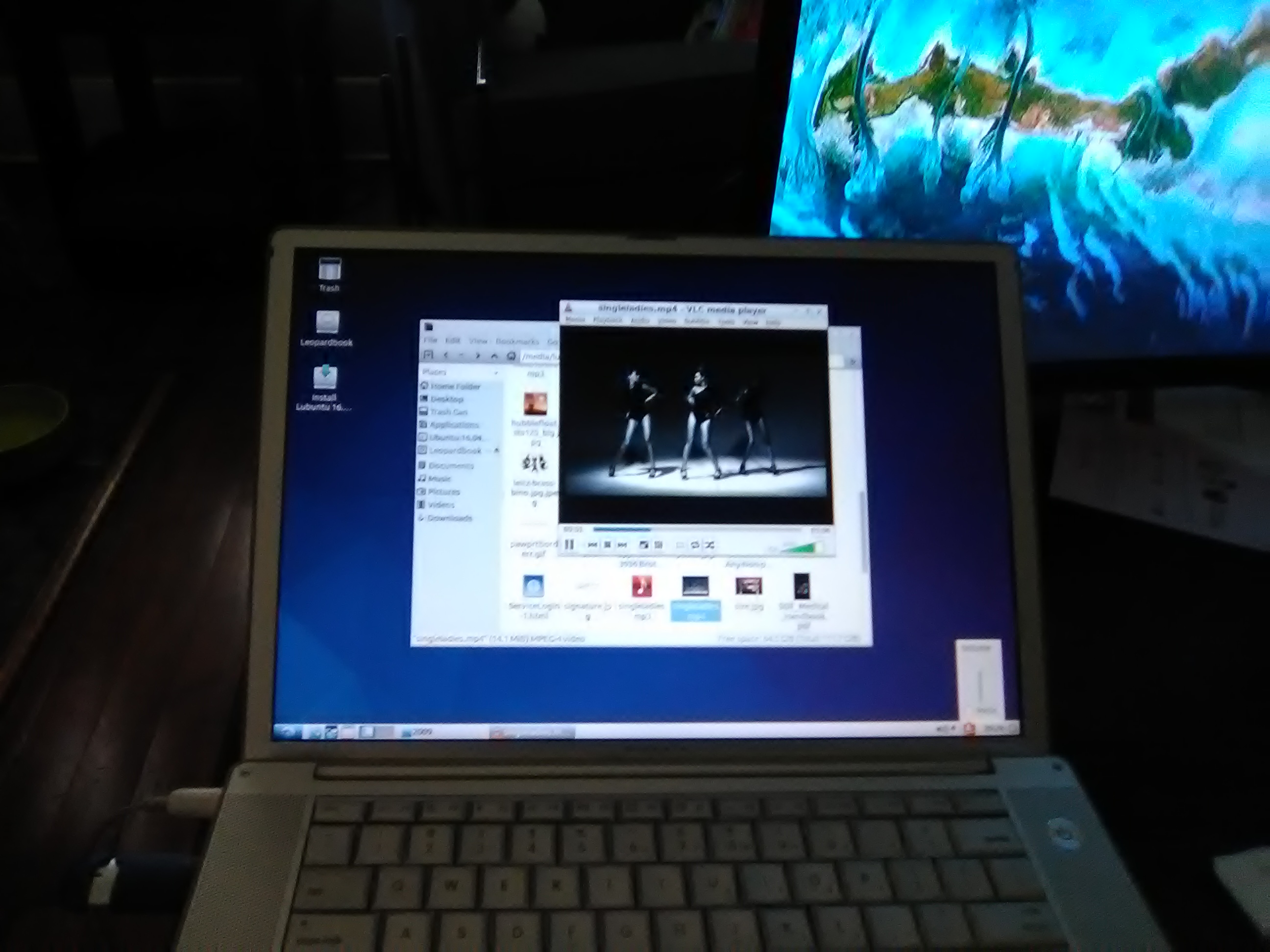

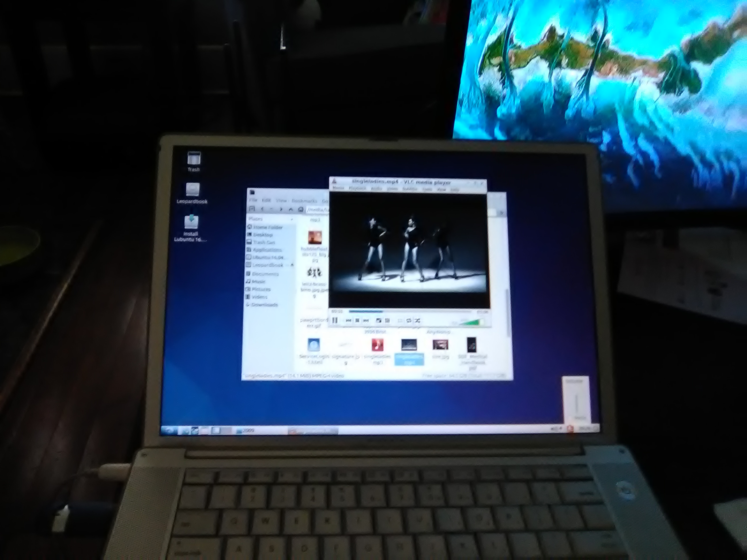

On my 1.67ghz Powerbook G4 15 inch boots off a usb fine, I get to the desktop and as soon as I click on the menu it locks right up. Might be a hardware problem? OS X is however working fine on same hardware. Maybe I'll try another usb stick.
Reactions: z970
Same thing happened on my 1.33 iBook G4.
