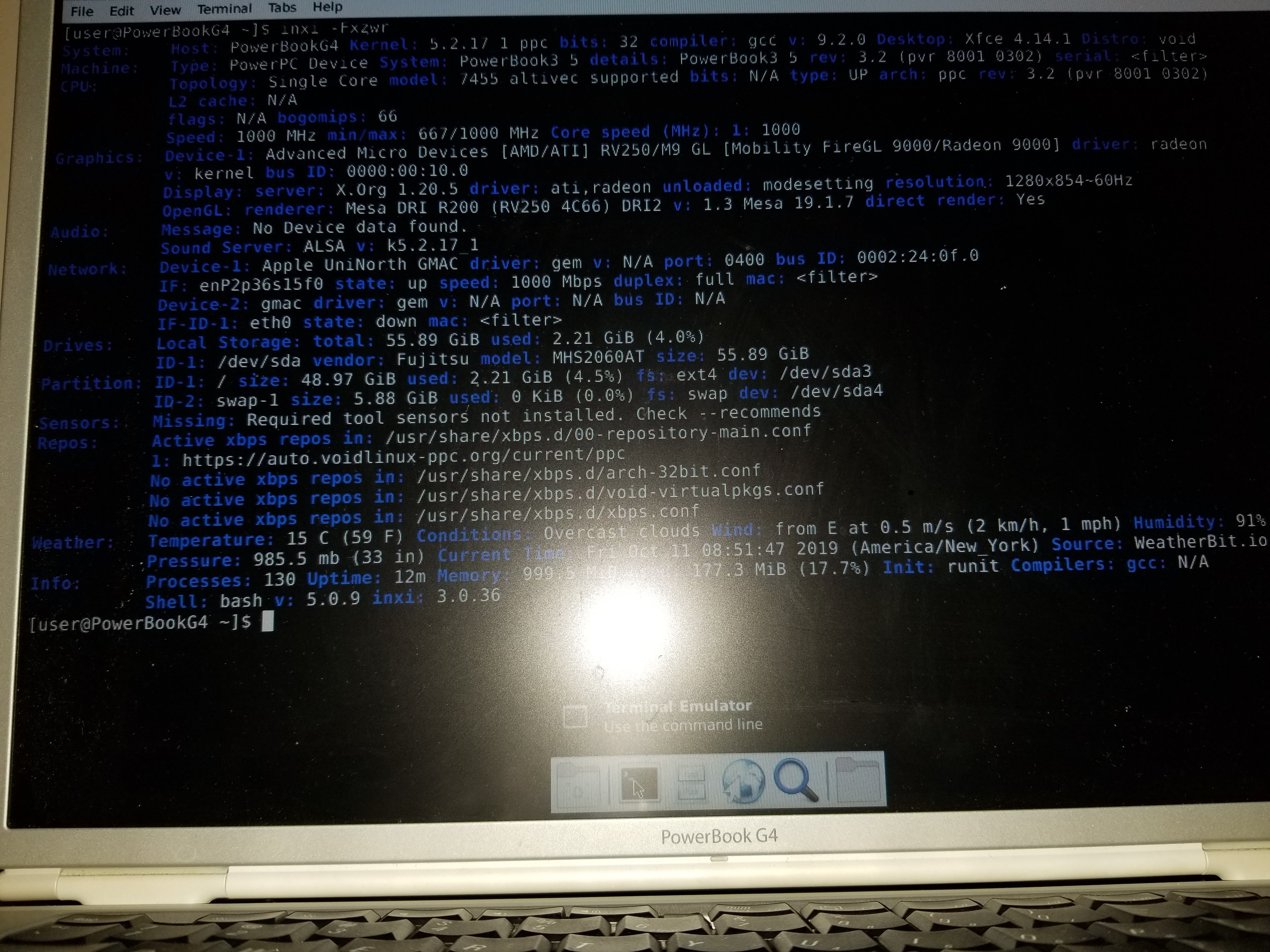

Well it seems voidlinux-ppc is the only distro to be stable and have most everything working on this TiBookG4 (I mean it has the best keyboard of even current macbooks!) behold

I've had no issues running kernels 5.1, 5.2, 5.3 on both G4 and G5s. Most of the issues are elsewhere
Are they? You’re the Void PPC developer correct? I’ve had a good experience with Void on G4 machines, but 2D / 3D acceleration is broken on both of my Powermac G5’s with AGP graphics cards, along with all iBooks with ATI Rage GPU’s, and Radeon 7500 GPU’s. What could be at fault?

Are they? I u detest and you’re the Void PPC developer correct? I’ve had a good experience with avoid on G4 machines, but 2D / 3D acceleration is broken on both of my Powermac G5’s with AGP graphics cards, along with all iBooks with ATI Rage GPU’s, and Radeon 7500 GPU’s. What could be at fault?
Yes, I am. A bit hard to say about the graphics stuff. I don't have any AGP ppc macs with very old GPUs like this (closest is my Powerbook G4 with a Mobility Radeon 9700). What I'd try first is using the matching Xorg DDX driver (xf86-video-ati) instead of the generic modesetting xorg driver. The modesetting driver won't give you any 2D acceleration, since it's generic and uses OpenGL (GLAMOR) to accelerate 2D, and it could perhaps fix 3D as well, since the modern KMS paths may not be well tested on old hardware like that.

sure, but you can still use the DDX driver for xorg-specific 2D accel paths and stuff even with the KMS kernel driver.
Anyways, I plan to spin some 3.16/3.18/4.4 kernels for the repository as well, at least for 32-bit and maybe BE 64-bit (LE 64-bit doesn't need them, and my space is limited as it is...). So in case the current kernels won't cut it (it should always at least boot though), one will always be able to fall back onto the older stuff (at least as long as it doesn't go EOL). And maybe in the meantime those other issues will get ironed out.
