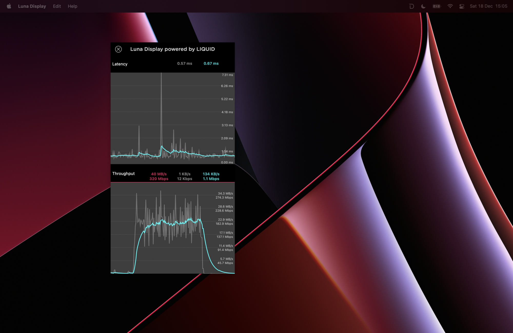

It comes with a bandwidth meter (selectable from the app main menu), shown below just after I'd been scribble-dragging this browser window around on the Luna Display. (The meter window is on the internal screen so it doesn't itself take up bandwidth.) 320Mbps seems to be a hard upper limit on the bandwidth it'll take on any interface, but it also seems sufficient. (I wonder if you could use more to get 60Hz on a 5K screen, you'd get diminishing returns as it would use up more computing resources on both ends, to capture, encode, decode, display that, to the point of possibly sacrificing performance in other respects.)

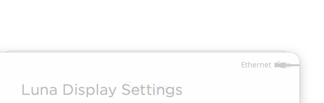

When you connect via your adaptor does Luna Primary (on the MBP) state that it is using an Ethernet connection? For me it doesn’t unless I use ethernet to ethernet without an adaptor.
That sounds like my Anker adaptor which gives me poor performance on the Mini and on the Hub. Yeah I have the Luna plugged directly into a port on the Mini.
I've got it set to only use ethernet just so I know it's only me I'm broadcasting to... it shows it up on the display as attached. Also I set it like that so I know it's going the best way it can and not defaulting to wifi. All very confusing!
