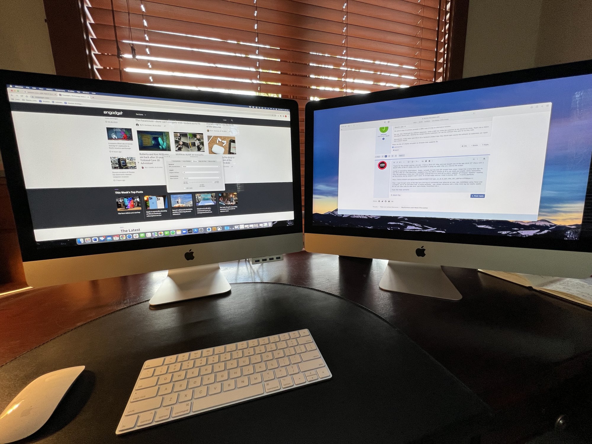

Thanks for this thread, joining a bit late. I have a 2015 27" iMac and just bought one of the last 2020 27" iMacs with a decent GPU (5700 XT 16GB) and was interested in using my older iMac as a second 5K screen.
Couple of interesting observations - firstly I already had the mini-DP version from when I tried this a long time ago on the 2015 iMac so I was assuming I would eventually need to buy the USB-C version to fit in my 2020 and enable retina resolutions but before that I wanted to try an adapter. They say ignorance is bliss and I had already ordered this $12 mini-DP to USB-C adapter off Amazon *before* reading all the articles saying adapters won't work. It arrived today and so I tried it anyway and ... it works perfectly.

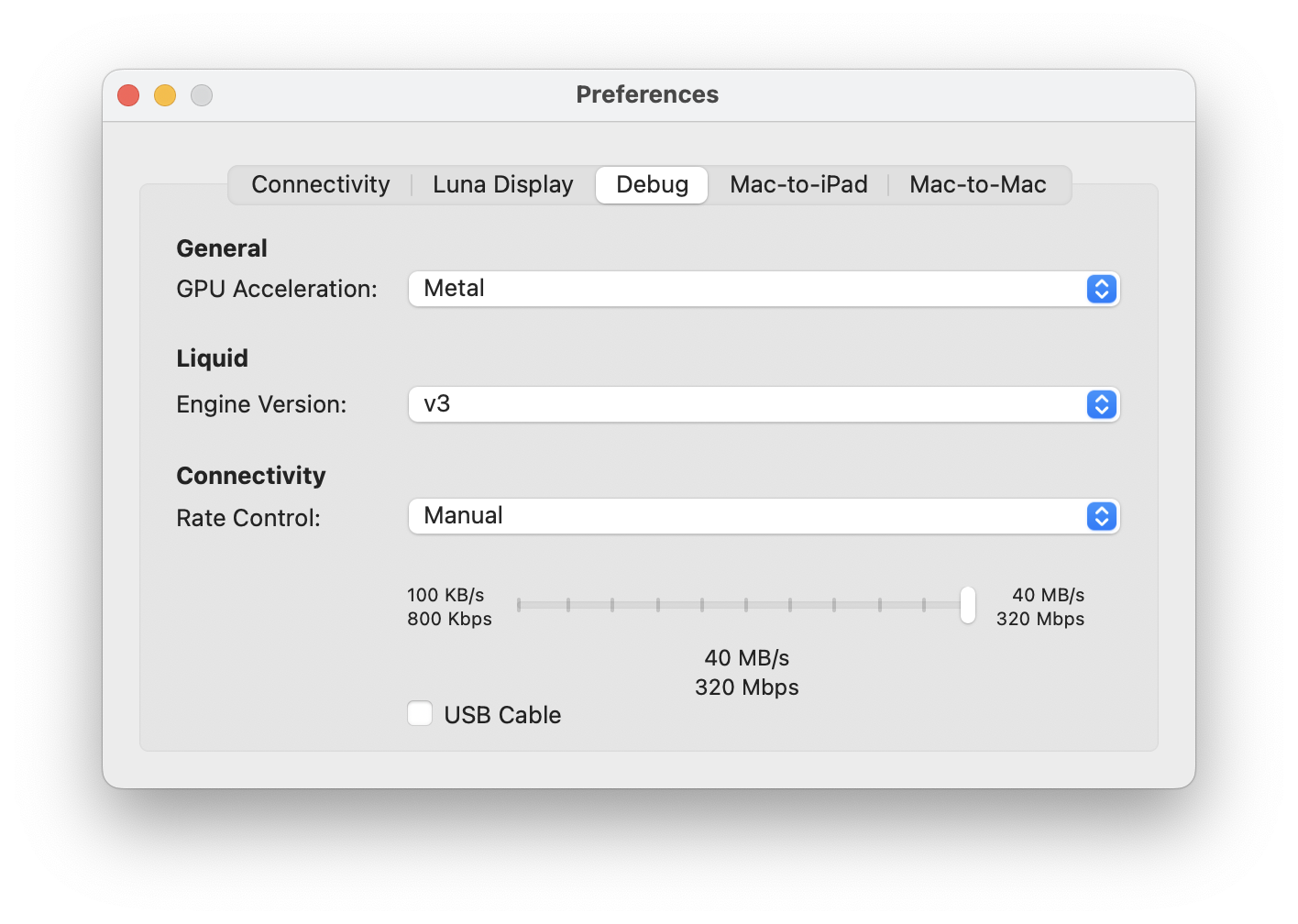

Then I read through some of the tips here (thank you) and have it connected over ethernet at max rate (320Mbps) using Metal and v3 Engine, set for 5K and 60Hz max. It works perfectly - yes, screen refreshes with a little more lag but totally usable for my use case where I want super crisp text that matches my main iMac 5K panel (side-by-side docs, web articles, PowerPoint etc.).
Question: does anyone think this will get even smoother with a thunderbolt cable direct connection? Which cable type do I need for my 2015<>2020 iMacs?

For those on a 27" iMac, I think i found a good compromise for Retina Quality/Frame Rate. If you go into Luna settings and select max resolution 4K, max refresh rate 60hz and then under Settings -> Displays -> Scaled -> 2560x1440, this makes it looks "retina" (I can't tell the difference between 4k and 5k) but allow you to keep 60hz.
Make sure to restart Luna Display for the 4k to take effect.
Thanks, this does appear a bit more snappy but I find that Luna/MacOS forgets the 2560x1440 resolution when it restarts and text is zoomed in as a result - it requires it to be changed back each time. Do you see the same thing?
