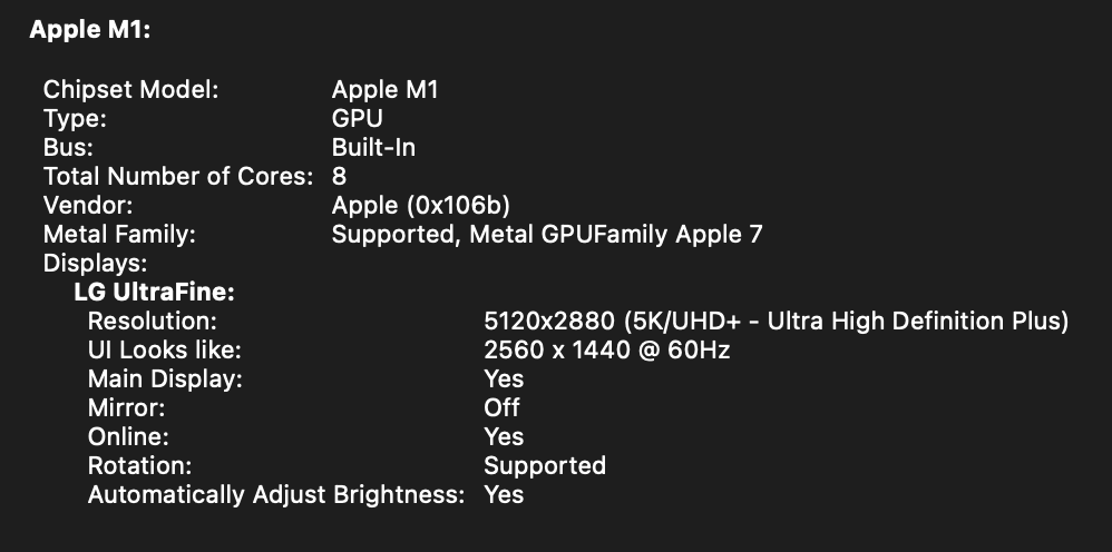

Do me a favor please! Check display resolution in system report. I run a Dell 4K on my M1 Mini and have issues with video at high resolution going from dark to light. Mine shows with 5K resolution in sys report, however it is a 4K max display. Also HDMI to HDMI

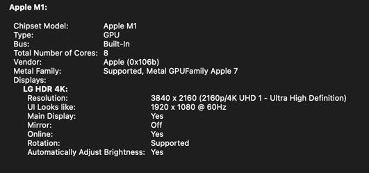

I have two LG 27UK850 plugged in to an M1 Mini, 1 via USB-C and the other HDMI. Both are running at 4K@60Hz, so you're good to go
From System Report:
Code:
Apple M1:
  Chipset Model:    Apple M1
  Type:    GPU
  Bus:    Built-In
  Total Number of Cores:    8
  Vendor:    Apple (0x106b)
  Metal Family:    Supported, Metal GPUFamily Apple 7
  Displays:
LG HDR 4K:
  Resolution:    3840x2160 (2160p/4K UHD 1 - Ultra High Definition)
  UI Looks like:    1920 x 1080 @ 60Hz
  Main Display:    Yes
  Mirror:    Off
  Online:    Yes
  Rotation:    Supported
  Automatically Adjust Brightness:    Yes
LG HDR 4K:
  Mirror:    Off
  Online:    Yes
  Rotation:    Supported
Reactions: sarveshmth

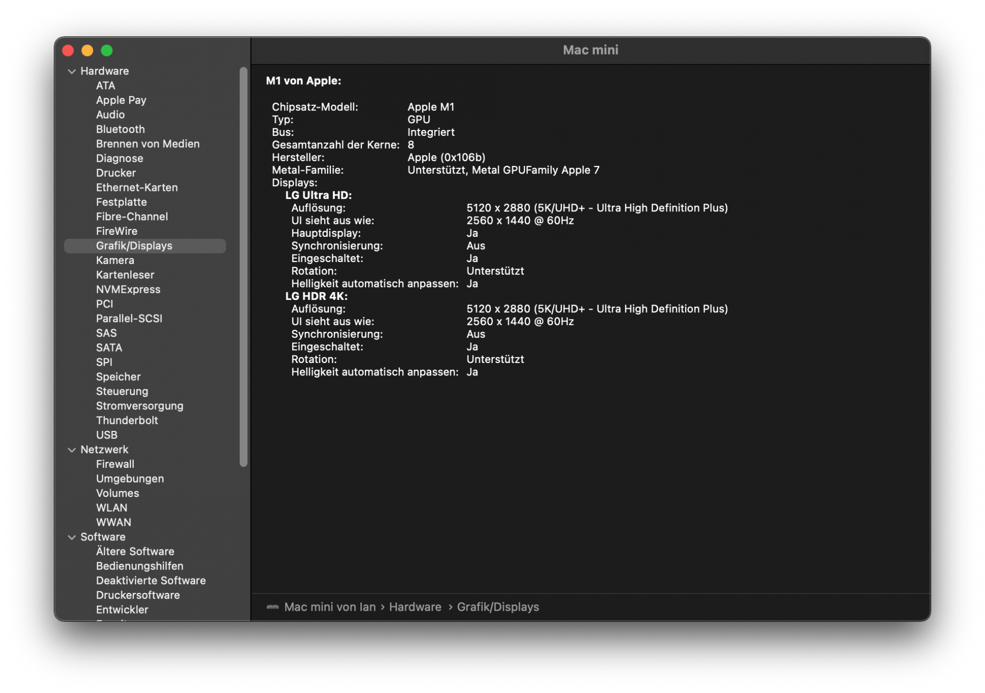

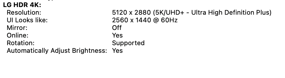

Mine says the same thing... It is a 4K monitor:
