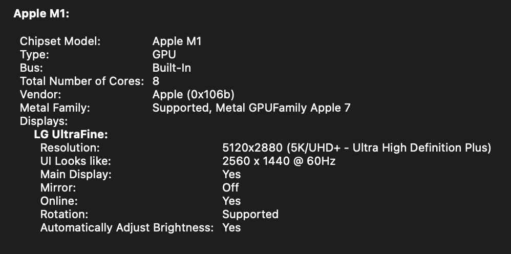

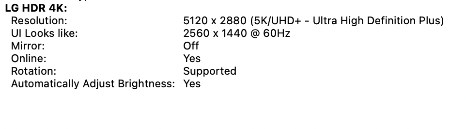

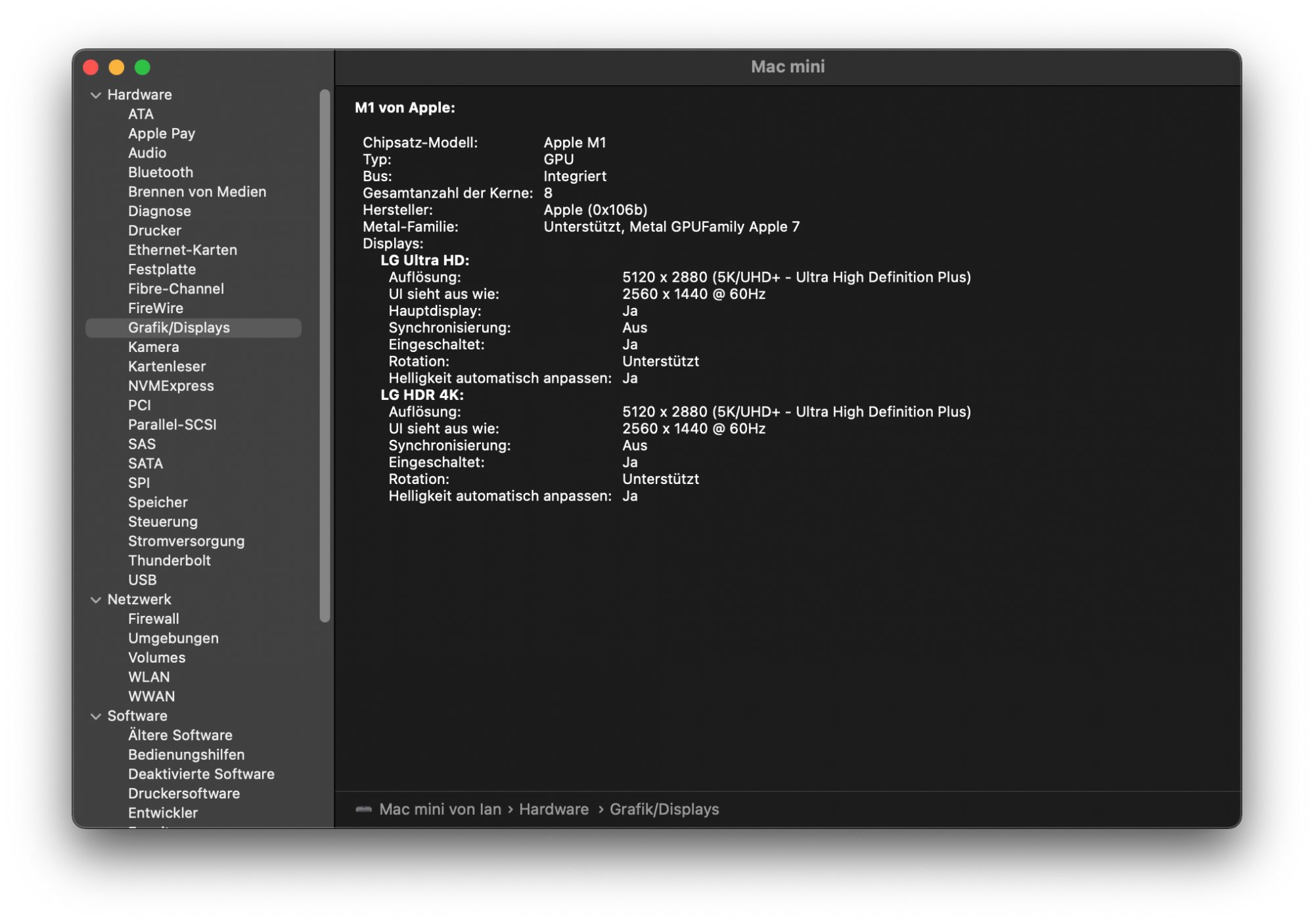

Do me a favor please! Check display resolution in system report. I run a Dell 4K on my M1 Mini and have issues with video at high resolution going from dark to light. Mine shows with 5K resolution in sys report, however it is a 4K max display. Also HDMI to HDMI
Mine says the same thing... It is a 4K monitor:

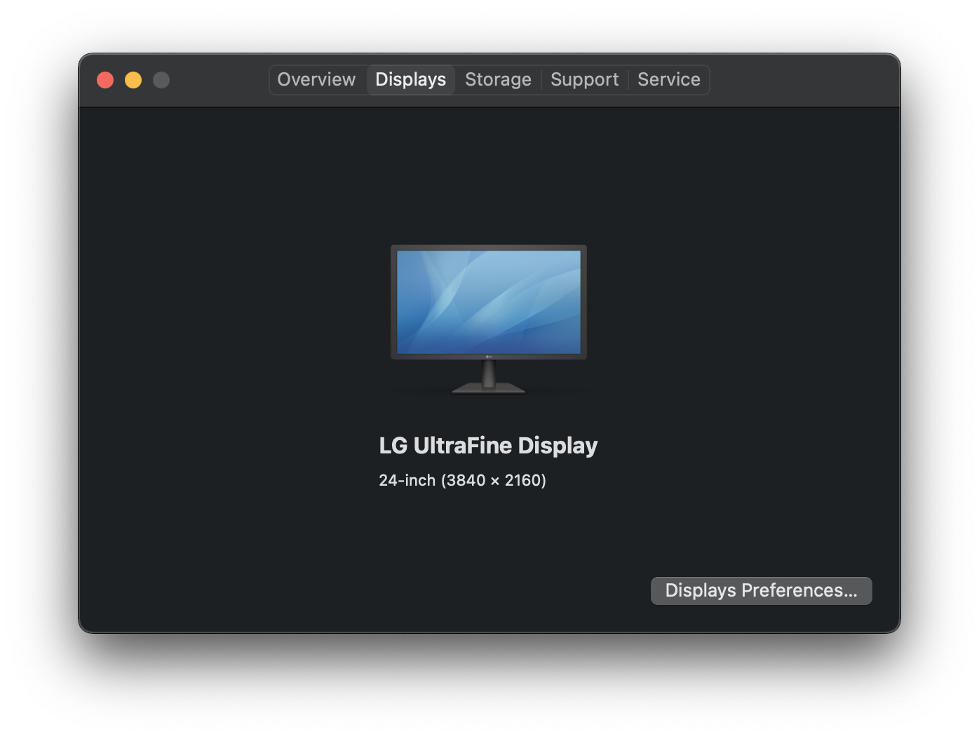

Strange. I have the new LG UltraFine 4K but in the System Report it shows as a 5K monitor which is obviously not correct... Just updated to macOS 11.01
I see the same thing on my 32UK550B. However, don’t forget the following;
If you select 2560x1440 as a scaled resolution (with HiDPI), the image has to be rendered at 5K before being downscaled and sent to the monitor.
In my case it says it’s a 27 inch monitor instead of 32 inch, but I don’t think the mentioned 5K resolution is a fault. It’s not communicated in a clear manner though 😀.
