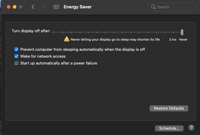

I also had an issue, but this has since fixed it. Maybe give it try? I usually manually put my macs to sleep anyways, so this was a no brainer. Monitor and mac mini wakes up when prompted, along with my mbp ‘11 (used as a 2nd monitor via lunadisplay dongle on the mac mini M1).
